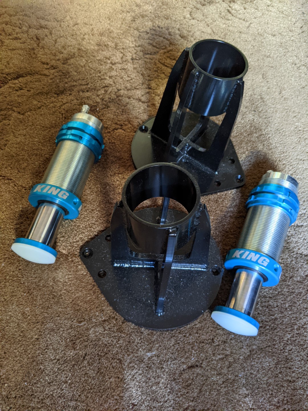

Well, sitting on the floor right now, but will end up replacing the rubber bump stops when I get up enough motivation to drop the front coils out. Being the dual rate dobs - they are tall when unsprung and somewhat of a pain to get on/off.
My (dear) wife picked them up on a w/end road trip down to disneyland (older son works very near there). Saved him dealing with shipping them up to me :) This 'should' be the last upgrade/prezzie for our 80 this year! Were a good deal.

Let us know how those work out. I'm curious about hydraulic bump stops. Might get some eventually.
