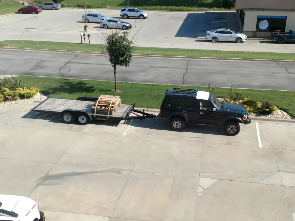

I towed with my 80 for the first time today.
I used a tilt style car trailer and had to haul some custom large skids for equipment to a shop. (not just the ones shown on the trailer now).
I have towed a LOT of stuff in my past, just not with my 80. Most of it with a 69 Chevy K10.
Well, I only had about 1000 LB on the trailer and the trailer is about 2200 LB and it pulls like a dream.
I had to unplug the lights (and brakes) because the wiring on my truck did not match the owner's vehicle so when I had my turn signals on, the brakes would cycle with the turn signal. That's not a big deal to me because I have never towed a trailer of any sort that had brakes. Everything I have towed on the farm was wagons or farm trailers that were never designed with brakes, yet weighed 20,000 LB each when loaded.
I have a 2.5" OME lift with heavies (850 / 863) and I also have airbags in the rear. I put 26 LB in the air bags and 45 PSI in the rear tires. (My new Duratracs.....My last set I got 97,777 miles on them...)
However, the 80 struggled on what I would consider small hills. I drove the entire time with the OD off. I drove about 55-65 MPH for the 2 hour trip. I burned a solid half tank of gas.
Running 60 MPH I had a couple hills that it had to downshift to second gear to maintain 55 MPH and hold it for 1/2 mile. Near the top of the hill, I noticed it got hot inside the cab. The AC shut off at 221°F coolant temp and it reset the AC at 215°F.
Most of the time it was running between 210°F and 215°F. It was a 95°F ambient day. This is the hottest I've ever seen my truck run. I know I'm due for some cooling system maintenance, so I will move it up on my list.
It will be interesting to see if the temps are lower on the way back with less load on the trailer and mostly less wind resistance. It will still be 95°F+ tomorrow anyway.

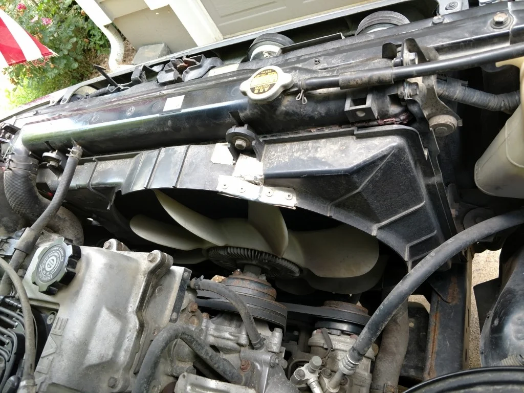

Well, my trip back home with the trailer, as you see it, was a bit better. I was able to drive with the OD on most of the time. It still downshifted occasionally, however, I still had (3) times when my AC kicked off and the engine reached 221°F.

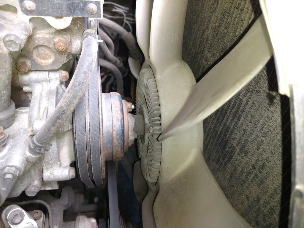

So, I got up this morning and took a look at the fan clutch, and, sure enough......the seal on it is leaking and it is easy to spin by hand. At least now I know the root cause.
I'm about ready to do my 100,000 mile cooling system tune-up, so this will now include a new fan shroud and a new fan clutch. The one that is on there is original with 316,500 miles on it.

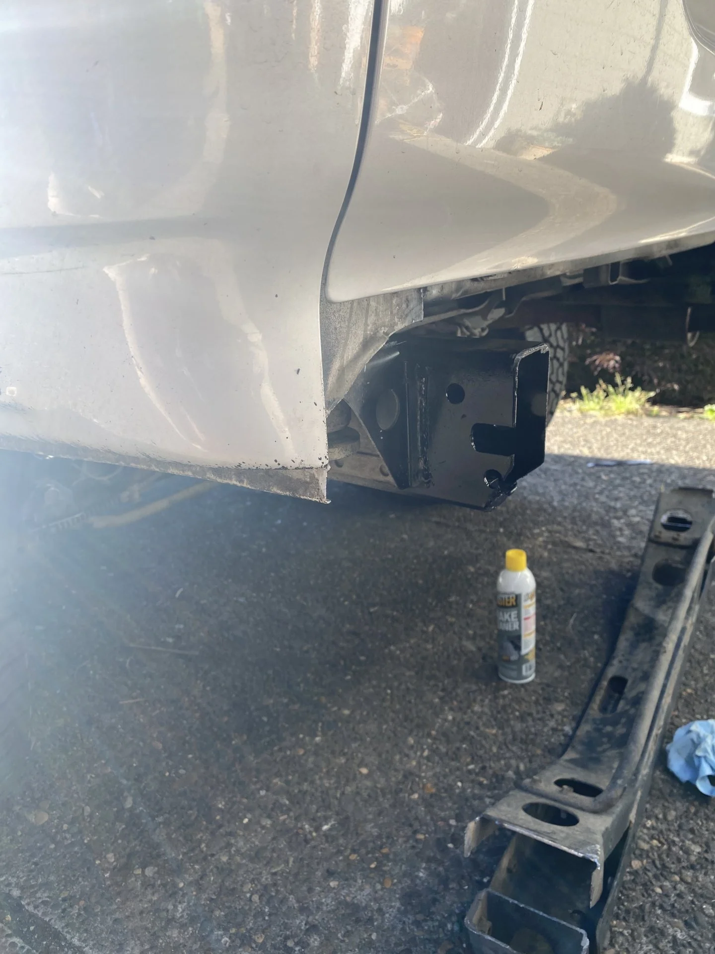

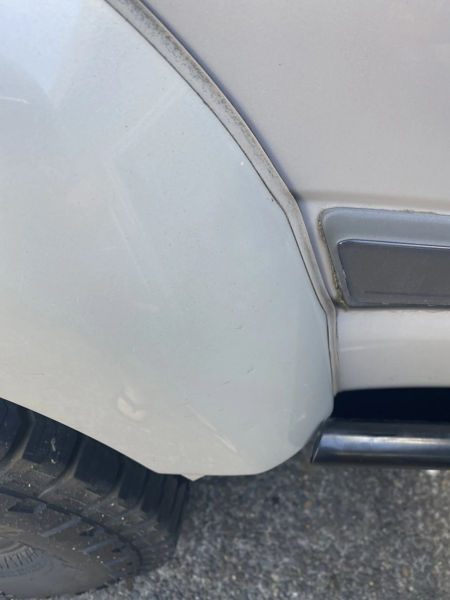

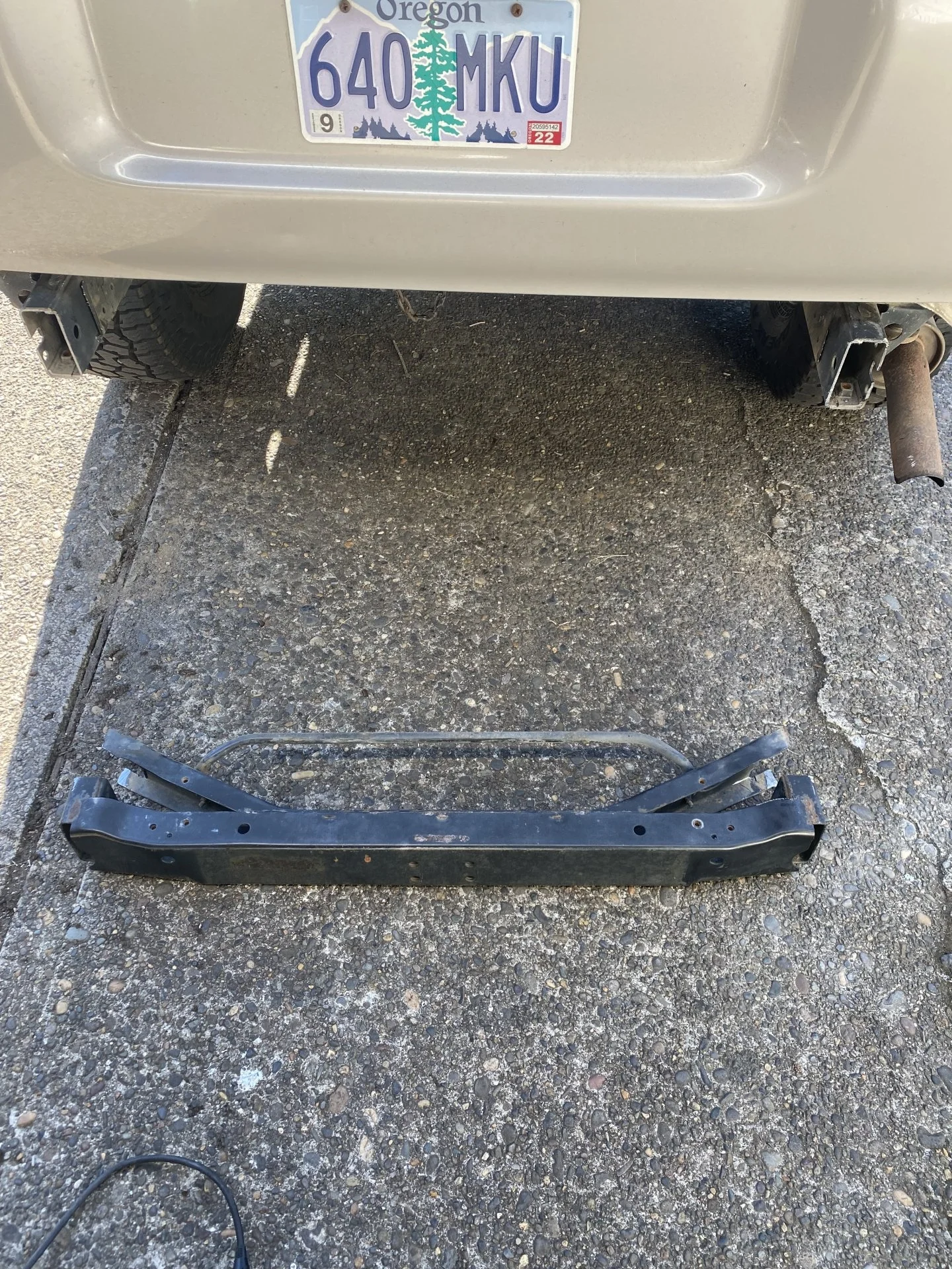

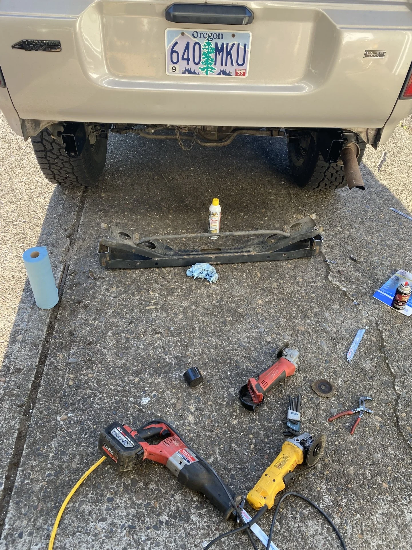

Went to mount @4x4labs bumper and the holes are not lining up on driver side? The wing is hitting my flares not allowing me to line up the holes? I guess I will have to step bit the holes out? And find a insert don’t want that thing moving around! Any advice?
