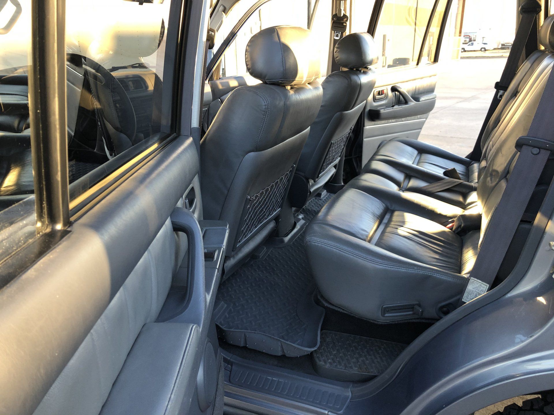

Decided to tackle the power seat gears on the drivers side today. I also have a clunk in the seat under acceleration and braking. Not a lot, just enough to be annoying. Did a search here and some pointed to the gears. I had ordered a full set from Gamiviti so figured I'd dig in and get it done.
First step was to wait for a break in the rain and yank the seat. Good opportunity to vacuum where the seat was.
On disassembly I find this little screw.
Somebody has serviced this chair before it appears. And low and behold, thank goodness I watched the Gamiviti youtube video and did the passenger seat first because whoever did the work forgot to put in the back washers. I might have missed that if I hadn't watched the video and done the other seat.
I grabbed one of the front washers and headed to the hardware store. An hour later I'm home and many of you are probably already ahead of me here. Yup, I forgot that the rear washer is slightly larger than the front washer. In fact, it's very precise to be able to fit over the splines but not over the main shaft in the back. I drilled out the washers I bought and installed it all and no more clunk. Going to be much better from here on out.

I received some seat 😍 from @Gamiviti. Okay, lets do this!
Now the drivers seat works great. WORD of wisdom - If your seats have been jacked up for a while, or you don't know the condition, I recommend ordering the WHOLE set of parts. Turn out the drivers seat took BOTH gears, so I'm sending Gamiviti more $$ to get additional gears for the passenger side. C'est la vie.

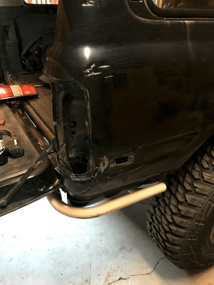

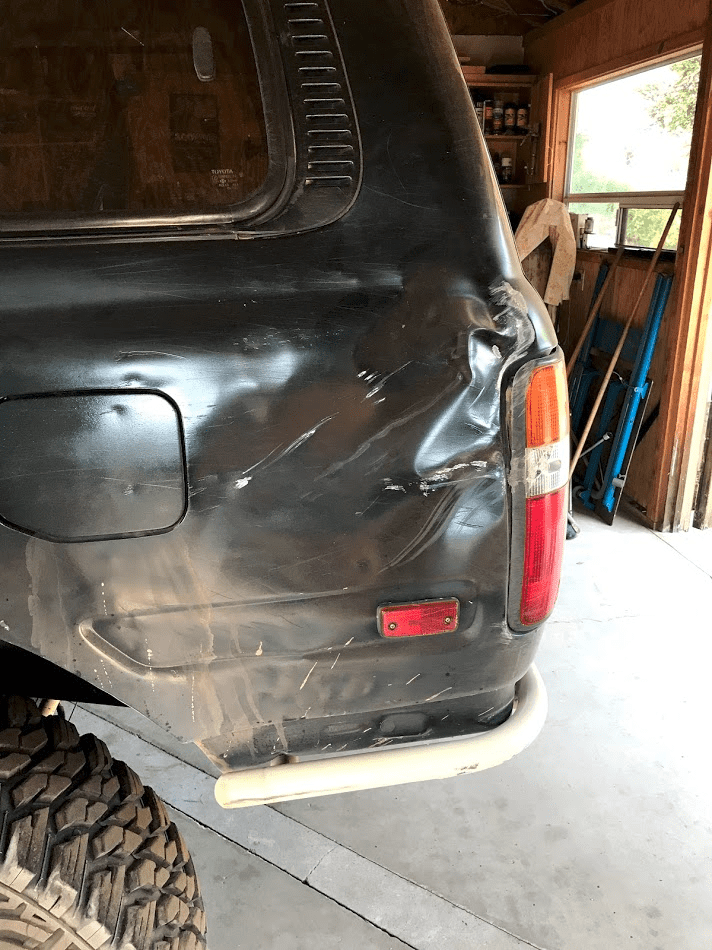

Started to bang out a years worth of wheeling dents. The hips on the fat lady are always getting in the way 🤷‍♂️
The dents are courtesy of the Rubicon,Coyote Lake, The Dusy Ershim, Sand hollow and Johnson Valley to name a few
No need to get it perfect it's a rock crawler, Just need to get it close enough for the new tail light to fit and shoot some color match paint on there. :rofl:
Started to bang out a years worth of wheeling dents. The hips on the fat lady are always getting in the way 🤷‍♂️ View attachment 2525230View attachment 2525231
The dents are courtesy of the Rubicon,Coyote Lake, The Dusy Ershim, Sand hollow and Johnson Valley to name a fewView attachment 2525240View attachment 2525241

No doubt, I made the bumper and I would like to add some side protection, at this point I am just tired of buying tail light.
But as you can see some of the damage is pretty hi up any protection that hi is just going to bend into the body anyhow 🤷‍♂️
I will be work on something soon, at least something to protect the lights. ( on my third set :bang: )
