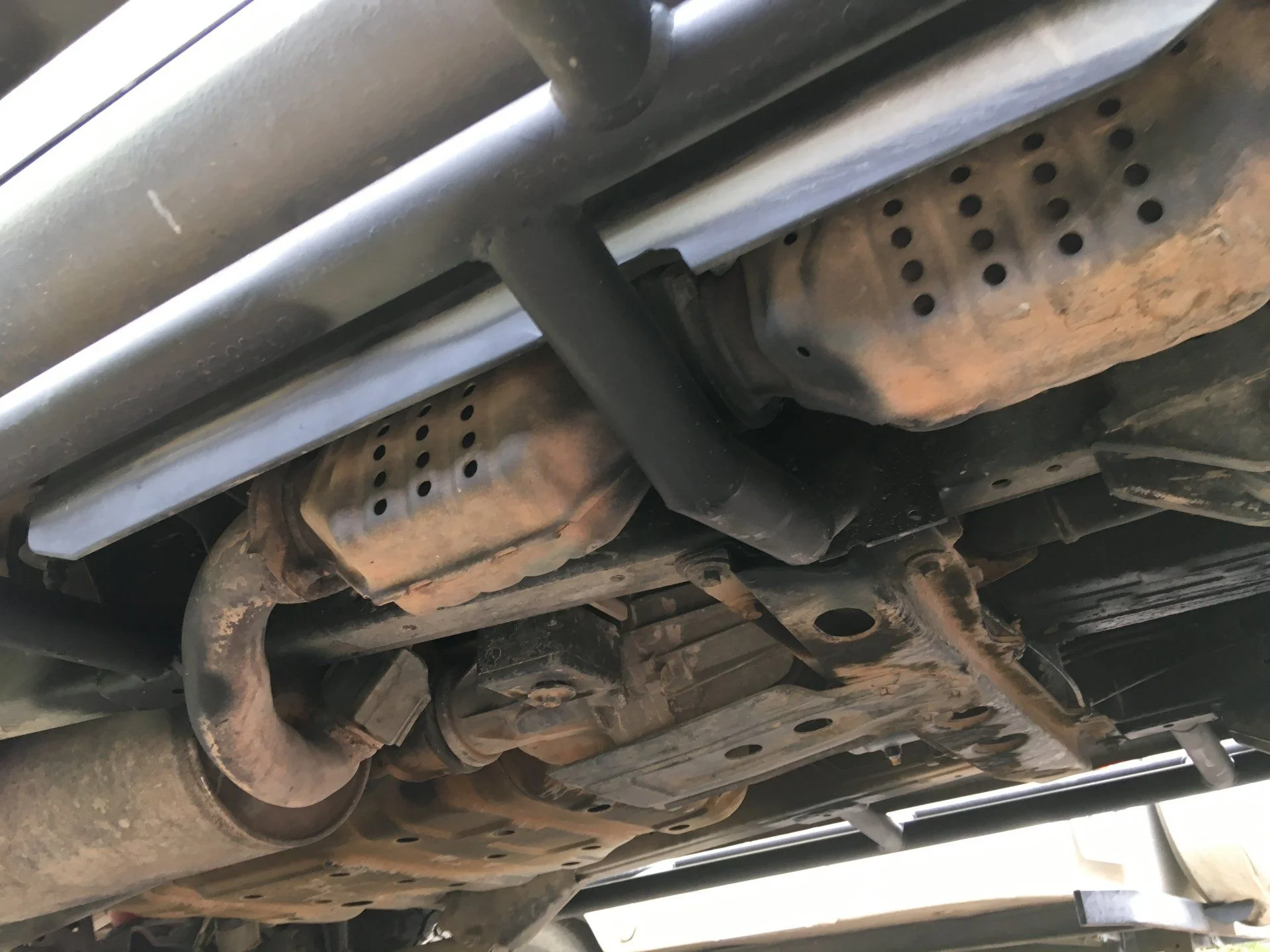

The LC, CO, and HC were too high.
I also have a 94 and failed smog with high HC, running rich. Not sure how to fix but oh well.
Check your basics first. You have extra fuel and poorly burnt fuel. Timing, plugs, wires , dizzy rotor and air filter. After that check for exhaust leaks pre-02 then also possibly a bad 02 then cat.
There are other possibilities like leaking injectors and such, but above will be the most common for you.
Thanks for the input , appreciate it!! I will look into some/all of those.

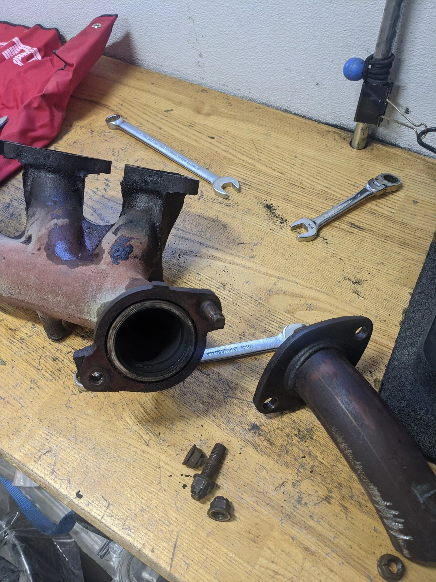

This looks horrifying :popcorn:
Just a moment from disaster, just one more strike from failure...not an ideal removal, but I'll take it...
This is on my list that I keep avoiding because I dont know anything about our exhaust.
