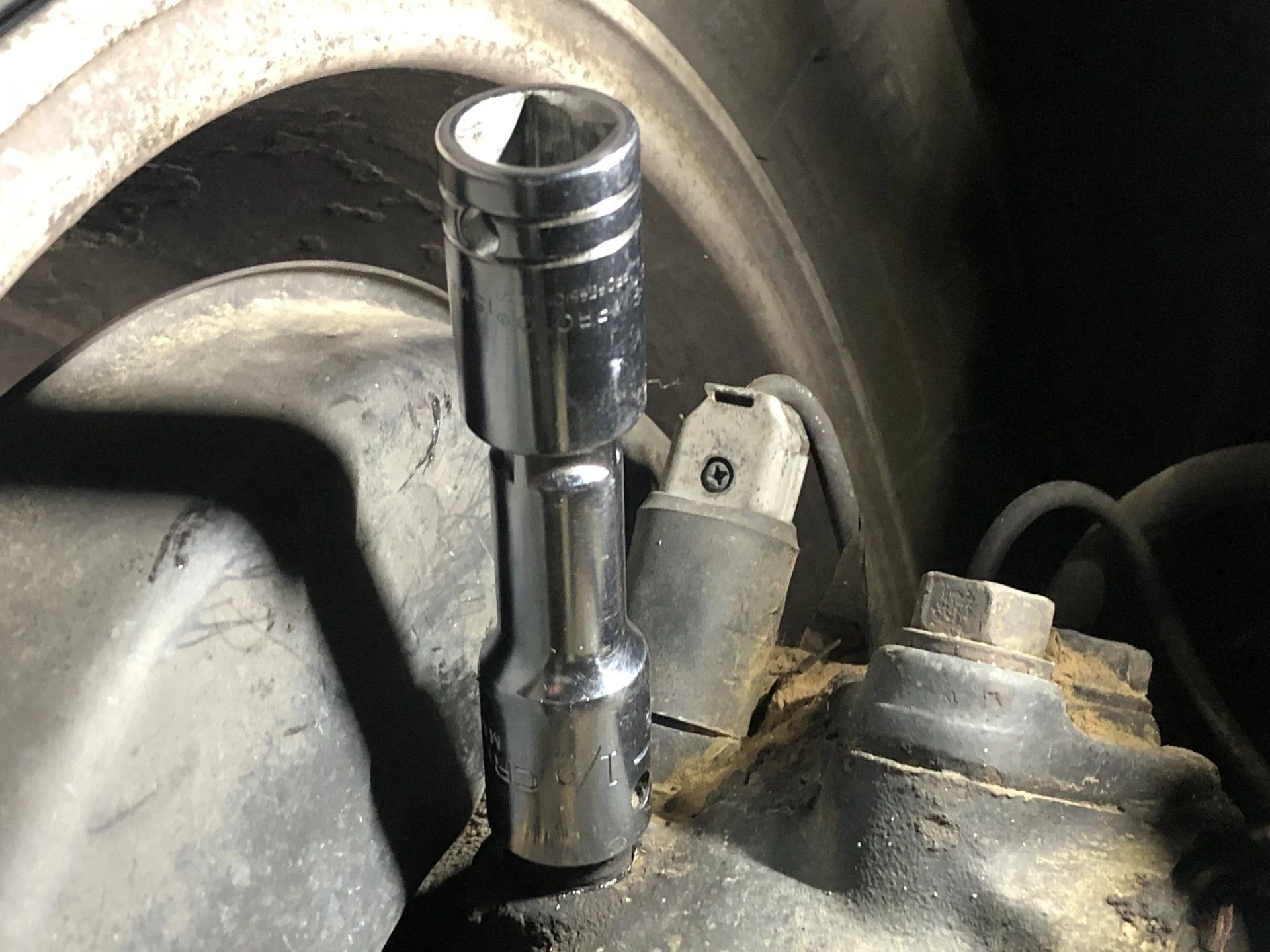

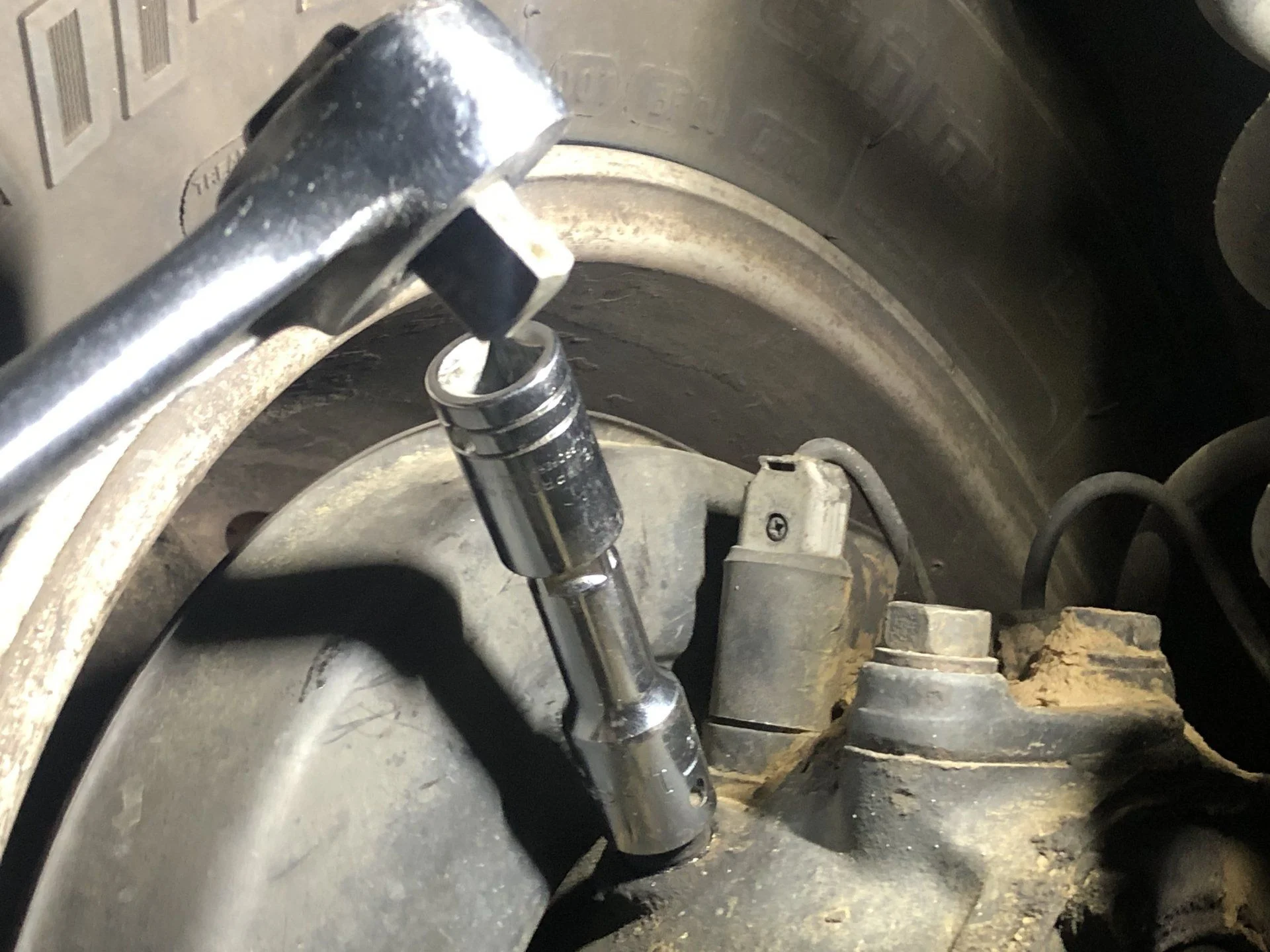

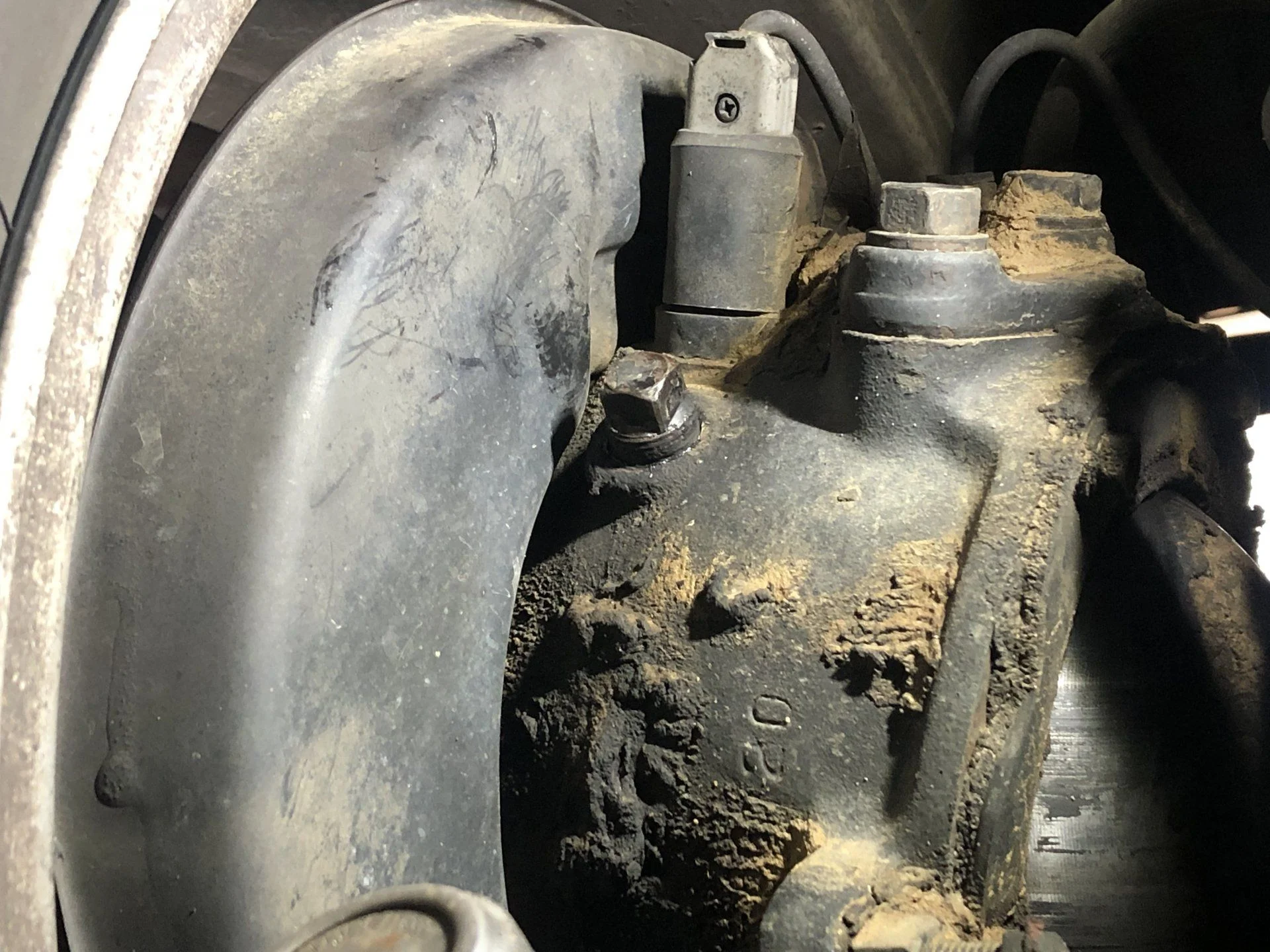

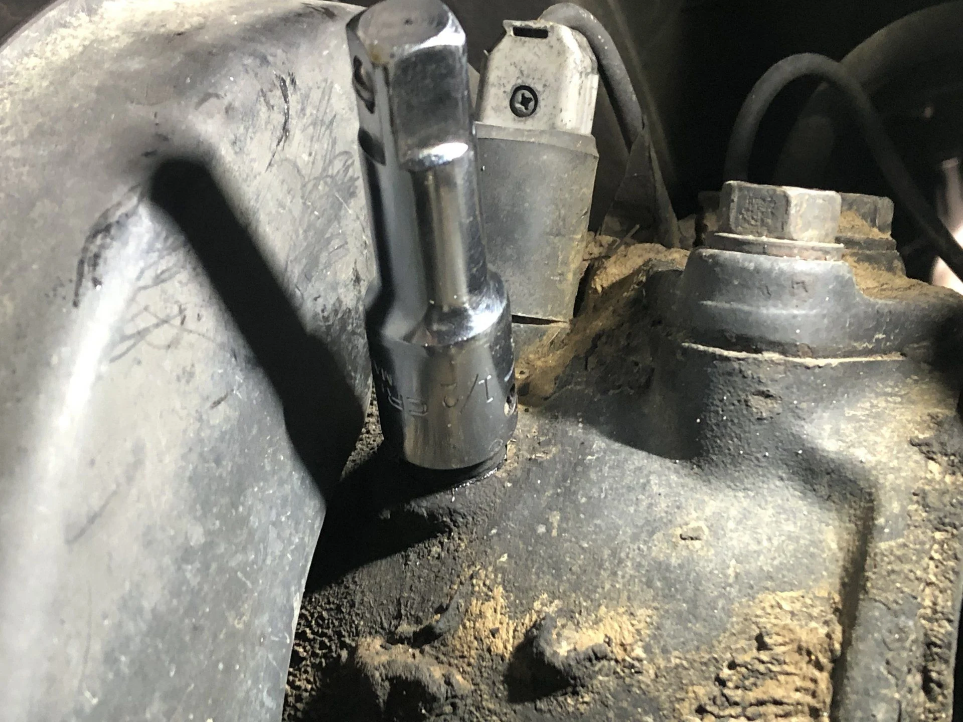

Added moly to the Birfs. Some of you may know this tip, some of the newer guys may not... I’ve seen threads asking what size bolt and socket to use on the Birf fill plug. The easiest way is to use a short 1/2” drive extension mounted with the square female end on the square Birf fill plug. Fits perfectly. Then a 15mm socket on the male end of the extension. Use your ratchet/socket wrench to loosen/tighten the Birf fill plug. See photos.
GENIUS!

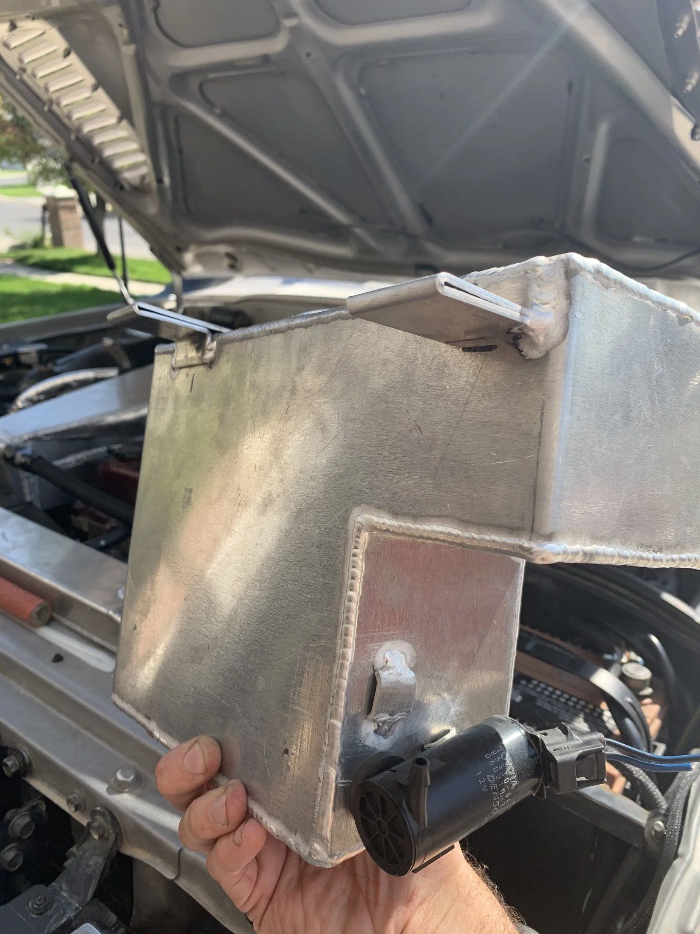

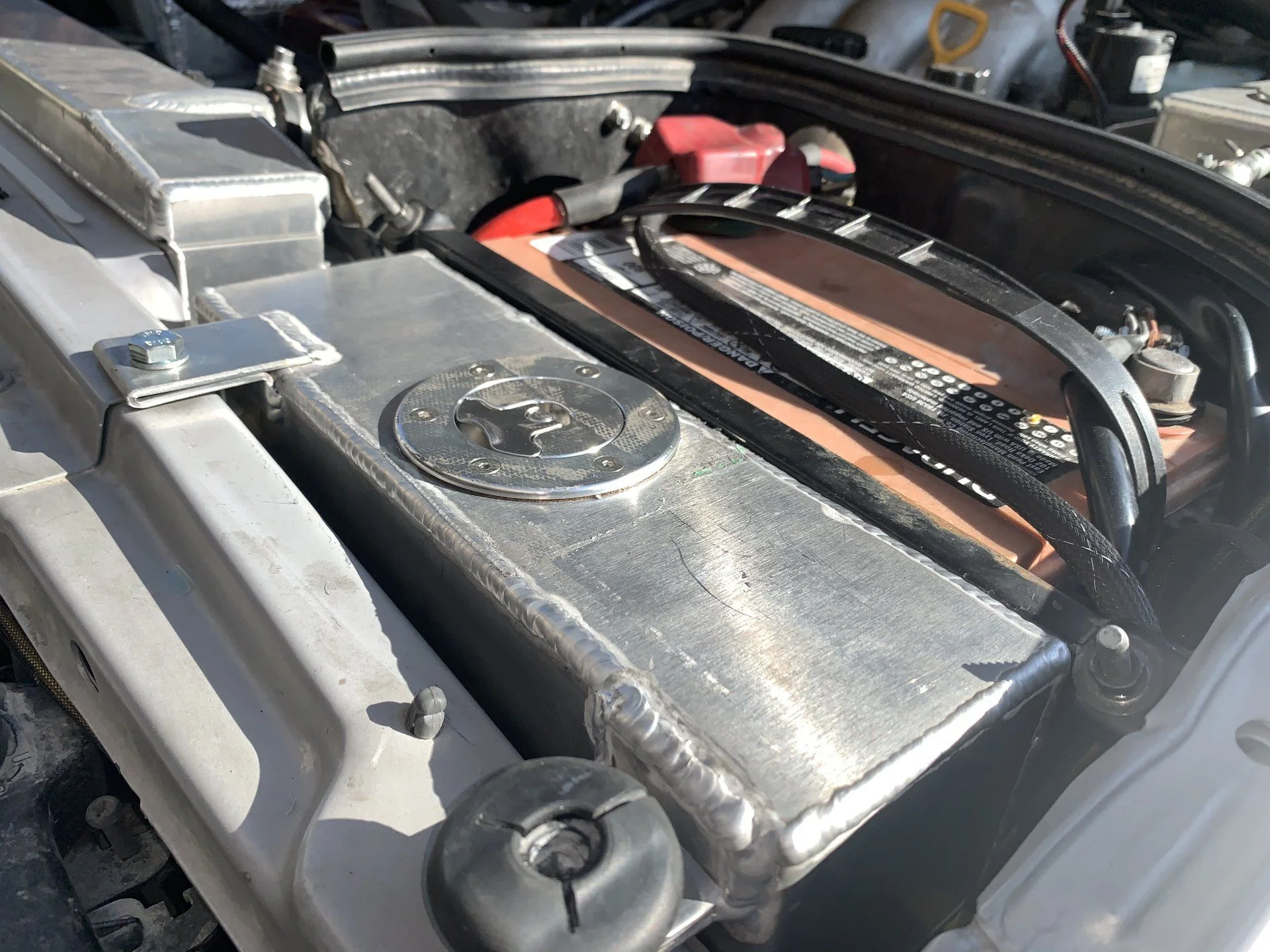

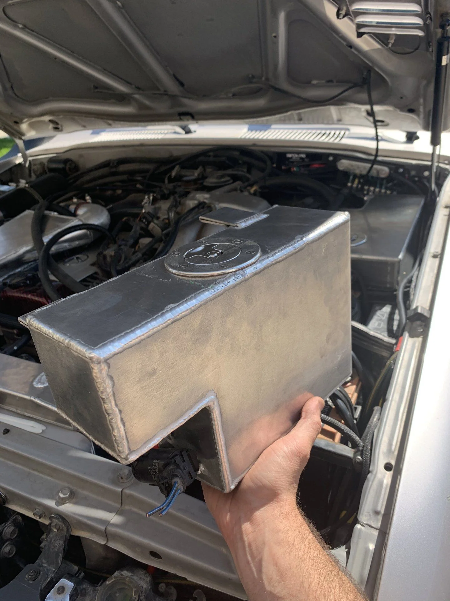

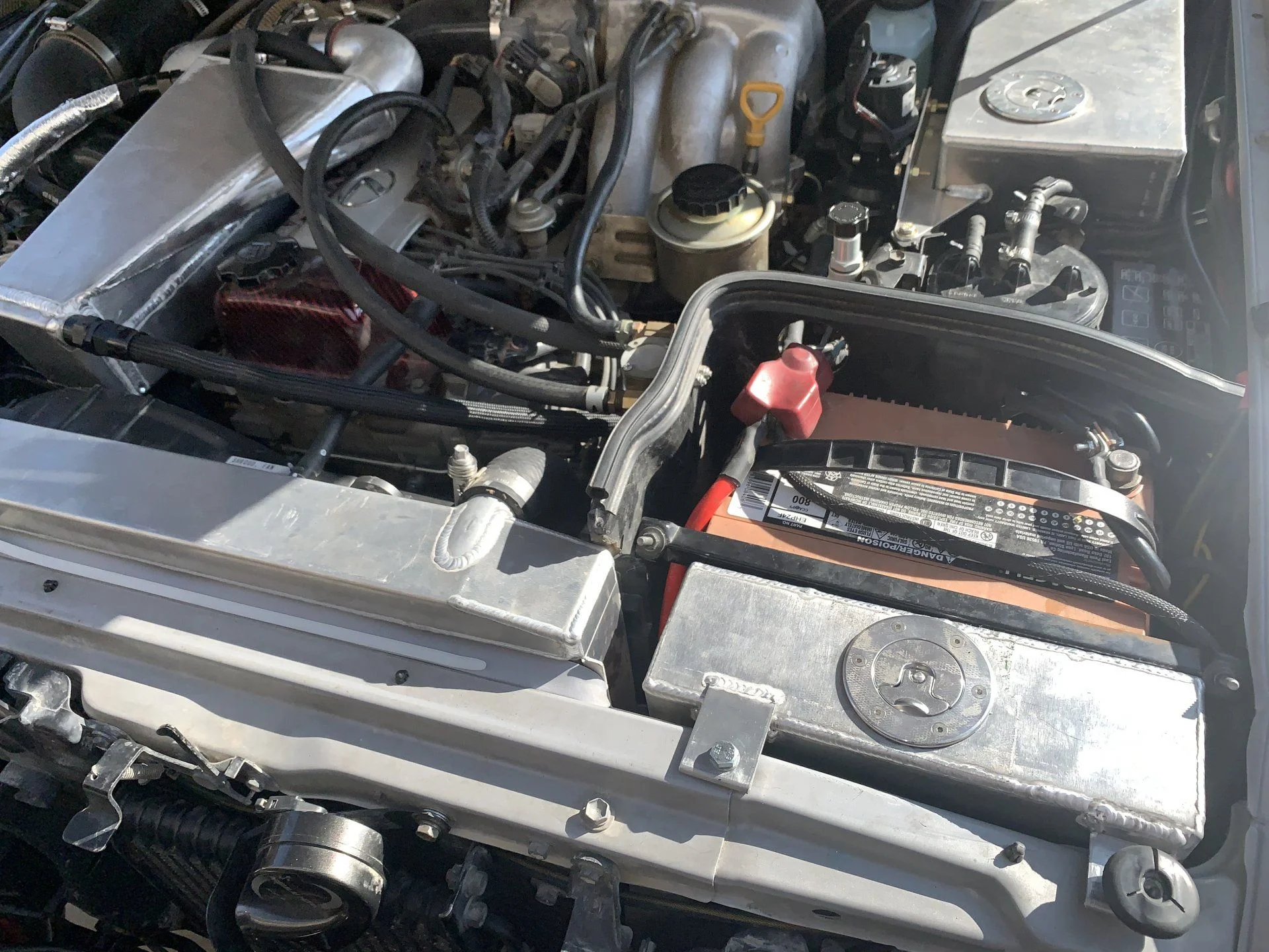

Made a thing. Now I can wash my windshields again.
There is officially no room left under my hood for any more activities.
