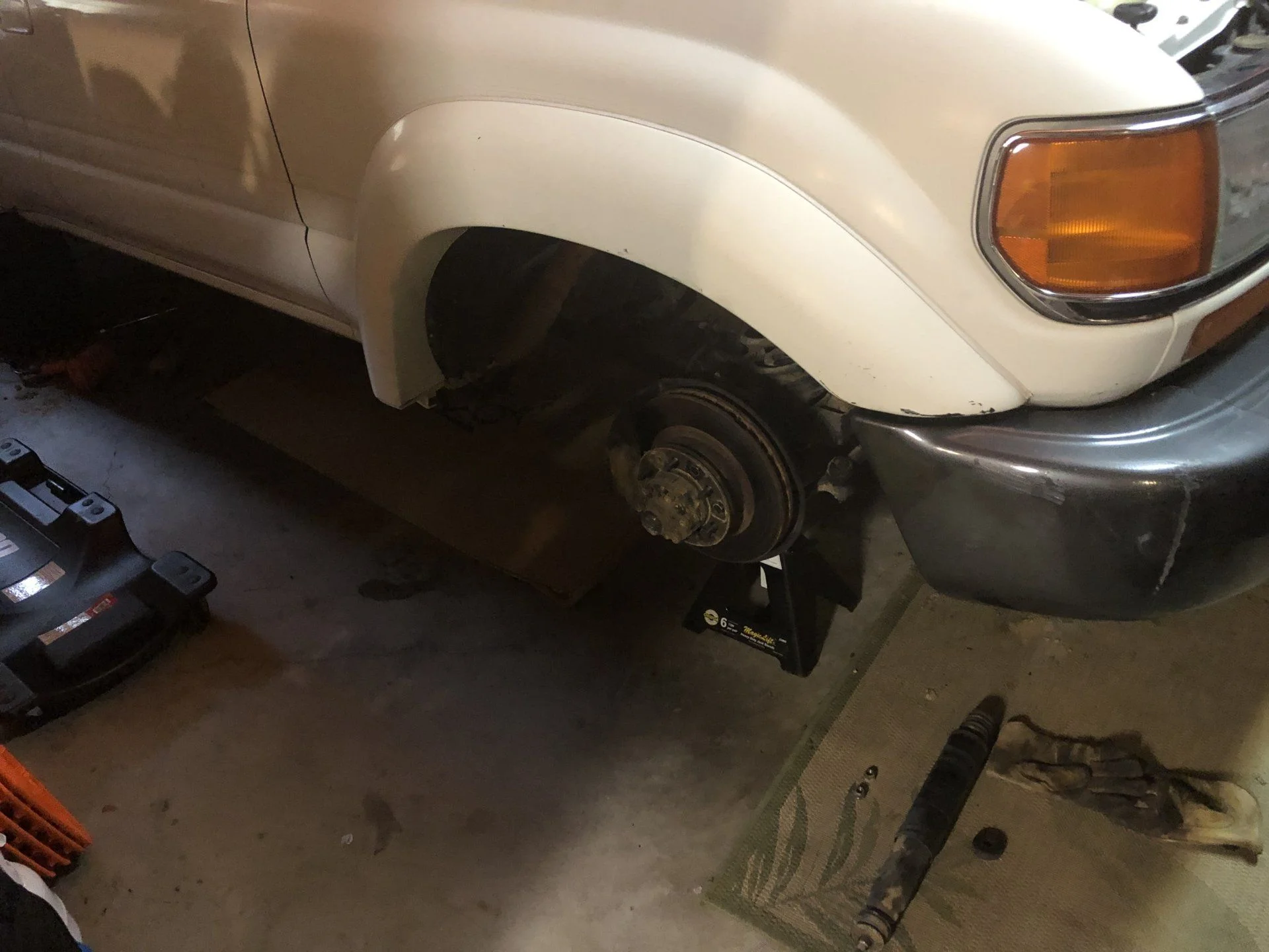

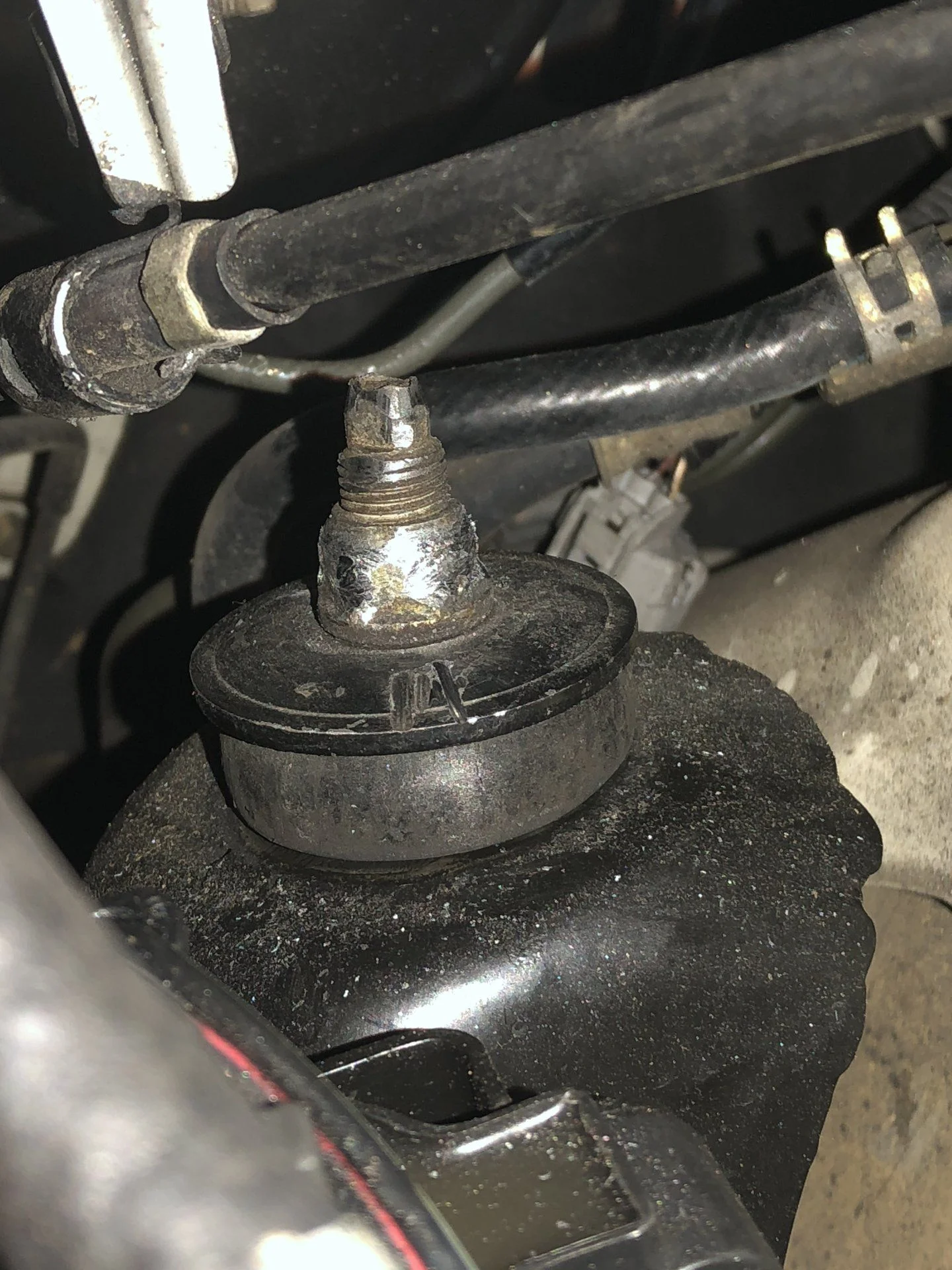

New OEM shocks going on Tallulah. I’ve tried everything on the front left top shock nut; PB blaster, swivel and long extension, Dremel cutting wheel, nut splitter, impact wrench, holding bottom of shock with channel lock pliers and strap wrench. The other three shocks came off with zero issues, so I’ll just have my local Cruiser shop do the one shock and be done with it. :bang:
You overlooked the Sawzall bud! Using a metal blade just cut right through the rubber and metal shaft. They come right out. Unless your trying to save the shock for another project? I’ve used a big vise grip or channel lock before to hold them tight if that’s the case.
Dangit! You’re right. And I HAVE a sawzall. Look out shock, you’re coming out tomorrow! Thanks!
EDIT: I just went back and looked, and there really isn’t any room to get a sawz all in there because it’s surrounded by too many other things.
Theres always the good.ol fashioned hack saw. Blade out with a gloved hand if you must.

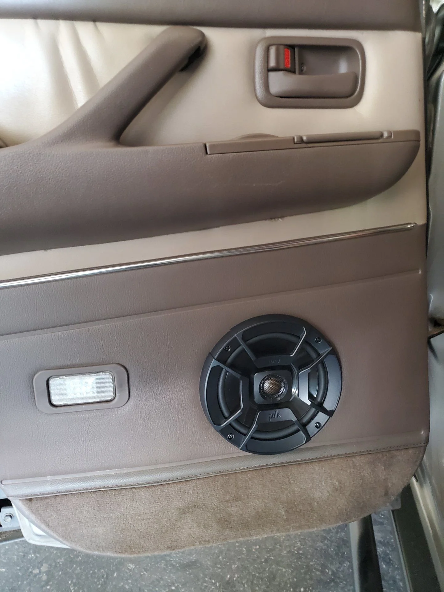

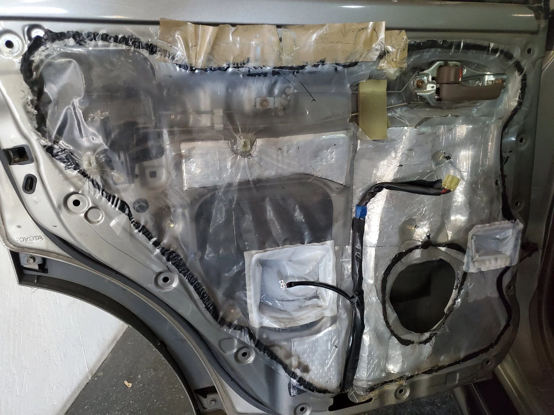

Wrapped up the rear doors today. Original plastic back on, speaker holes enlarged, Polk DB652's in and sound awesome.
