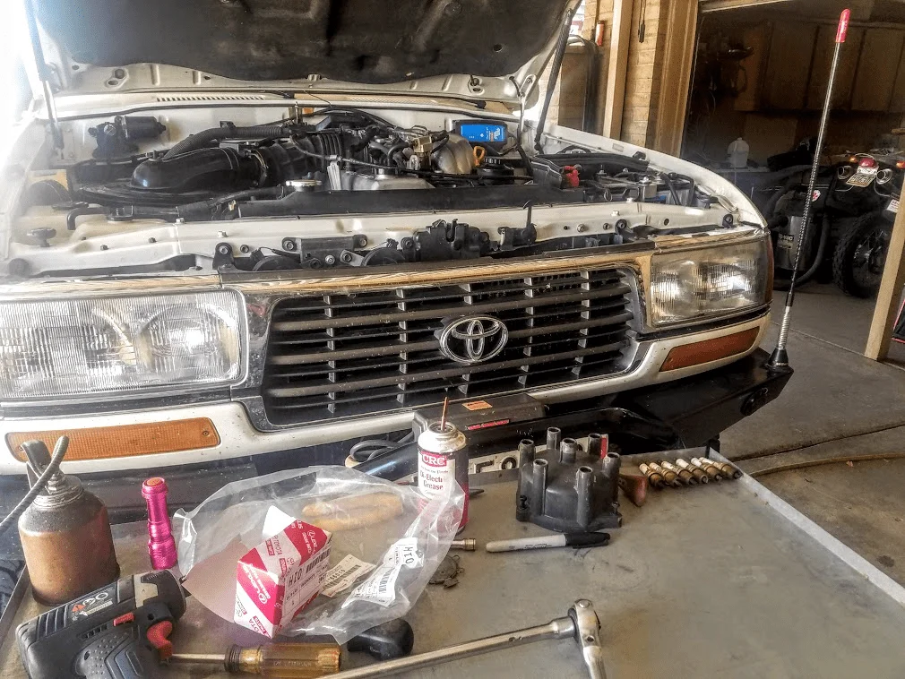

Mini tune up after 75K......sounds and runs the same :meh: everything looked normal.

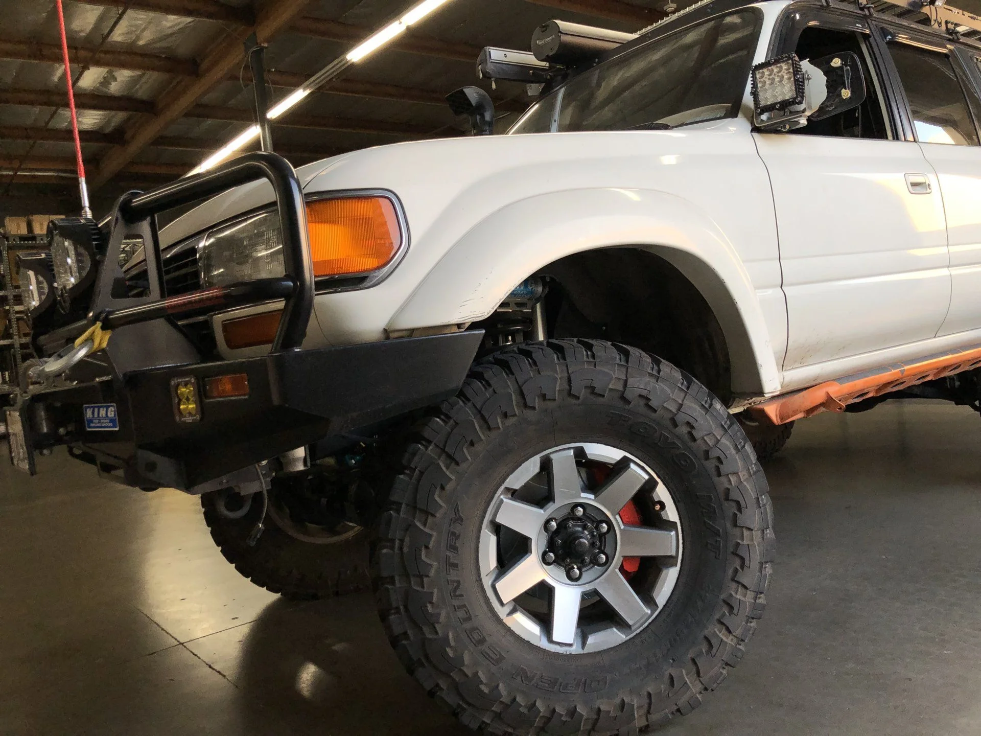

Decided it was time for rock lights. Did a portion of the Rubicon in the middle of the night and that was no fun with just headlights. Had to get out with a flashlight a few times to see where I was going as I couldn't even tell where I was putting a tire.
So I'm installing a mix of various LED light pods and actual small rock lights. And it will absolutely be complete and utter overkill by the time I'm done. I won't even need shop lights anymore when I work under the truck.

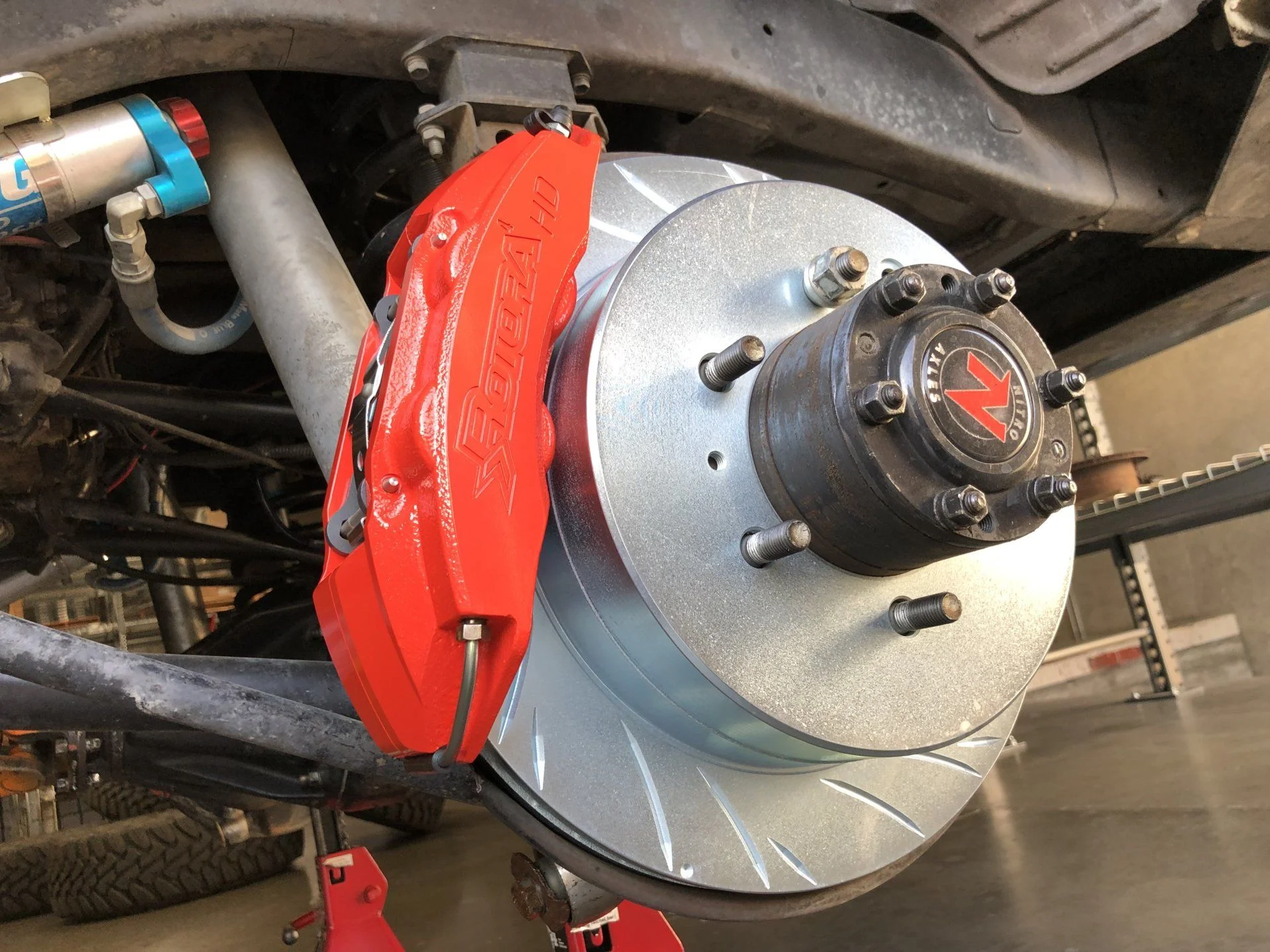

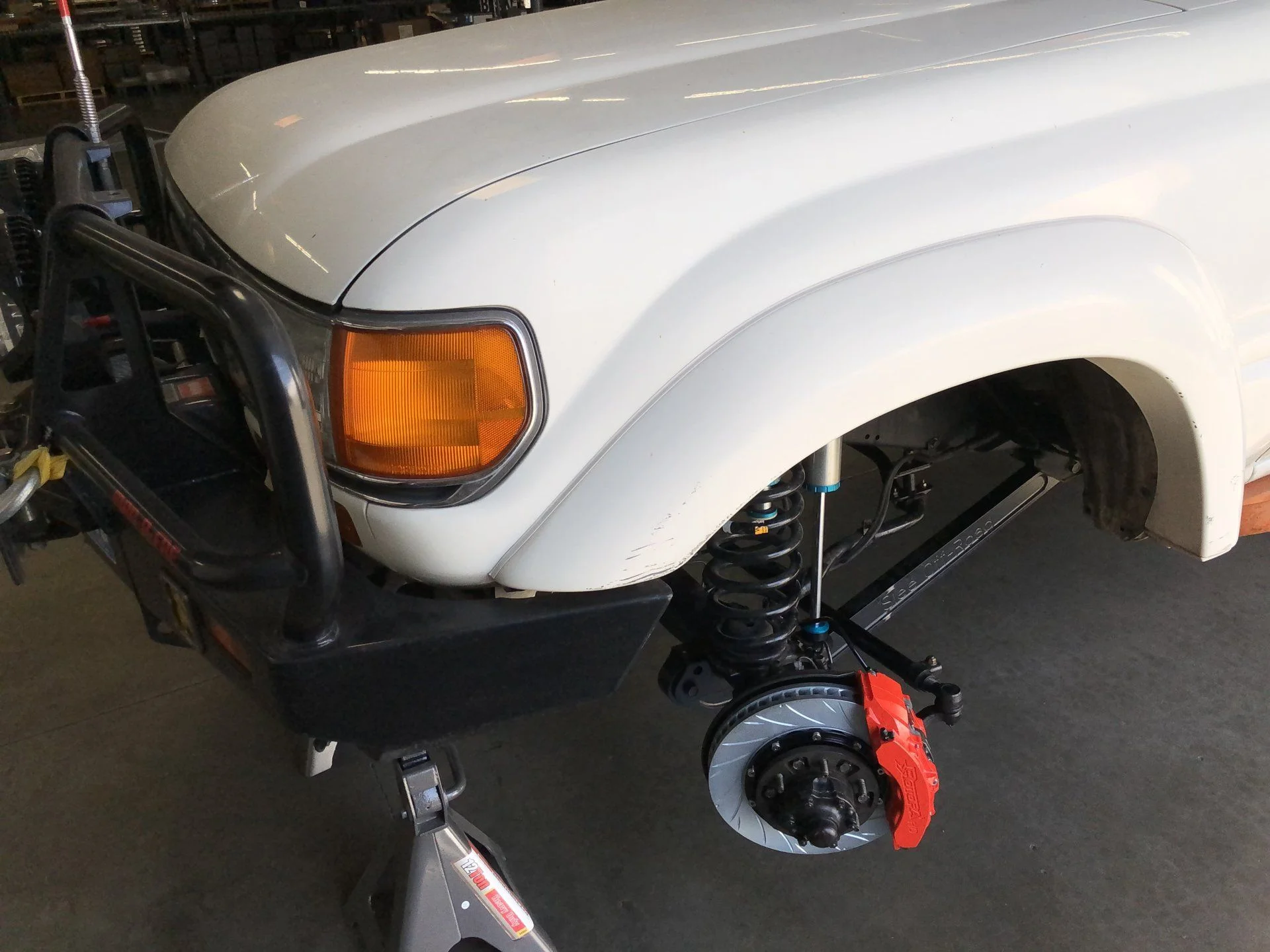

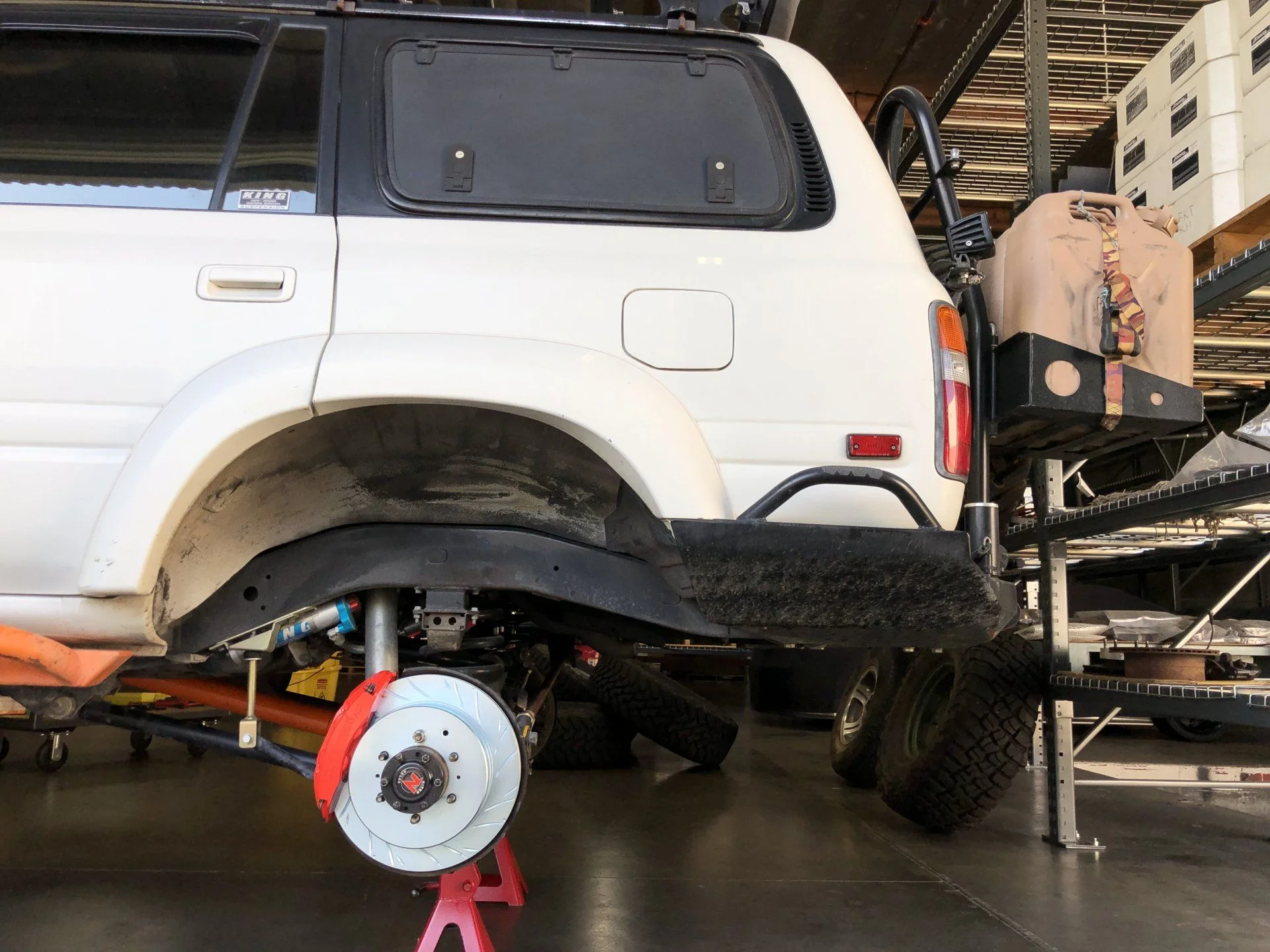

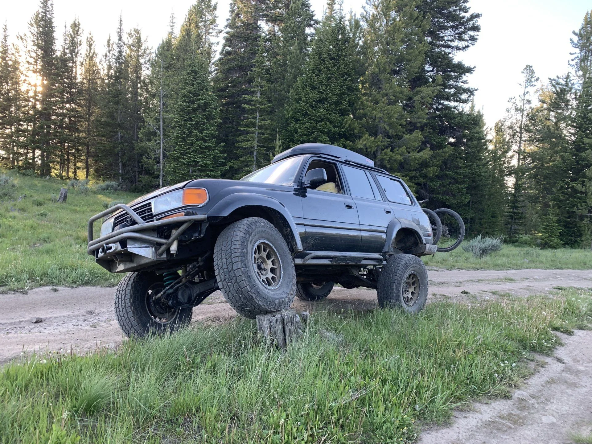

So after Doing ALL new braking system OEM calipers,pads Booster/master cyclinder and EBC rotors AND new hyperflex arms from Superior, new front ring and pinion and all new bearings/races front/rear diffs.
I took the truck for a test drive to viriginia down to the overland expo east.
1900 miles total after breaking in ring and pinion first. and about 100 miles off road.
still has a slight vibe at 62-66 MPH from front DC DS
BUT she stops, never ever has this truck even pretended it was going to stop, just because you hit the brake pedal. Now it does. So thats awesome.
The new cerullo performance seats are scheelman level serious, but made in Merica, super comfortable and you can sleep in them.
my 100AH Relion Lithium charged by BOTH my 150AMP sequoia alternator via redarc BCDC1225 and merlin 140watt solar failed to keep up with a 65L dometic running all night, yea that happened, not sure WTF but Ill find out.
Long story short my first time ever rebuilding diffs, ring and pinion etc worked. new OEM brakes sans ABS and LSPV all worked.
hyperflex arms worked out even at 80MPH on highway, but I still think its the genesis of the vibration as it allows pinion angle to move slightly.
Tested breakage strength of the @LandCruiserPhil quik disconnects and they passed, by a lot.
that is all.

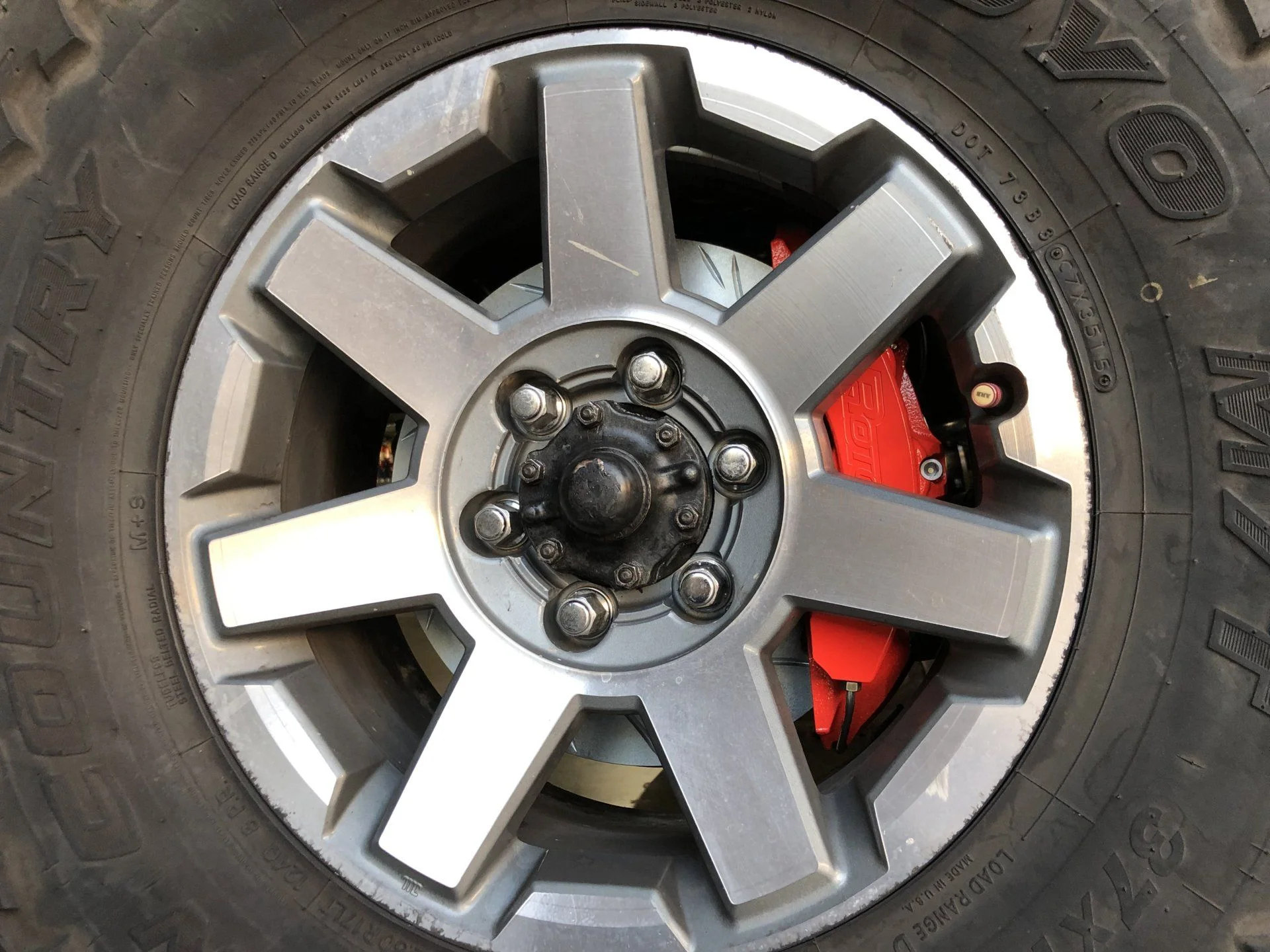

Where did you purchase this and what part numbers are they?
Did you cut the front brake shields?
Do they fit behind the wheels without a spacer?
Ok so they aren’t a big brake set. Thanks!
Was it plug and play?
Where did you order from? It’s difficult to put a set
Together on my own.
Nothing exceeds like excess. Looks serious. And Im not surprised.
