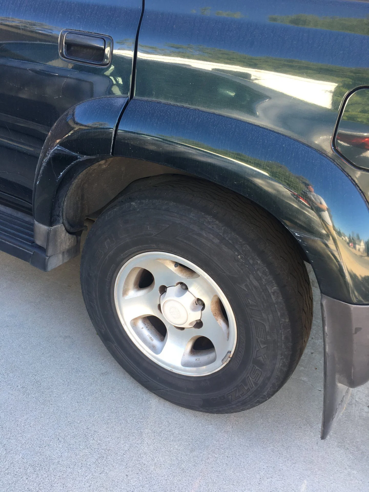

Tires: over 2 years old and cracking (new ones one the way)

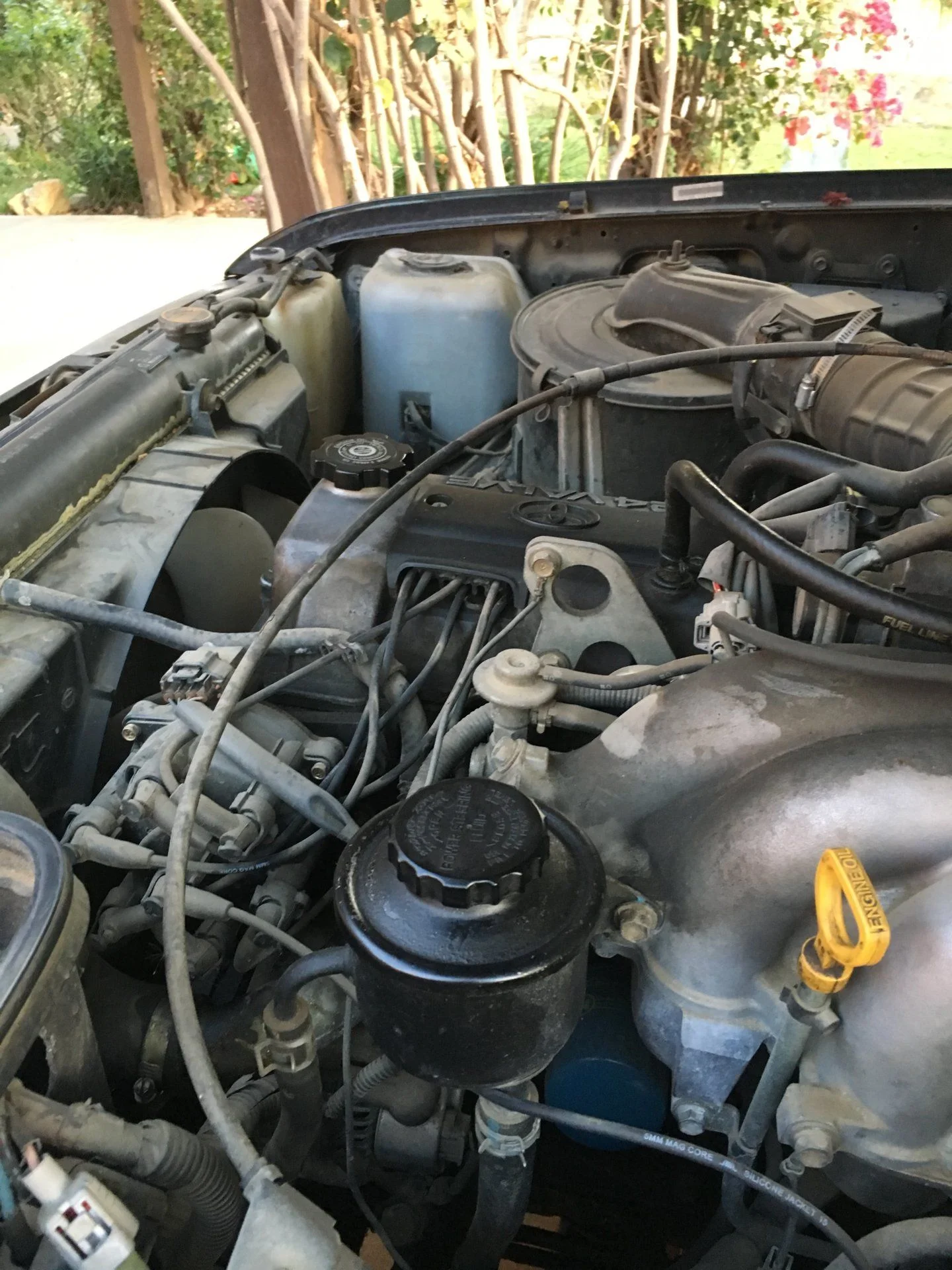

Radiator: some leakage around the top

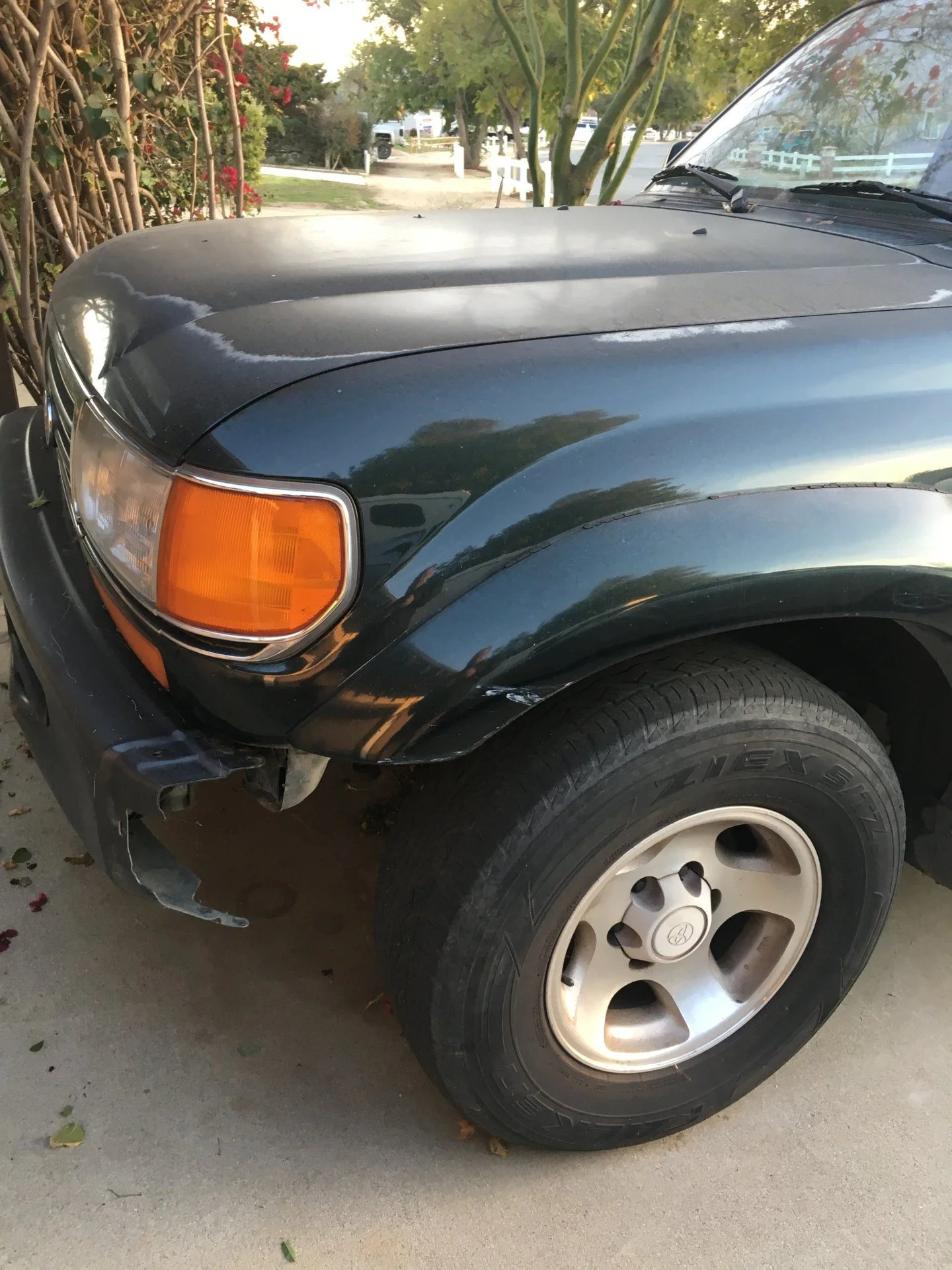

Front Bumper - damage from reckless driving habits

Any thoughts on next steps with the seats? Radiator? Air Conditioning?

Radiator, seats, AC in that order.
If you are going to do the radiator and possibly swap out the AC compressor you may as well leave the truck down for now and do a full front PM rather than taking it back apart later.
Just my .02 and the green ones NEVER die.
Radiator
Radiator Hoses
All top of motor hoses
Plugs
Wires
Rotor
Dizzy gasket (internal o-ring)
Dizzy cover gasket
Oil pump gasket
Front main seal
AC compressor
AC Drier
9011 Headlight Mod
Clean tuna can
Clean or replace air filter
New belts
Fan clutch?
Then once it's all back together you can leave that entire area untouched for a while and it should run cool and leak free with functional AC once charged.

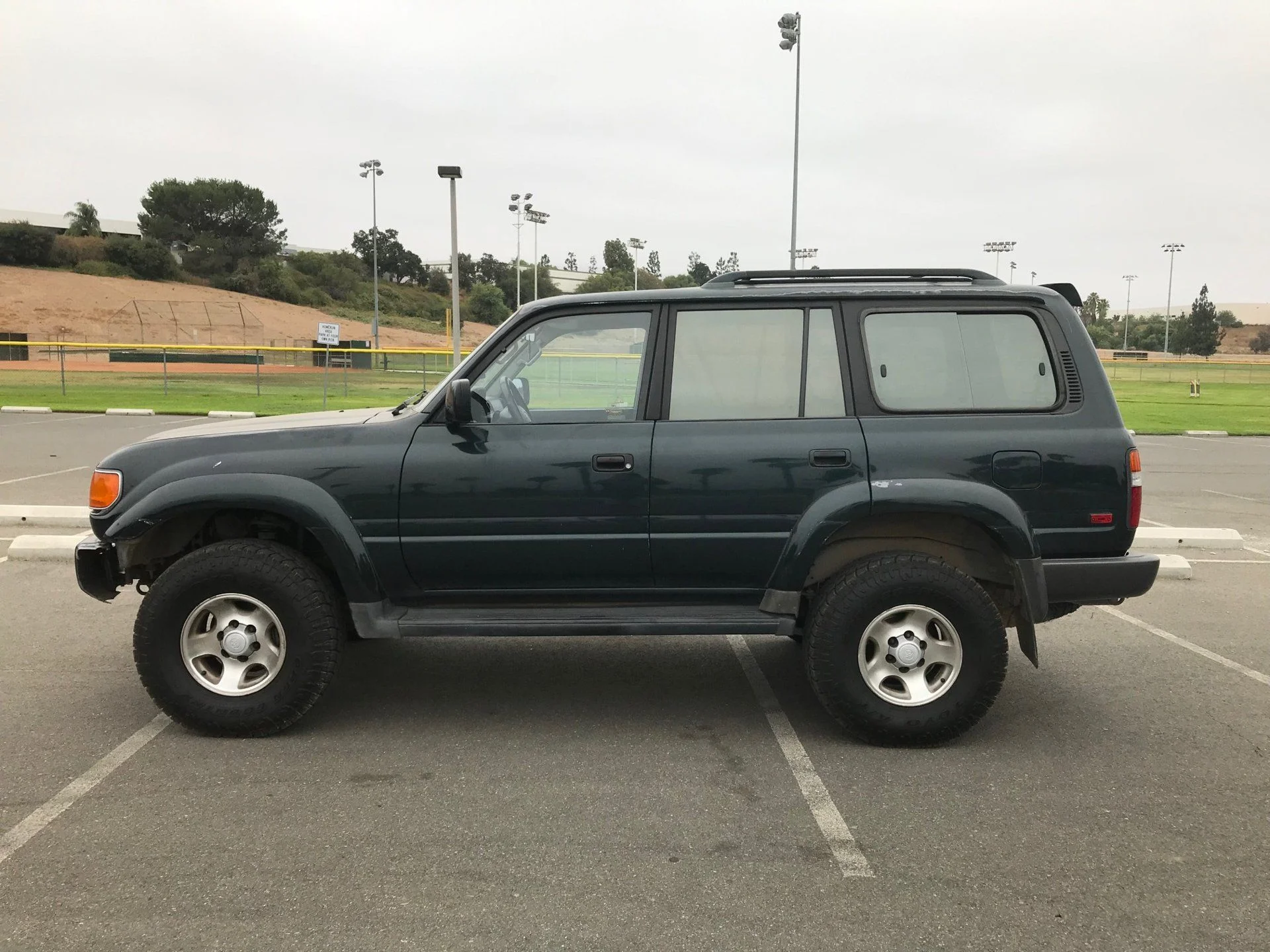

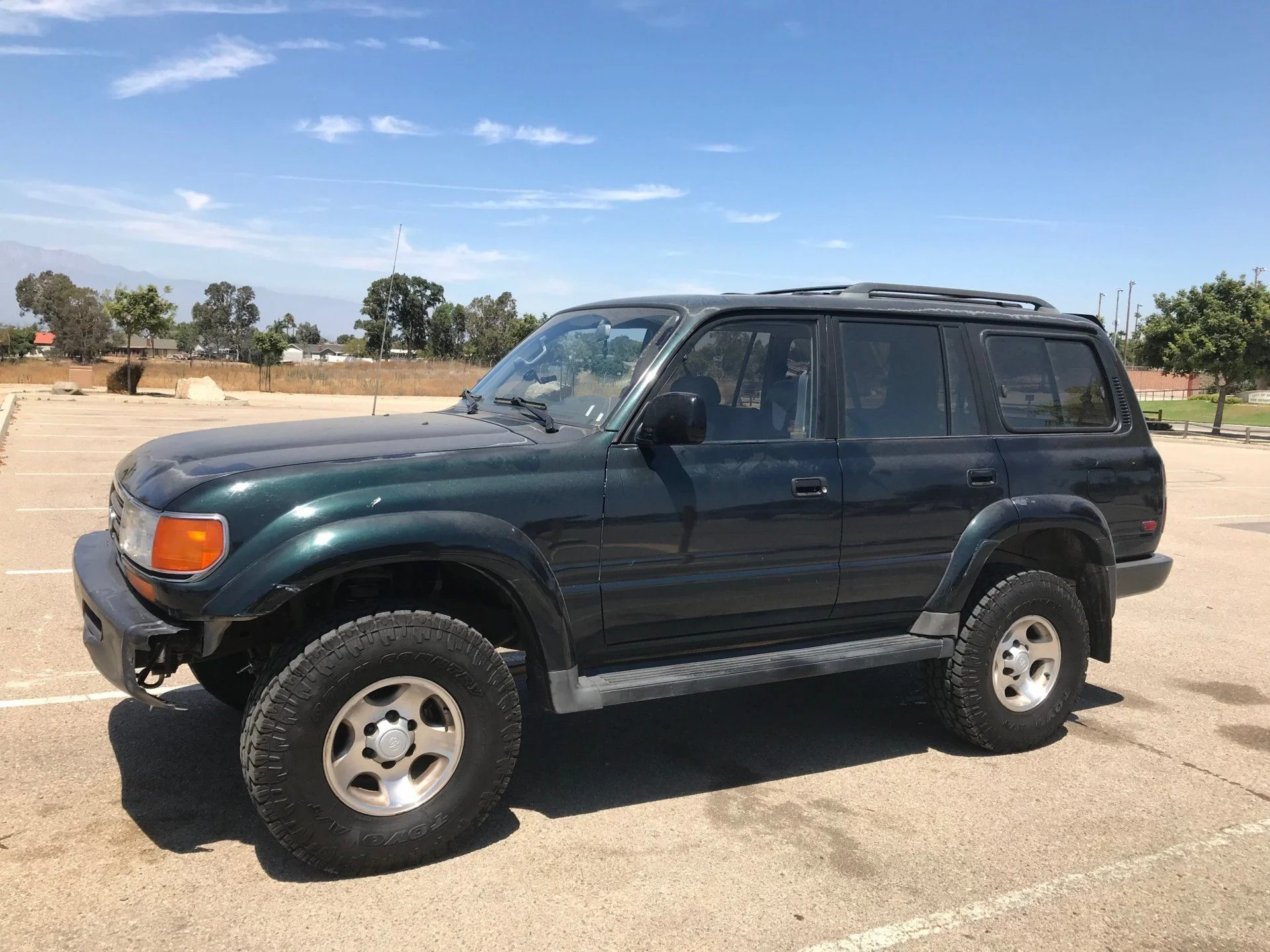

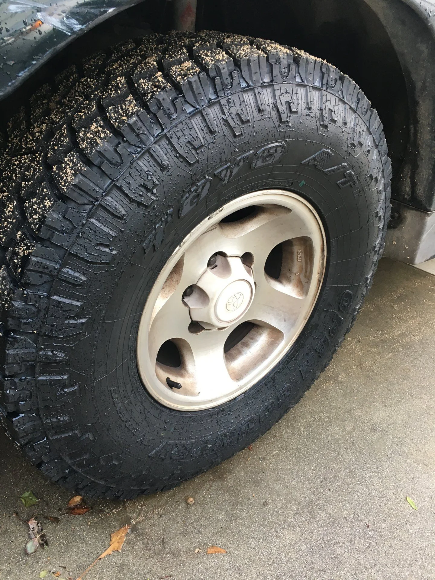

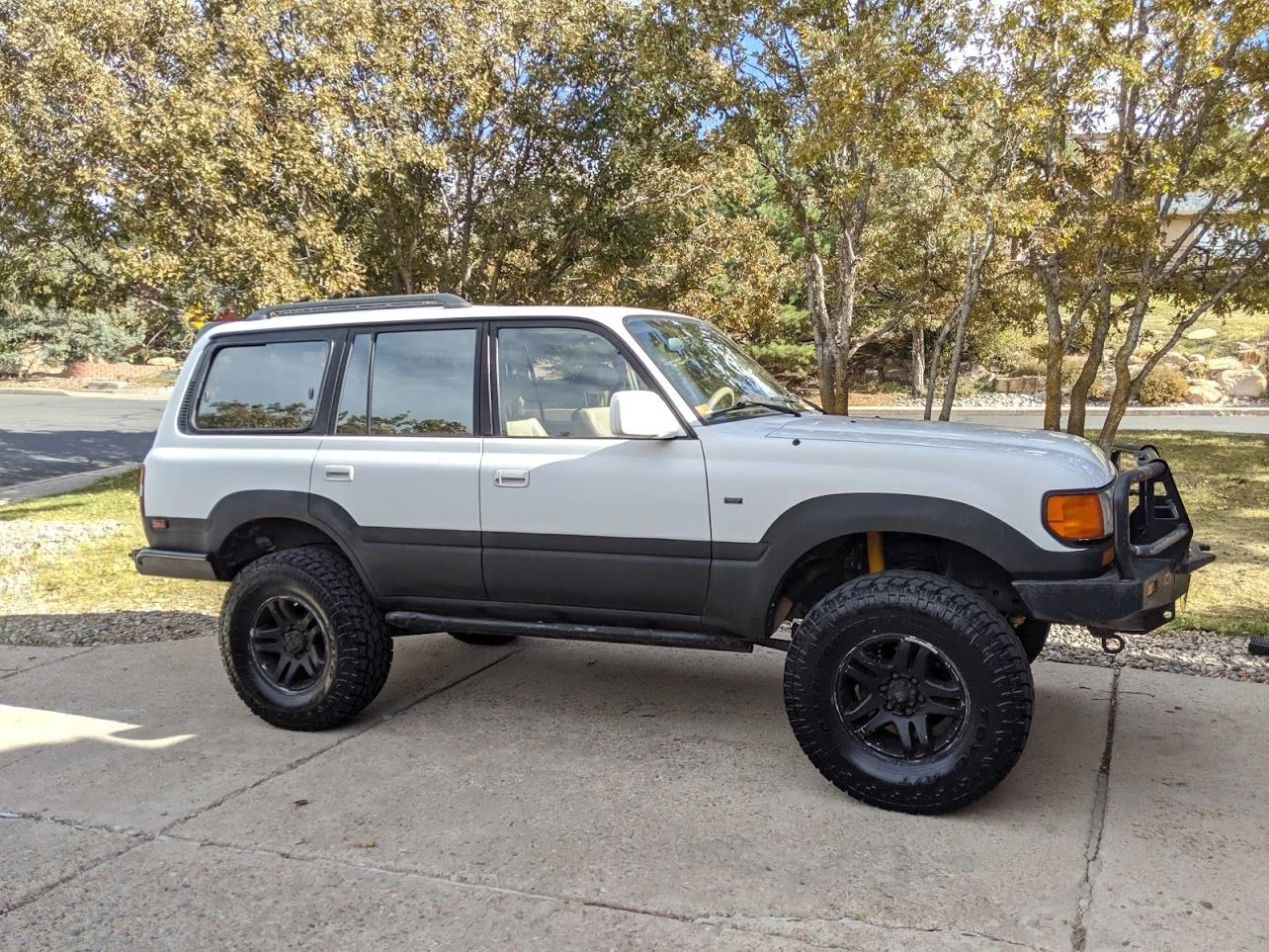

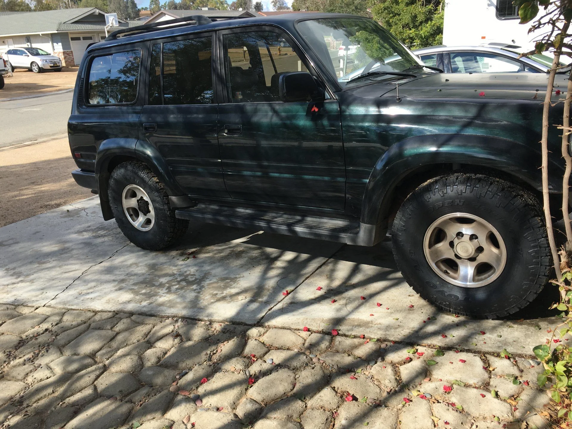

I got my new tires! We are prepared for the next steps. Thanks, Tony @ “The Shop” on State Colege in Anaheim for hooking me up. These are the Toyo 295/75/16 tires on a 100% original (180,000) suspension. No lift or other mods. The spare tire (barely) fits in the standard under mount location.
Aug 2019:
3 1/2" "J" OME shocks and springs
Looks good! I just put those exact tires on my truck yesterday. How are you liking them? Are they wearing well?View attachment 2110495
I totally love them. We have had them on road and freeway (at roughly 32psi) and on mud and rock (roughly 18 psi). Smooth sailing so far. When they were installed, they were inflated up to about 40psi and when I did the chalk test, it revealed that 32 psi is the winner for road driving. When I wear them out, I might just check out the 315 M/T because I can fit them everywhere except the spare tire location. I did the calculations (using Waze) and they screw up the speedometer by about 9%. No problems with rubbing or road noise.

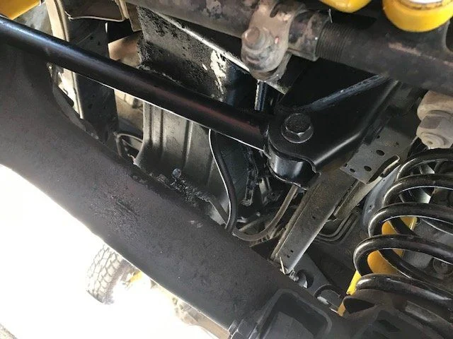

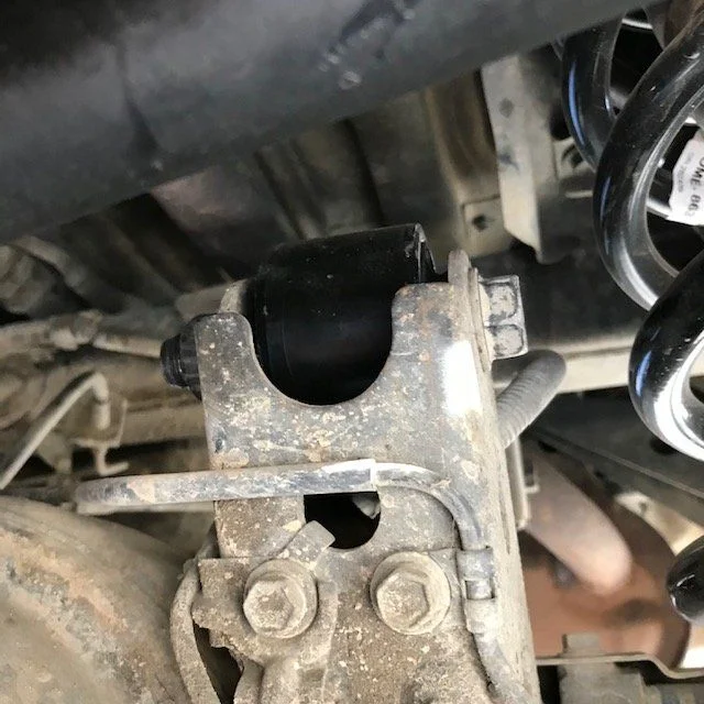

Bushings control arms....
