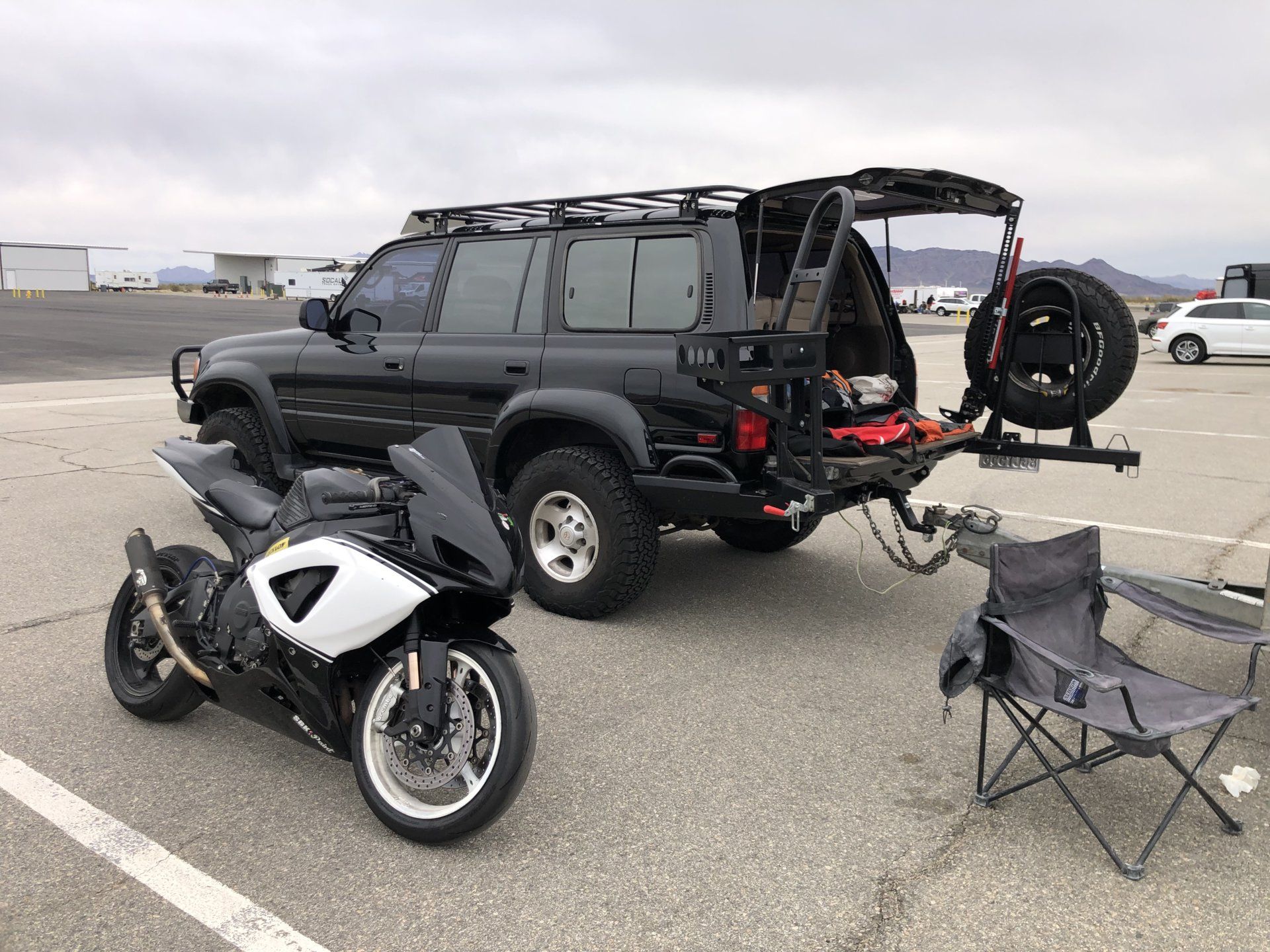

very nice rig. what size wheels are those and offset? Do you have any rubbing issues with those on full flex?
35” Wrangler MT/R’s 15 x 10 Procomp steelies, only rub so far was the mud flaps. About 5 min with a sledge hammer fixed that though. I haven’t had a chance to run it through full range of motion.
I am heading up to the mountain this weekend and will try and get a full flex pic...
15x10? Jealous!!! 16x10s here.
Just because I’m probably not the only one wondering, what’s the offset or backspacing number for those wheels?
Thanks for asking! This is straight from the ProComp website...
  • Wheel Size: 15x10
  • Bolt Pattern: 6 on 5.5
  • Backspace: 3.75
  • Finish: Flat Black
  • Center Caps and Lug Nuts Not Included
  • Replacement Center Cap Part Number: PXA1425017
Hope this helps

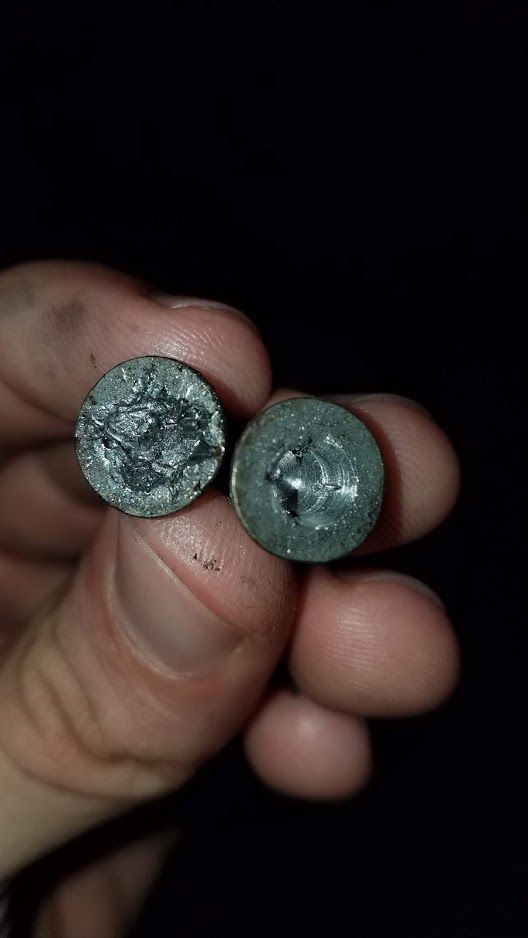

I stripped 2 screws on the oil pump cover and they were kinda a pain in the a$$ to get out but eventually did. Thankfully didn't screw up the threads. Pun intended.
