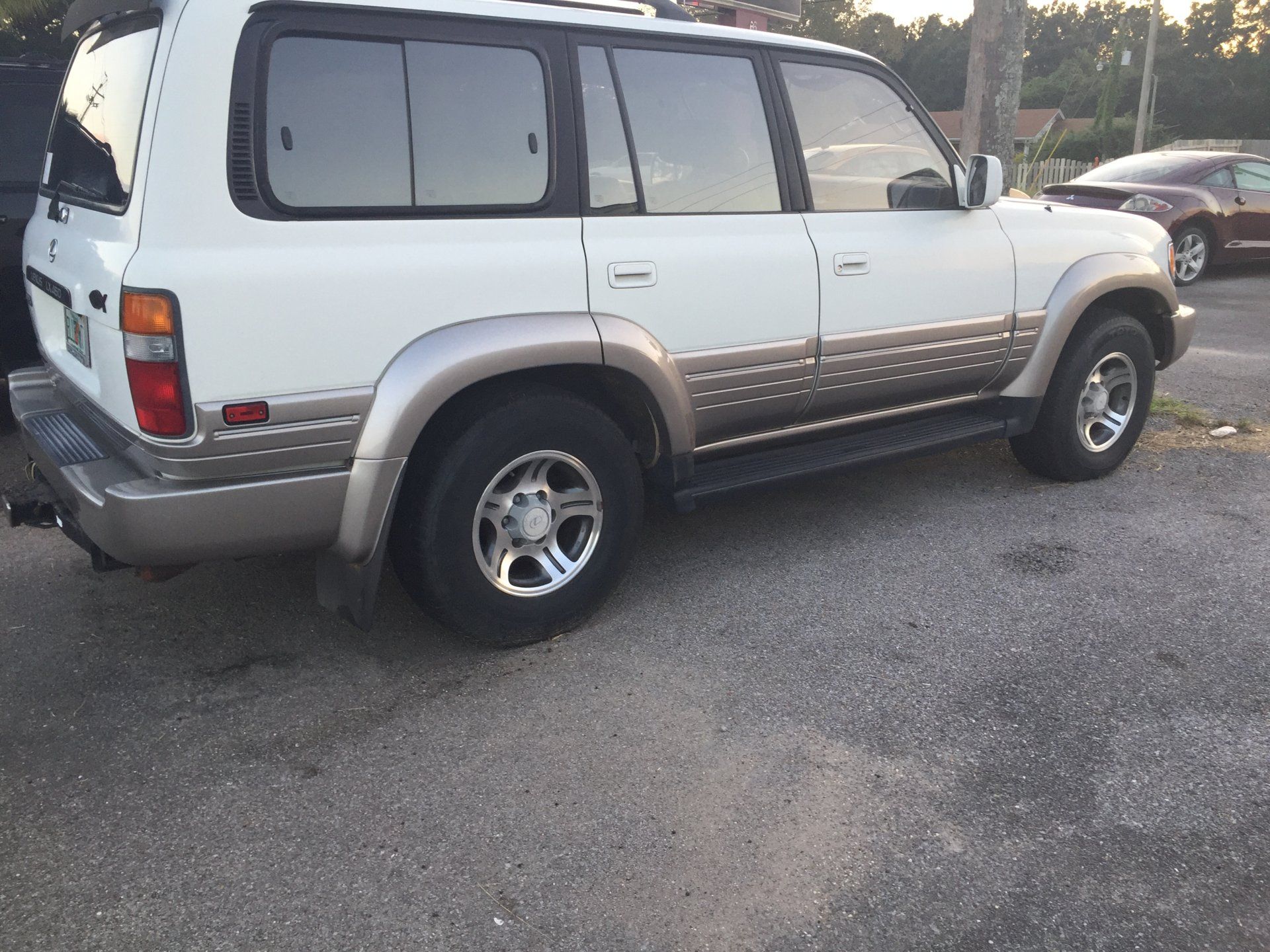

Been waiting a few weeks for the couple who own this LX to give me word on if they will sell. Husband wants to get rid of it, wife doesn’t. Been sitting for a year but has 120k miles.. interior looks practically new! Son in law says I’m the only one to ask about it since it’s been parked.
Damn - looks like it's in great shape
For the most part it is. From what I’ve seen it needs a birf rebuild and has a bit of surface rust on the frame but overall very nice 80

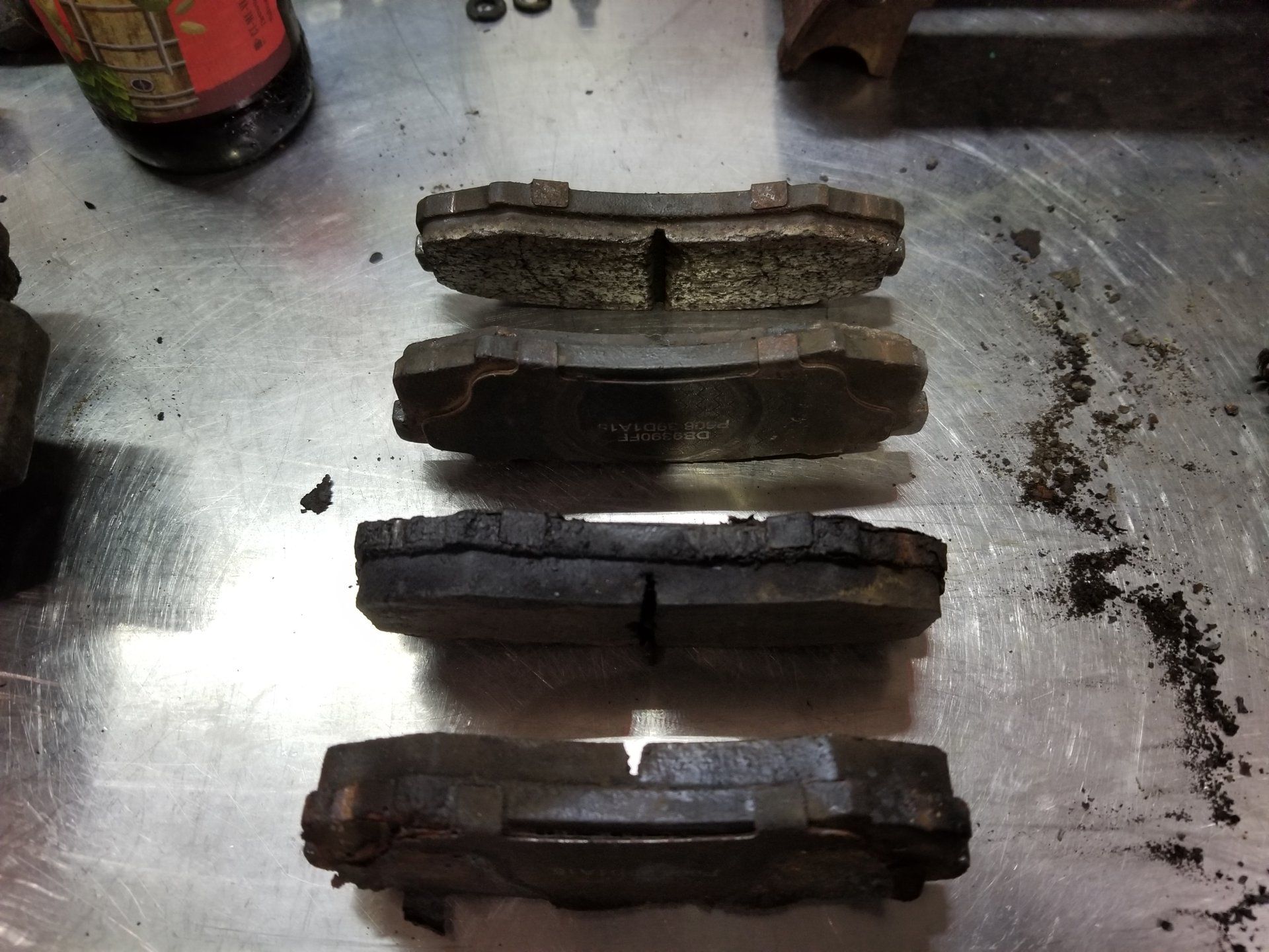

So the lift on the Cammo Cruiser is work in progress to put it mildly. I've been chasing gremlins since the install. Much more to come once I actually get to that process, but since that truck is currently napping, I decided the LX needed to get back on point as the DD since it rains every day. I've been chasing a squeak that sounds like a motel by the hour rental bed from somewhere in the back axle. Finally decided to do a deep dive.
Parking brake on drivers side was mangled. I knew that, finally decided to repair. You can see where it's missing a piece. Top 2 are DS, bottom 2 PS.
Realized while I was in this process that the DS caliper was sticking and PS was leaking ... balls. DS pads up top, PS on bottom PS pads were soaking wet.
Installed new parking brake hardware. Not fun, but just a little swearing. Old DS components were beat.
