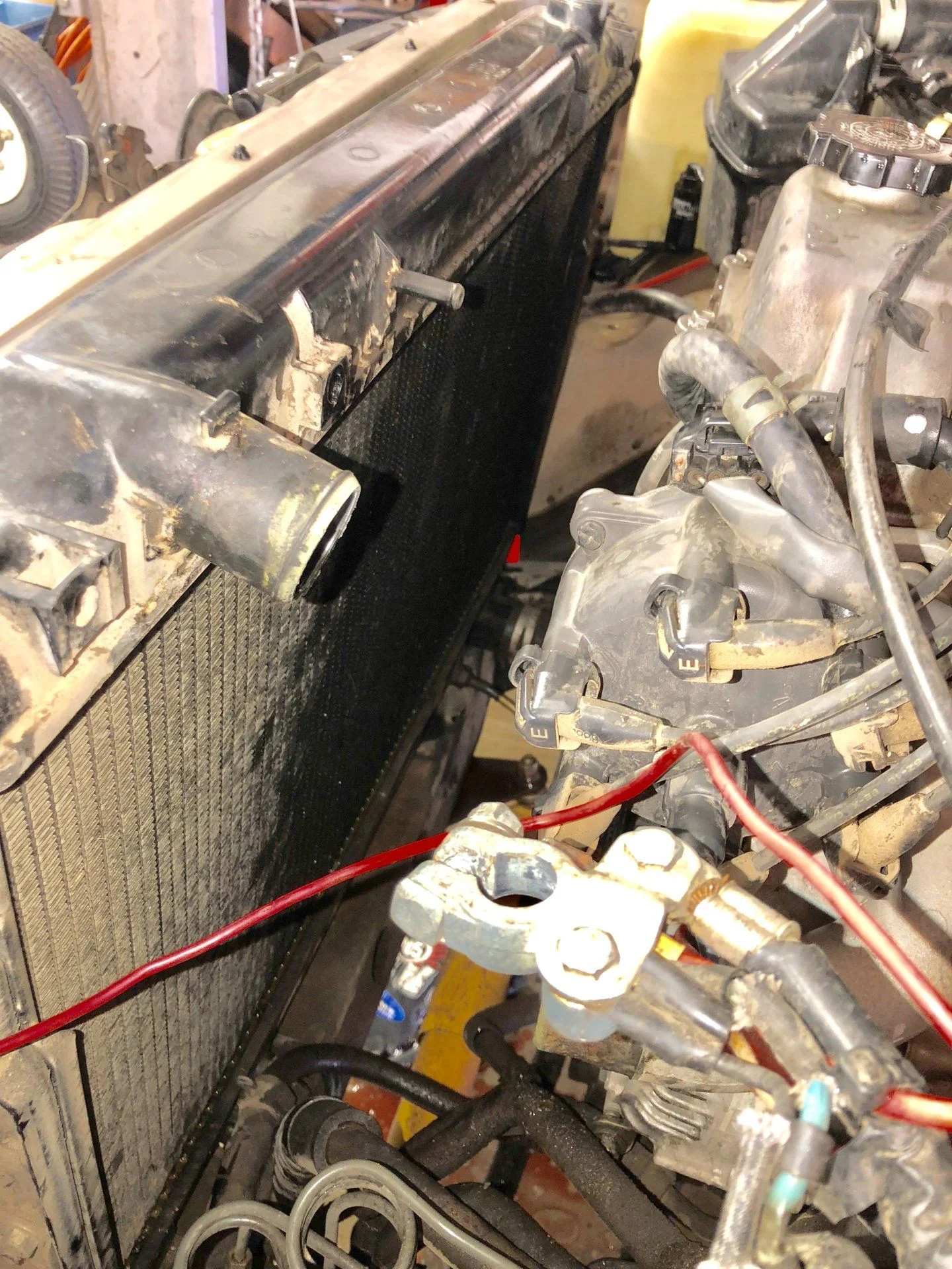

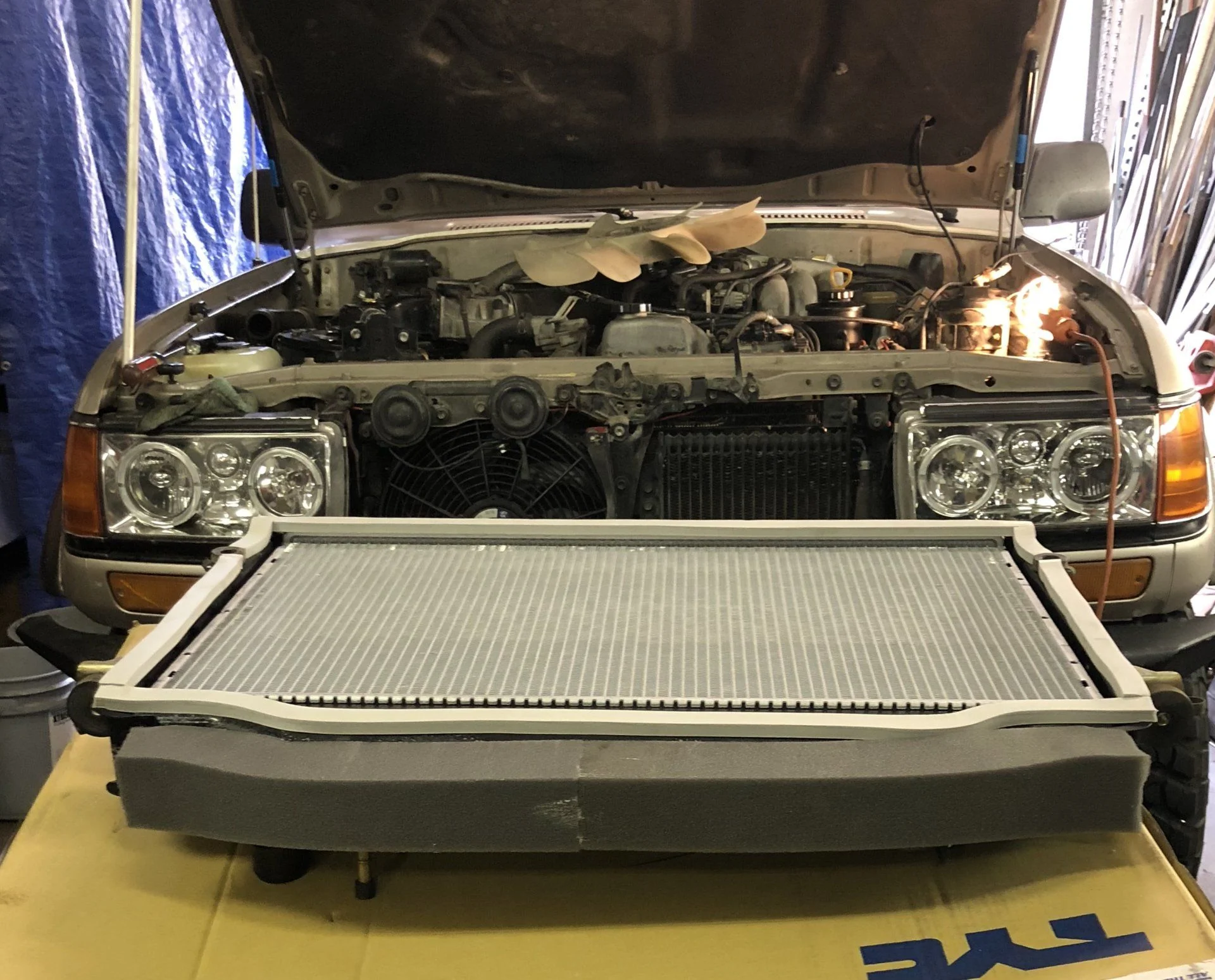

New TYC radiator, foam, seal, ready to install. 1. flushed the radiator a few days ago 2. I drove it around with cleaning agent. 3. Flushed again yesterday and then installed new radiator. 4. Replaced thermostat and radiator hoses while we were at it. My radiator was exceptionally dirty. 5. replaced heater valve, throttle body hose last week. 6. PHH was in good condition so left it alone. Hopefully the brake booster doesn’t fail soon but my understanding is this is a food time to replace PHH if booster goes kaput.
Old radiator ready for removal; must remove entire battery terminal and casing.
New radiator in

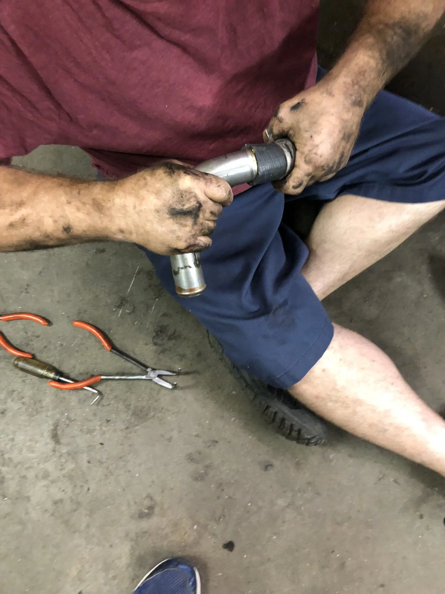

Fitting hose. Note: BUY long 90’ plyers and long plyers for tools in rig!
Thanks @inkpot and @Tools R Us for the process and each procedure to do this properly. Pure wizardry.
New radiator inView attachment 1801976
Zona
I don't remember having to take the battery out when I did mine but I can't really remember much haha.
I hate those spring clamps and have been replacing them with traditional screw clamps as I've been taking them loose. If you want to stick with the spring clamps for some reason a set of cable pliers work much better: https://smile.amazon.com/Astro-Pneumatic-Tool-9409A-Pliers/dp/B003D3N7YW/?tag=ihco-20

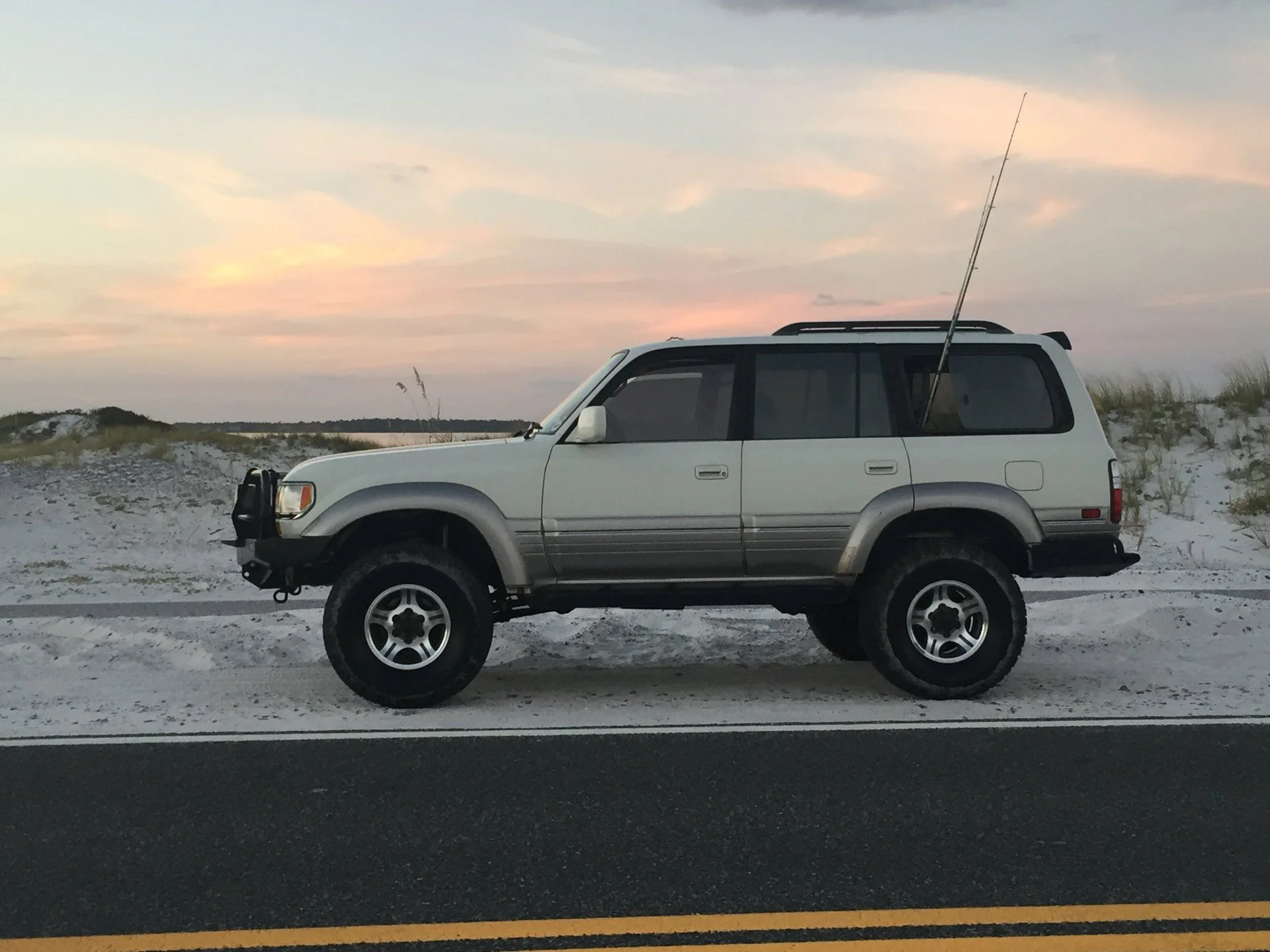

So last time I said the tranny was leaking bad. Sunday just started her up and drove it down the road, checked the fluid and put 2qts of fluid in her to read to the proper level. Been a small bit of leaking but she’s still driving like normal. Cleaned her up today and used the excuse for a beach trip to throw out a line or 2.

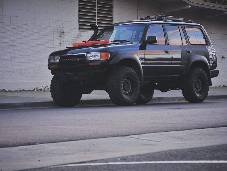

Finished up 1st part of the build. Stage 1 lift, supplied by Icon Vehicle Dynamics, 17x9 Black Rhino Arsenal rims, custom Ivan "ironman" Stewart inspired wrap, custom hood rack complete with 2 gallon rotopax gas tank and 2 gallon storage container and snorkel, because why not!
Have the honor of working with Slee to install most everything. You can find more photos and keep up to date with it via Instagram - Tuck Graham (@_tg____) • Instagram photos and videos
