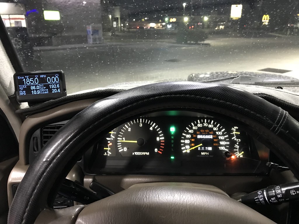

Quick mod last night to move my Ultragauge. I've had it mounted to the top of the steering column for a long time but from my driving position it blocks everything from the L indicator down. So I wanted to move it over to the A pillar so it wasn't blocking the gauges.
Here's how it's been....yes I know the temps are a bit high. This was from last week as I was looking at fuel trims to find out the truck is running very lean, causing it to run warm.

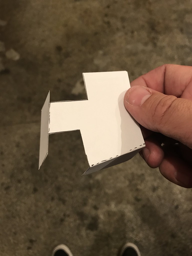

So started with a simple cardstock mockup of a new bracket.

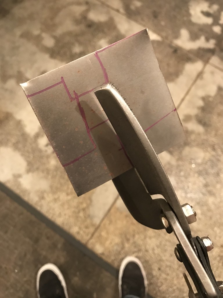

Which was then cut from 16ga sheetmetal and cleaned up, bent and painted.

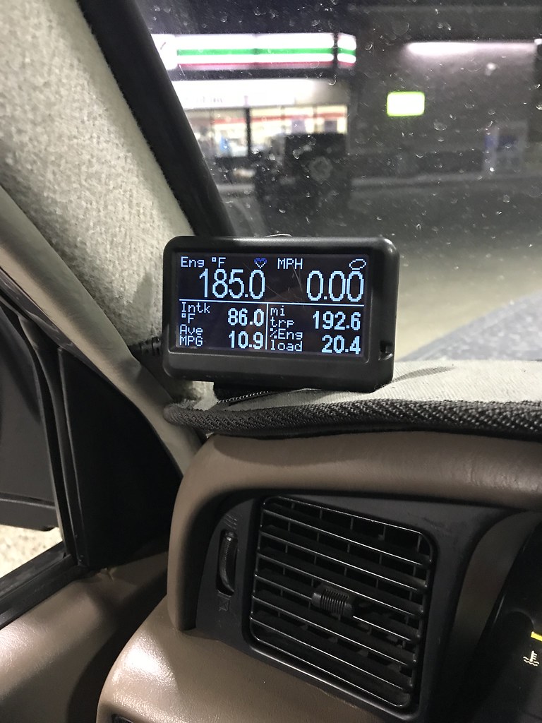

Used some double sided adhesive Velcro to hold the Ultragauge to the bracket and attached the bracket to the A Pillar.
Untitled by Adam Tolman, on Flickr
No more blocked gauges.

Well look at you! Mr. Fabricator! haha...looks good
Your temps aren't high tho...that's a normal operating temp
