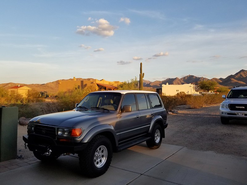

I dug Sheila out of the weeds, she has been neglected for years.
