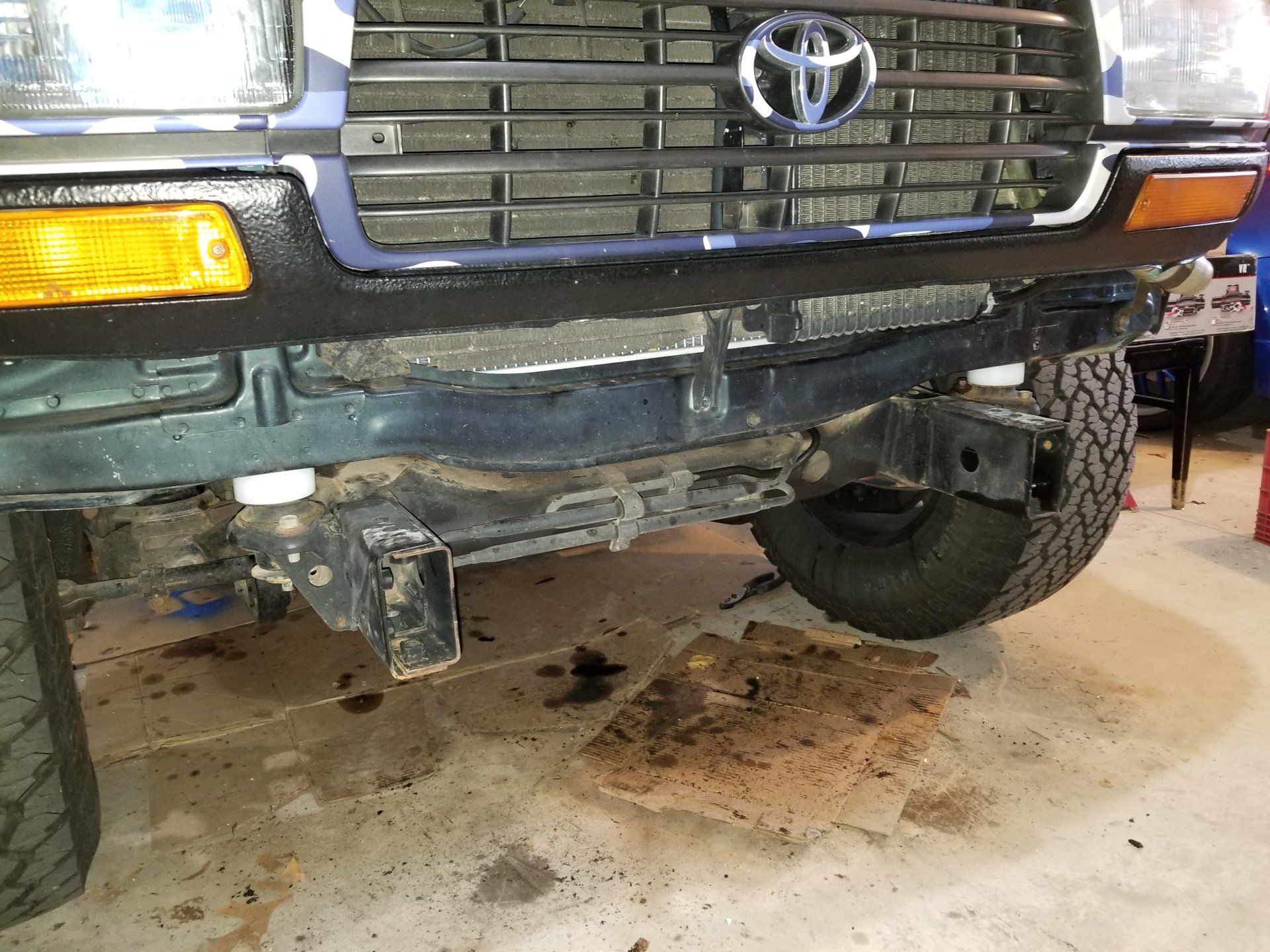

Parts that got replaced:
High pressure PS line (Gates), Fan Clutch (OEM), All motor and transmission mounts (OEM), steering stabilizer (OEM$$ b/c most aftermarket ones don't have ball joints), Front Diff fluid replaced again to rinse out birf grease after blown seals (fixed two weeks ago)).
Also, my pockets got lighter. Been working too much to work on it myself so my mechanic got paid. I can't wait for work to slow down a bit, and warmer weather so I can wrench on her myself. When I do my own work I will post pics, and / or when I finally get to take her off pavement.

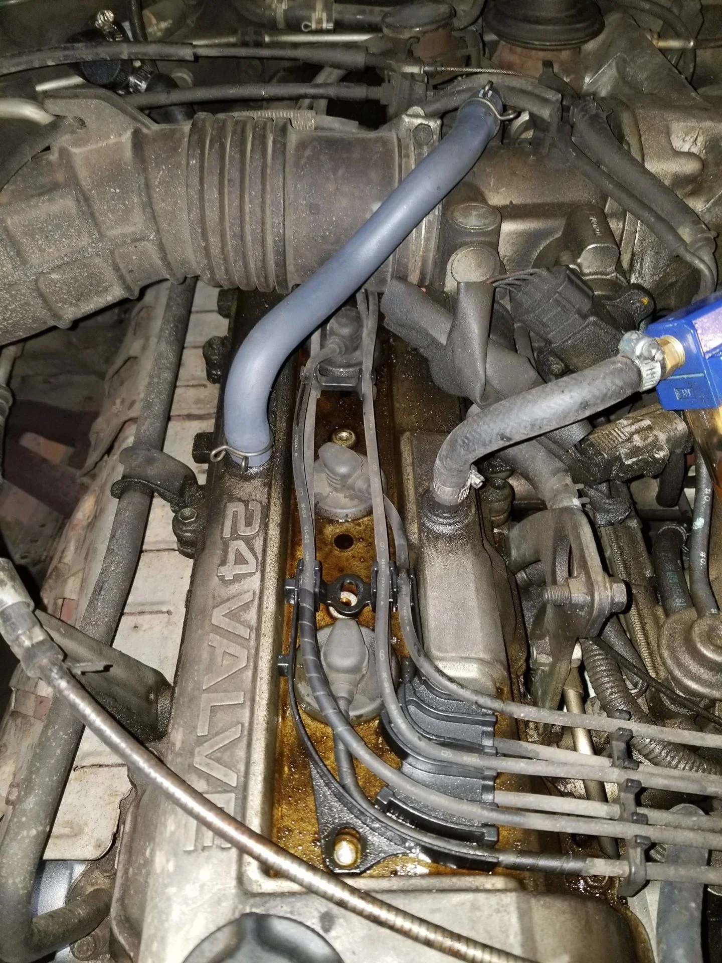

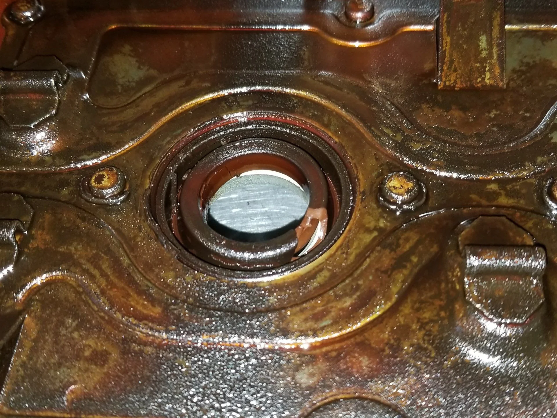

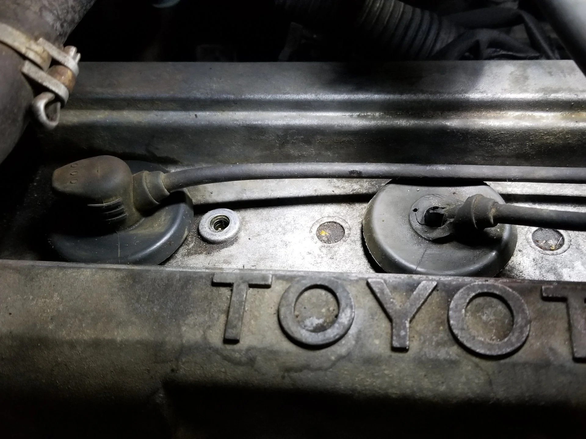

Valve cover gasket replacement this week. Just keep moving through the base-lining checklist. The spark plug seals were leaking badly. Once I got the cover off I could see why, they were very brittle.
Before:
After:

Think I found the problem ... found the missing chunk on the head.

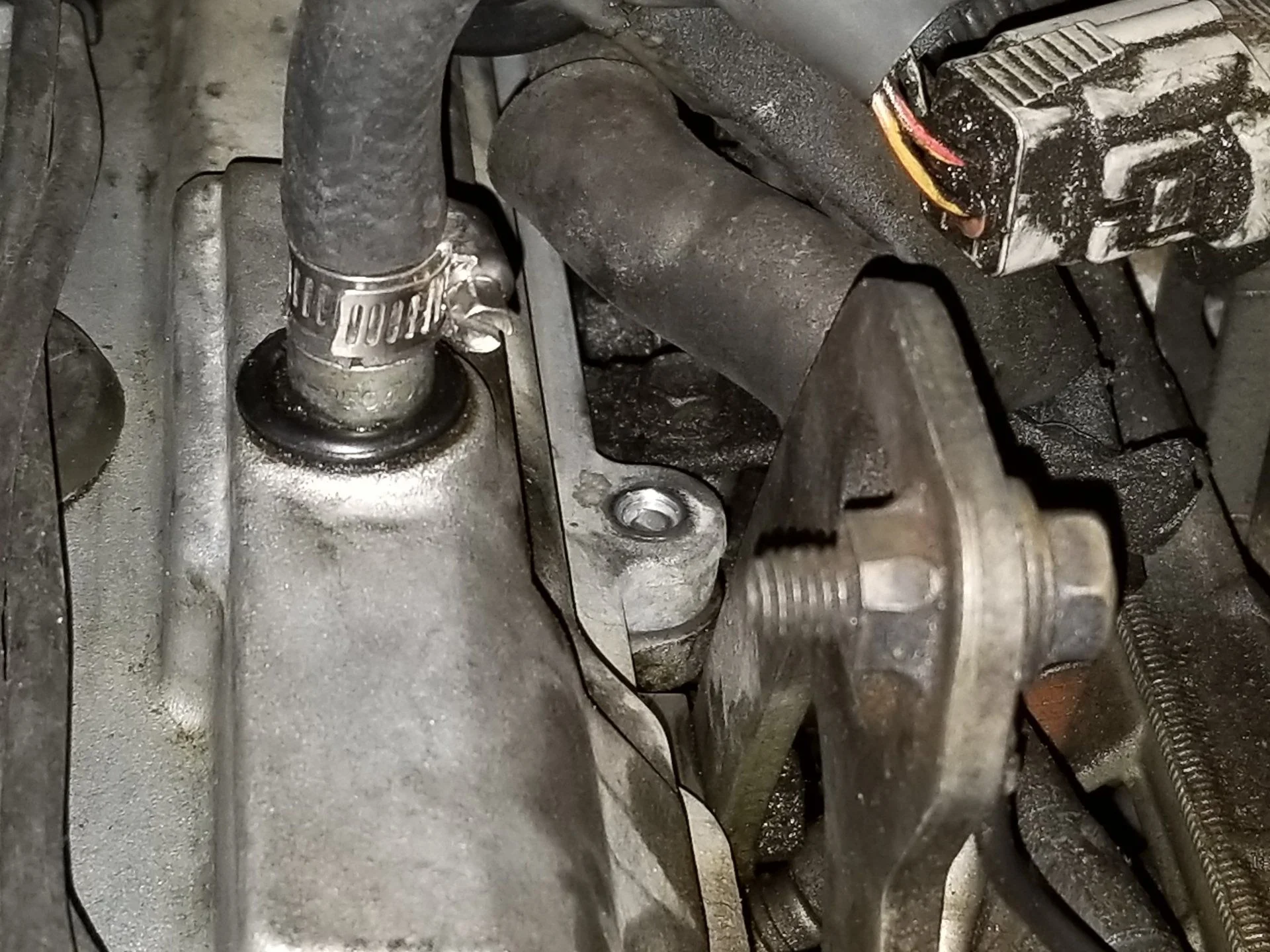

Had a bolt head snap off. No leak, but will need to fix this next time the cover comes off:

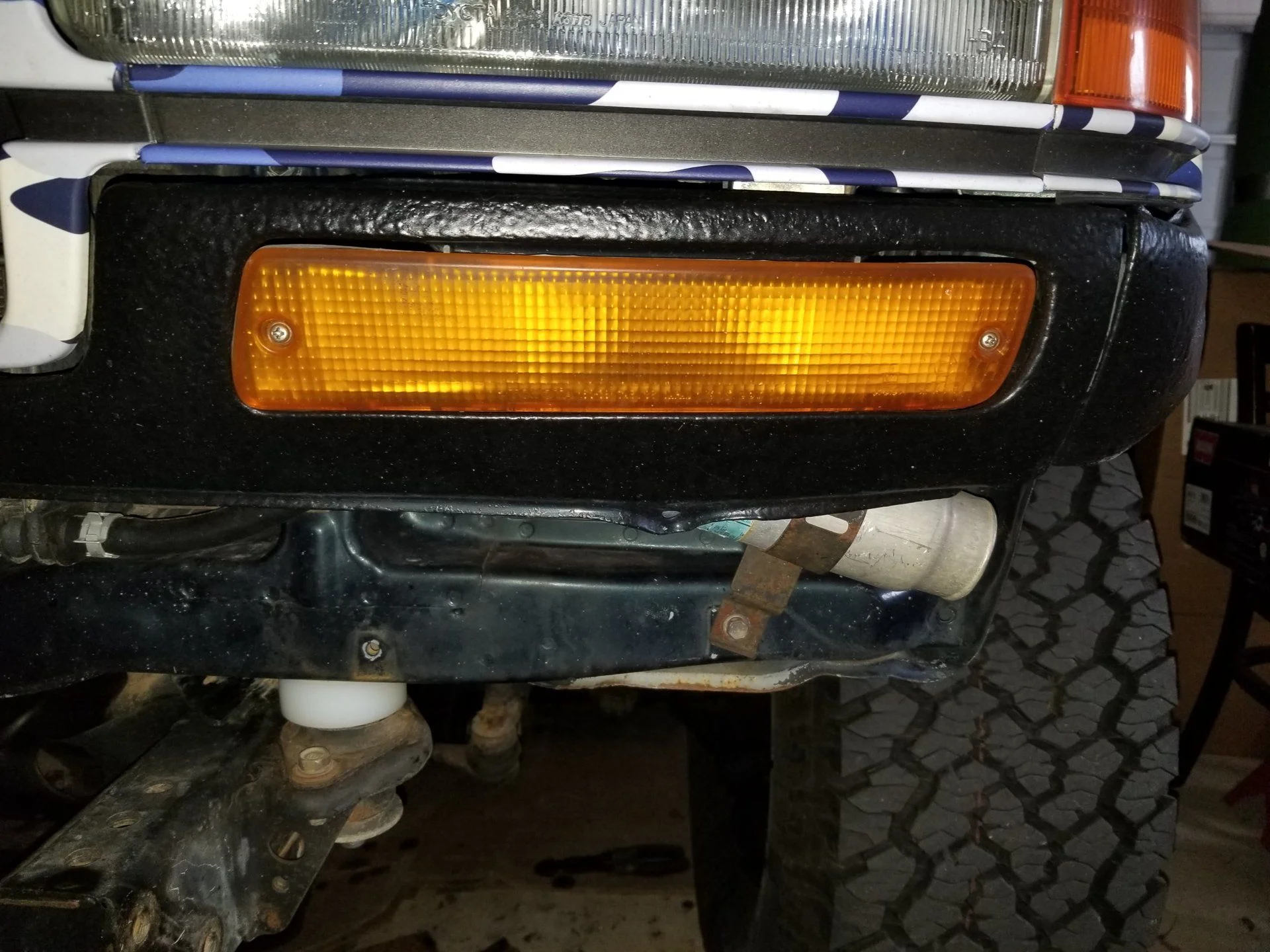

Dieseled the drier out of the way to prep for the new bumper. Lines didn't crimp and new compressor just showed up, so I guess I will find out if it pulls a vacuum shortly.
