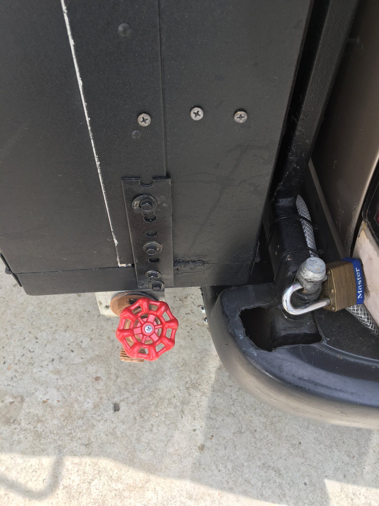

Installed a new hinge on the Campteq. Went with a heavy duty stainless steel piano hinge. Lovely weather for it...

I just hope that the bolts aren't the link that could create the reaction. They are stainless bolts and the nut side would be touching the Aluminum via a washer.
Touching is fine as long as no moisture can get between them.
You need 4 things for a galvanic cell. 2 dissimilar metals, electrolyte, and a metallic path. If you get rid of any one of those four, the reaction can't occur.
Your bolt is the metallic path, but without the electrolyte, there is no cell.
A light coat of anything will work. Just to keep the bare surfaces from rubbing each other. On my aluminum trailer for my 18 wheeler on some places they had rubber gaskets, other places just black paint, and also some thin plastic like packing tape on some places. The headache rack I have on my Freightliner, just uses the protective film that the polished aluminum comes with. They bolt the ss piano hinges right over that, then just tear or cut off the excess. My entire trailer is aluminum, with SS hardware bolting it together.
"Anything" that forms a dielectric shield - yes. A thin coat of copper based anti seize will not help, and will in fact make things much worse.
The plastic wrap is a perfect dielectric shield.
