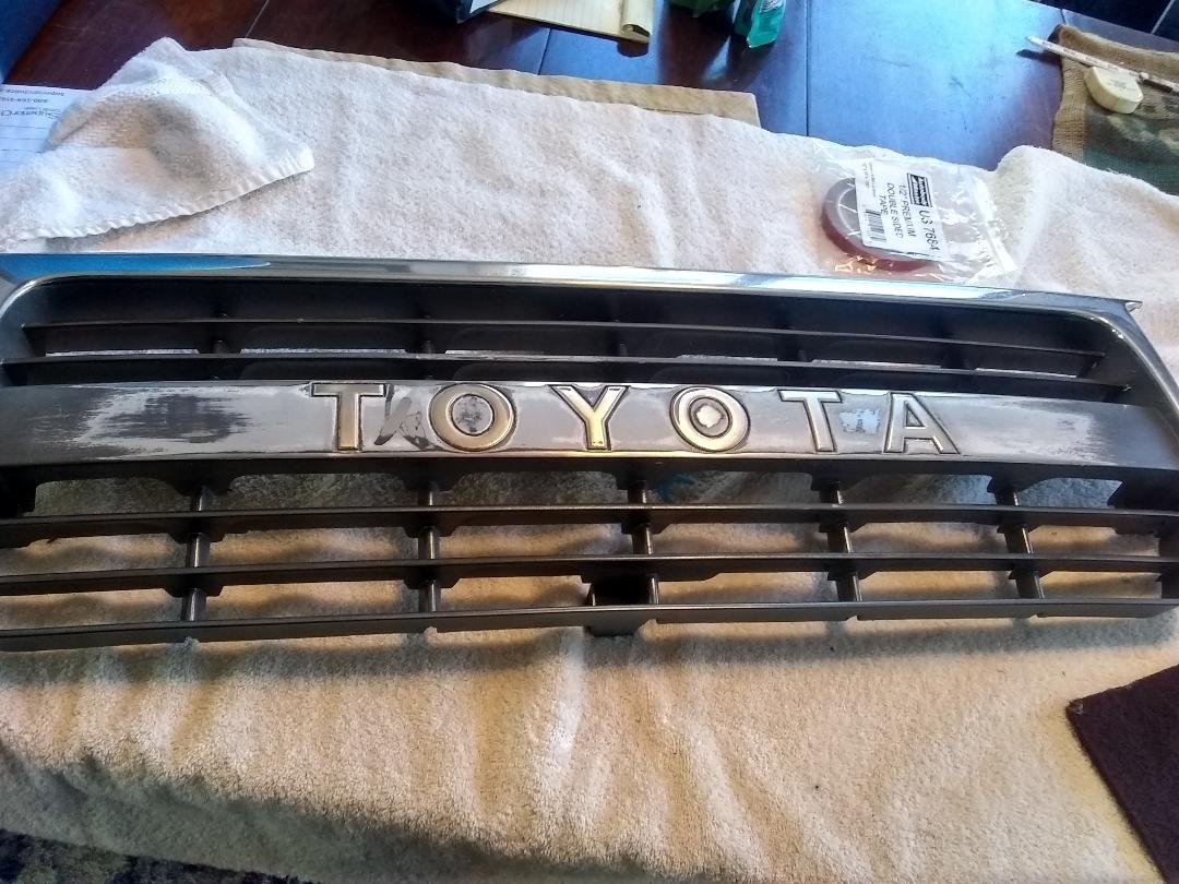

Finished up a HG job for a local cruiser guy.
Replaced everything while in there. Cleaned every parts.
Amazing all the prep to prepare for paint! Doing quality work like you do is what separates the hi quality paint jobs from the “Macco” Jobs. Can’t wait to see it!
Yeah, I am not an expert painter, but I have learned that prep is the key. It takes awhile though. I probably have close to 8 hours into this so far. I did spend a lot of time cleaning the tar that had built up on the backs of the headlights and taillights, but a lot of it is just sanding and then doing lots of thin coats. The hardest part will be cutting letters out.
Can you powdercoat the factory trim peices? Maybe on a lower temp?
Not sure. I do know there is a surprisingly thick coat of chrome in all of mine, especially the front on the grill, but it doesn't cover the entire thing. the insides of the slats and the rear portion of it doesn't have the chrome, it's like they dipped it partially, but not all the way.
Cutting the letters is where I failed.
When you tape your letters do you use blue, green or regular tape? Does it matter? I always get the edges “bleeding”.

Yeah, I think I did a decent job of cutting around the letters, but I ran into a set back. Not sure what happend here, but it looks like the tape left some residue behind after I peeled around the letters. At any rate, this will be a do over. I am going to let the white set up for a few days longer once I get back to that point. I think I rushed it and the tape damaged the finish. I am also going to remember to use the prep spray before I do more finish coats.
I am also going to just paint the whole grill black other than the letters. The graphite looks dumb. I also realized that I botched the tape job. The middle of the Os and the A should have been left untaped. Wasn't paying attention and was rushing. I think I should have used primer after a light sanding on the white I was covering too.
Maybe others can learn from my mistakes.
I bought some fancy green 3M tape from the auto body supply store. I think it will work well with minimal bleeding, but I am going to have to wait a few days for the white to set up better before I try this again and I am going to do each letter individually as you can see in my pic that the over lap line from just using two pieces across the whole thing left a visible line.
NOT regular masking tape.
Blue is good. Green is better.
You must rub the edges down well to minimize bleeding.
Also, make the first coat very light and let it dry. This will help seal it off before you apply more paint that could bleed through.

Things officially went off the rails with the grill paint project, lol. I tried to just sand down the top coat to get back to a point where the crazing didn't show and everything is just too gummy. I am going to shelve the project for a couple of days. I have a better game plan for the next effort. I probably deserve quite a bit of lecturing for this effort. I gotta learn to be more patient :hillbilly:

The little pieces look pretty good though.
