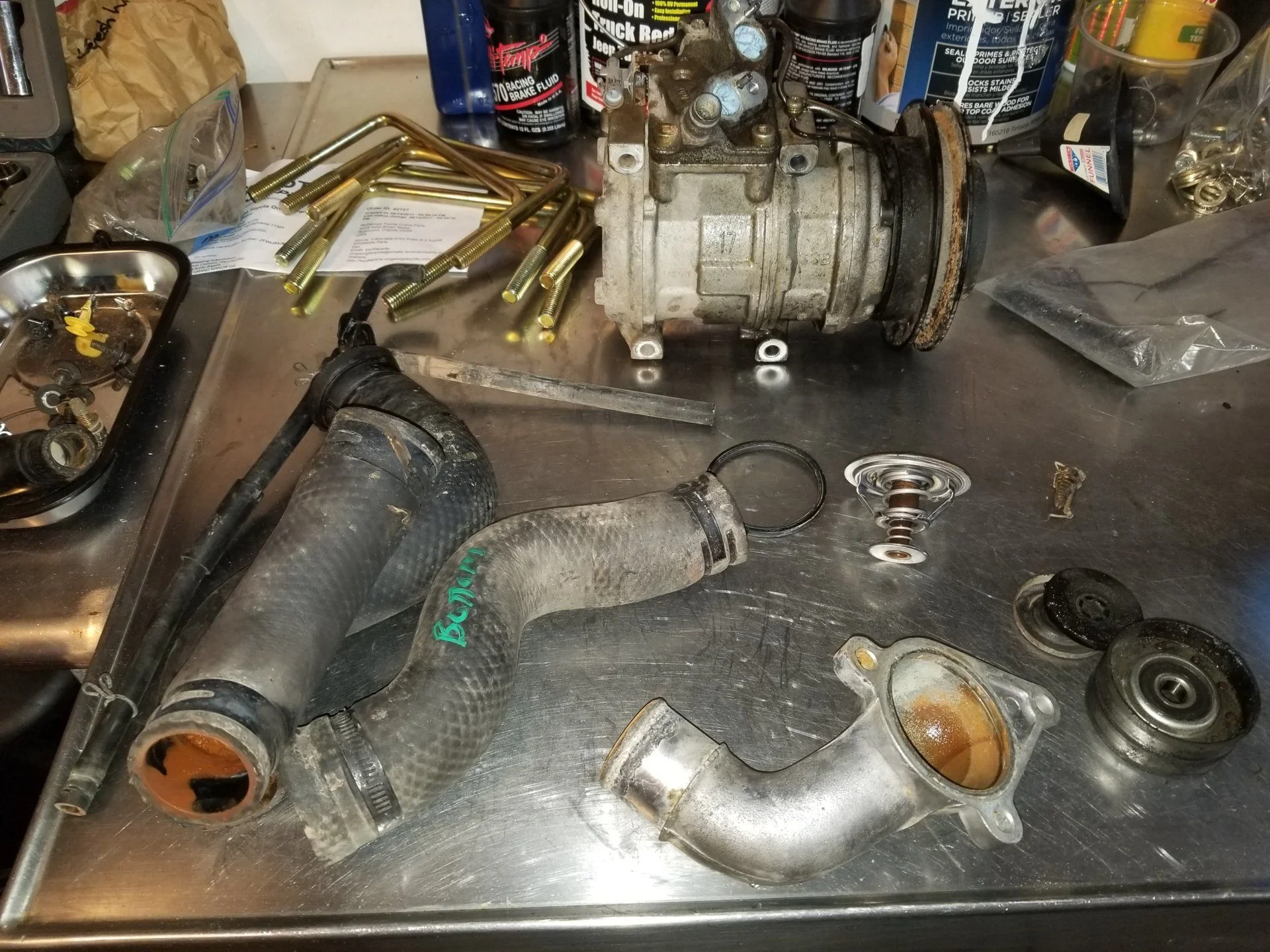

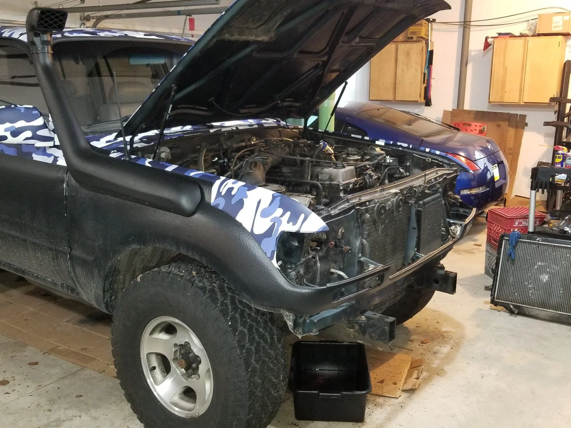

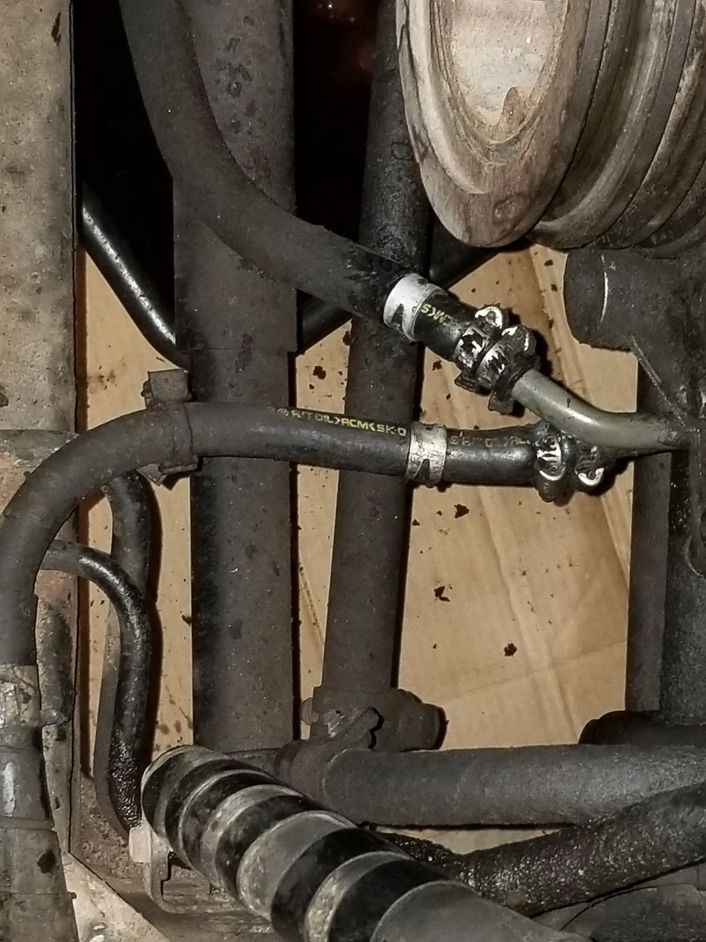

Backwards before forwards ... AC compressor, idler pulley, belt tensioner, all radiator hoses, transmission cooler hoses, thermostat, power steering hoses, dizzy o-ring, oil pump gasket and valve cover gasket all getting replaced.

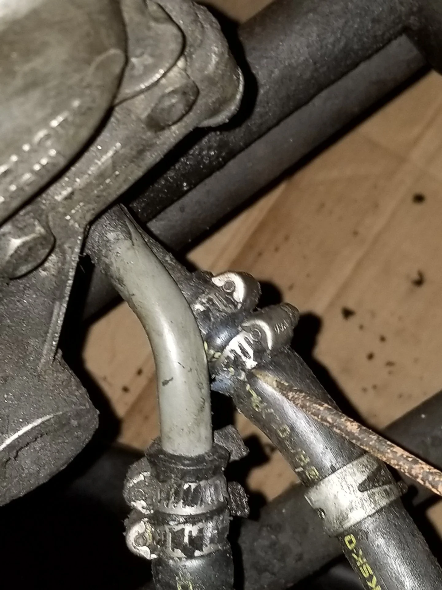

I think these may be the issue, but really not sure. PO "fixed" these prior and one of the hoses seems like it may be nicked.
Have a nasty leak on the driver's side front of some sort. Seems to be spraying all over that side ... any ideas? If it's oil, its a really fine mist and it coated the front of the engine. up the drivers side in line with the belts and even left a mist all over the intake runners and underside of the hood.

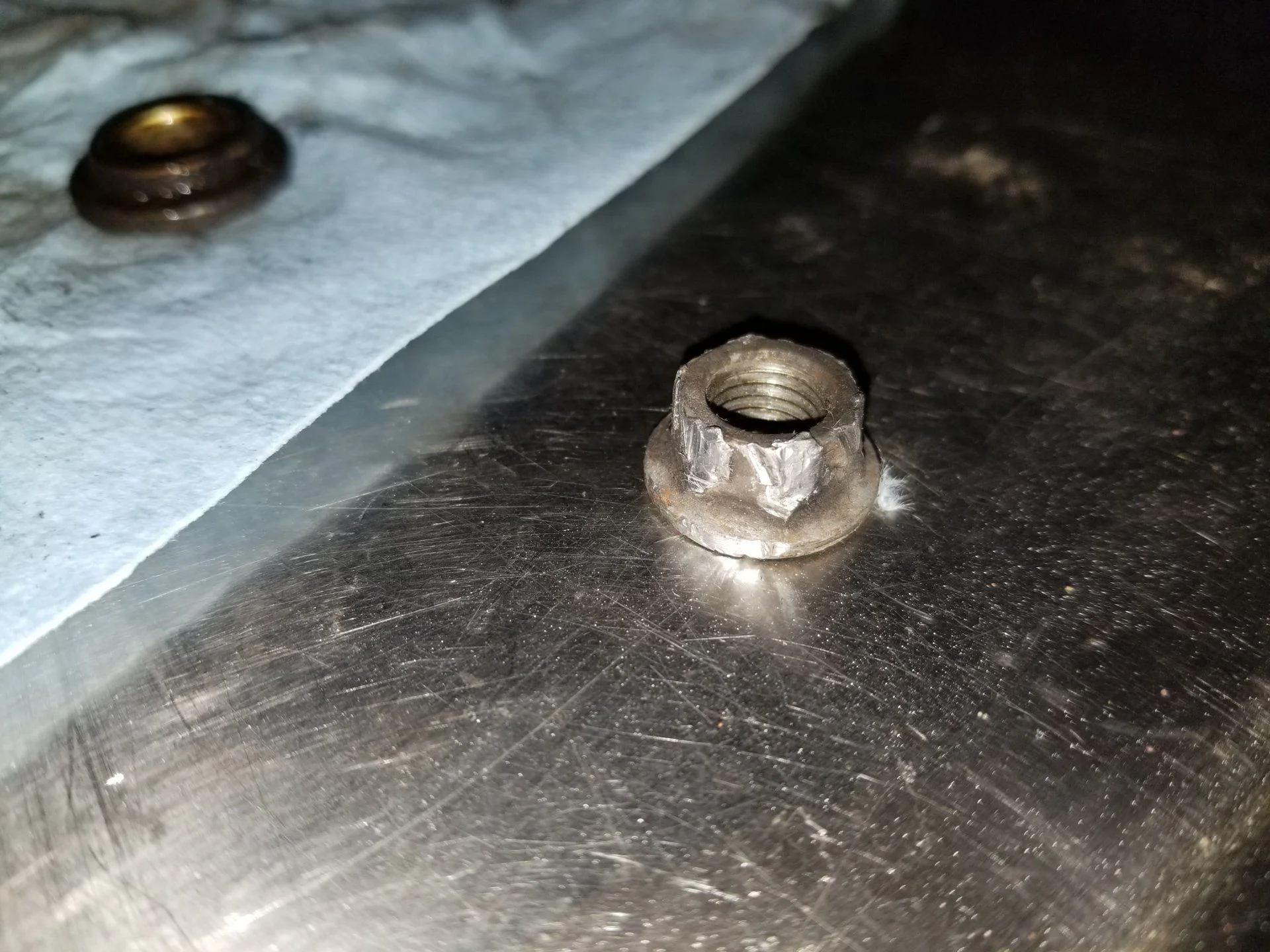

Rounded off the locking bolt for the AC compressor adjuster :bang:

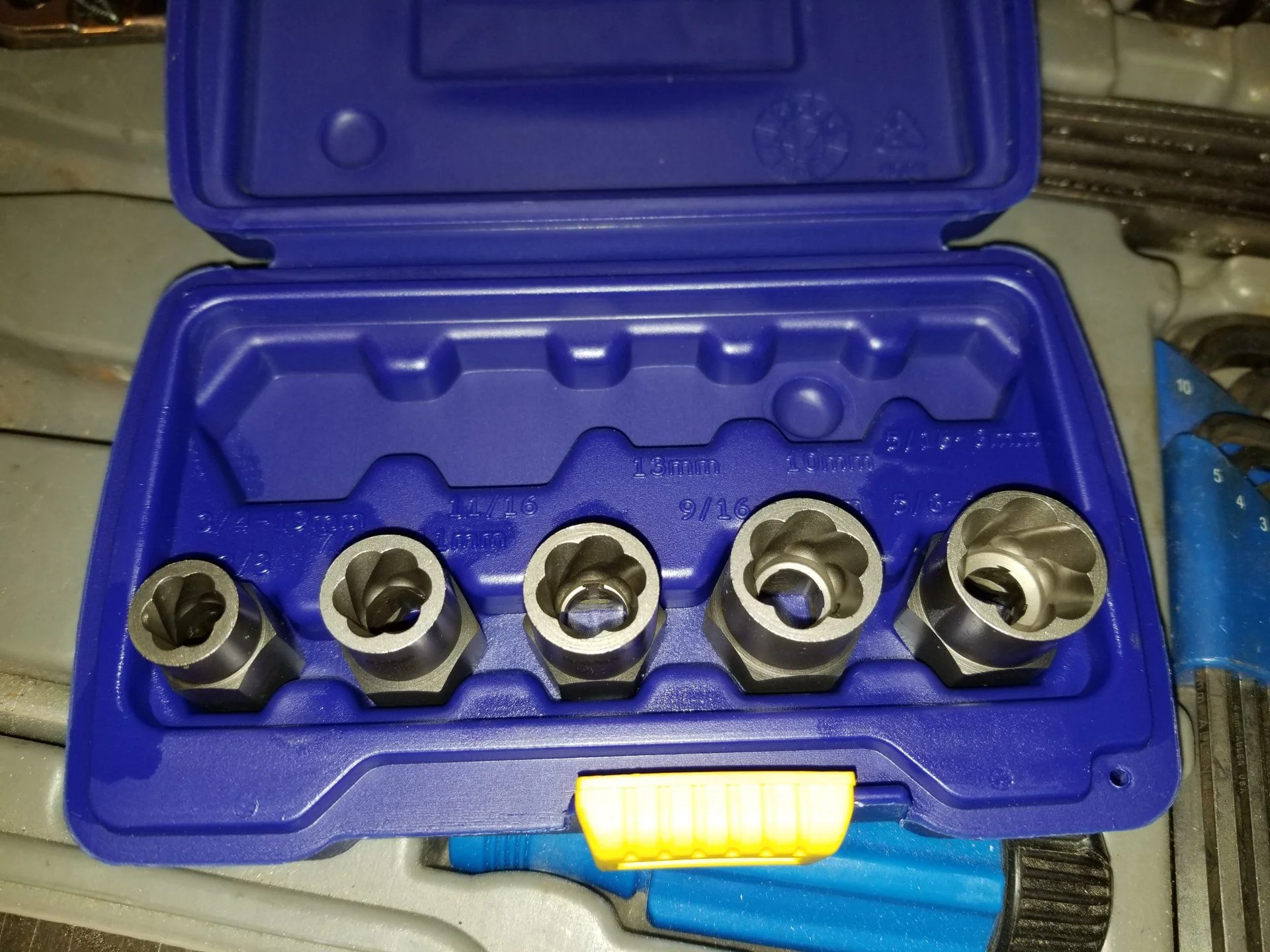

IRWIN removal tools FTW!!

Looking at the pics cass007 posted of the fixed lines with double worm gear clamps,if anyone feels the need to do this make sure the worm gear is at least 90 degrees off the other clamp,180 would be ideal
