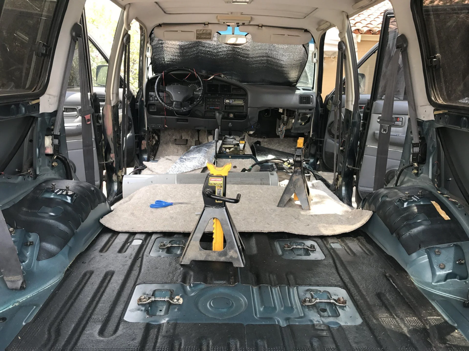

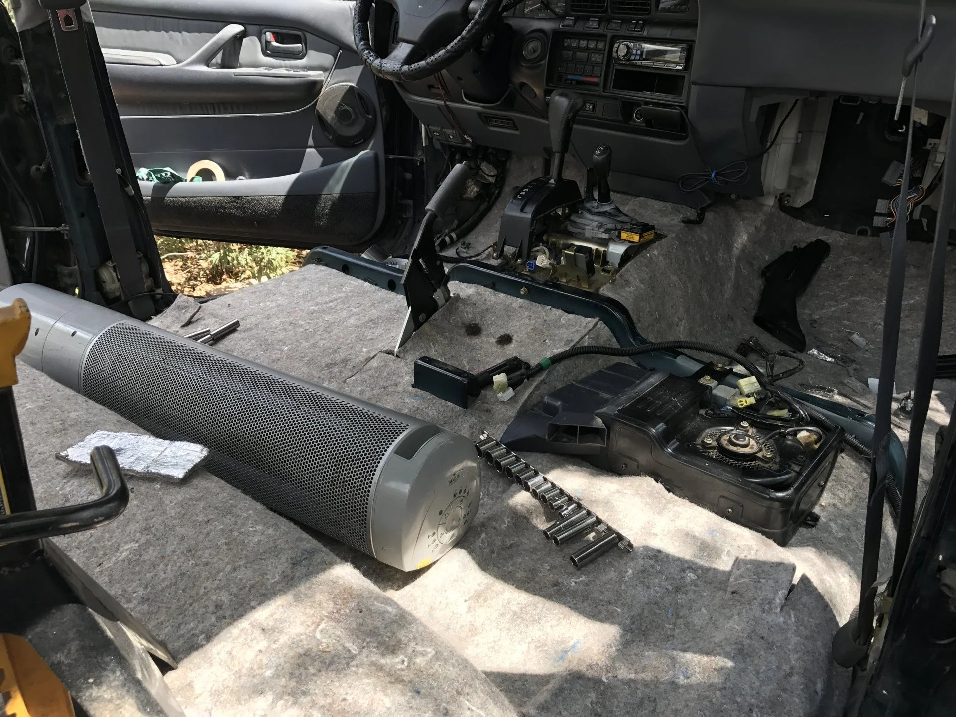

Mission creep
It is easier to install the second row insulation if you remove the wheel we'll carpet. That means removing trim and stuff and might as well remove the cargo carpet. Might as well clean that carpet as well and see if you have enough insulation for the back.
It is there you find where that spilled quart of oil went. :doh:
I'll need to order a yard or two more of thermozite and regular insulation. I can salvage the wheel well carpet. I think I'll price out a replacement for the cargo. It is a mess. It gives me a chance to run the fridge power cord from Joey too!

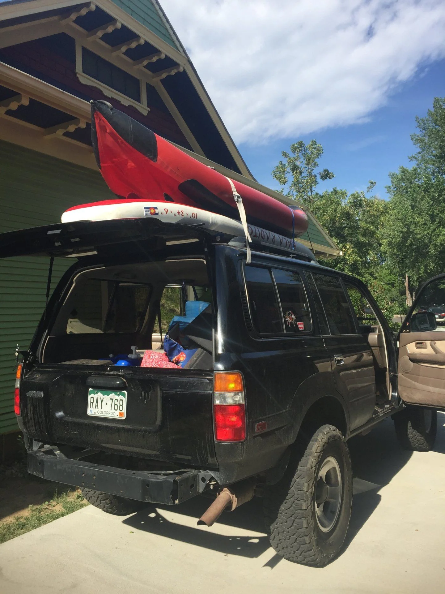

You'd think I was loaded for a month on the Grand Canyon, but in fact it was just a day to Horsetooth Reservoir with the family and some friends.
Rafts, IKs, paddle boards, kids and friends made the packing worthwhile.
Gotta take the plunge.
Little dude is actually asleep on the paddle board.

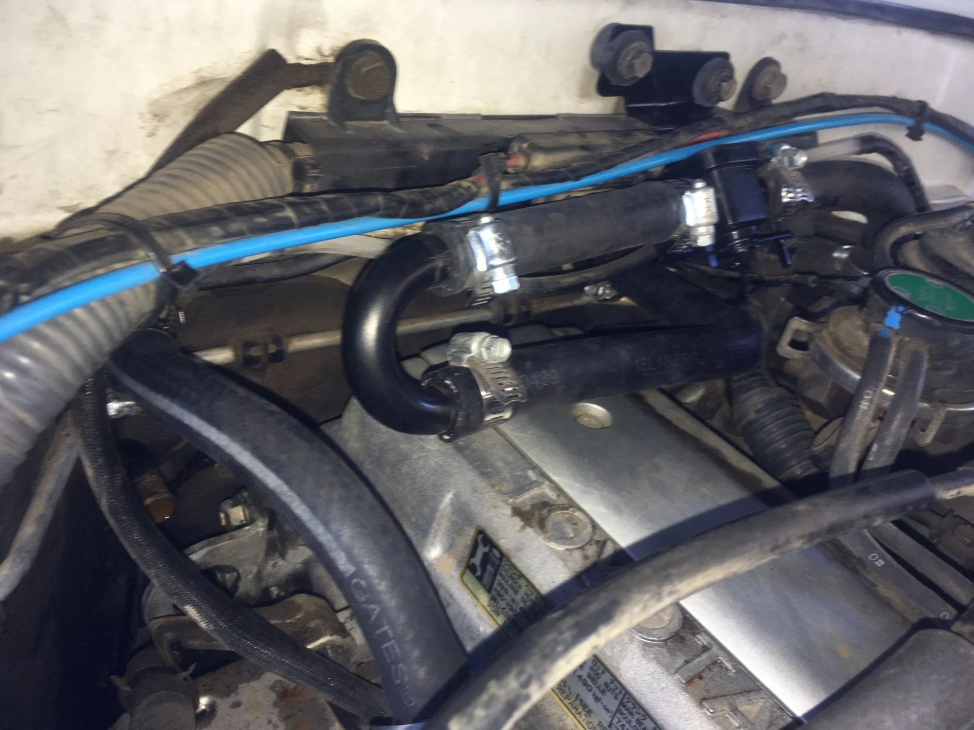

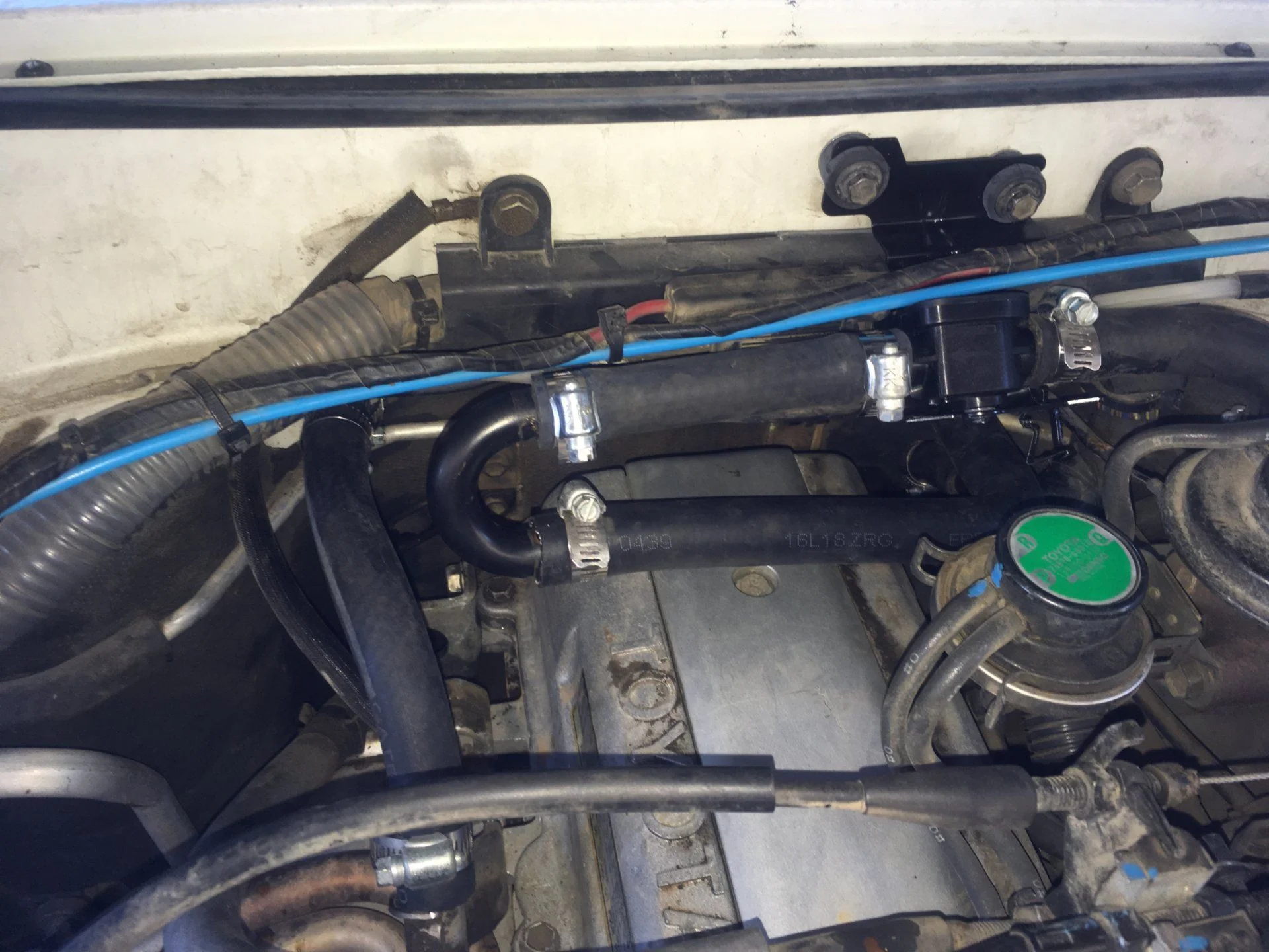

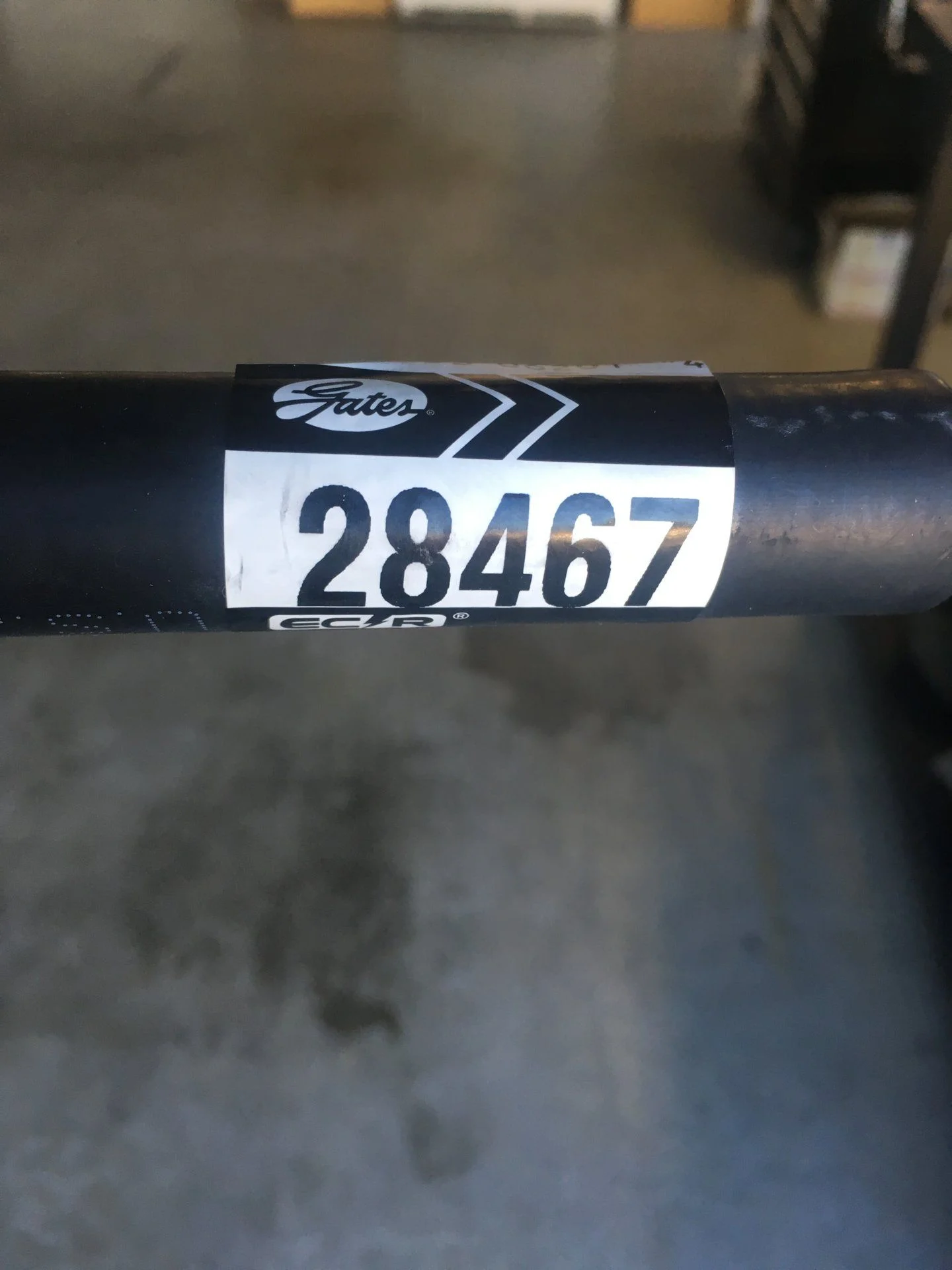

Bypassed the rear heater with a Gates 5/8" diameter hose that's about 12" long and has a 90* bend formed into it. I searched Mud and found this idea, it works perfectly. The heater valve was also replaced.
Things were going so well I decided to eliminate my not so old PHH by running a single hose from the head up to the heater valve. And since that went so well, I decided to swap the water bypass hose (#1 I believe) that runs from the bottom of the throttle body down to the head with a newer one off my spare engine. That little hose replacement was a big pita!
I also installed a black hub fan clutch that I filled with 15k oil to replace the black hub clutch I was already running with 10k oil.
When I refilled the cooling system, after a bit of research, I decided to stick with a 50/50 coolant mix but this time I dumped in a bottle of Redline water wetter.
On a 25 mile drive at speeds between 65-75, AC on and AC off and ambient temp at 105f I never got above 205f on the Koso temp gauge. Turning the AC off decreased water temps by no more than 5f and slowing to 65 made very a minimal difference also.
Last year I overhauled my cooling system completely, installed the previoulsy mentioned fan clutch, 50/50 coolant mix and no water wetter. At 105F ambient air temp my water temp went as high as 219f under the same conditions.
No doubt the fan clutch is now more agressive but the water wetter is the mystery snake oil. Redline's testing showed an 8f drop in water temp. I was pleased with the lower water temps I was seeing no matter what caused it.

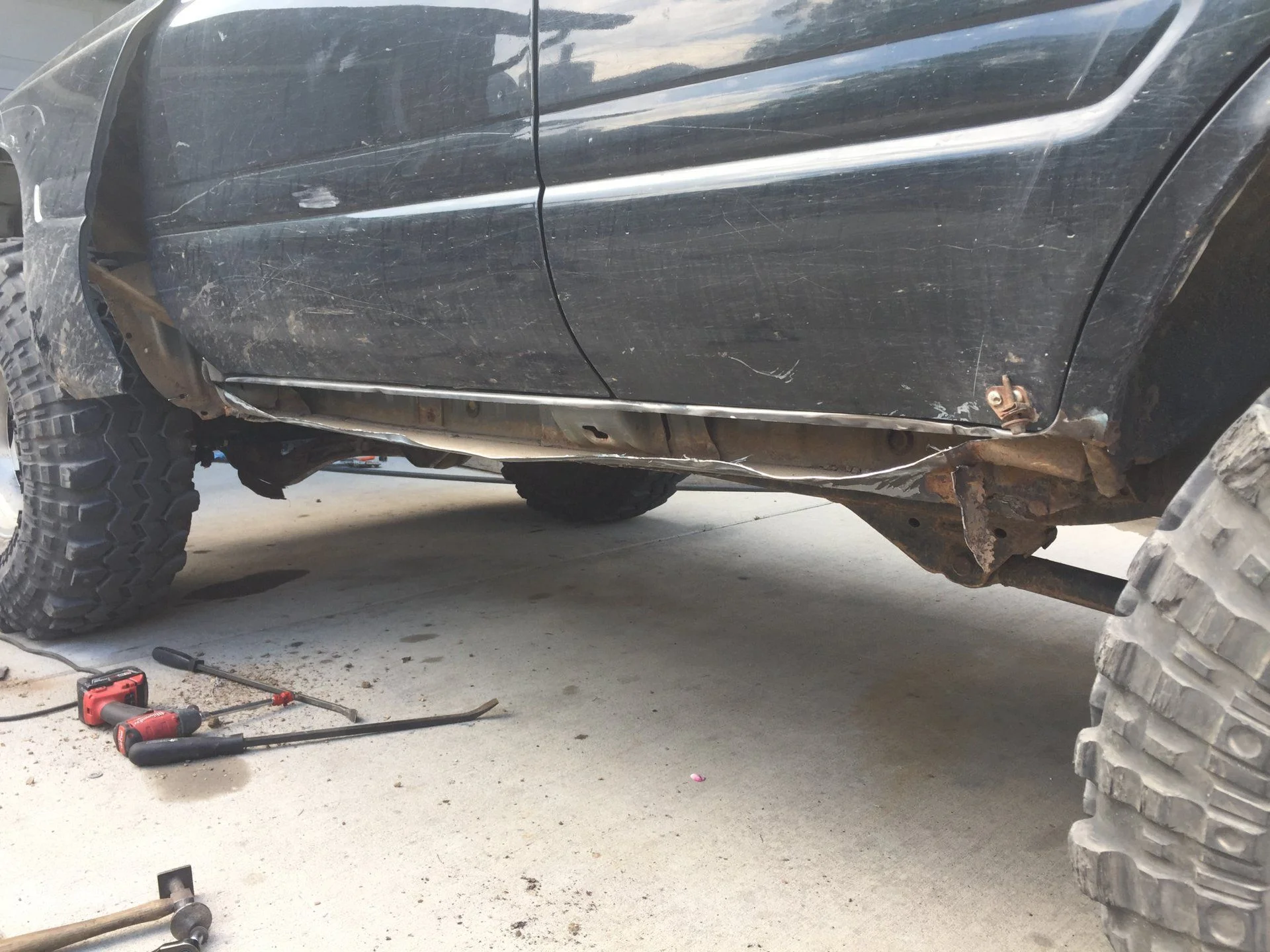

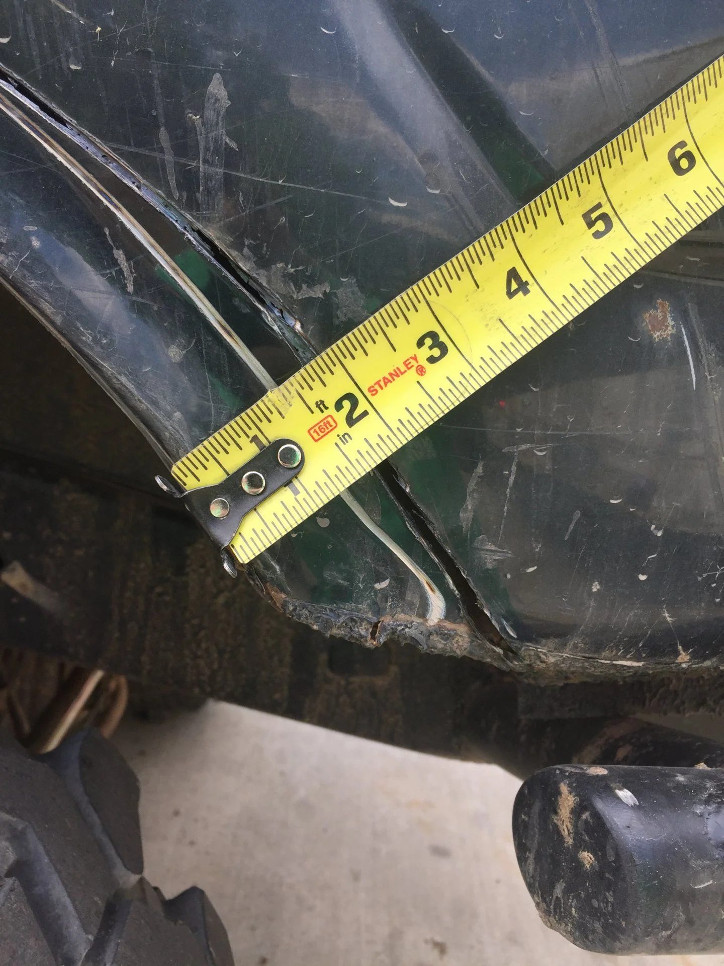

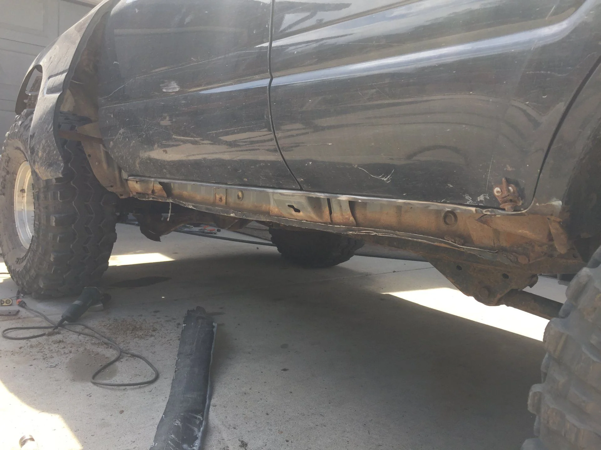

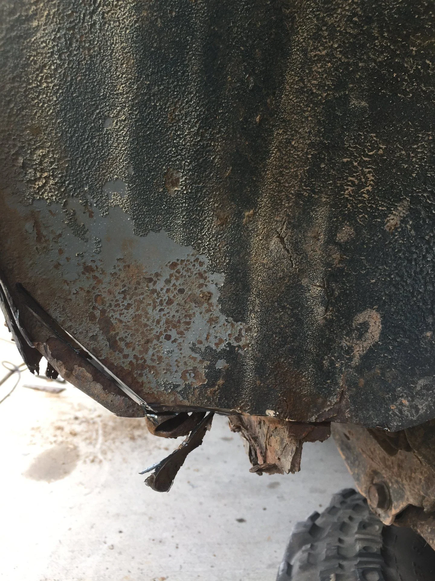

Ran Coney Flats in heavy rain. Amazing scenery with everything all wet and misty. Parts of the trail turned into a small river. No crowds either. Fun times, but the clunker paid the price. Bent radius arm, 2 punctured tires, rear driveshaft took a beating and my whole exhaust relocated itself about 6" forward, breaking all the hangers and unplugging the o2 sensor :eek: I think I convinced myself to finish my TG sliders and get bigger tires now :eek:

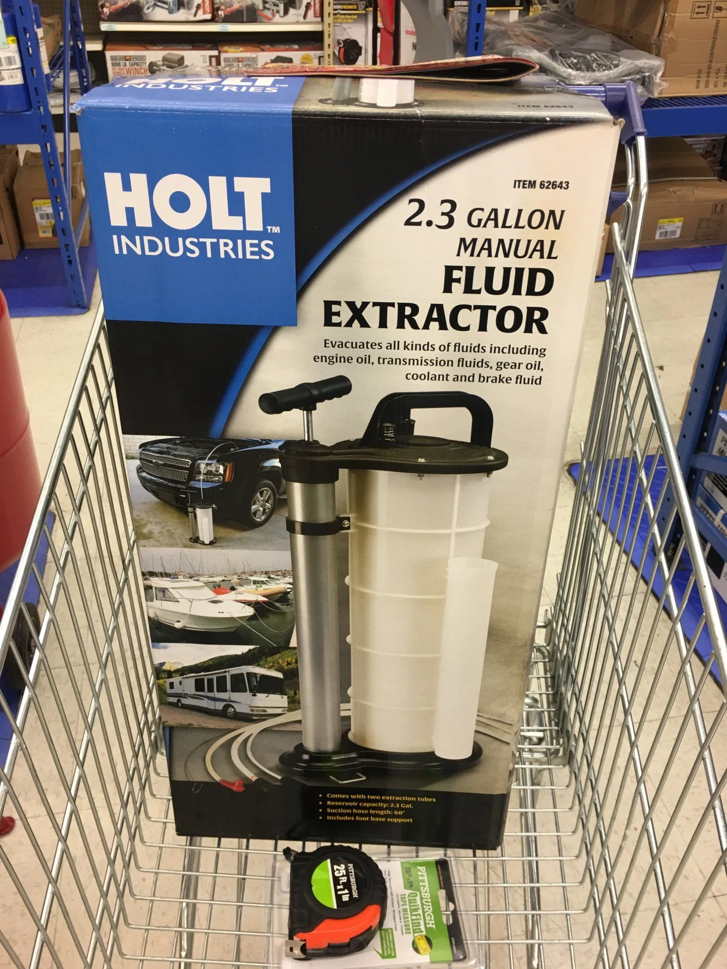

Picked up a vacuum pump for fluid changes. Did the power steering fluid flush
Sadly my Pela wouldn't work for oil changes.. toyota crimps the dipstick tube down to a pretty small diameter at the bottom and the tube for my Pela wouldn't fit. Yours may be different? Also, not sure whether you've used one of those before.. it helps a LOT for the oil to be hot. Not a big deal for a PS reservoir, but for a 7qt oil pan it can be the difference between 2 minutes and 30. SUPER useful and mess-free where it works though
how do you clean it out as to not mix fluids, or is it just for sucking
Only for extracting the used fluids.

Not sure where you are in colorado, but I'll be driving through along I-70 coming in from Nebraska at the end of this week on my way to Utah. I have two good radius arms, and I could bring one or both with me and you could have them to replace your bent one. Let me know.
