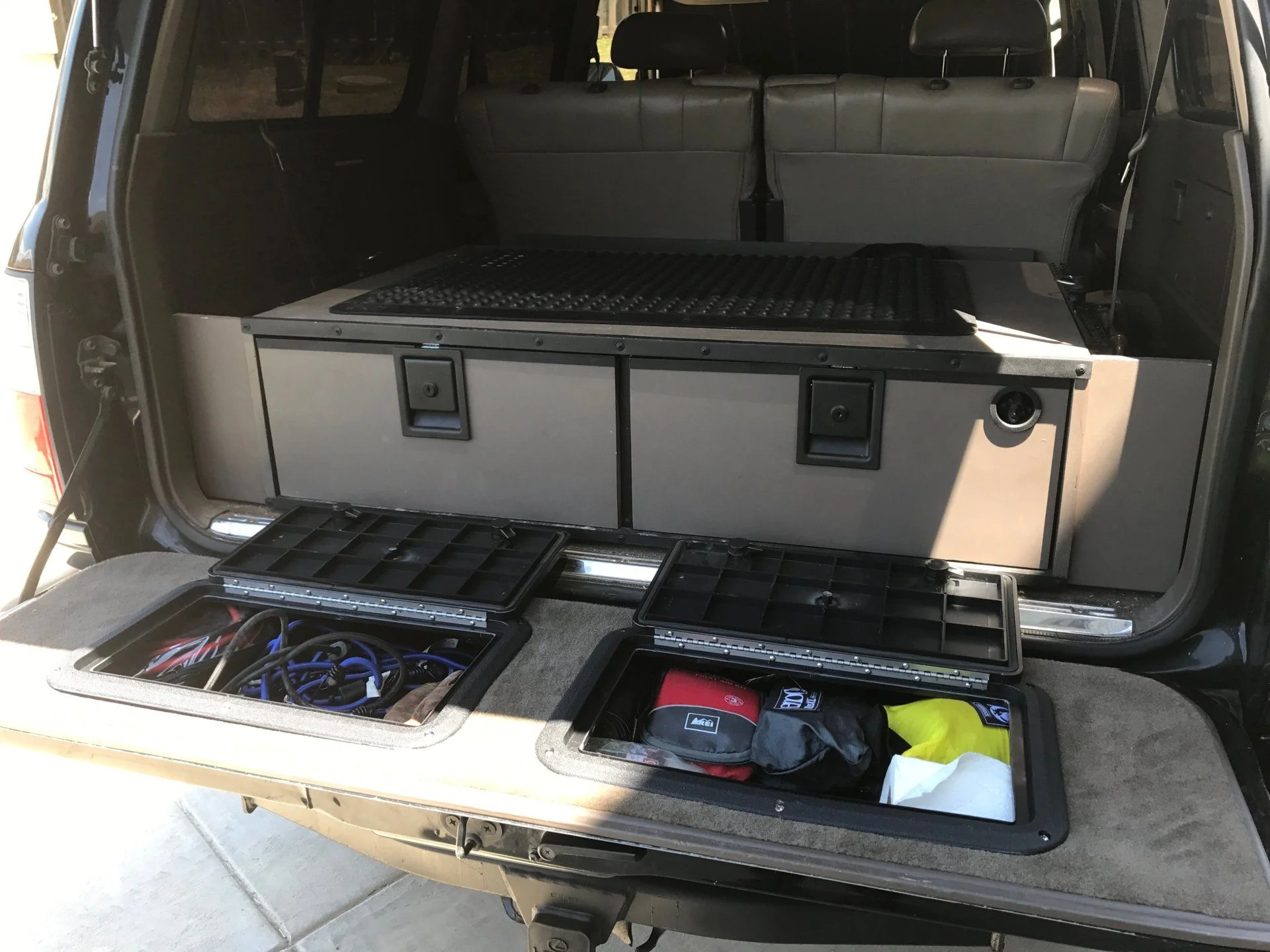

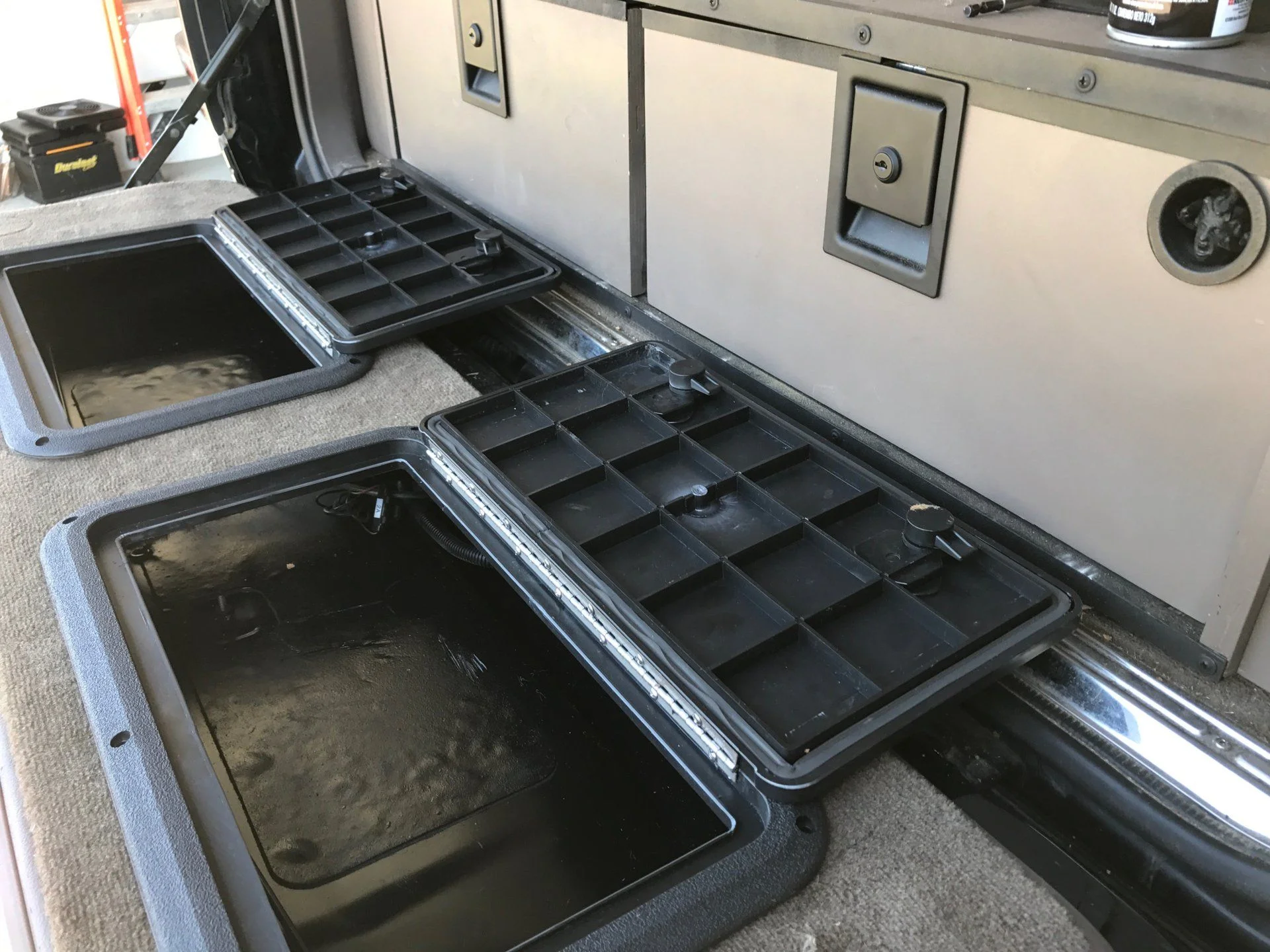

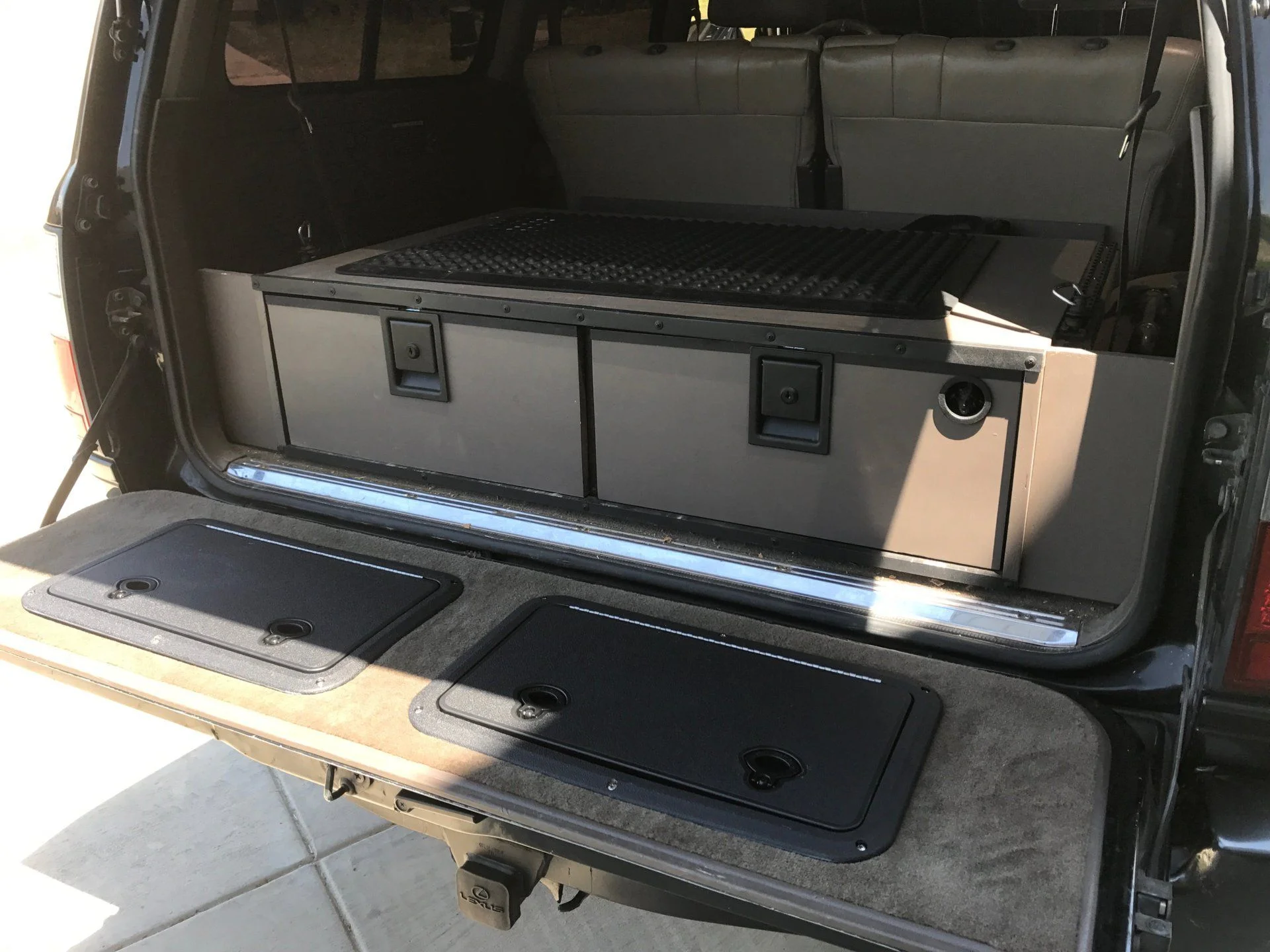

Added marine hatches to the tailgate. More storage yay!

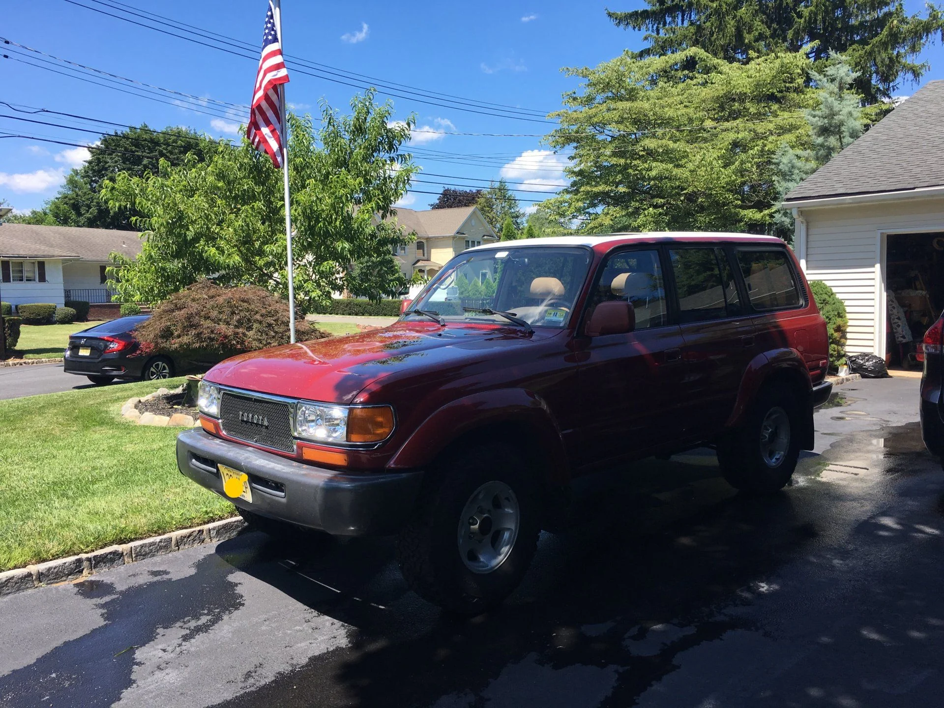

I'm on the Scheelmann site. Which seats did you buy? These look great!
@baldilocks I have the Vario XXL for driver, Traveler LR for passenger. Vario XXL has a lot of adjustments and is for taller folks. :princess: is about 5'4" so doesn't mind shorter passenger seat. The Traveler passenger is for Land Rovers :eek:, the bottom can open up since those trucks have batteries and storage under the front seats. I can look at my rear heater. I got them 2nd hand from the rep, they were in his truck, so I took whatever he had and they turned out to be just right.
I can't say enough how much more comfortable they are. I hope they stand up to wear, in terms of comfort they rock.

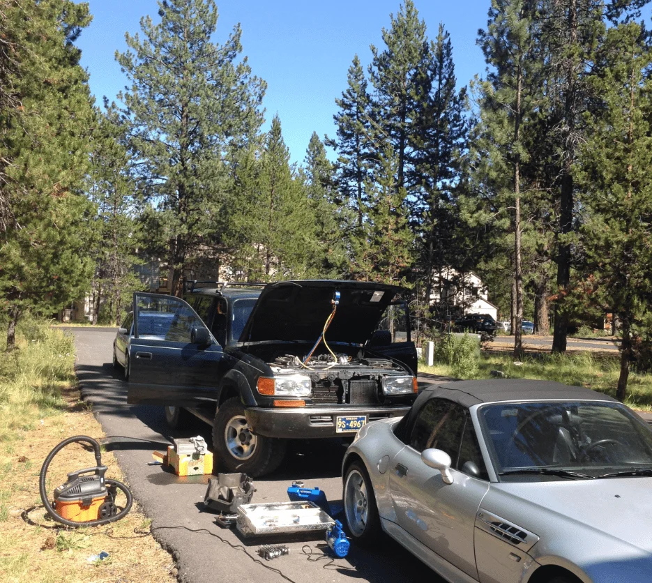

Pulled out the AC evaporator and blower fan for a deep cleaning. Replaced the expansion valve, drier, some O rings and vacuumed and charged the system.
AC went from non existent to freeze you out cold (40°F vent temp).

I'm actually in the middle of this. I'm stalled on waiting for the new compressor to arrive. When I pulled the evaporator and saw how dirty it was I immediately turned it over trying to shake the mesquite leaves out. I spilled a good chunk of the PAG oil (I'm guessing) out all over the drive way. :lol:
I'm trying to figure out how to proceed. Spill the rest out on the drive way and add the correct amount is what I'm thinking. I've never done this and have no clue
