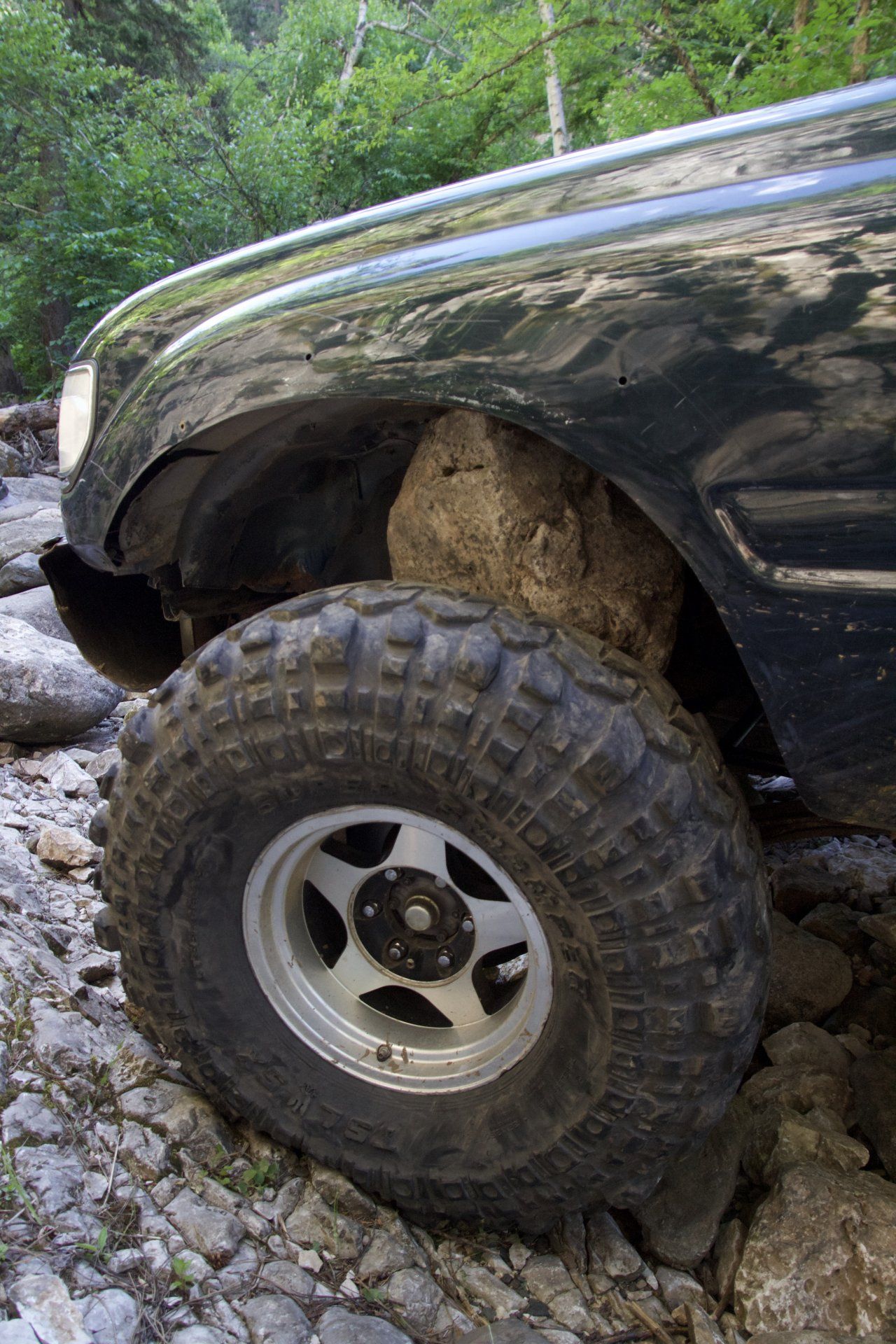

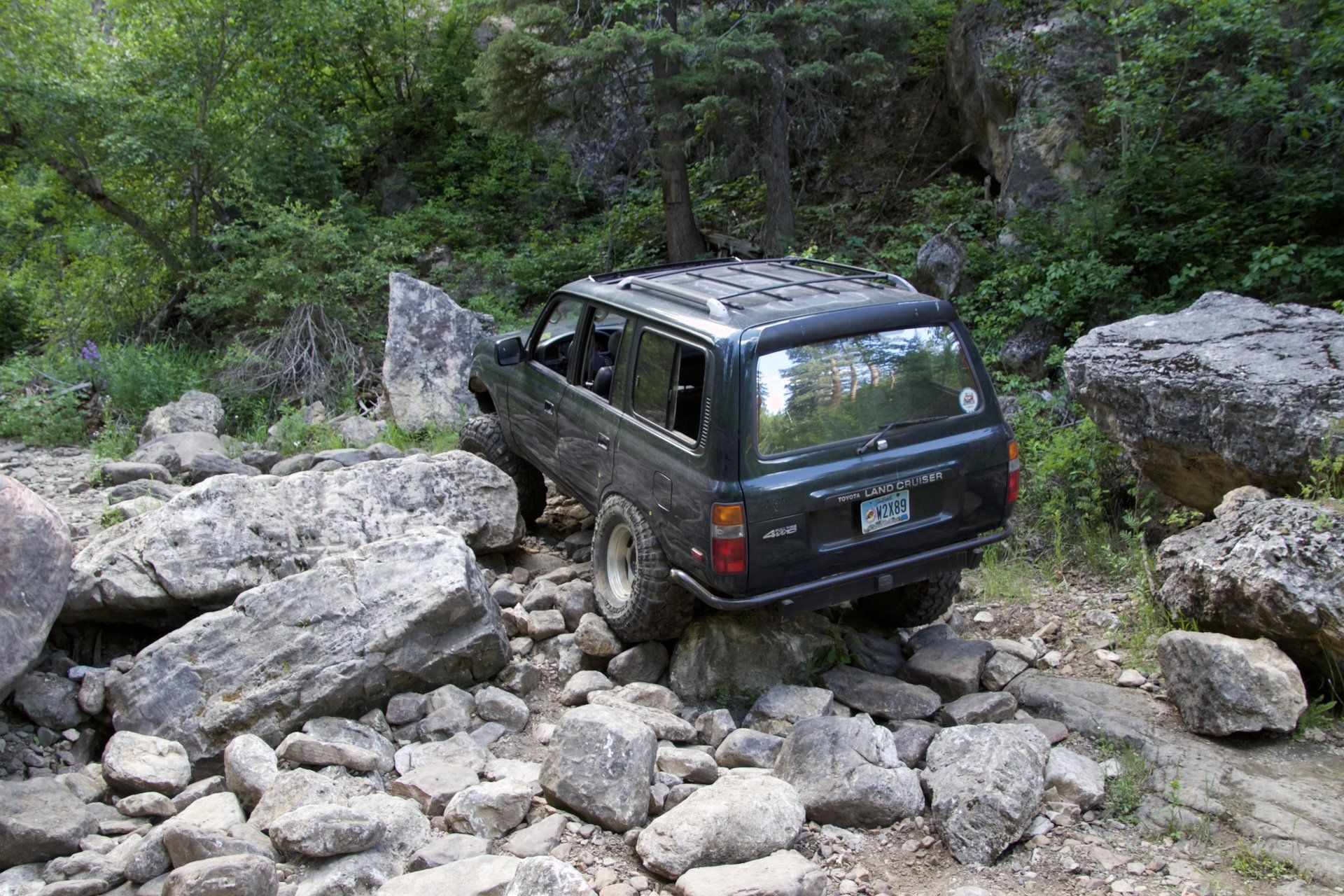

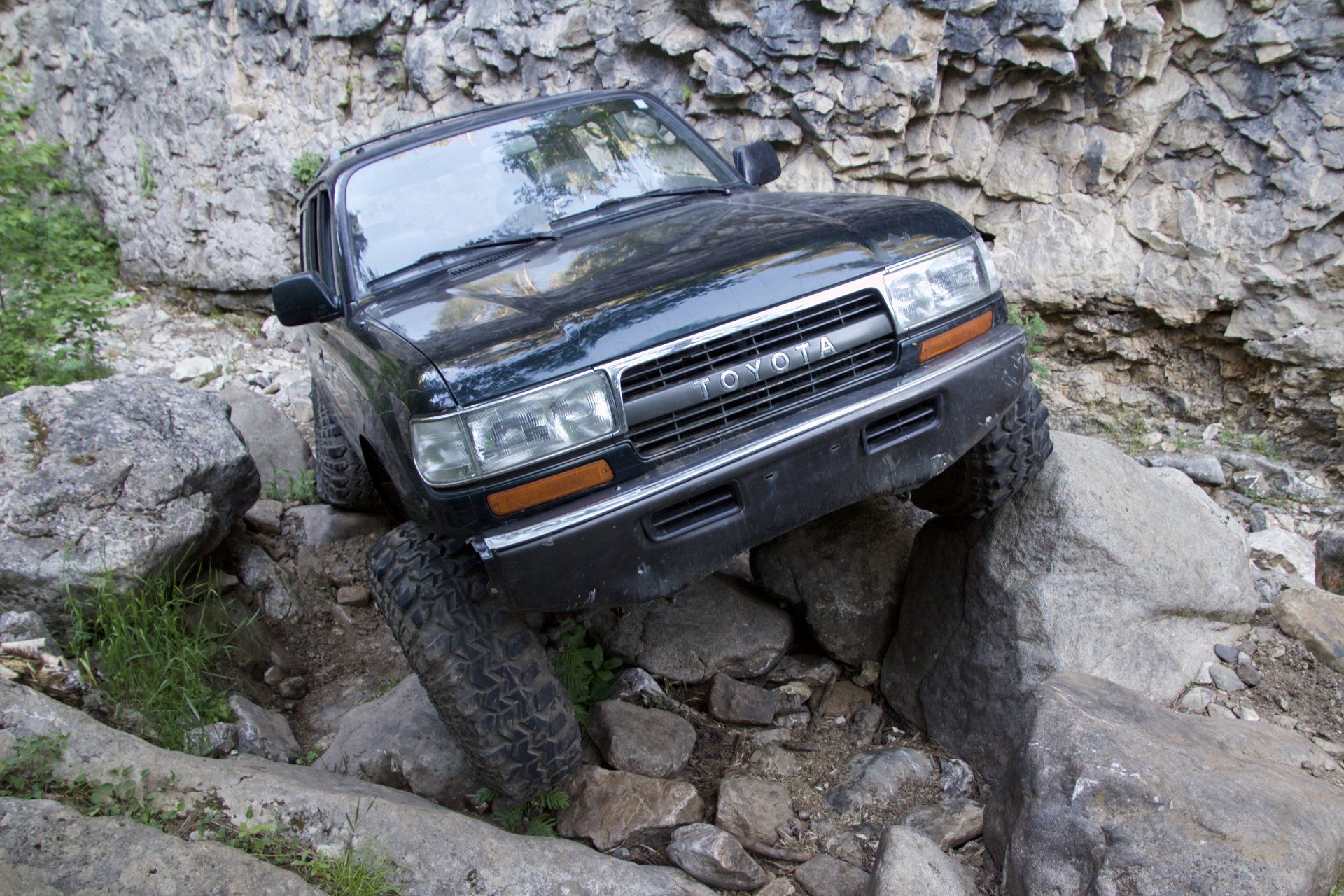

Tried getting to Wheeler Lake just north of Alma this weekend with the TLCA Club from Fort Collins. Never made it to the lake due to snow and then ran to Mosquito Pass for fun even though we'd know it would be closed at the top by snow. Wheeler Lake has got to be one of my favorites. Im in the green 80 and @trout bum is in the white
