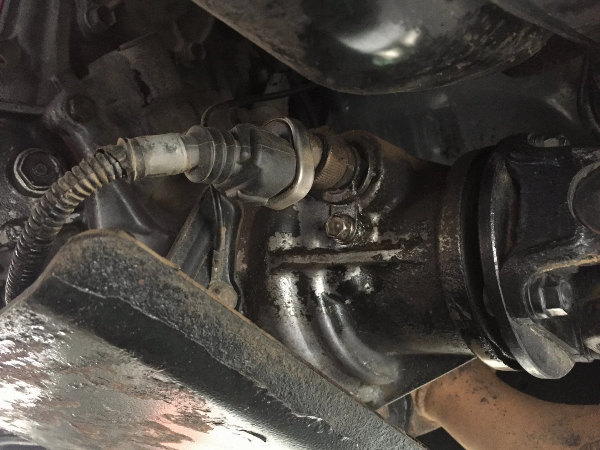

Tracked down a slow leak and found out it's from the speedo sensor. (I think)
Does this have an o-ring inside that I can replace?

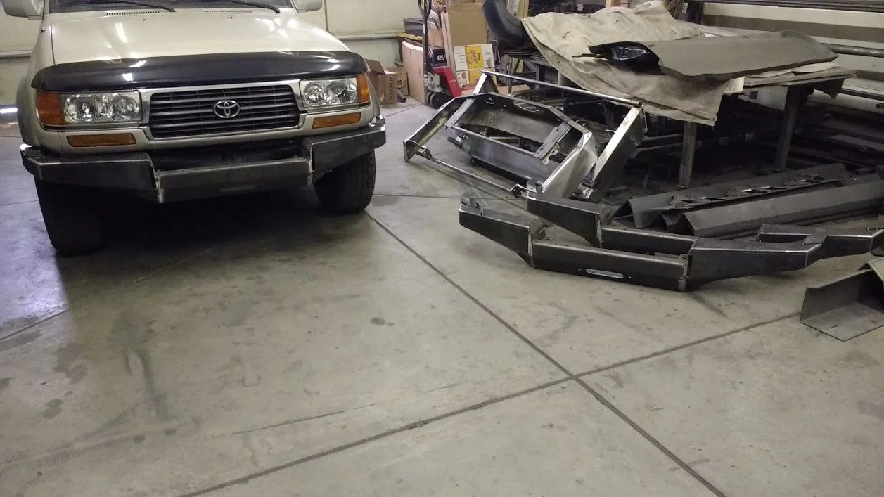

Made up some rear antenna/light tab mounts.
They are in paint now and will post pics tomorrow. I will have these in stock in the next 2-3 weeks along with Rigid Dually or aftermarket LEDs.
Also, made up a "Safe Jack" style topper for the OEM bottle jack. These are tube section cut for optimal axle to jack support contact. As most know... any slop or play on a jack surface with a 5-8000# rig = disaster due to momentum forces. I've made a ton of these for the Rover and Jeep guys so might as well extend to the Cruiser crowd.
Thanks.
There is an o-ring on the outer portion of the speed sensor and then an internal seal that rides on the speedo gear that needs to be replaced as well. The inner seal can be pulled out with a pick and reinstalled using a deep socket. Please note the direction of the inner seal before you remove it.

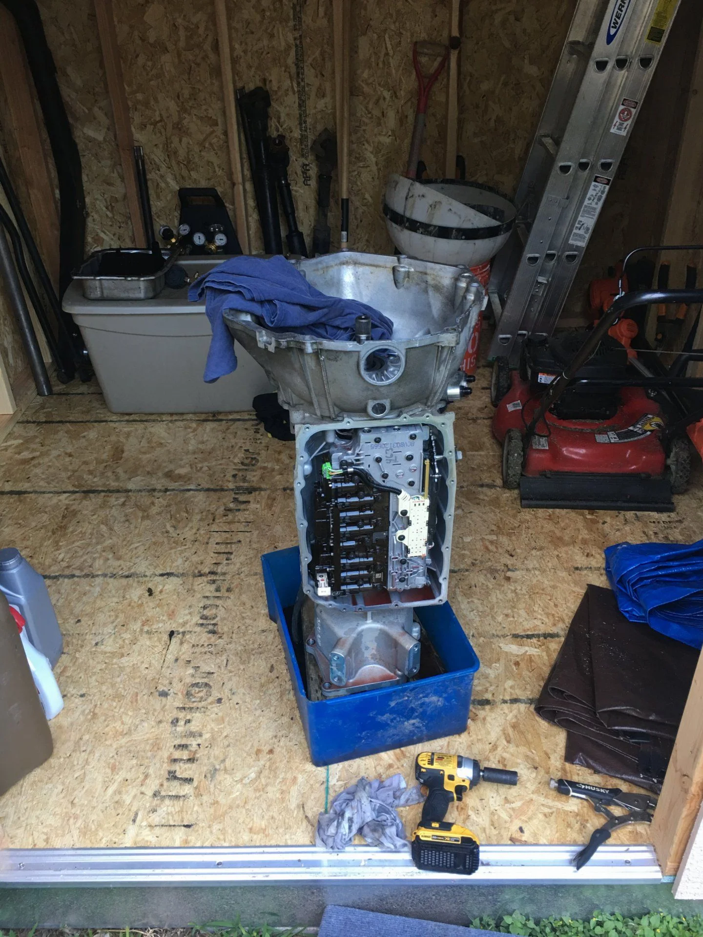

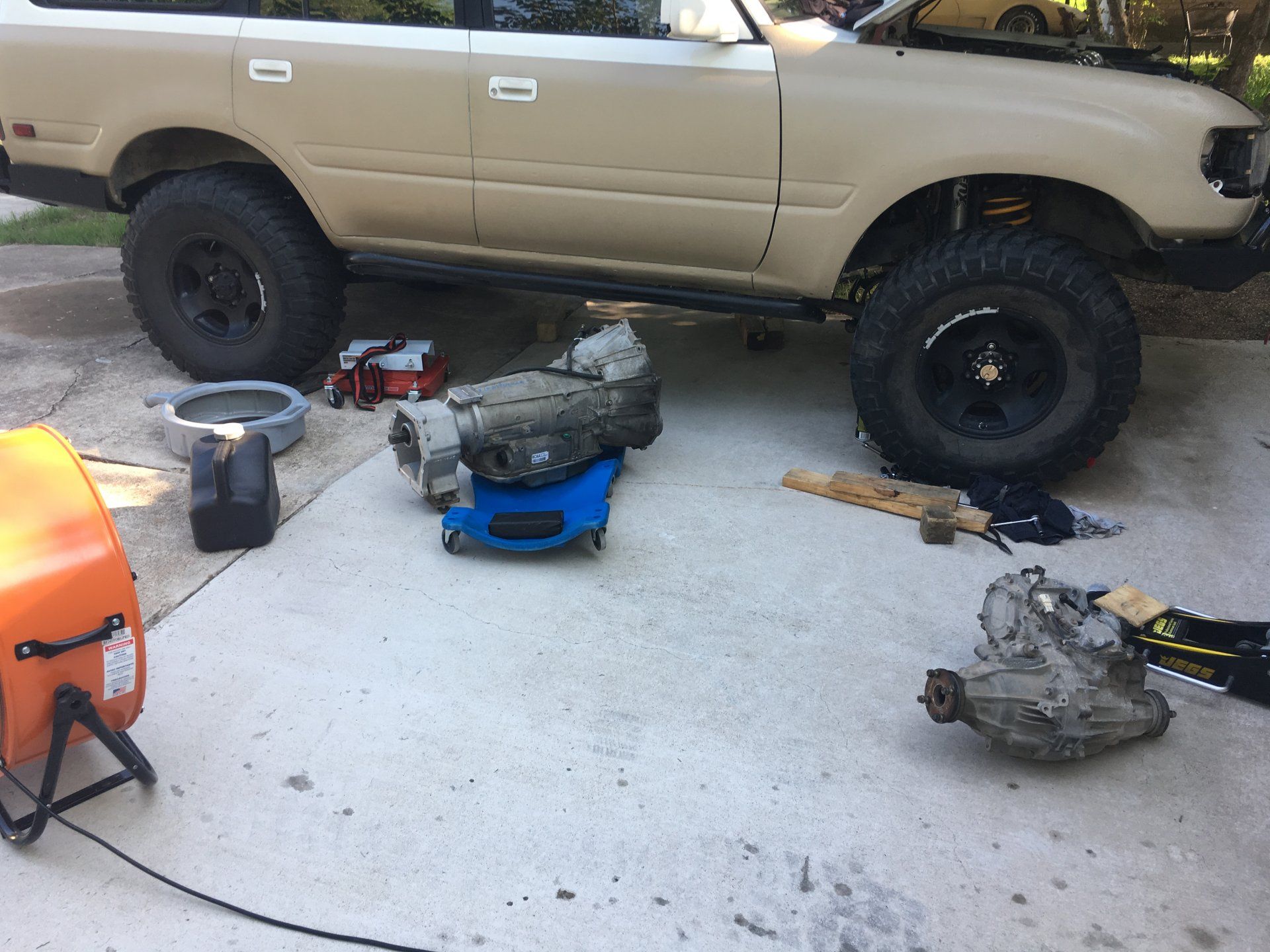

Getting quite efficient at pulling the transfer case. I'd much rather NOT have had to pull it.. but whatever. Gotta tear down the 6L80.. not many pics of that, very oily hands.. but found the cause of the 3rd gear slip. the 3/5/rev clutch had some slightly burnt steels.

Does it shift rough from 2nd to 3rd, or sometimes the engine revs up a few hundred RPMs?
It did the light throttle 2-3 flare that is common with 6L80s.. only mine didn't when cold and did when warm.. this is opposite of most others. No flare at all above 40%ish throttle. At first I figured it may be caused by the MAF calibration being so far off, but I dialed that in pretty well during the most recent trip and the shifting weirdness persisted. Then on my way up a steep gravel road in third gear it bounced off the rev limiter all of a sudden. Did that a couple times after as well. Fortunately it was acting ok in all of the other gears, but knowing third gear involves at least two clutches in the transmission, and both of them impact other gears, I babied it along to make sure it got home.
Now knowing it was the 3/5 clutch I'm REALLY glad it got home. On the freeway it gets into 6th quickly but it doesn't take much throttle to downshift to 5th for hills. I didn't notice problems, however. Was even logging "transmission slip" in HPTuners to keep an eye on things and didn't notice anything other than third gear.
It's an inherent problem with all the ZF derived transmissions.
I read somewhere the solenoids go bad, mostly due to too much heat.
It can be reset, but the problem will quickly come back.
Mine is a ZF and it does it when the engine is still cold, but under heavy acceleration it's not there.
Even when the engine is warm up it can do it under very light acceleration. The slippage is only there when cold (sudden RPM surge).

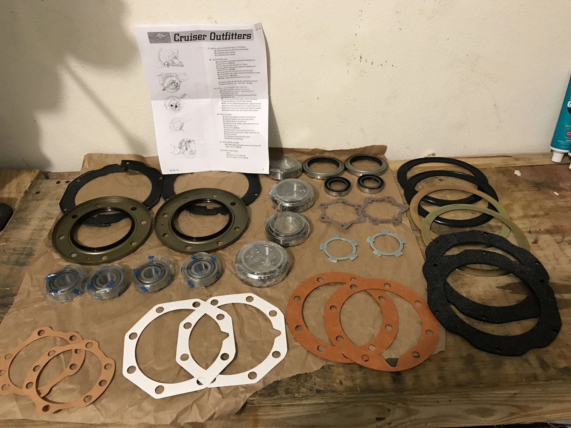

Needless to say, this weekend I'll be replacing the bushings in the bar and the bolts. This will then snowball into the overhaul of all the rubber underneath as most is cracked and or original.
Oh and yes, I need to do a full knuckle job but that will have to wait for now. (Sadly the kit is sitting on a shelf waiting to get installed, just need time)
