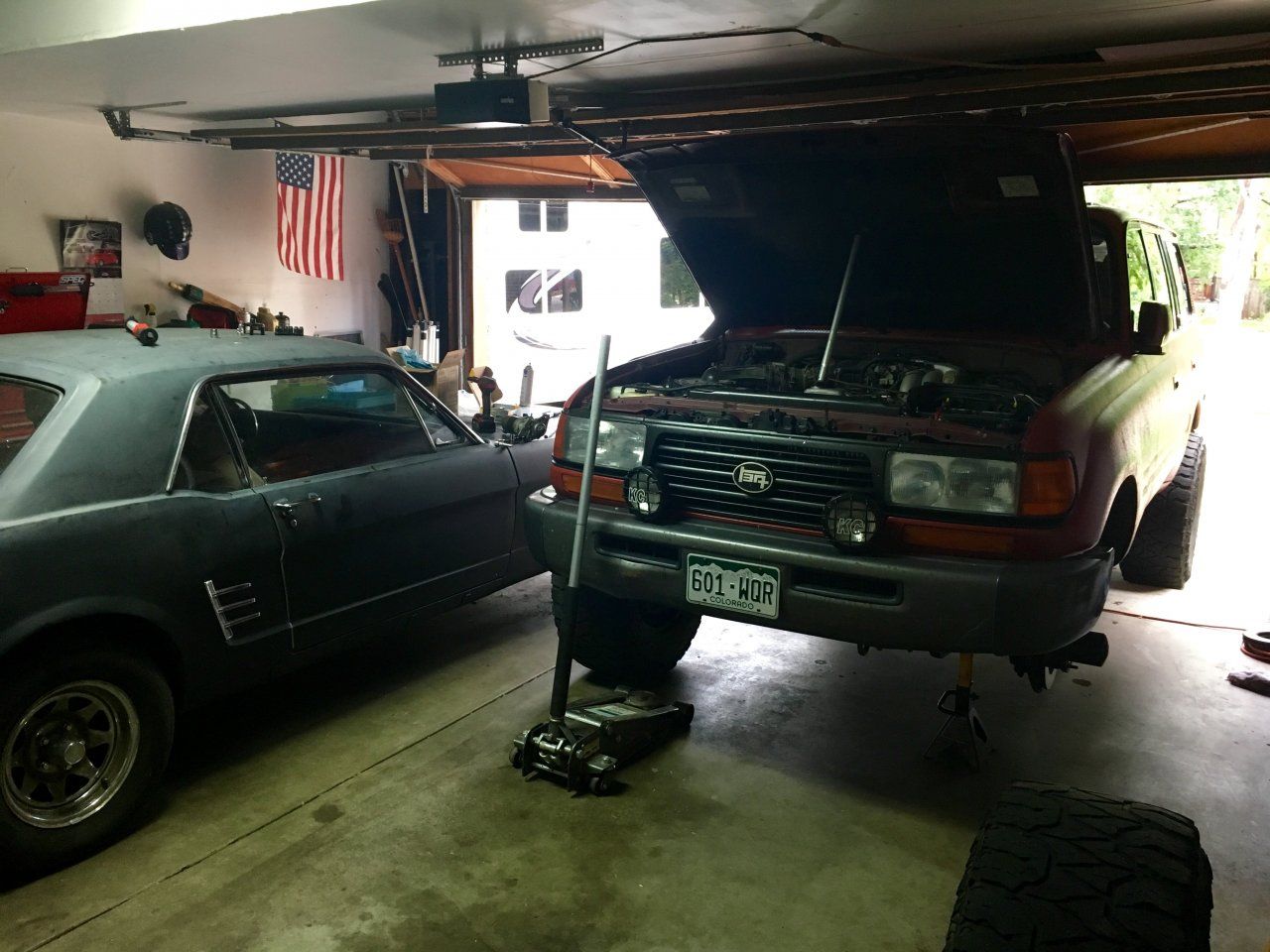

Spent all weekend cleaning out the garage, but it was worth it now that I can work out of the sun and rain. I also immediately got to use my re-found work space to change the oil and replace the failing starter on the cruiser.

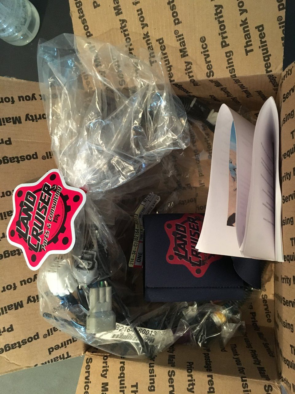

Thanks to @beno for the front wiring harness so I can be officially 3X locked.
More importantly, THANK YOU to @beno for his unmatched knowledge. Incredible the wealth of knowledge he has. Excellent service.
And a cool koozie thingy and sticker! WOOHOO!

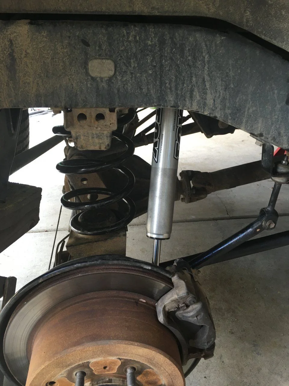

Finally got lift kit on with Fox Shocks and OME 851 Fronts and 860 Rears. Almost 3 inches in lift. Rear is around 3/4 inch taller then the front so spacers will have to be added eventually. Do not think it is all to noticeable/bother me to much (however only been on for a few hours) so not a huge priority.
Rides much better and looks much better. No castor correction yet or steering stabilizer installed but does not drive all to bad so far (only took it up to around 50). 33s quickly went from looking big to pretty small....
Big thanks to @Nay for helping with the install.
Finally got lift kit on with Fox Shocks...
Love my Fox's, but take my advice and get the rock spray guards for the rears. They are not expensive. I hadn't even hit the trail yet and found a small nick in one of the rear shafts. Had to modify my guards to fit, wasn't a big deal. Just had to cut a little bit of plastic off the bottom to clear our large lower mounting bolt and washer.

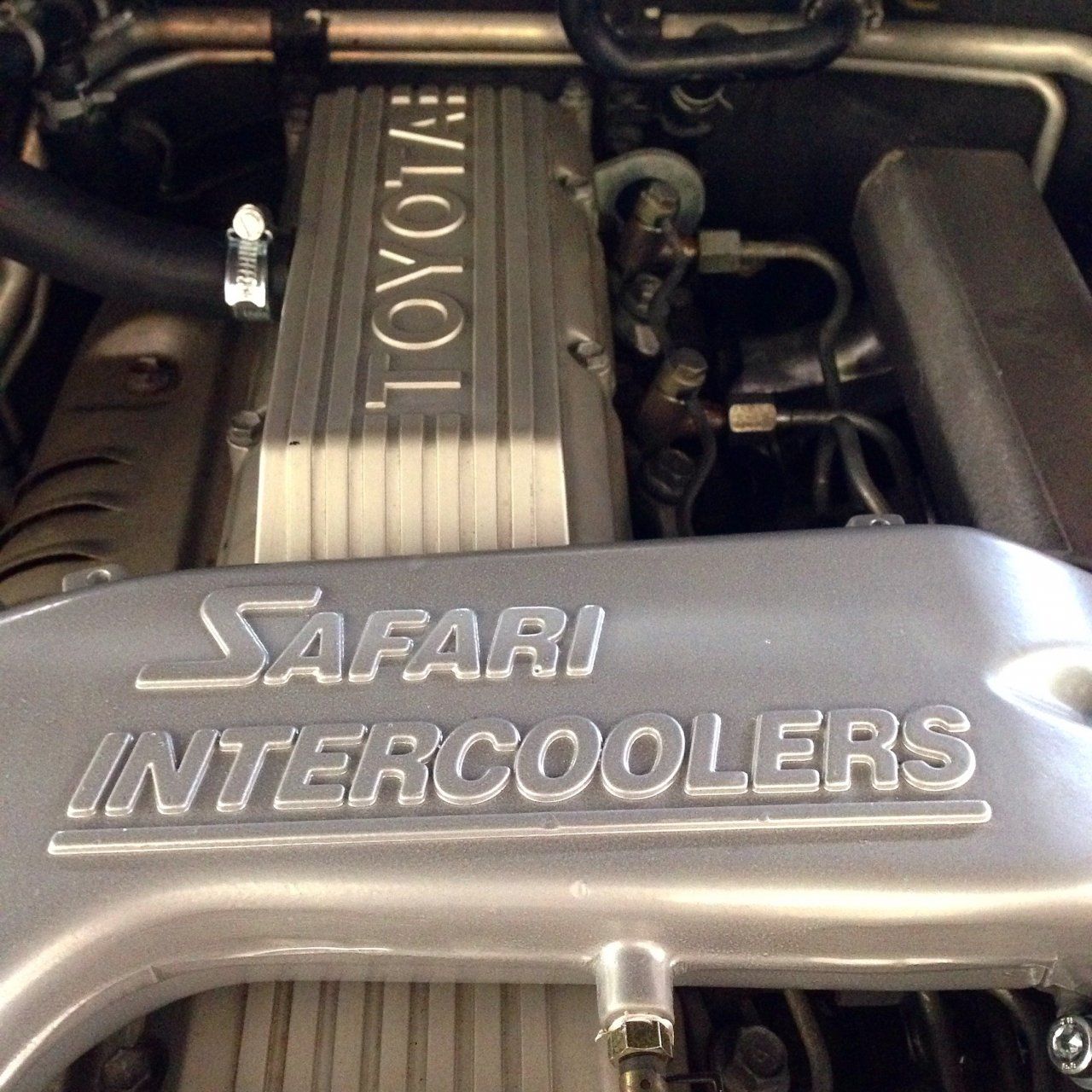

A few weekends ago I finished my safari intercooler install
