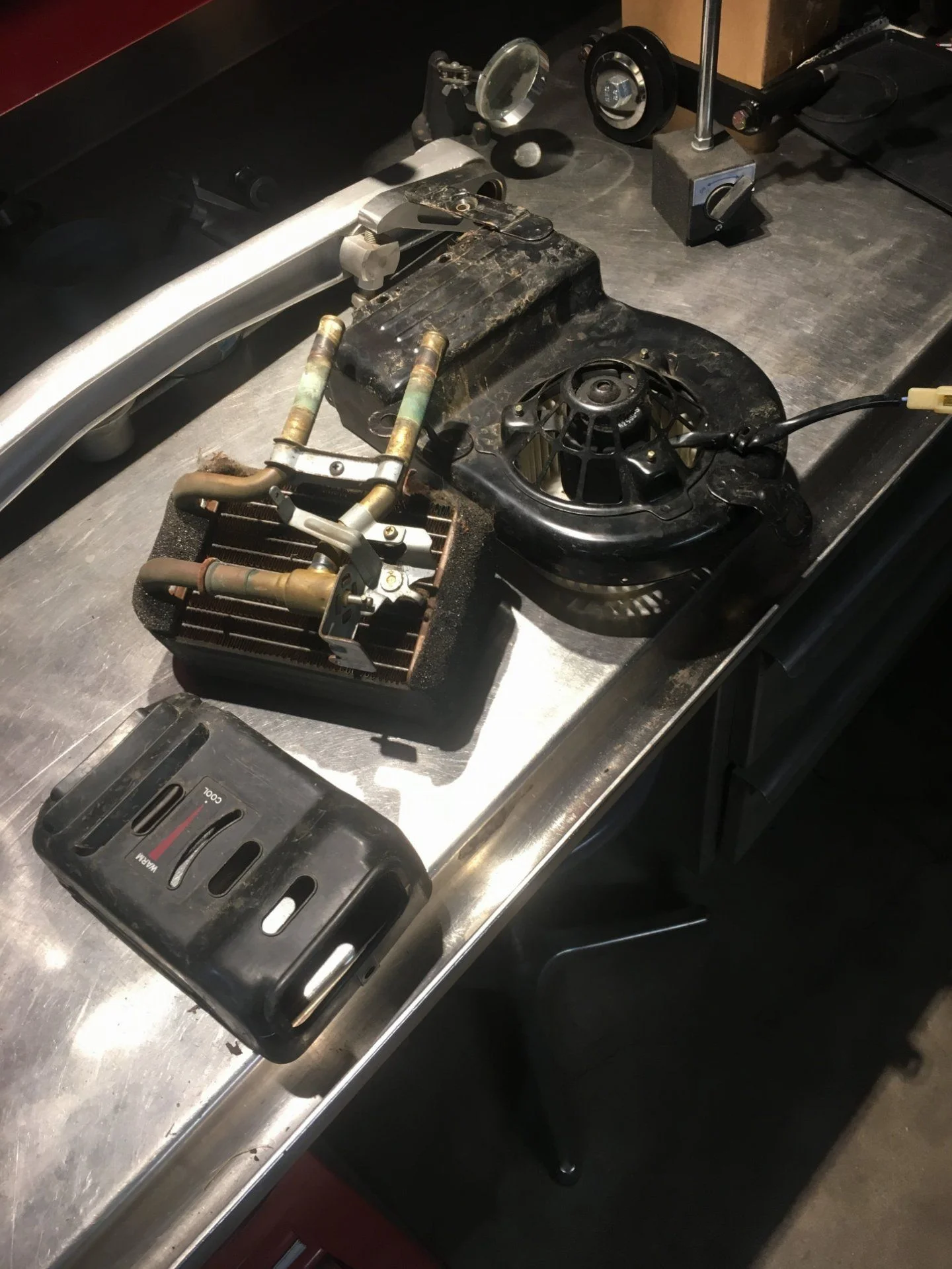

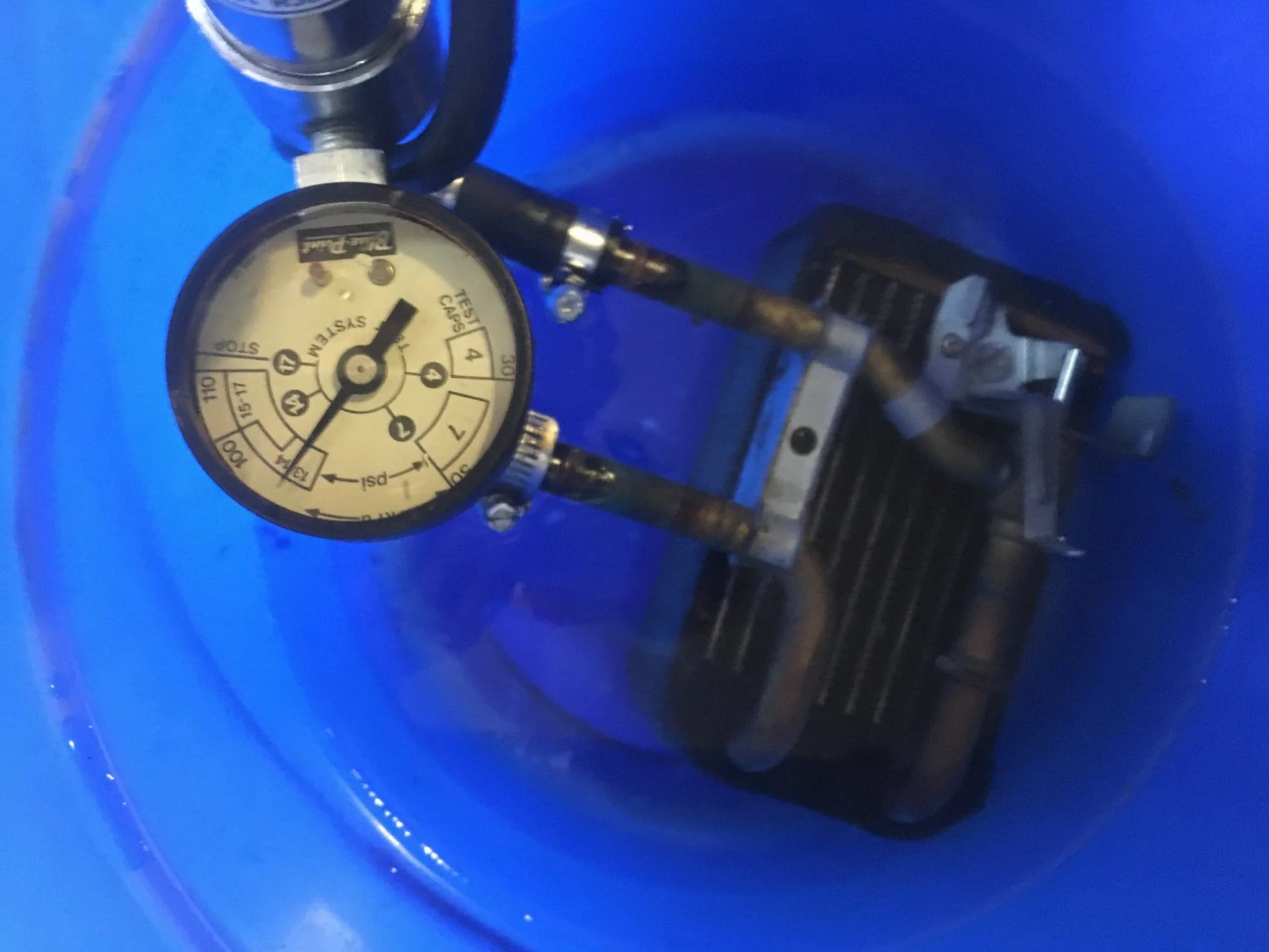

Cleaning and testing the rear heater I bought . It hasn't had one since I've owned it. No bubbles, yay.
I wonder if the knob for the valve is still available from Toyota?

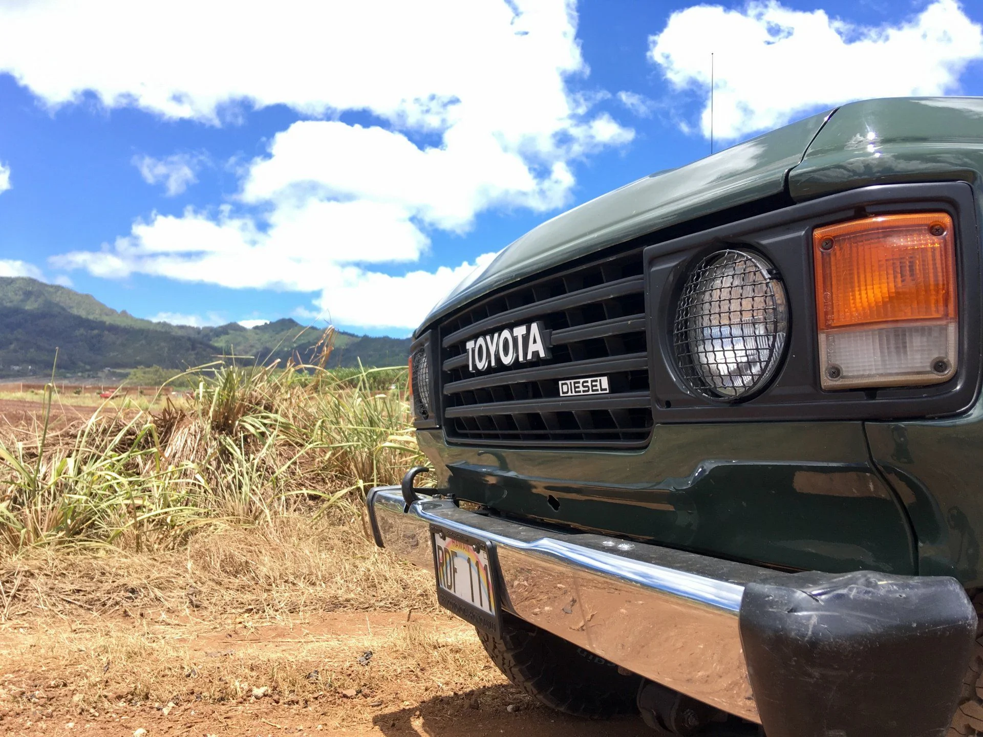

Having some cooling issues with the 60 running a little hot. But only when blasting AC and slowing down/idling. No overheating on highway driving with AC on. Fan clutch was the only thing on the cooling system that we didn't replace during the cooling system overhaul, so it's looking to be the likely culprit.

I believe the OEM Aisin/Asco fan clutch is FCT-058 for your H motor.
Thanks, I will look into that. I do have a small bottle of the 10K silicone oil, so may try to see if that fixes it before buying a new one.
10K is good. I'm about 10.6k with a lower stat setting. it runs a lot, but I haven't felt like it's hurt anything, and I'm not afraid of the heat anymore...if you can't reset the timing, slightly more csk is what I understand the AZ guys are doing to keep the condensers cooled at stoplights in the desert heat. I have heard as much as 15K, but think somewhere between 10 and 12 is just fine for where I'm at. 105*+ summers...
