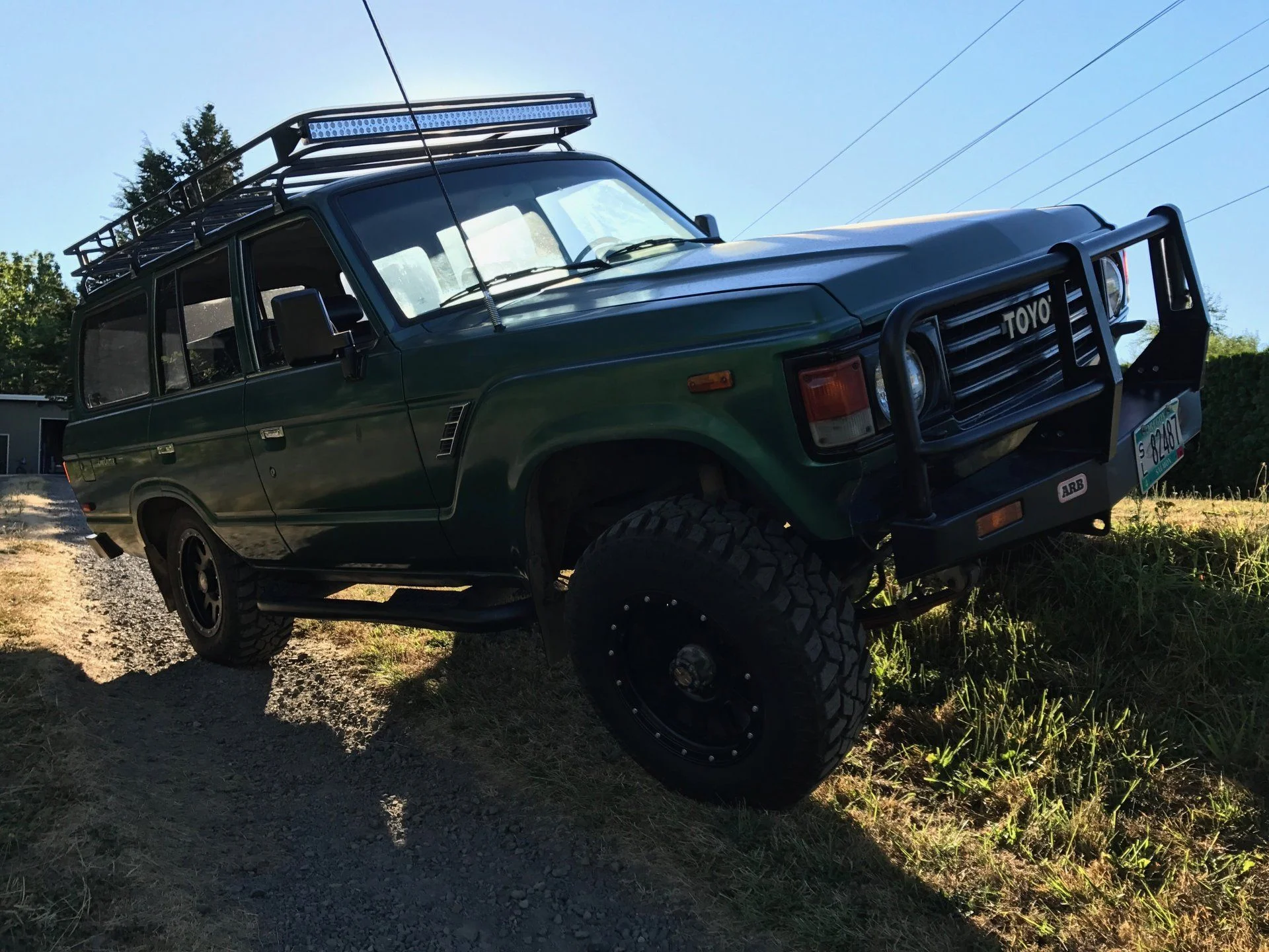

This is really the culmination of about 4 weeks worth since acquiring it.
Issue: Power steering pump pulley was rubbing the upper radiator hose.
Cause: Man A Free bracket installed without correcting the Saginaw pump to a proper Toyota pulley.
Repair: Replaced MAF Saginaw setup with new Saginaw kit (Georg @orangefj45 @ Valley Hybrids and Cruiser Brothers) (Pump, modified bracket, adapter bracket from George, his high-pressure line), air-pump delete idler pulley from Jim Chenowith @FJ40Jim (TLC in Lancaster, OH). Previous Owner (PO) eliminated OEM power-steering pump bracket + air-pump adjustment bracket. Replaced missing air-pump adjuster bracket with used-OEM from www.sor.com (great service). Also replaced upper-radiator hose with OEM from @orangefj45 @ Cruiser Brothers.
Issue: All lights not properly working
Cause: Blown bulbs, shorted wiring, PO installed headlight relay mod with poor connections.
Repair: Removed all corroded connections, replaced/repaired wiring as necessary, re-loomed wiring and tucked as aesthetically desired.
Issue: FM antenna broken.
Cause: Unknown
Repair: Ordered CB/FM all-in-one antenna, courtesy of WagonGear.com in-stock status.
Issue: Missing light-bar from roof rack
Cause: Stolen when listed for sale on Craigslist
Repair: Amazon $40 light bar Amazon.com: LED Light Bar Nilight 52 Inch LED Work Light Spot Flood Combo LED Lights Led Bar Driving Off Road Lights,2 Years Warranty: Automotive(52") + OEM Toyota Fog-Light switch Amazon.com: Toyota 00550-35976 Fog Light Switch: Automotive.
Issue: Stumble, miss under throttle between 1,500RPM--2,500RPM.
Cause: SMOG vacuum routing
Repair: Followed forum here: My Desmog Thread
Issue: Pressurized oil leak coating passenger side of engine compartment.
Cause: Multiple signs of multiple leaks.
Repair: Replaced leaking, non-hose-clamp, non-spring-clamp, PCV valve hoses, PCV Valve, air-cleaner vent hose (back of engine compartment on air cleaner), plugged air-cleaner with @FJ40Jim de-smog kit. Replaced Oil-cooler gaskets & O-Rings, ensured lines sealed and non-leaking, saved OEM replacement for later inspection/replacement as needed. Removed fuel pump, cleaned engine block, replaced spacer plate with OEM found on Amazon Amazon.com: OES Genuine Fuel Pump Flange for select Toyota models: Automotive. Tested OEM fuel pump per FSM and passed test. Reinstalled OEM fuel pump with new gaskets obtained here Amazon.com: Airtex 1414 Mechanical Fuel Pump: Automotive. Now carrying aftermarket fuel-pump as a spare. (235K miles on OE pump aint bad!).
Issue: No A/C. Compressor was diagnosed by Capitol Toyota (Salem, OR) as leaking.
Cause: Bad compressor
Repair: Replaced compressor with Denso found here Amazon.com: Denso 471-0204 Remanufactured Compressor with Clutch: Automotive and Denso Receiver/Dryer from here 1987 TOYOTA LAND CRUISER 4.2L L6 A/C Receiver Drier / Accumulator | RockAuto. Need to return to shop with A/C manifold to swap lines, re-charge and re-test.
Issue: Install CB Radio
Cause: N/A
Repair: wagongear.com » Antenna Mount Info & Installation
Issue: Coolant drain petcock is a mess...and sucked
Cause: Just a crappy design IMO.
Repair: F103SX: New Generation Valve with 12mm-1.25 Threads
Took a long time :)

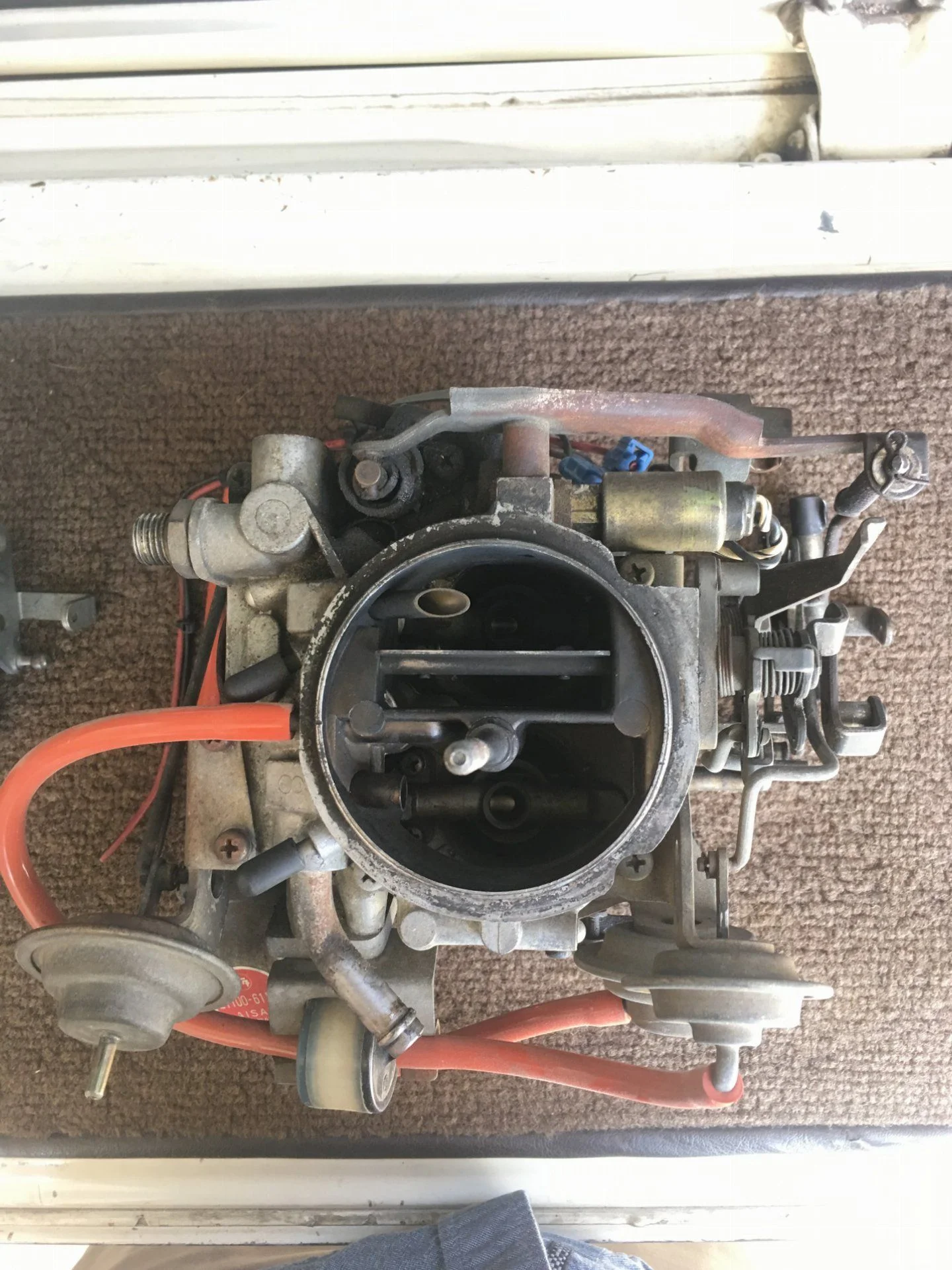

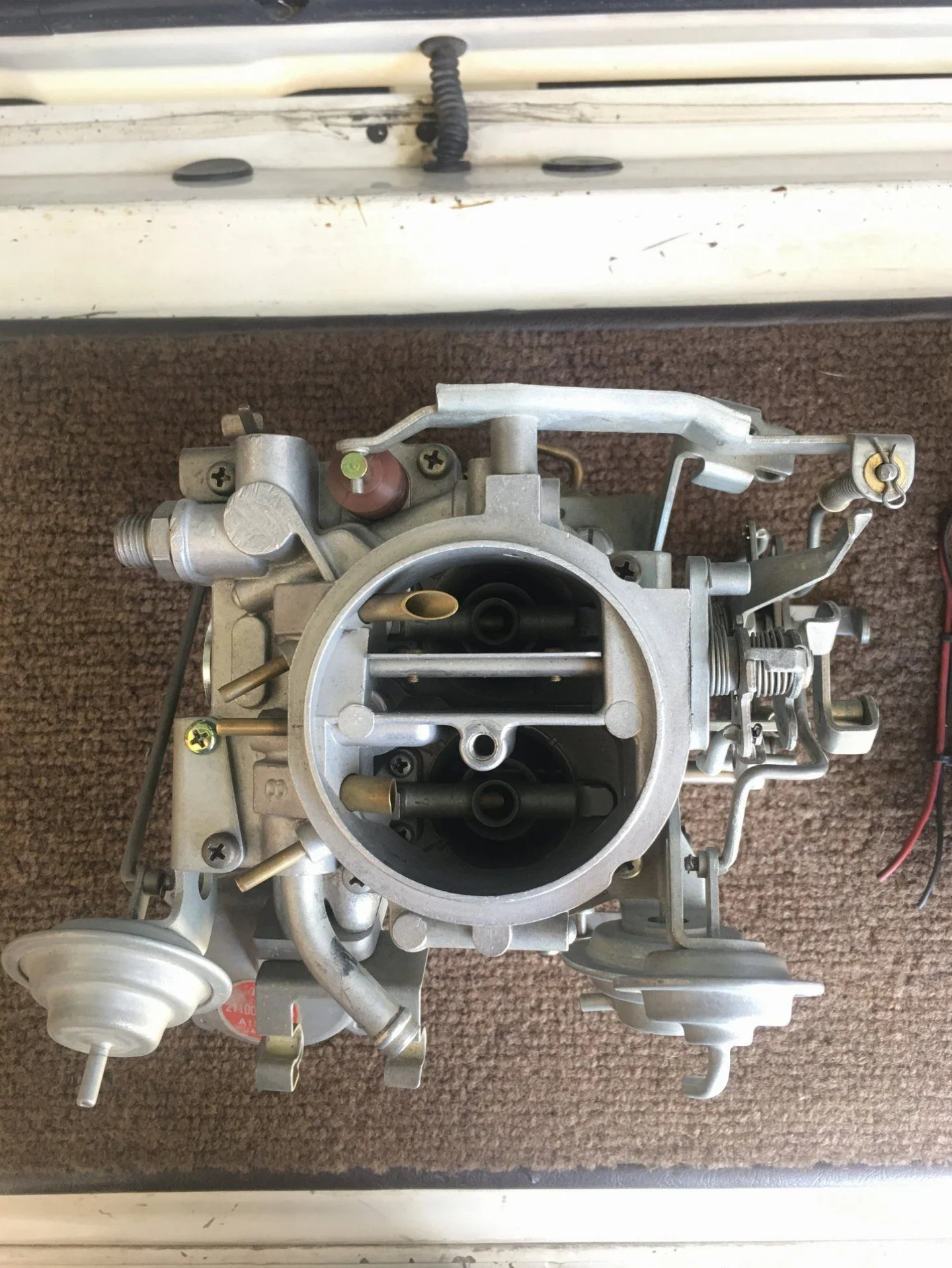

Installing the rebuilt carb. I noticed it looks like some parts were cadmium or zinc plated on my old carb that aren't plated on the rebuilt one. Anything to be concerned about? The new carb sure is pretty! Thanks @65swb45 for getting this out to me so quickly!
Cadmium plating being gone will not hurt anything. A fresh carb is so much fun:), you will love the performance once you dial it in.
