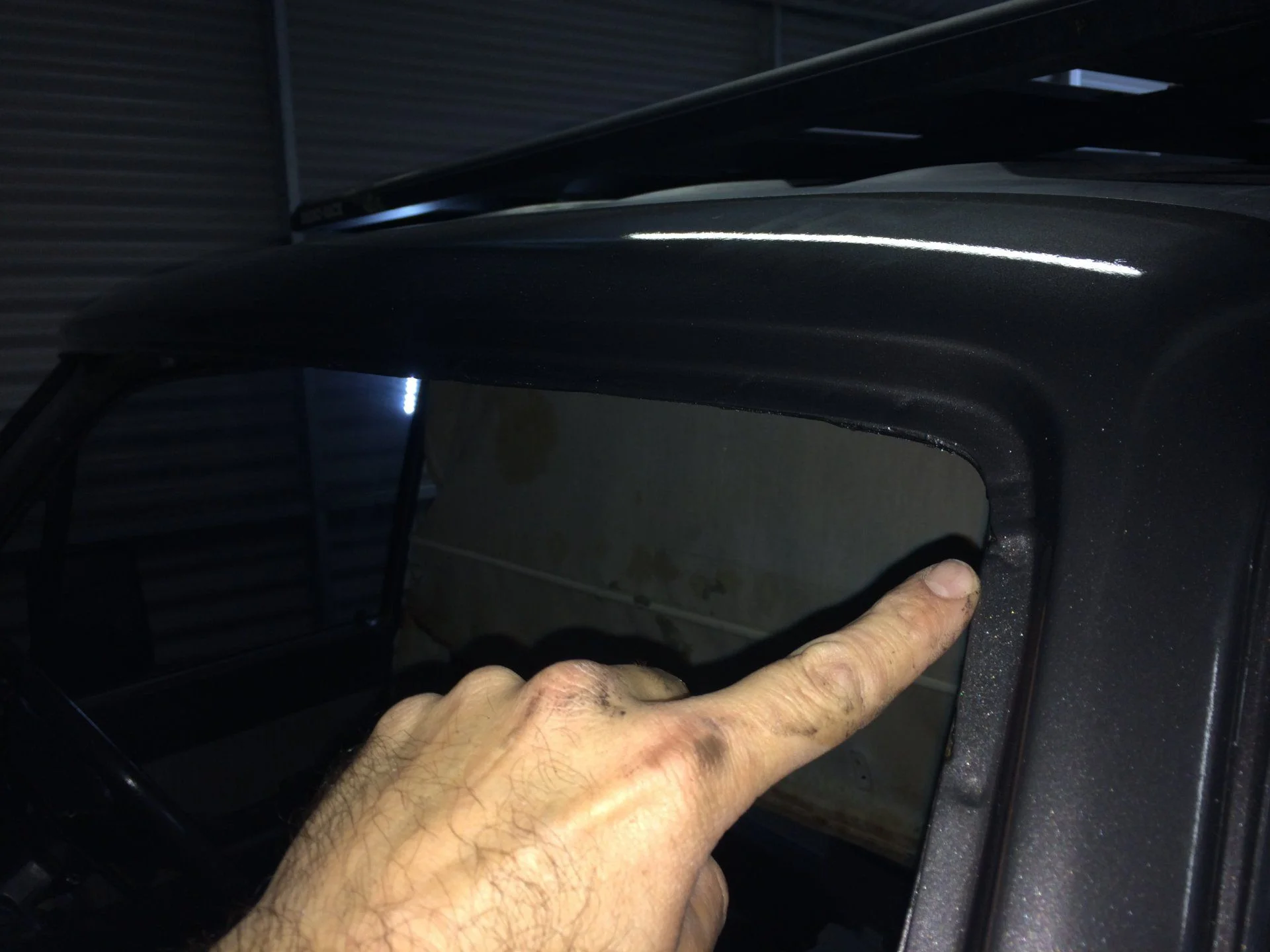

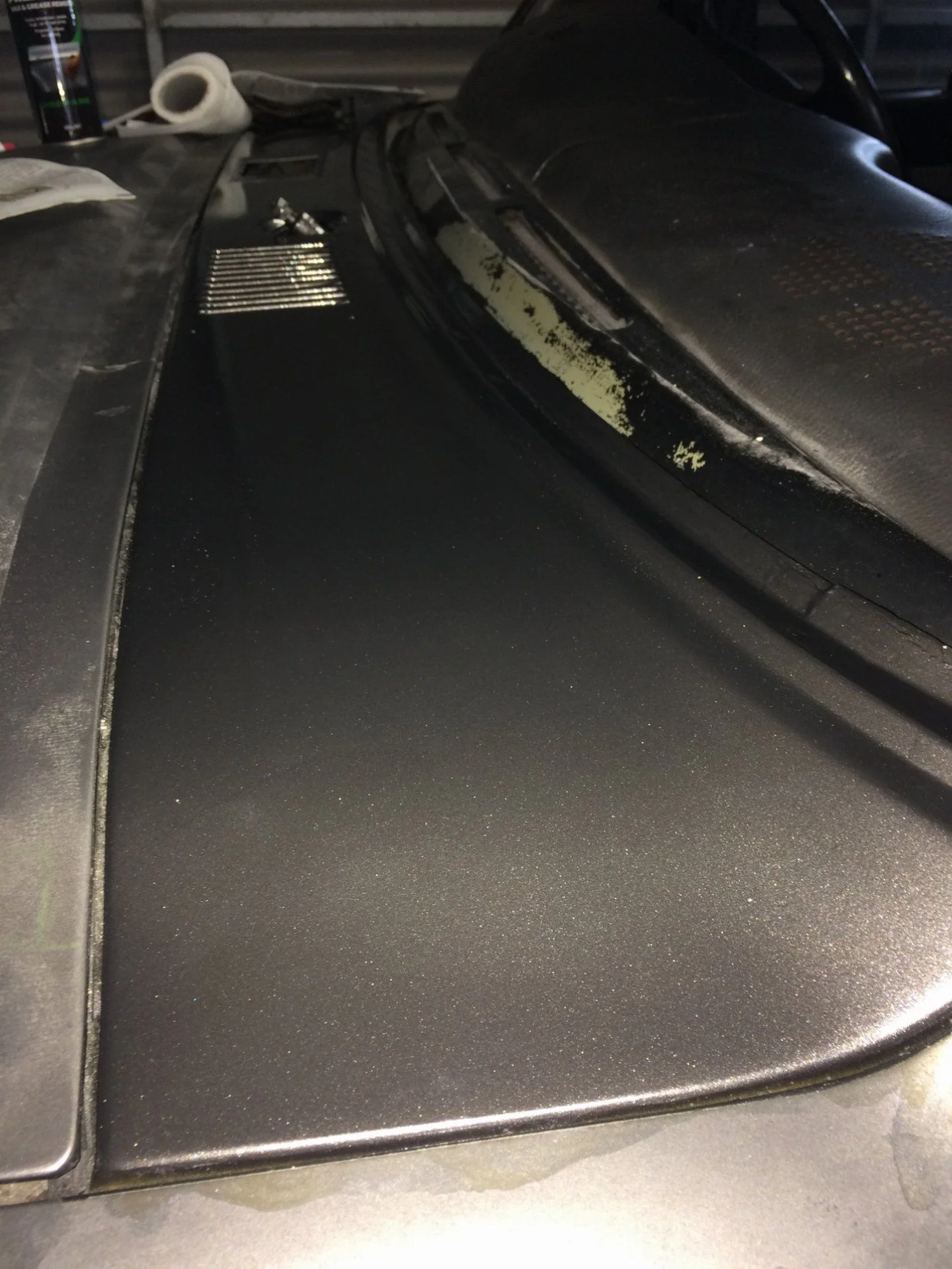

Finally got around to painting the windscreen frame! I also sprayed Penetrol into the gutter cavity while the front section of roof lining was out. Of interest was the Penetrol seeped out the seam at the top corner of the frame (where the factory braze joint is) and ran down the frame pooling in the bottom corners. This seam is covered by the roof lining section that wraps over the inner lip and runs down the windscreen frame, so no matter how much caulking a windscreen gasket has on it, if water can get there it will still leak.... (I had wet foam backing to the lining that runs down the edges of the frame prior to pulling the windscreen and just assumed it was leaking past the gasket....)

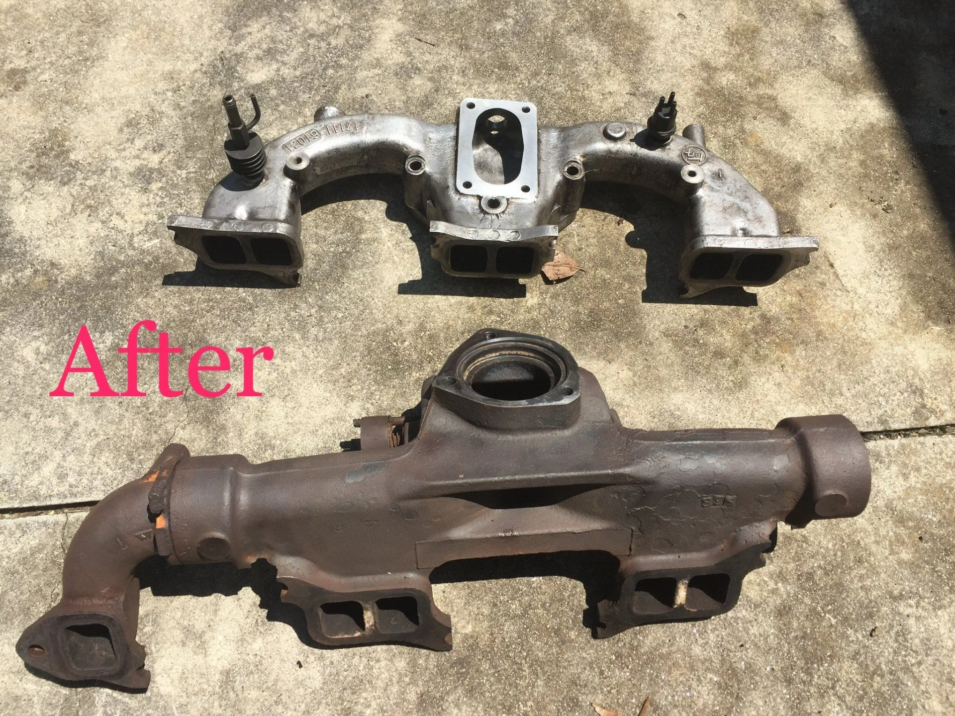

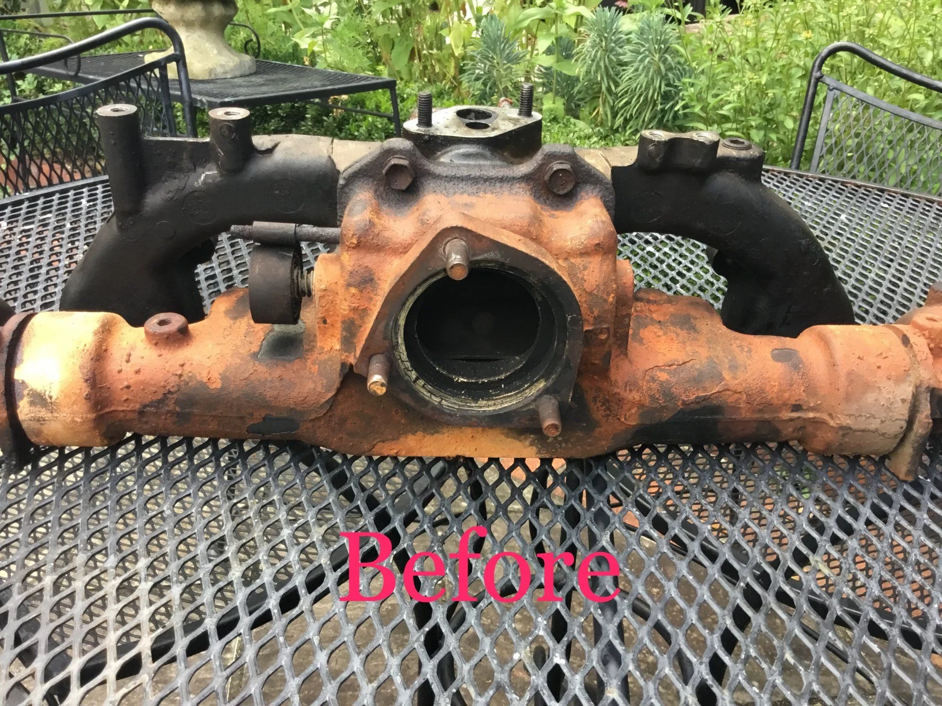

^^^seems like the thing to do. I used canolla and a BBQ cure, but it didn't hold up too long. Slip plate, or ez slide will be my next attempt
I tried coating the exhaust manifolds on the 3FE going in my '86 FJ60 project vehicle with EZ-Slide and think it turned out great. No experience on how it will hold up - just installed the engine in the last couple of weeks.
Manifold Makeover - EZ-Slide Coating Approach

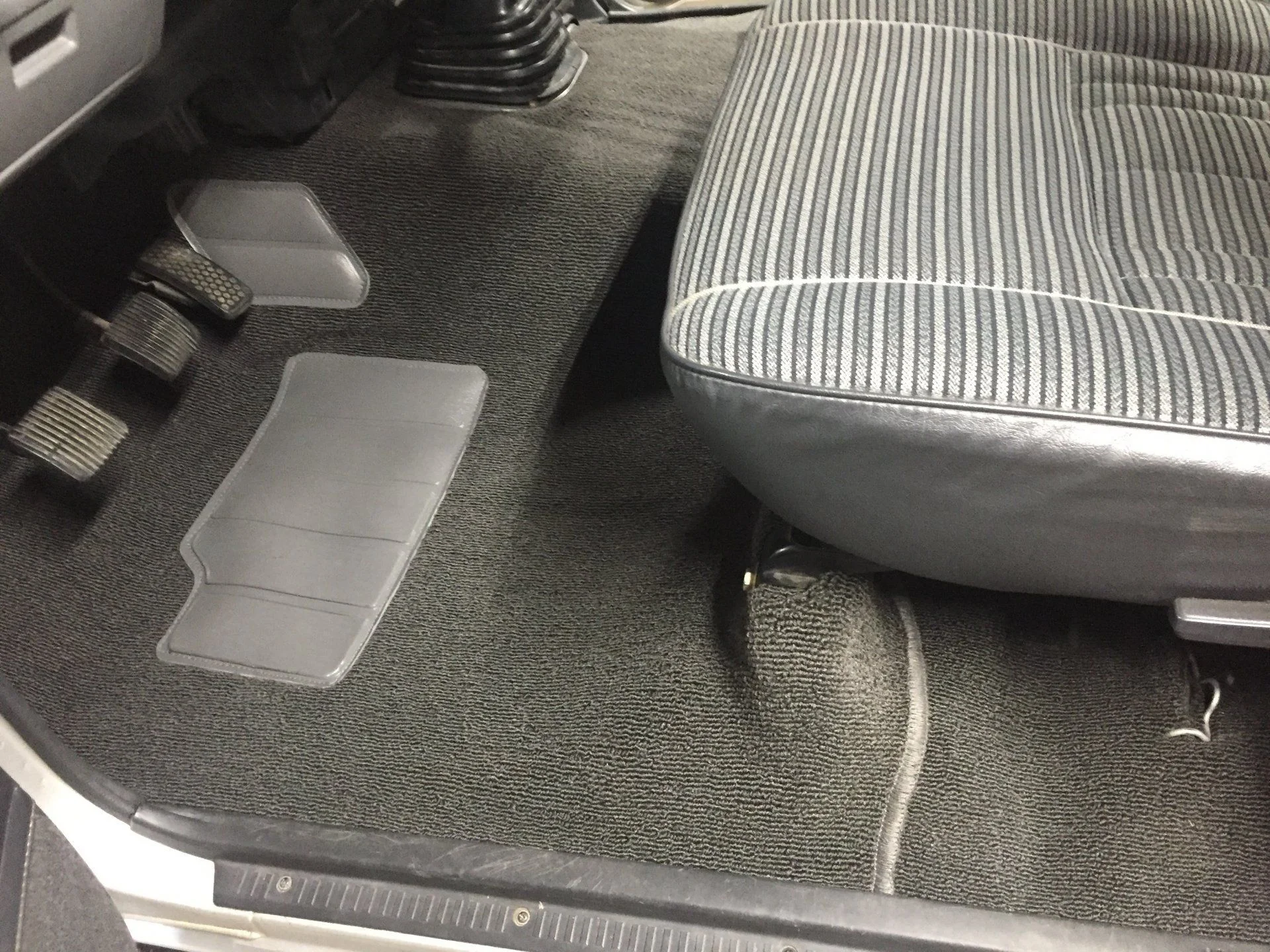

Got @dnp carpet set installed. Super nice set that has all the pieces (tailgate, rear seat back, even fender wells!) Very impressed with quality and price!
