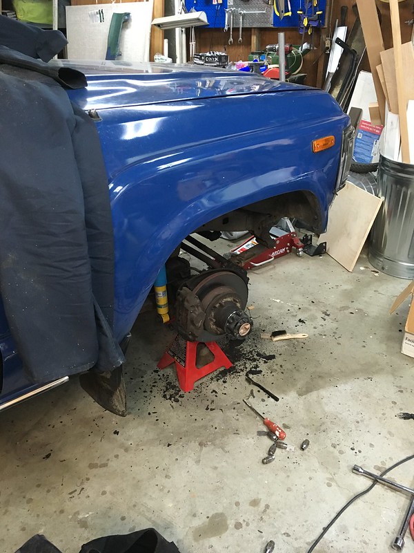

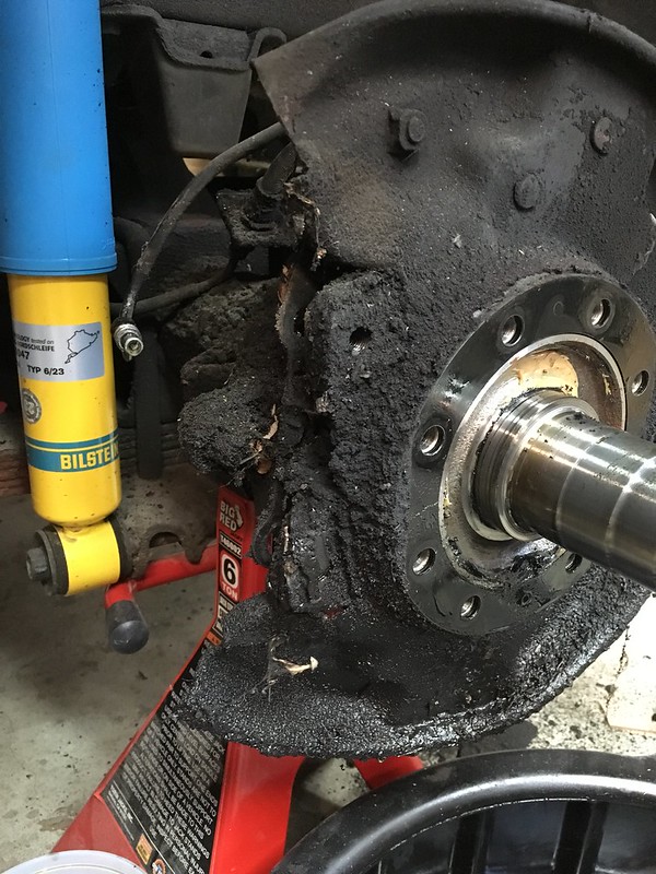

Finally reintroduced myself to the "knuckle rebuild project". I haven't done this in 10 years. No, the last time wasn't on this particular cruiser, although as you will soon see it seems none of the POs wanted to do this project.

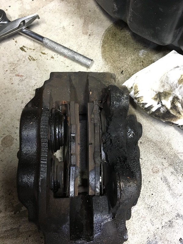

Judging by the amount of grease around the brake caliper and rotor I am not surprised how s***ty this thing stopped. Stopping on a hill was scary at best.

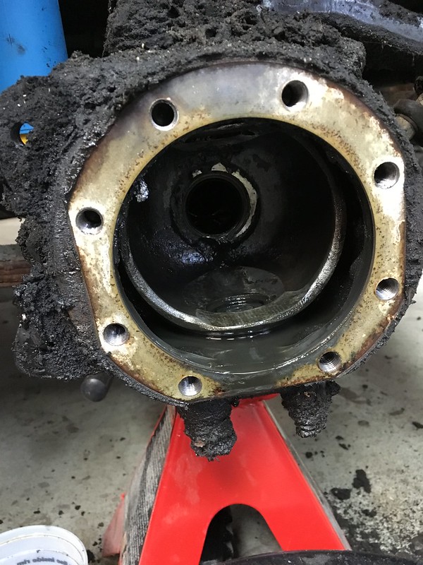

When I took the spindle off this is what was inside.... nothing, no grease! Hardly anything even dripped out.This cruiser was in serious need of some love and safety improvements.

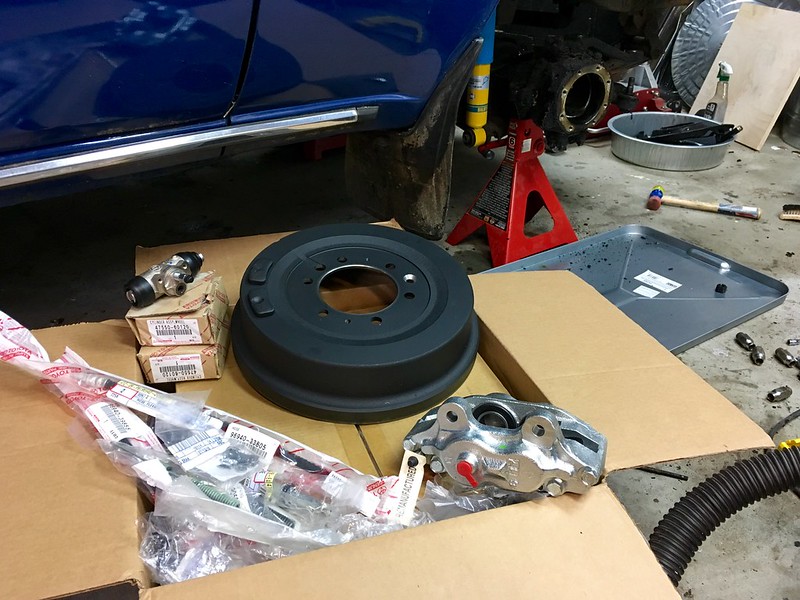

In addition to the knuckle rebuild, new tie rod ends (parts both via @orangefj45 :cheers:), all new brakes for the front and back (via @beno :cheers:) and the steering box will be sent to WTOF for a rebuild. Let the fun begin!
Just did that about two weeks ago! Loads of fun! Mine looked about like yours. I found three different types of grease in there. Someone packed the birfields with lithium grease.... I'll have to swap 'em out eventually. I'm in the middle of a clutch job at the moment. I'll post pics when it's all done.
