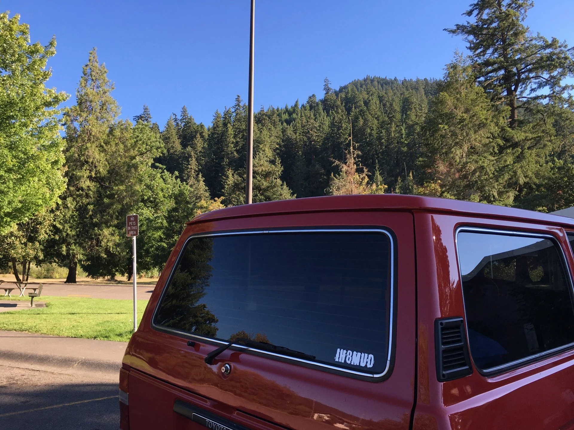

Thanks J, if I waited a few more weeks I would of saved a couple of hundys on both lockers, ( off of you). I still need to run the wiring harness to the 80 series switch and run the rear harness for the fzj axle. Hoping I can get all this done before the end of the year.![]()
Yeah it tends to take me three times as long to do a simple job. Got some time off of work to finish this part and I miss driving it.
I also installed some longfield chromoly gun drilled front axles which gave me some problems because the po did not align the axles on the last knuckle job. Which was a real pita, but I finally got it done. I figured since I was in there might as well and be done with it.
I ended up using the EBC 6000 series green stuff for the front pads. I thought I'd check them out for the first time. They seem to work well but I still have a spongy brake pedal. It'll be a few months but I plan on adding a new 80 booster, master cyl. , and rebuilt 80fzj rear axle.
As far as cleaning up all that grease and dirt off the axle housing,it took me some time. I degreased , primered/rust inhibitor , and painted.
During that time I also installed the rear hatch glass, tint , and kaymar bumper.
