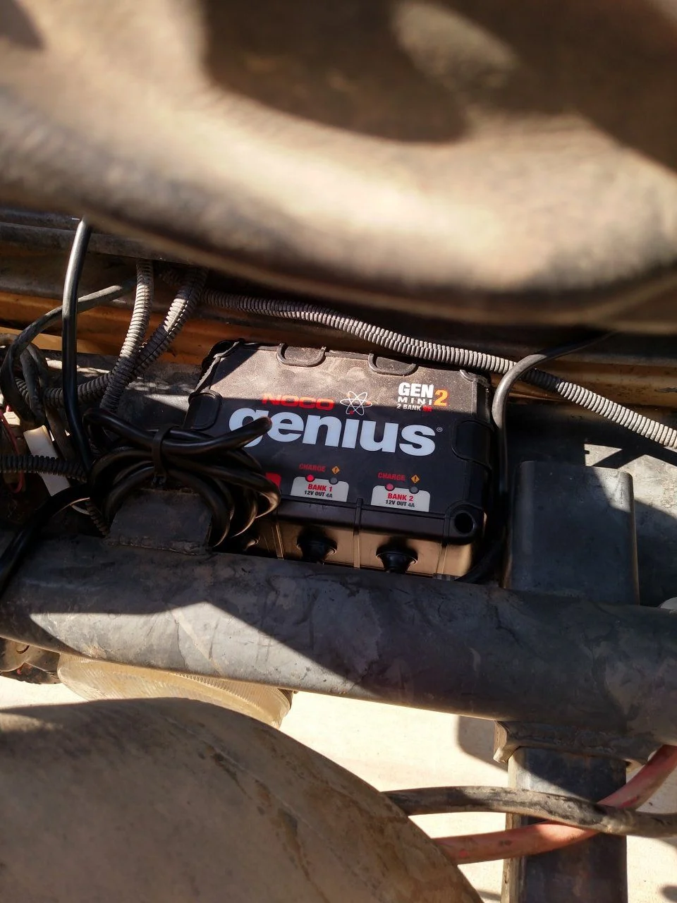

I added an on-board dual bank battery charger. I had been using cheap 1.5 amp chargers but this is a much better system.
