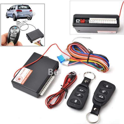

Wired up power 62 locks on my 60 today. Bought the universal remote for $11.20 off ebay. I switched out the entire latch/actuators with my manual 60 latches. There isn't a readily available attaching point in the linkage to put the actuators on the 60 latch. It can be done with some drilling or welding or some other inventive rigging but was easier just to unscrew 3 philips screws, one 10mm bolt and unhook the linkage and switch out the latch. The wireless unit box sits nicely under the dash panel fuse box. Only wires I needed to run were from the actuators to the white and white/black wires on the box. All other wires coming off the box are long enough to reach ground, power at the fuse, turn signals etc.
