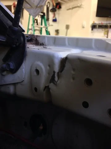

Ace could you post up a pic of your mending plate? I have rips on both sides, I plan to have my buddies shop pull both aprons on their rack (Again) to get them straight and then weld plates over both sides and also fill the inside with automotive structural foam. After my trip to the dunes my drivers side is buckled so bad the door strikes the fender when you open it.

Just a small 2" x 3" mending plate found in any hardware store held in place by HD steel pop-rivets. Seems to be doing the job so far.
Thanks Ace, good to know that's been holding up for you. My plan is probably over kill but I don't want to deal with this again.
Drivers Side Tearing
Passenger Side Tearing
Top off plate removed exposing the fender apron, I plan to tape off the (outer)side of the channel and fill with foam. I was hoping to use structural automotive foam but ironically now that OEMs are using it in manufacturing there seems to be no third parties supplying this stuff to the consumers.
Side taped off, I will use the holes in the apron that the top off plate snaps into to inject the foam. Since structural foam is no longer an option I will be using plain old expanding foam from Lowes.
After filling both sides the aprons seem much stouter. Before, I could crush them with my bare hands like an aluminum can with the top off plate removed, and when I grab the turn signal I could pull up and down and see the apron flexing at my tear points, I cannot bend it or cause it to flex now.
My next step is cutting a plate of 1/8" steel to run the length of the apron. There are a few used and unused threaded inserts in the apron that I will make use of to attach the plate. Ace, I think I will use your rivet idea as well. After looking at how astonishingly thin the aprons are I don't think I could weld it without just blow holes right through it.
