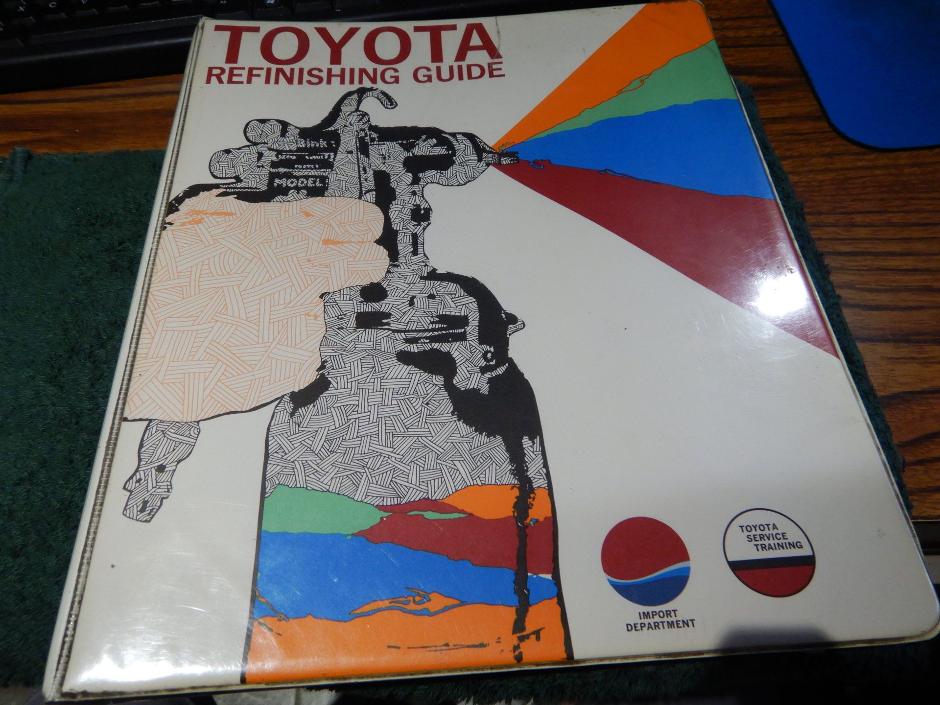

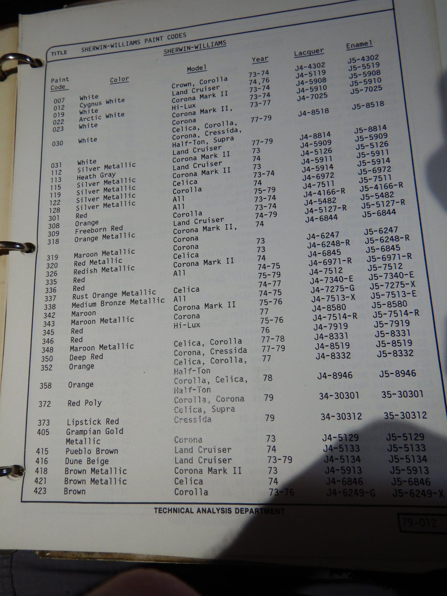

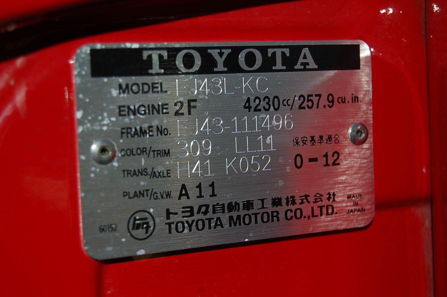

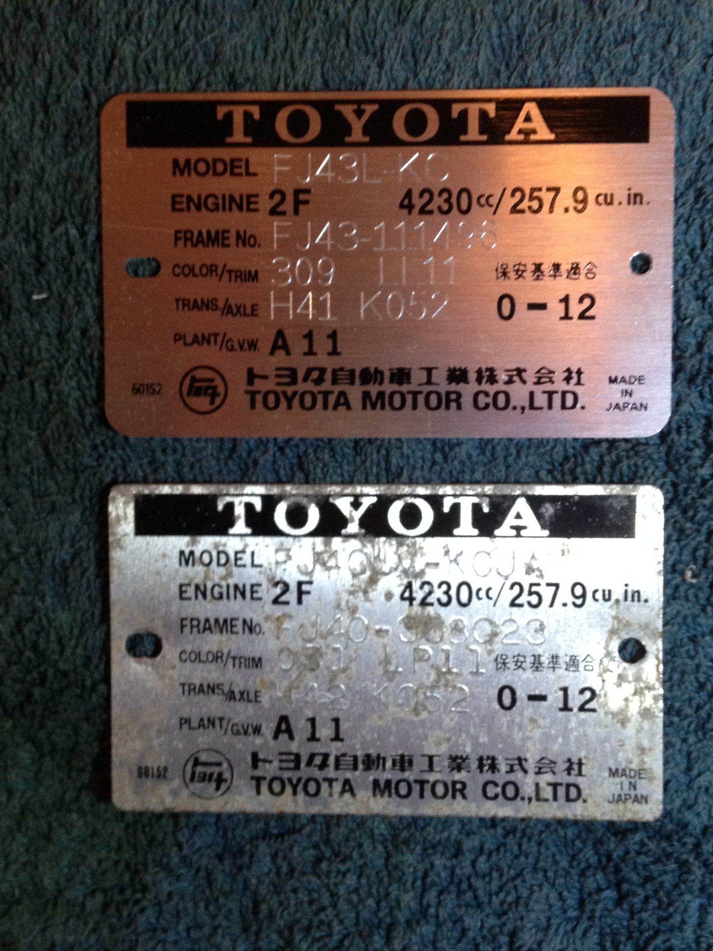

those were shot with a NIKON D-50 , partly cloudy day , but vehical in shade , & NO photo-shop
sorry to hijack the 60 series forum , but great lengths were taken to match 309
I used Sherwin Williams Enamel J5-5127-R

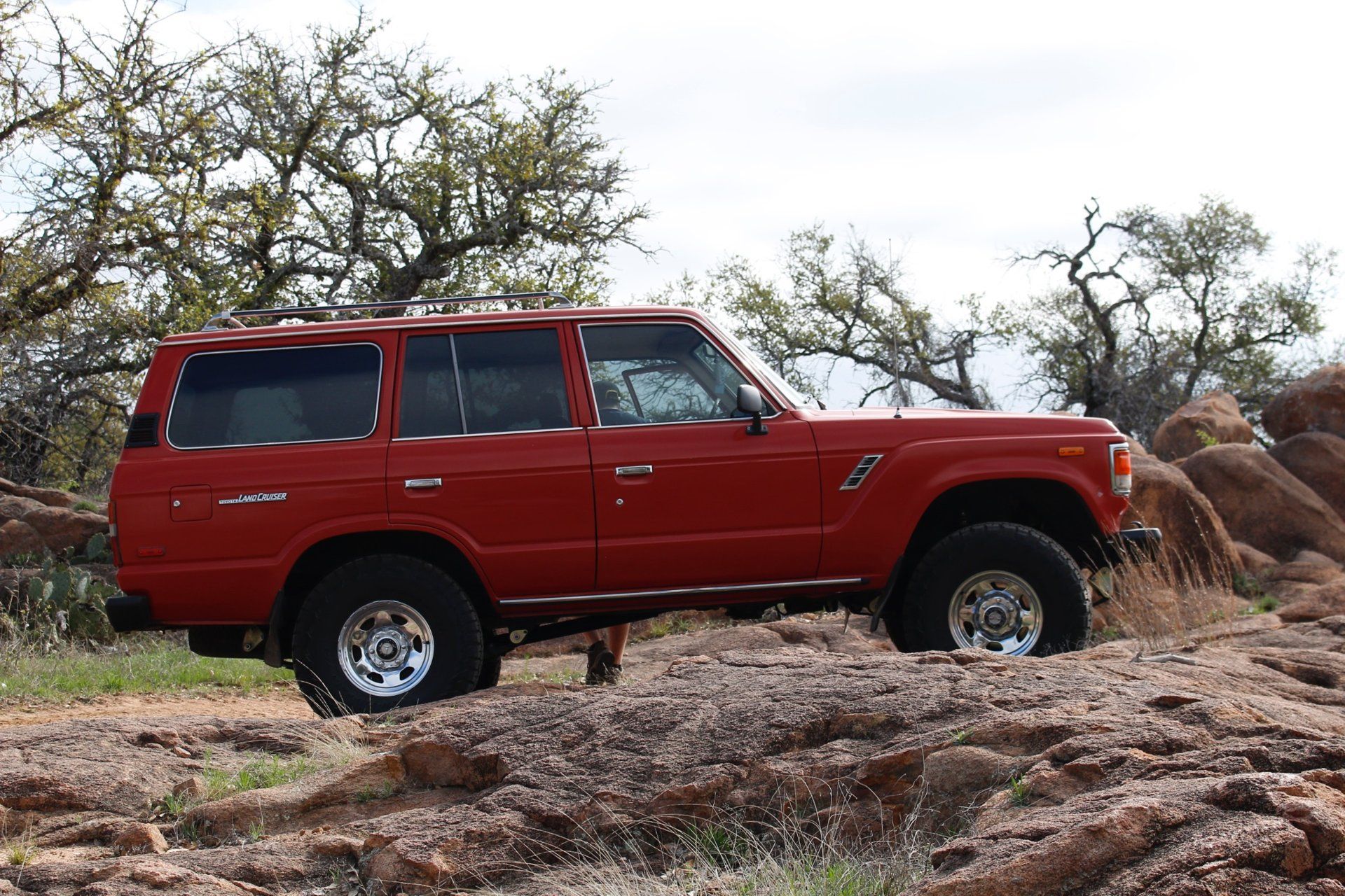

WAY old thread, but I just ran across this same issue. Apparently, "Freeborn Red" is not necessarily "Freeborn Red." Your truck looks more like 3F4 red, not 309 red. The tag on your firewall should say for sure.
I always thought all reds on Land Cruisers were "Freeborn Red." While I guess they could have used the same name, there were at least 2 different shades of red on the 6x models: 309 and 3F4. ToyotaReference.com / ImportArchive.com says that only FJ62s had 3F4, my '86 FJ60 has a 3F4 firewall tag.....and it's definitely not the 309 red in the paint can above. In fact, it's exactly the same color as my '88 FJ62 (See photos below)

I just checked my ID plate. My '84 is 309. And the factory paint looks just like your examples above. I think there is an "old" 309 from the seventies/early 80's found mostly on the 40 series, and "new" 309 which is closer to the 3F4. This is what my '84 has. Luckily for me, I much prefer the newer orange/red over the pink/red of the older paint.
