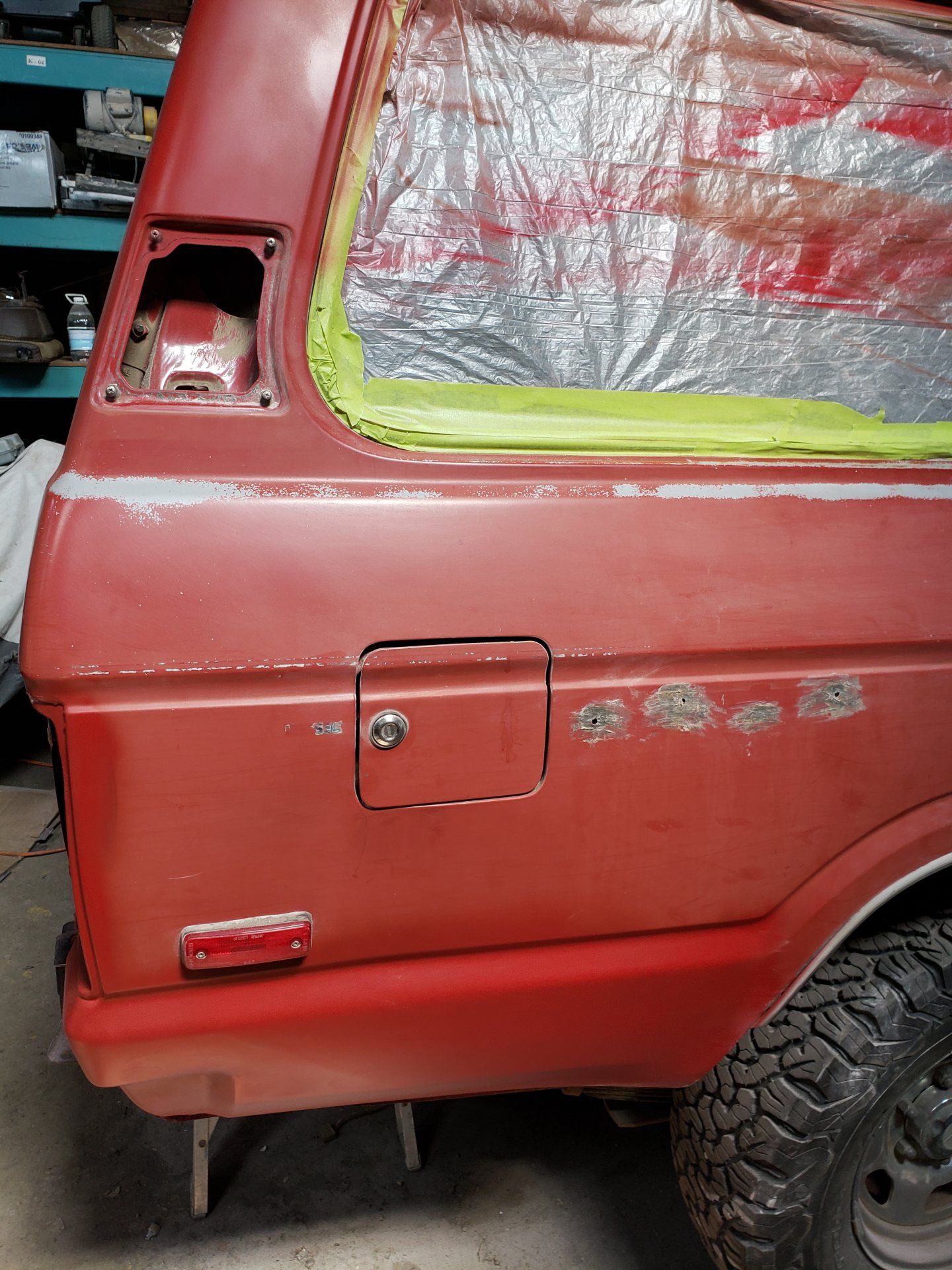

Hi George, I am in Squamish and thinking about painting my heavily patina'd Freeborn Red BJ60. I started the pandemic with repairing a few rust holes and adding a rear door sill (tailgate was screwed into 4"x4" wood). I was hoping to get away with covering the repairs with two large cans from Roberts Paint Care to touch up only the repairs however I am leaning towards a full respray now that my BJ is partly fresh 309 paint and partly 38 year old 309.

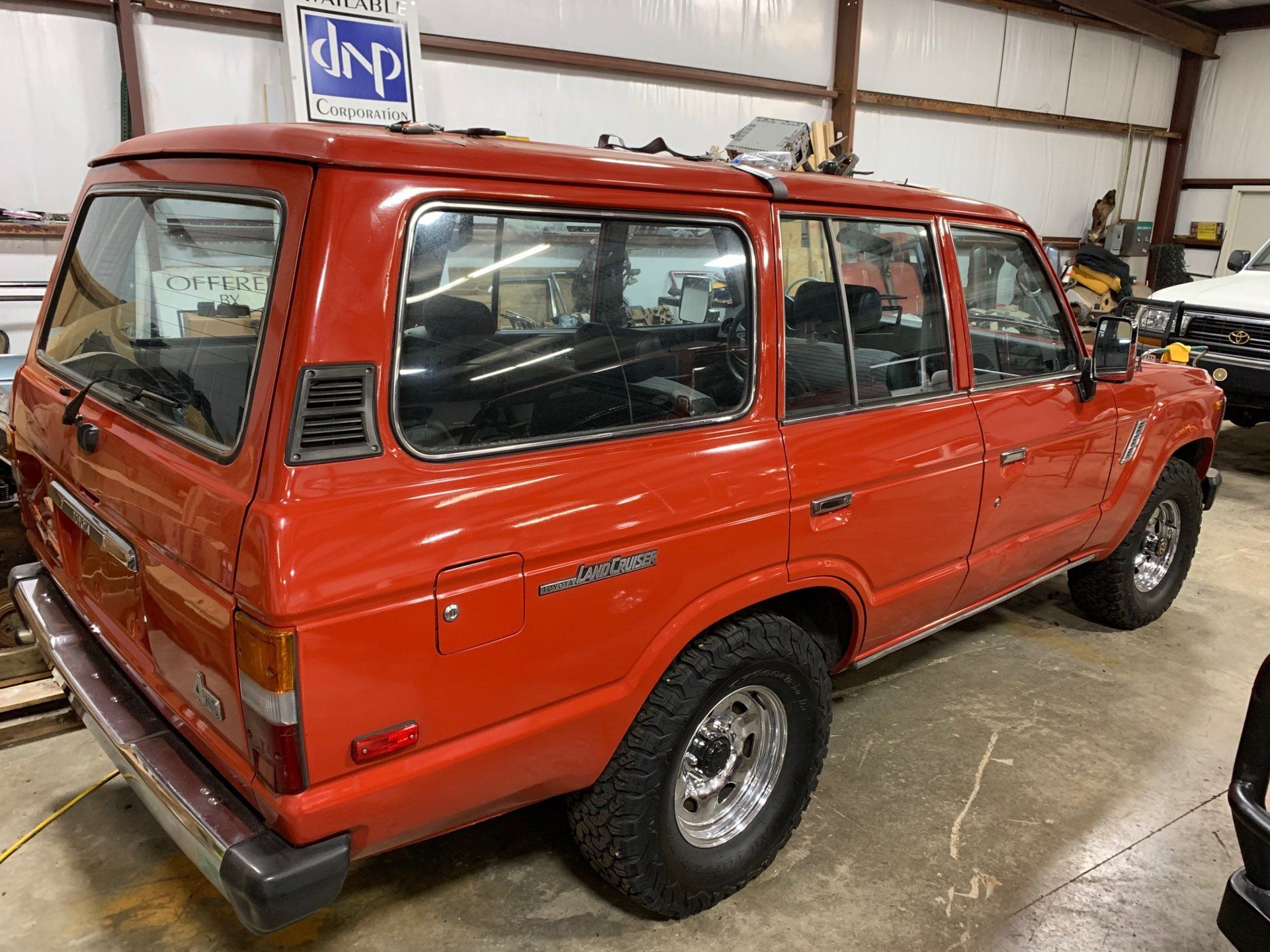

This is a very interesting thread. I have a 1981 BJ44 and just replaced one of the steps/running boards. I had my friend paint it at his shop, and I simply told him "it's a '81 in freeborn red". My firewall tag is paint code 309. The two colors and their difference look like what you have on that firewall picture.
I didn't think I would care but I really do like the 3F4 more, so I'm lucky my original paint trends more towards that. The other color is too bright and "show car" like in my opinion.

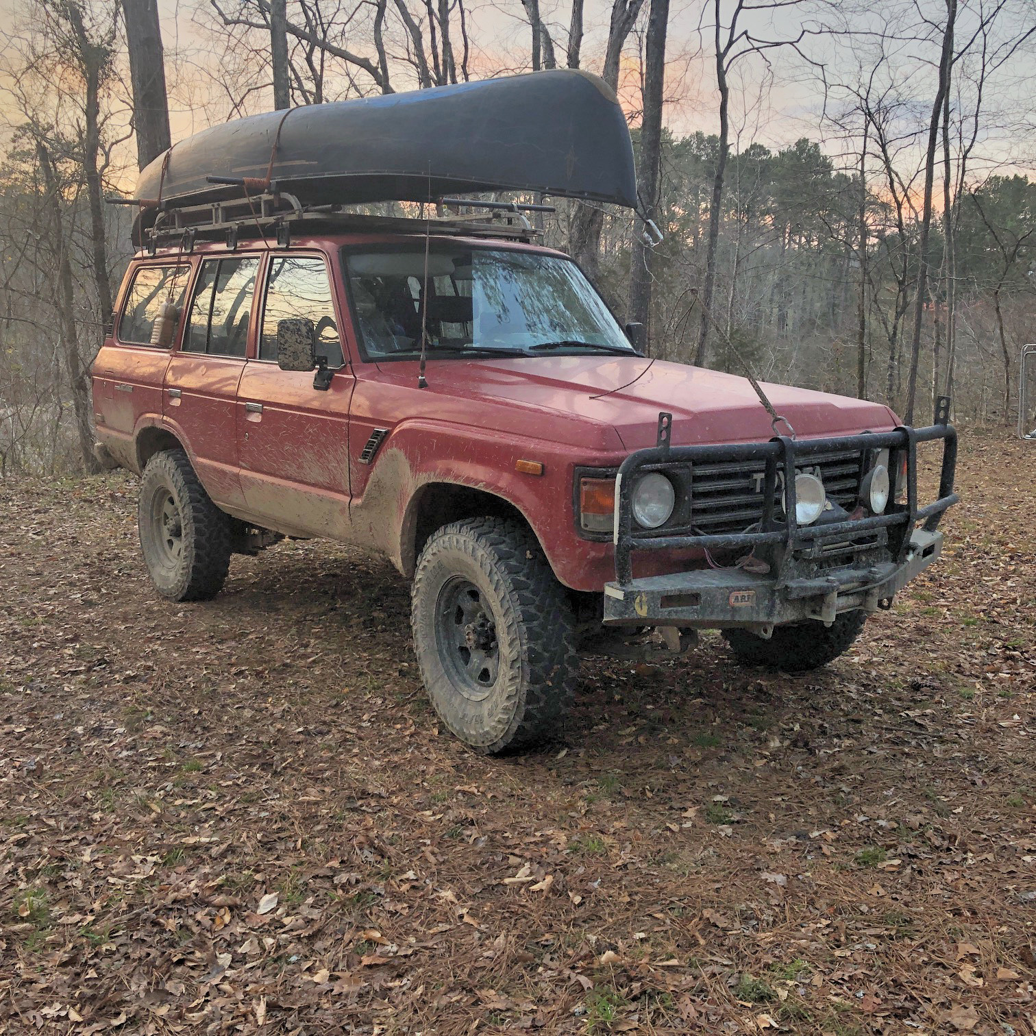

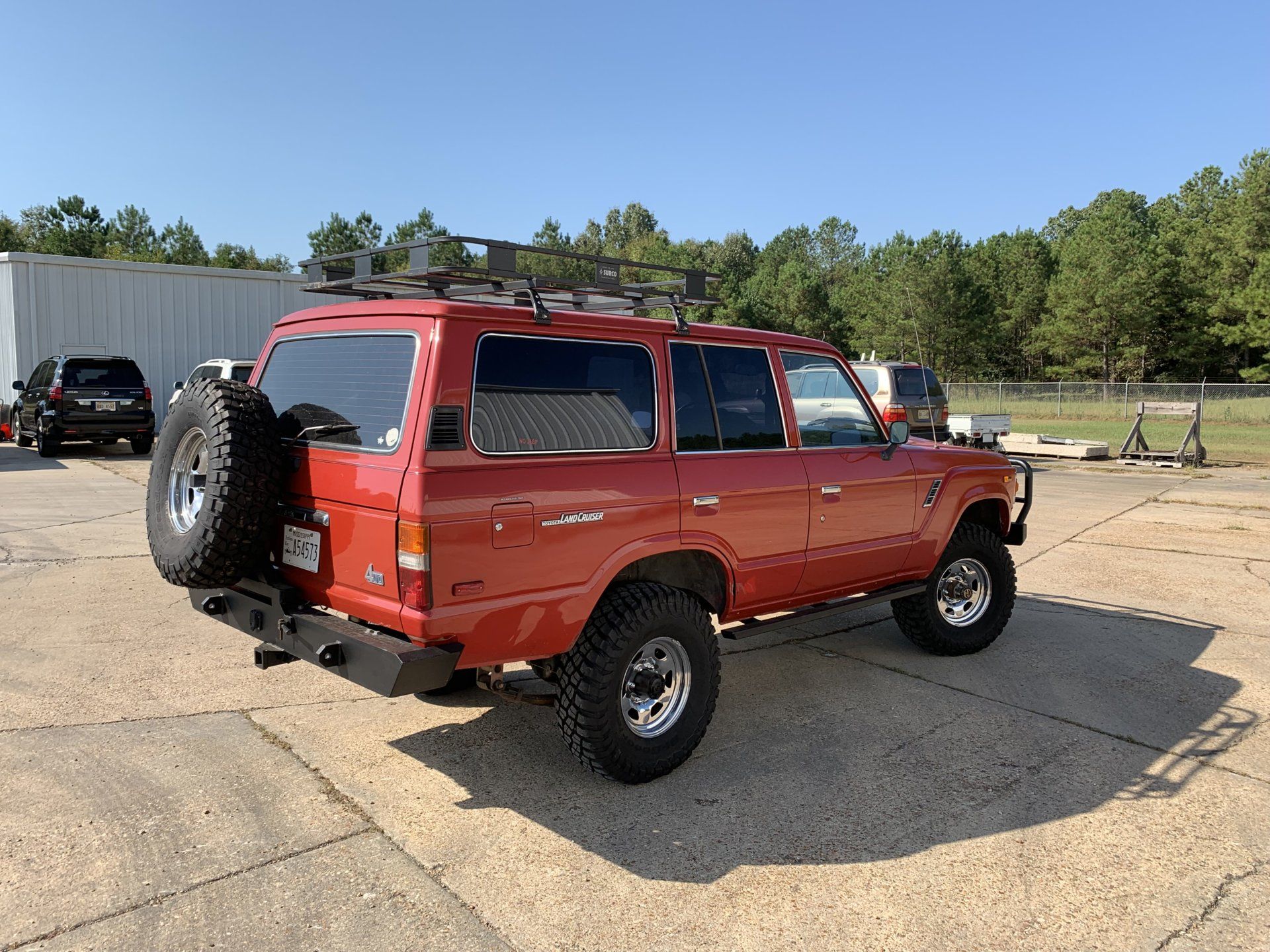

WAY old thread, but I just ran across this same issue. Apparently, "Freeborn Red" is not necessarily "Freeborn Red." Your truck looks more like 3F4 red, not 309 red. The tag on your firewall should say for sure.
I always thought all reds on Land Cruisers were "Freeborn Red." While I guess they could have used the same name, there were at least 2 different shades of red on the 6x models: 309 and 3F4. ToyotaReference.com / ImportArchive.com says that only FJ62s had 3F4, my '86 FJ60 has a 3F4 firewall tag.....and it's definitely not the 309 red in the paint can above. In fact, it's exactly the same color as my '88 FJ62 (See photos below)
