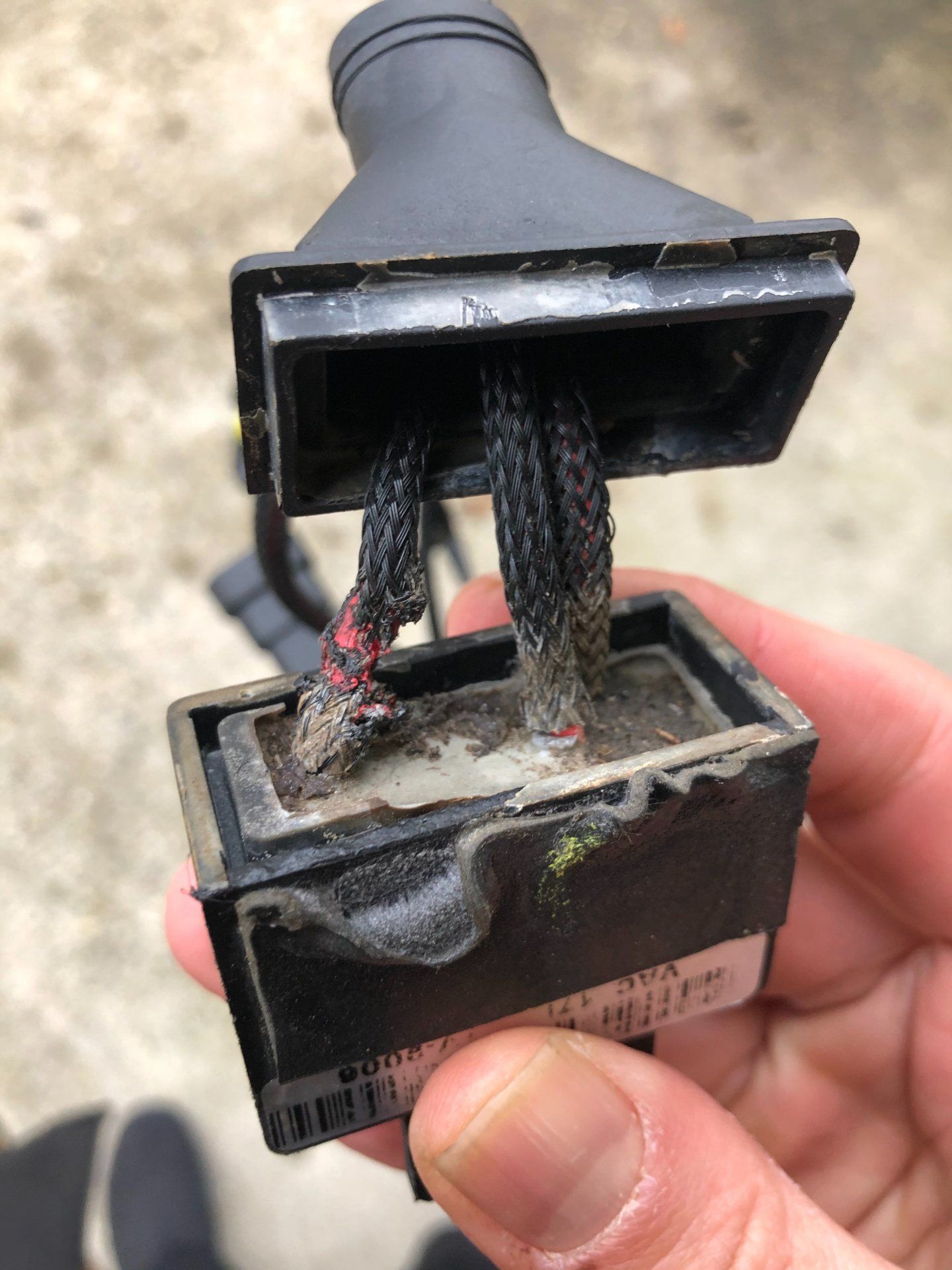

- It’s an aftermarket HID bulb kit from xenon depot (XD).
- XD sent a replacement ballast, I replaced the ballast and it did not resolve the issue (the headlight would not turn off).
- On November 23 the XD sent a replacement relay harness for the headlight
- I swapped out the relay harness and the lights worked perfectly.
- I did not start the car at this time (I just turned the ignition to on to test the lights)
- The old harness looked awful (see pic below)
