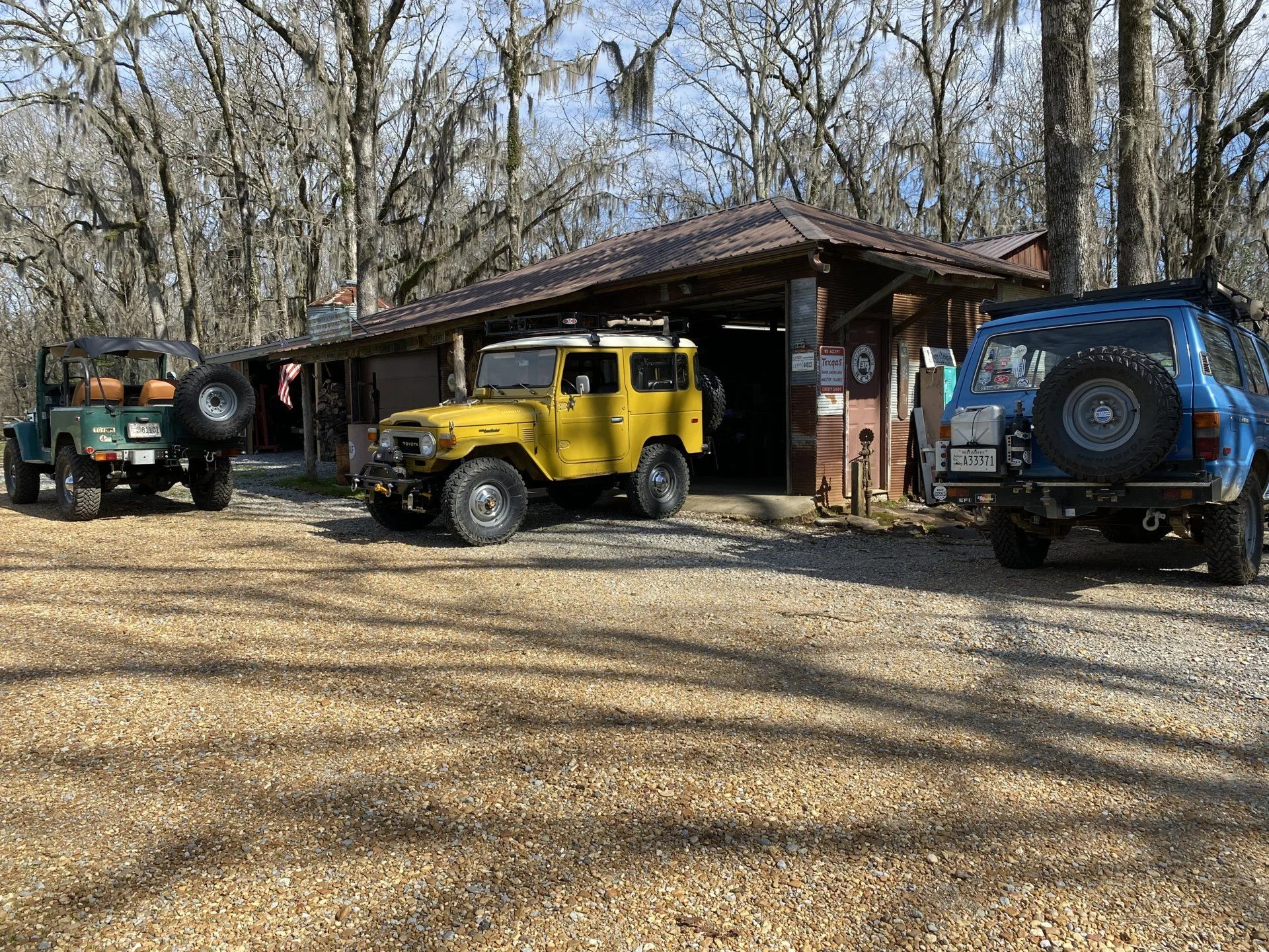

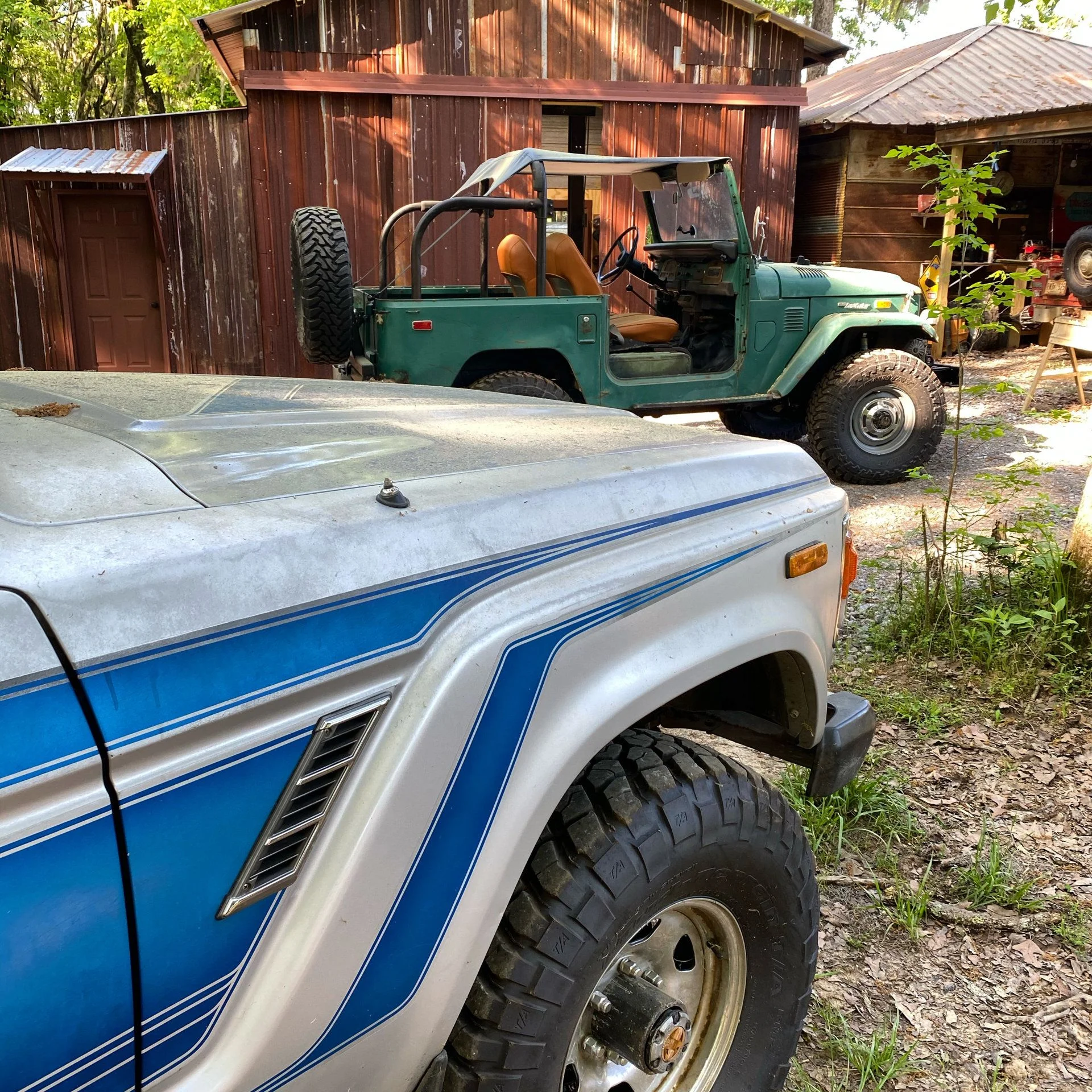

Weenie 3 got a ride today and some sun.

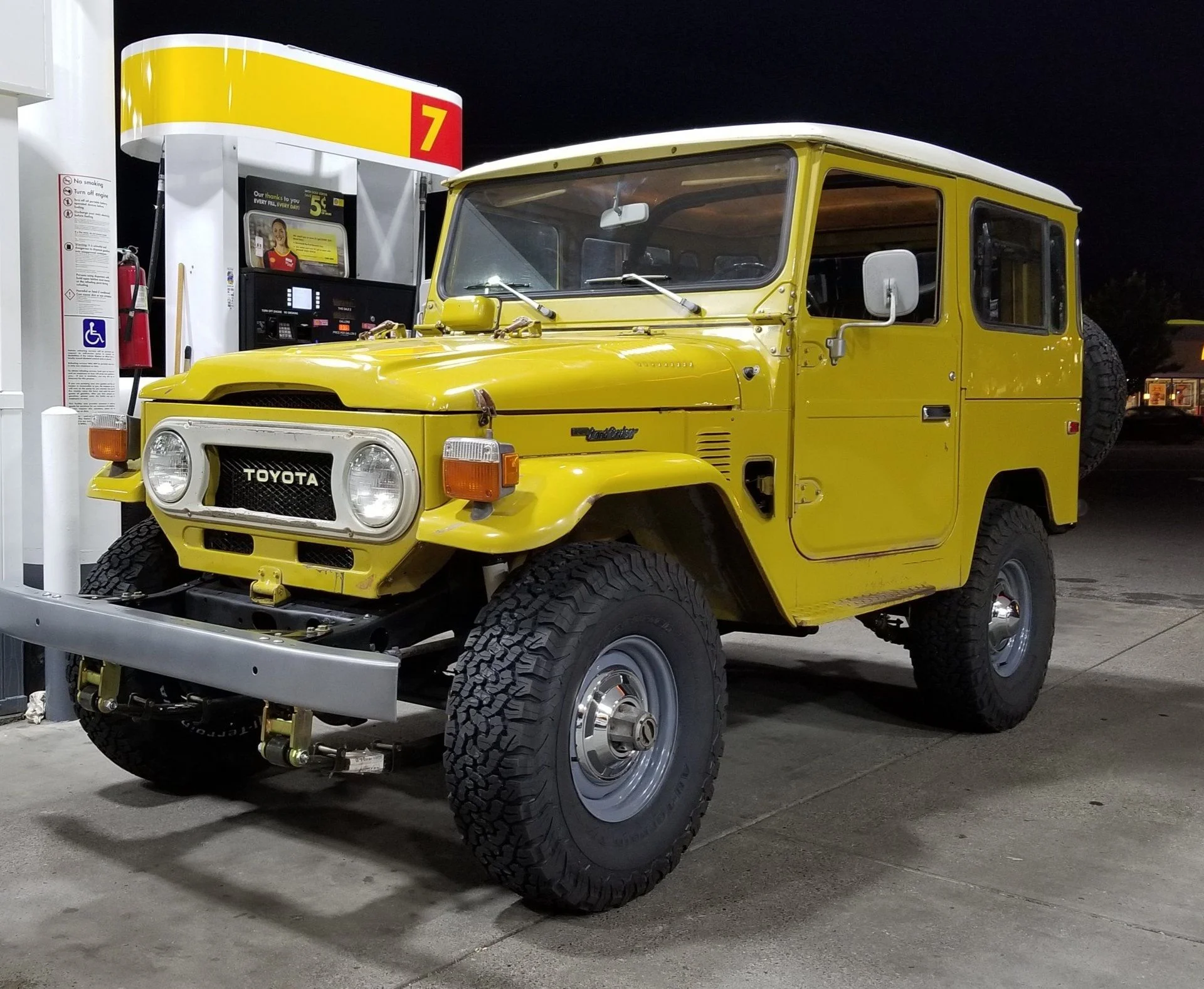

I've been seeing a lot of the yellow 40 recently - is that new to the herd? Is there a thread on this one somewhere? It looks very...clean...

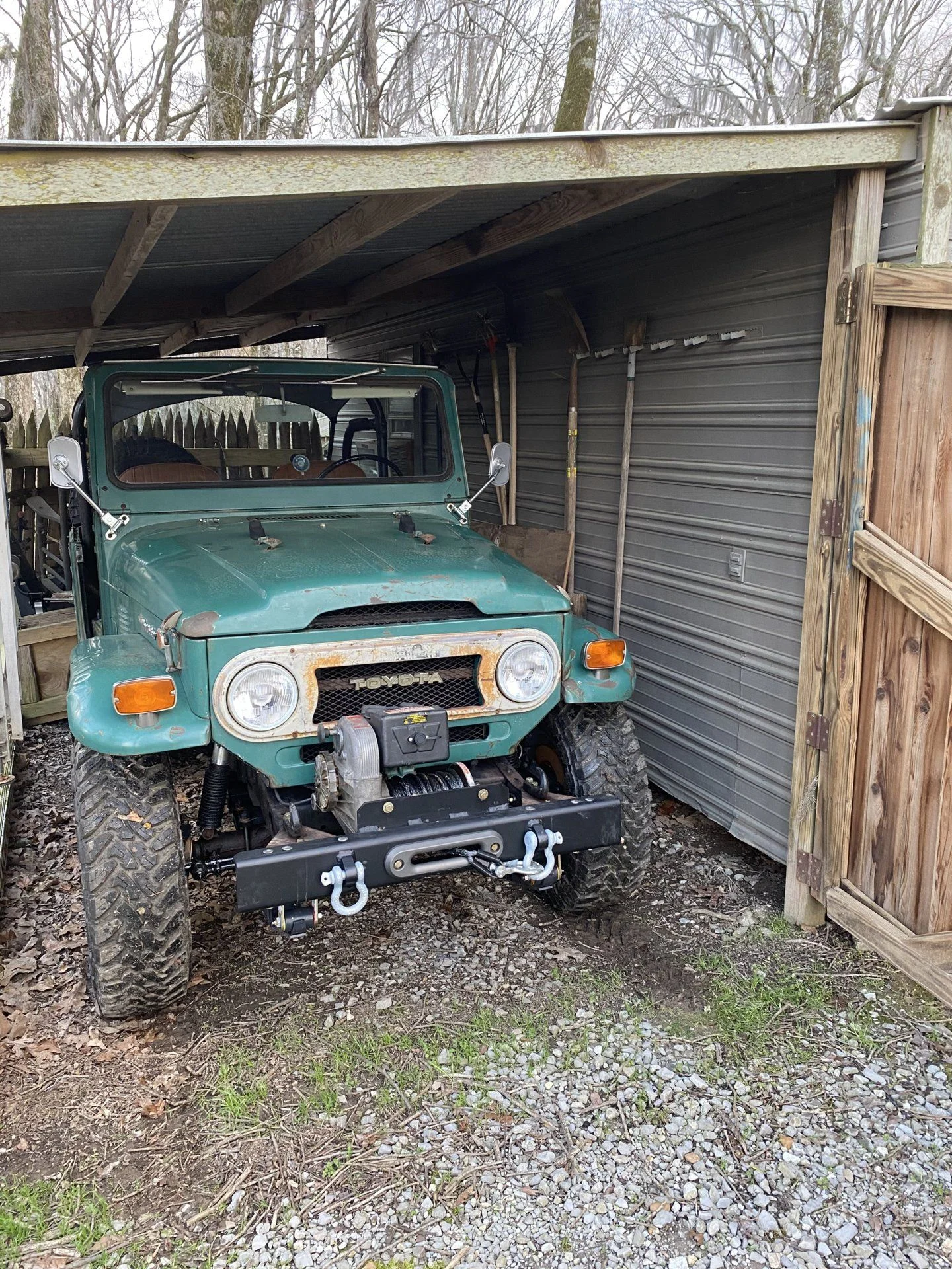

Weenie3 is still sadly waiting to be called home
That said, I picked up a real nice item for it yesterday that it’s really been needing.
Photos tomorrow

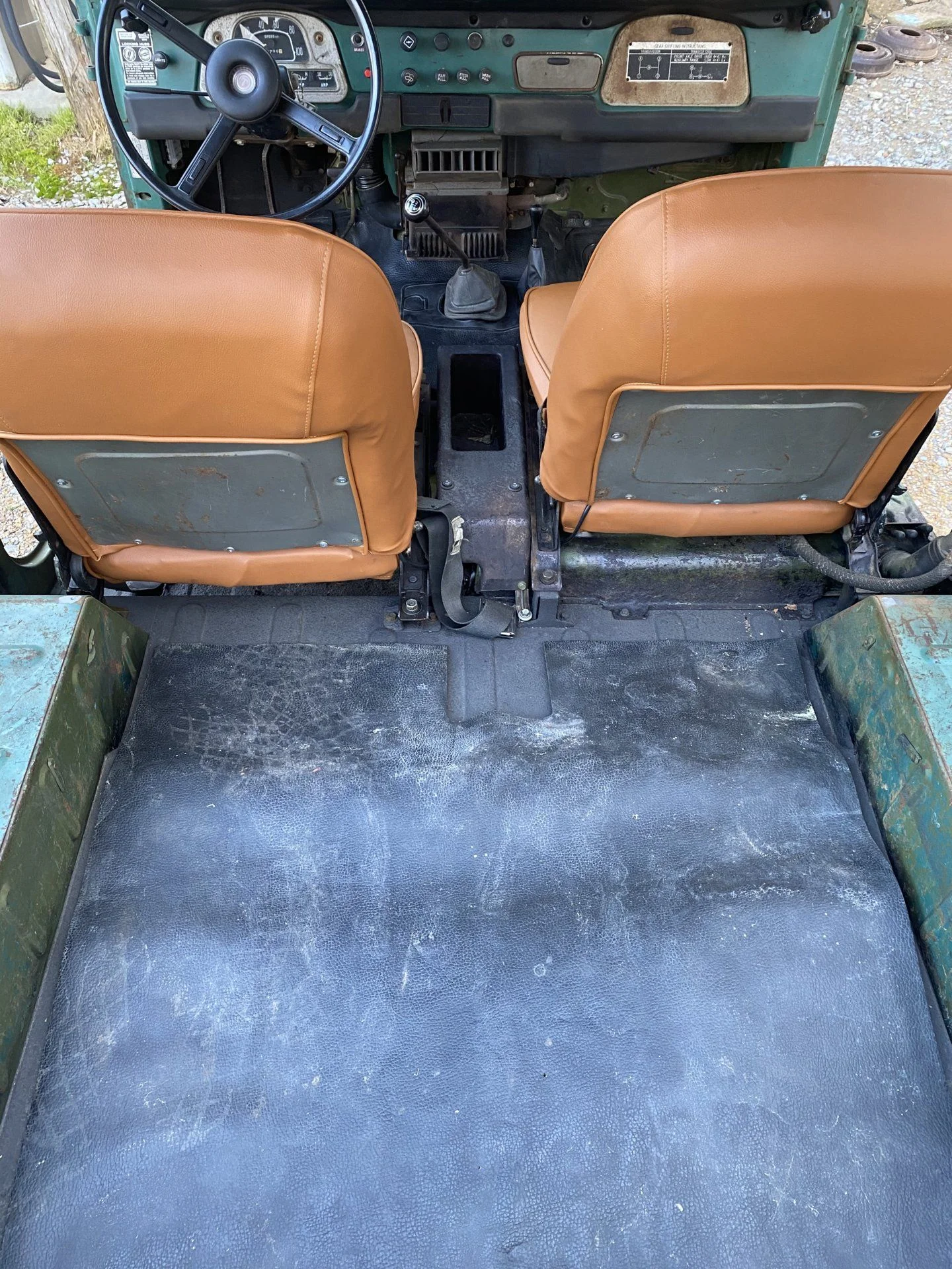

Really stoked to be the steward of these beautiful original floor mats for Weenie 3
Yeah, the owner was Not scared to spend the money on the reproduction mats but held out to get some that looked right with this project.

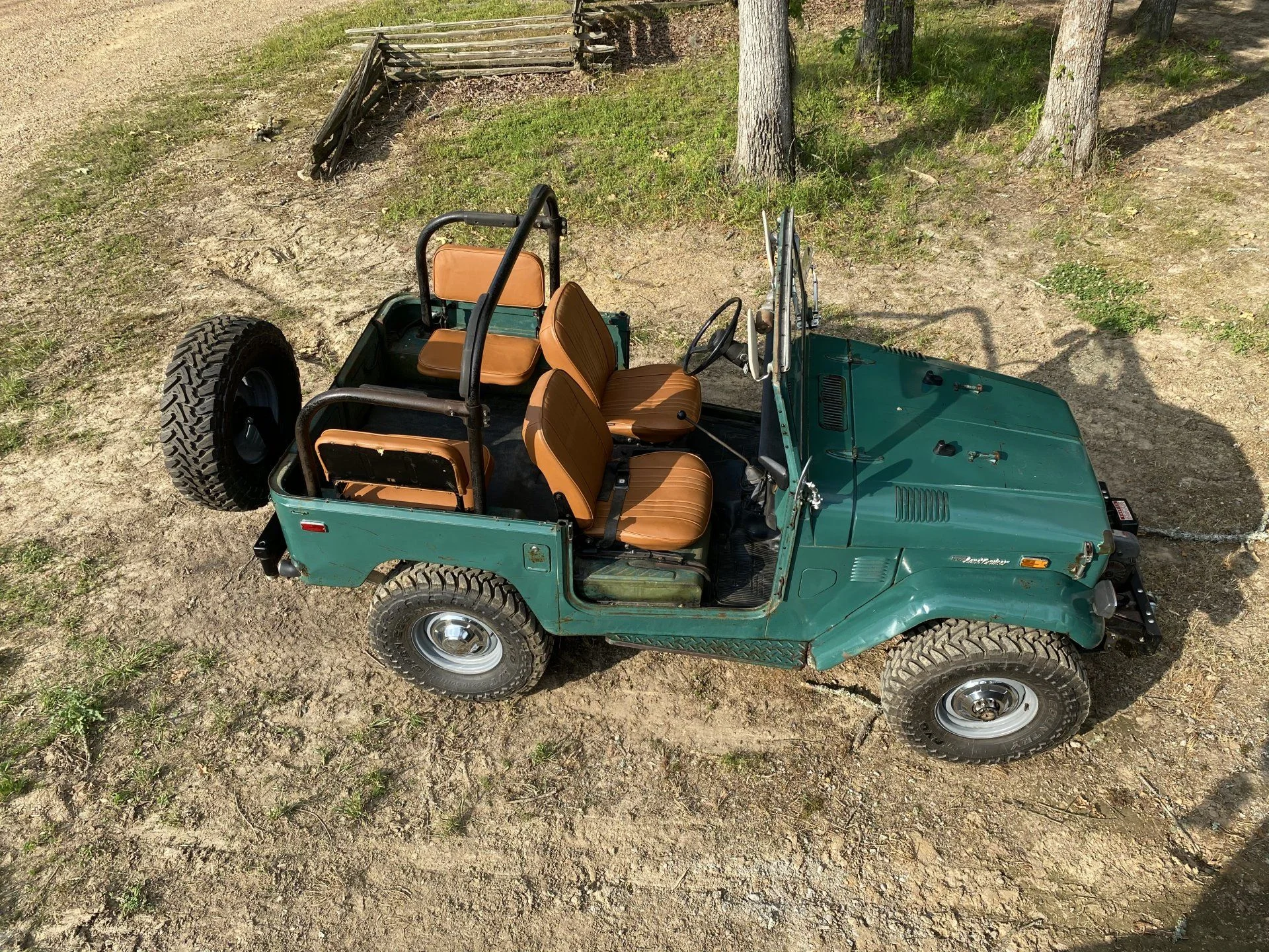

And of the record, I’ve been quite busy with other projects of others and my own so Weenie3 has been tucked away in my M416 shed for a couple of weeks and it fired right up like a champ.

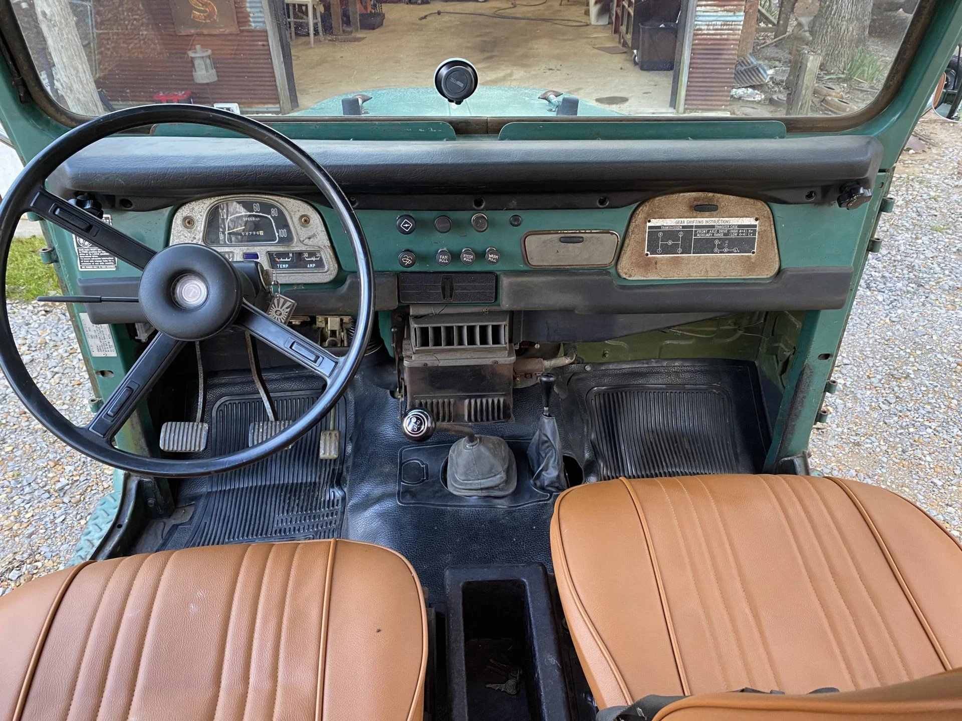

just noticed it still has the 3spd. late 73 manufacture date?
10/73 so it has a F1.5 and a 3 speed. I really don’t hate the 3 speed as long as the brakes are good.

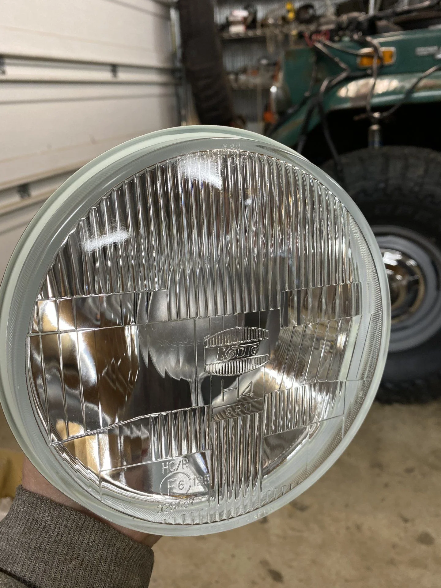

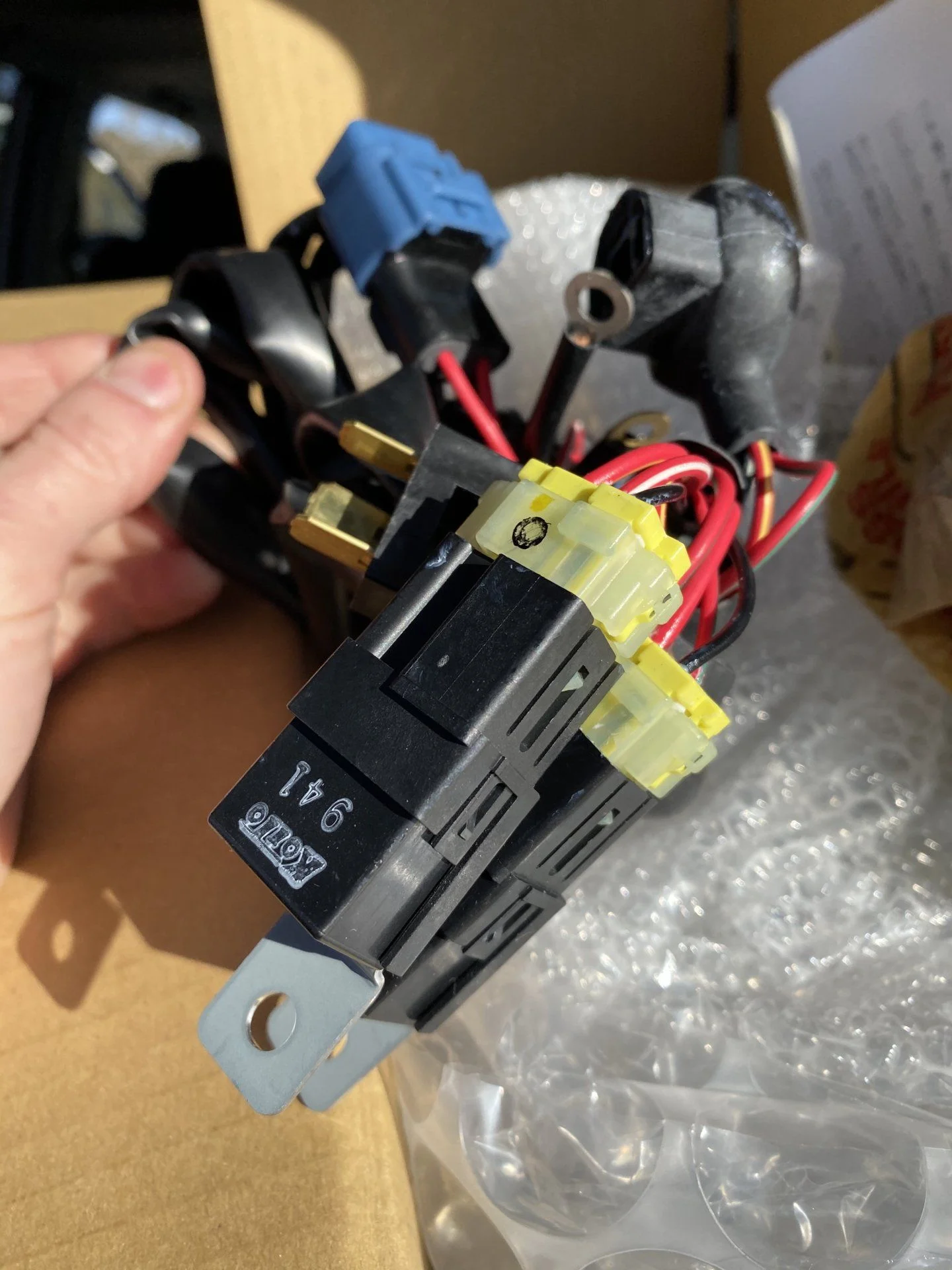

These lights are beautiful and Toyota sends you an upgraded plug and play harness as well as a big pack of zip ties.
I bought a set for all the Cruisers!
View attachment 2154617Do you by chance have the part number for the Headlights you ordered from Toyota? This project has been very interesting as I am restoring our 1965 FJ40. Thanks for all of the detailed posts.

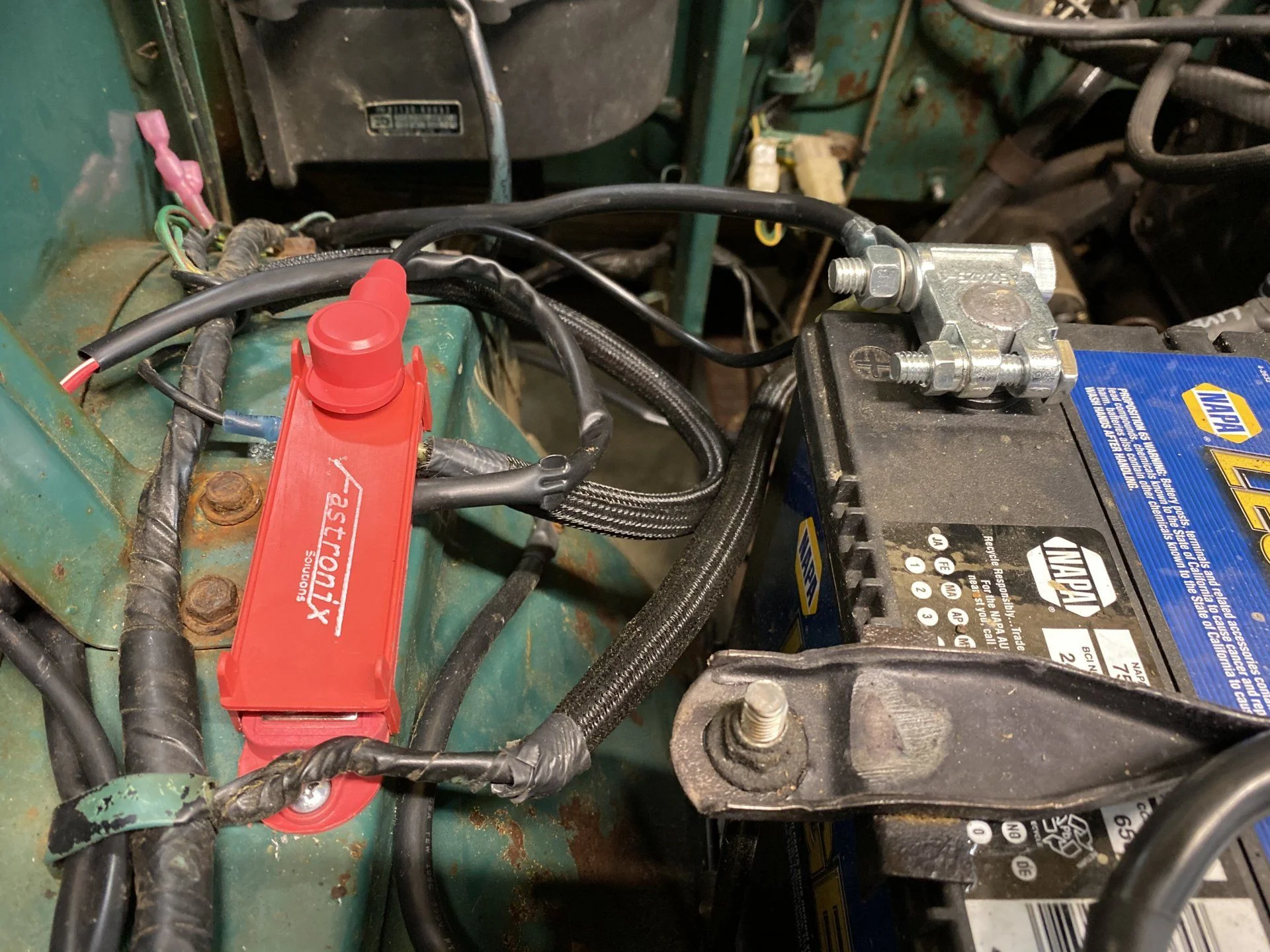

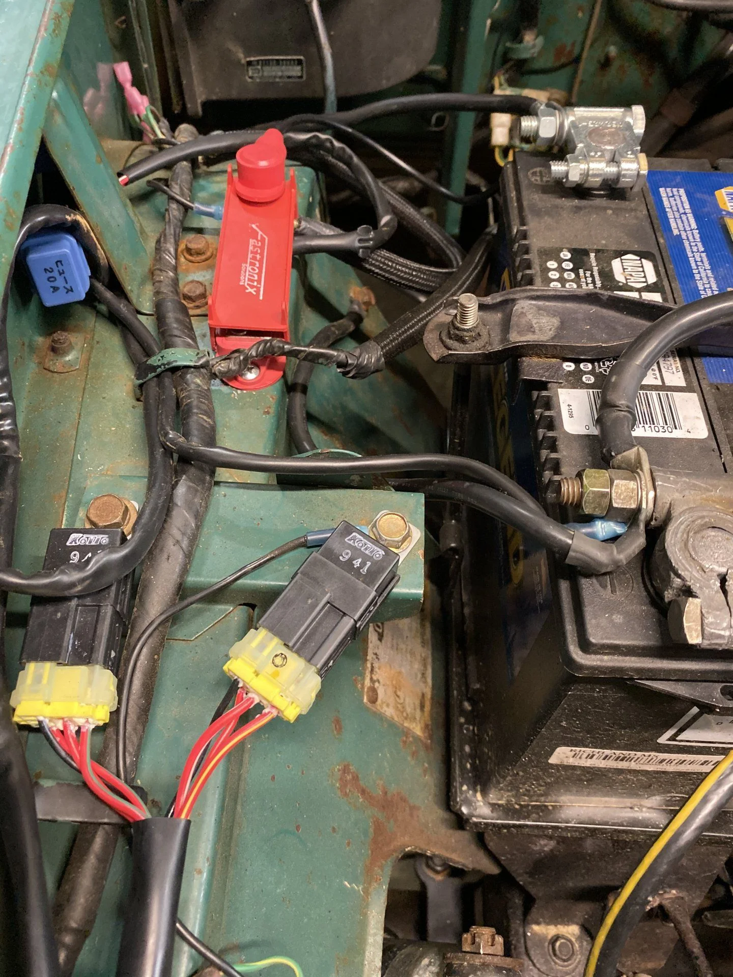

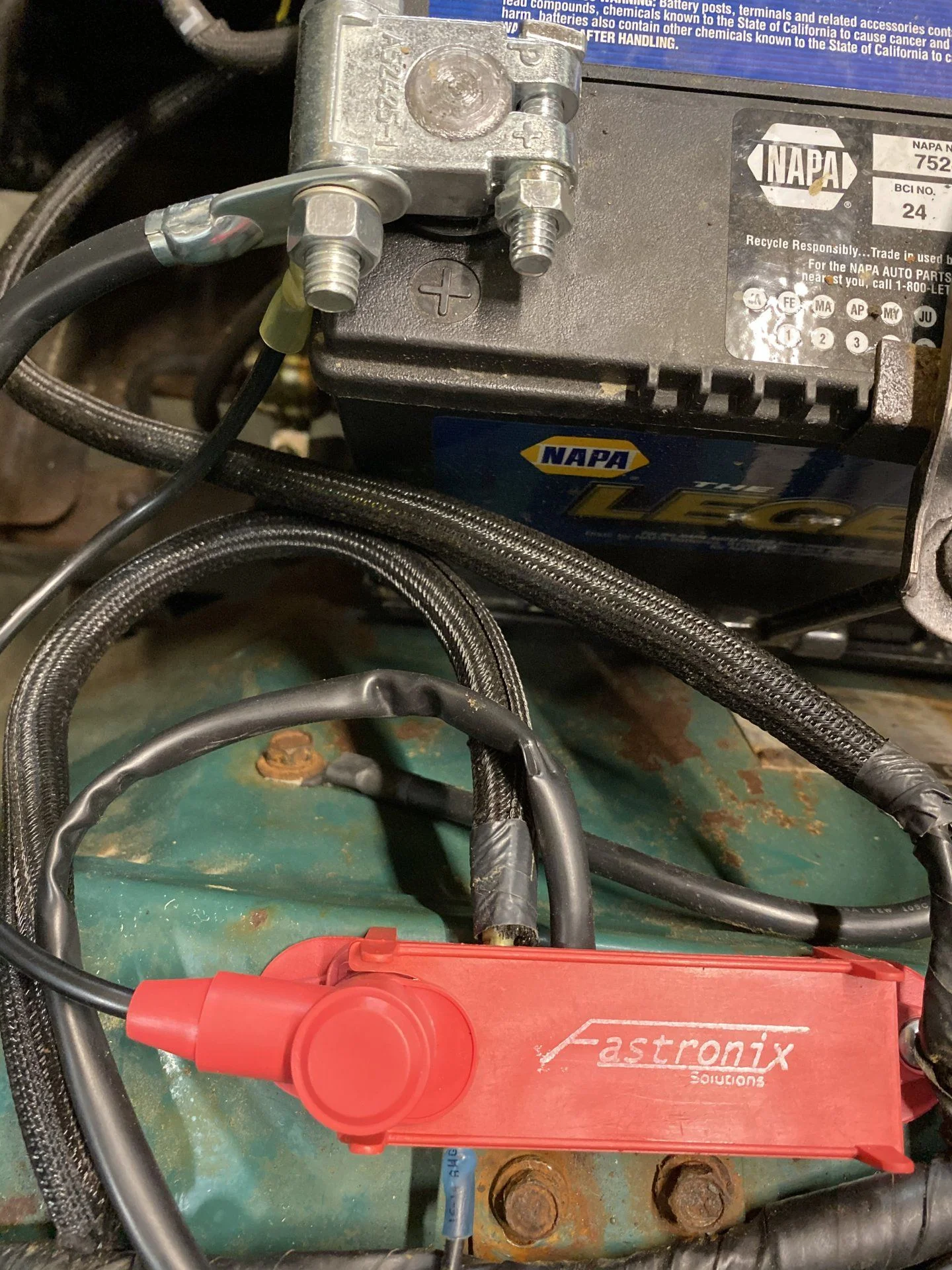

Instead of jumping in and hooking up the lights (easy 1 banana job) I installed some new wiring upgrades knowing at least one more 12v wire is coming and a winch.
View attachment 2154627View attachment 2154628View attachment 2154629
New Marine terminal and fastronix panel for a clean place to install constant 12v as needed.

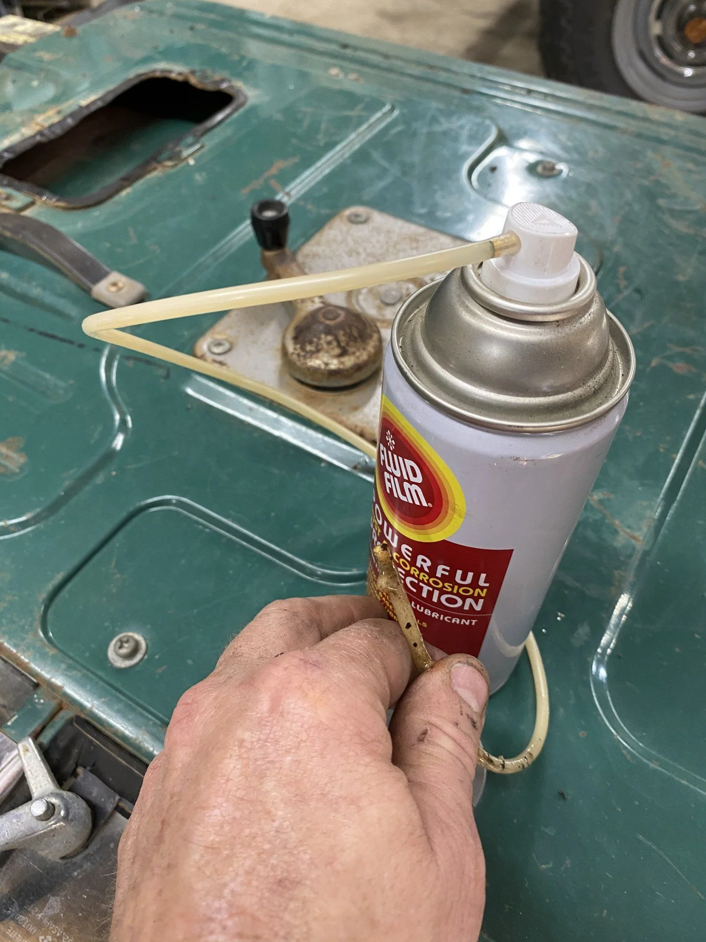

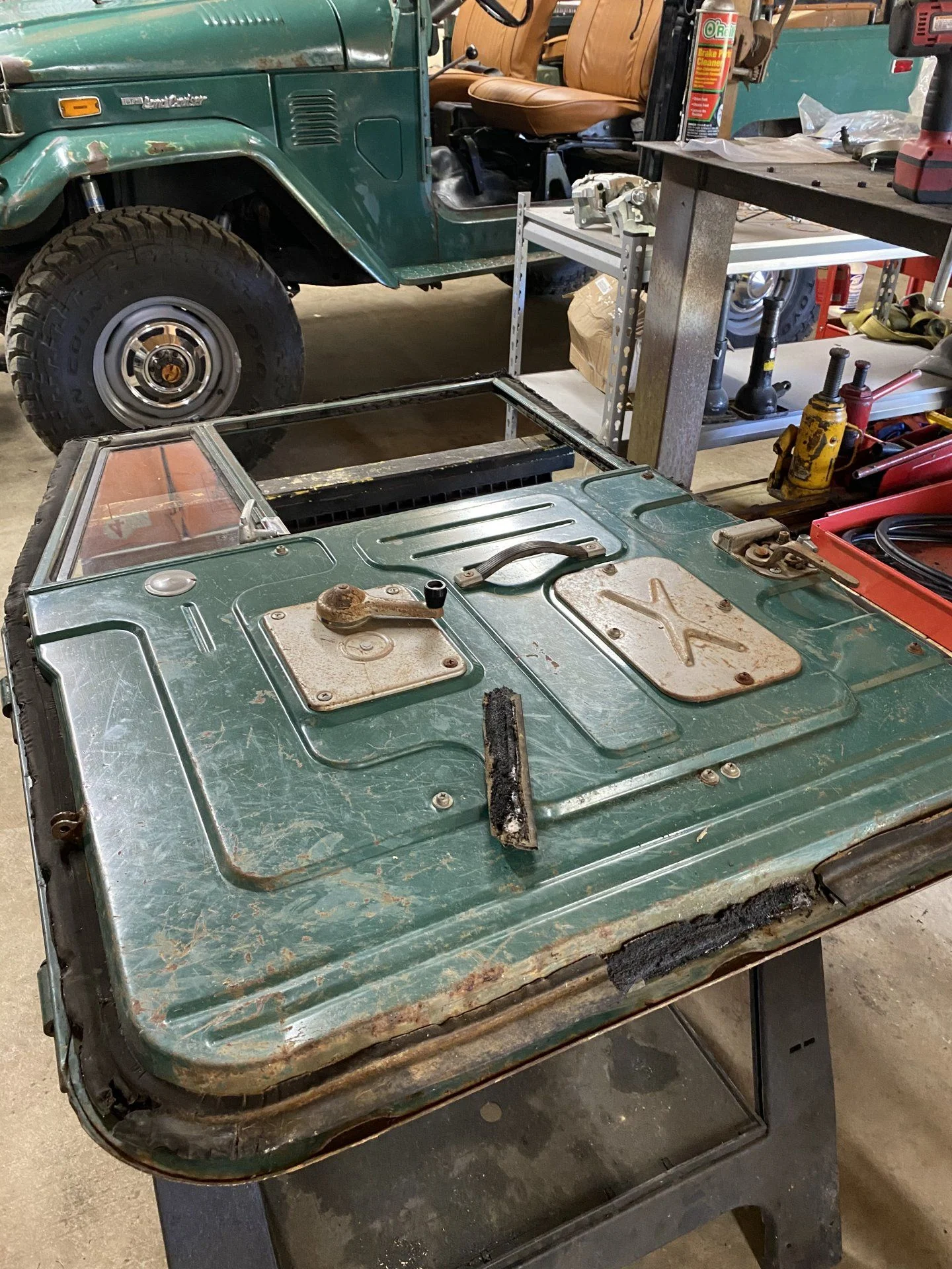

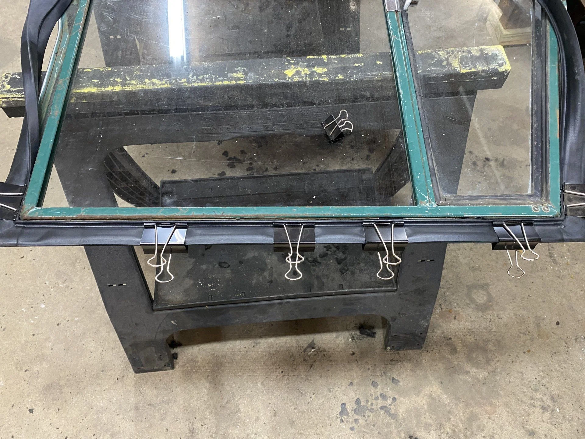

Took the first door into the shop. I’ve literally not looked at them in months. I was expecting the bottom to be rotten like 75% of them I’ve had are but I was very pleased that they look great

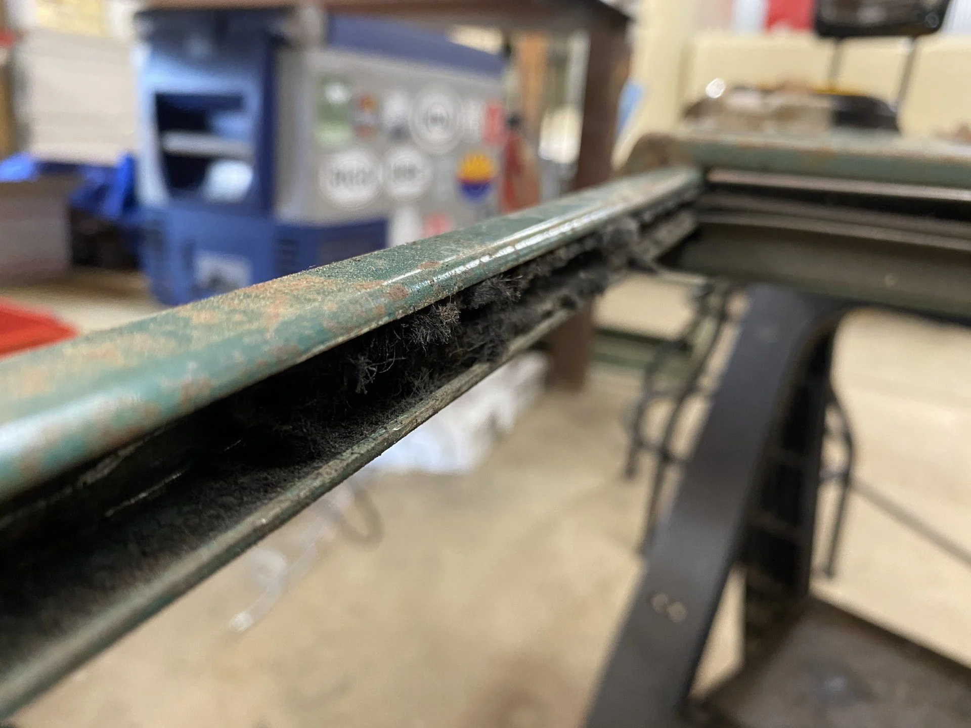

They would not roll up because the runners were so crusty.
I pulled them out and put in some from City Racer and they were so thick the windows won’t roll up. Anyone else have this issue?
I got the 360* sprayer tip out and hoses the inside of the door with Fluid Film.
How cool is it when you wind the original barriers are in place.
Gaskets going back on. 3M weatherstrip glue and paper clips
What or who’s weatherstripping are you using...I’m nearly at this stage on my project?? Thanks in advance!
