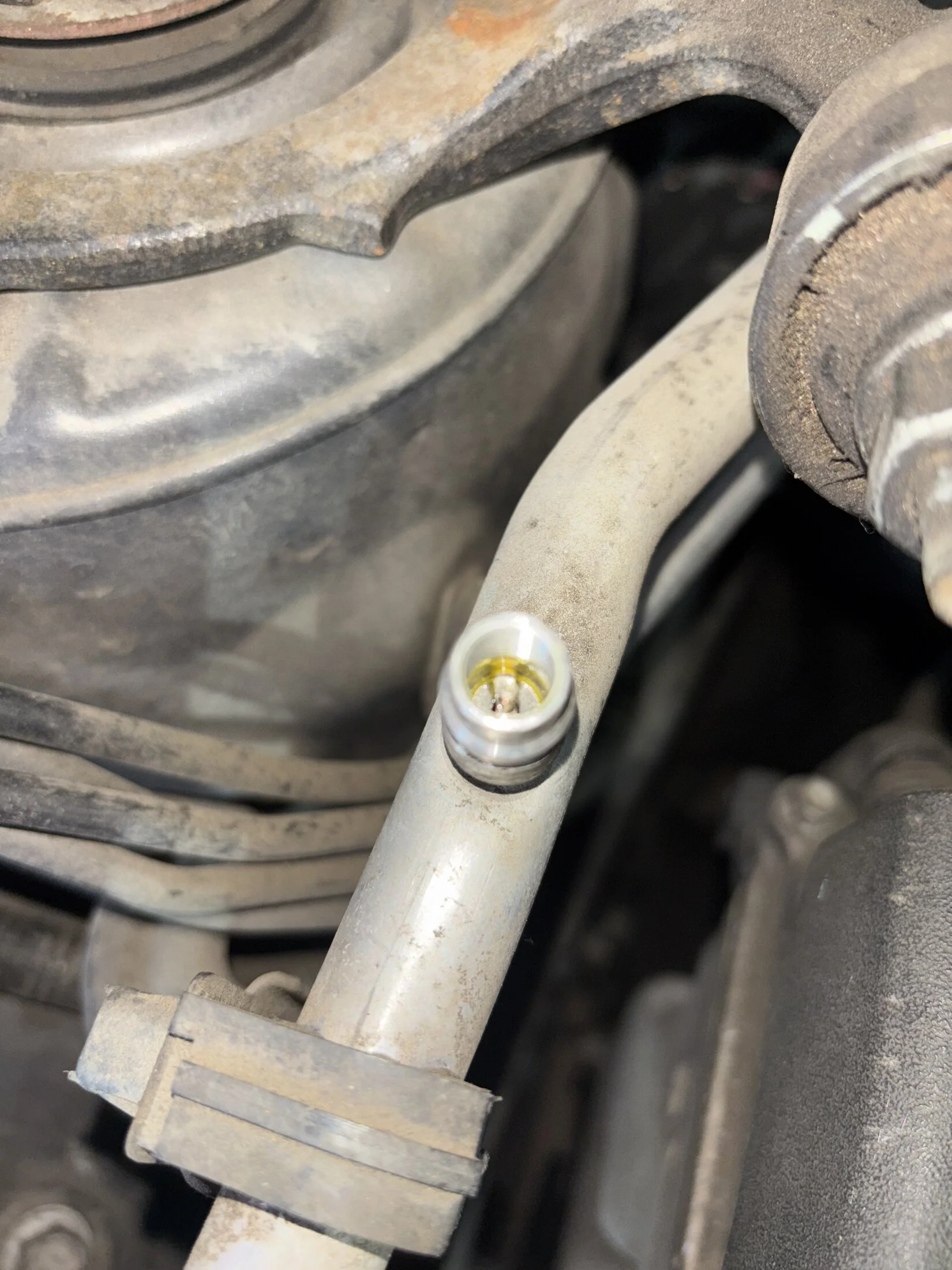

I caught some AC oil leaking from the low side port:

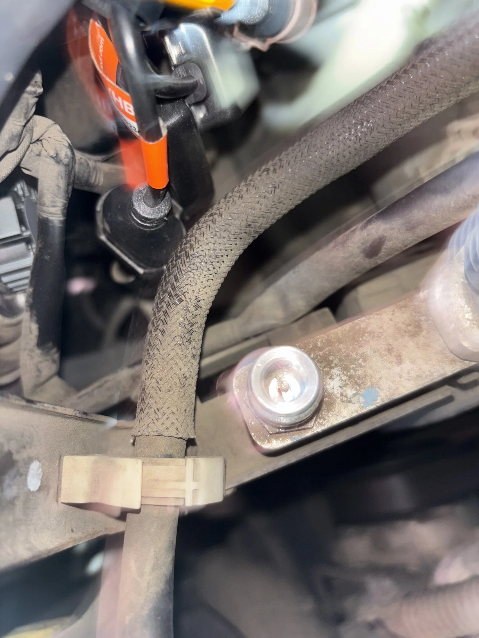

High side port (not leaking):
Evcuated the system, replaced both shraeder valves, vacuumed, and recharged.
AC is ice cold now
