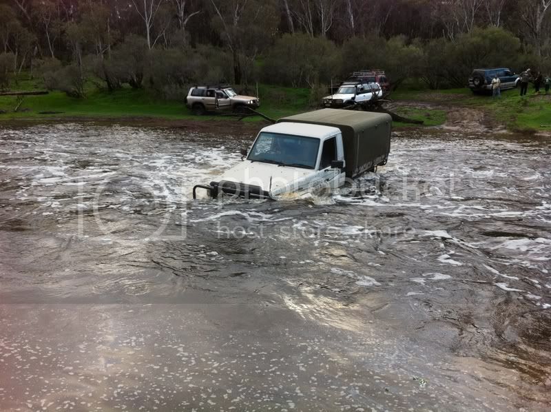

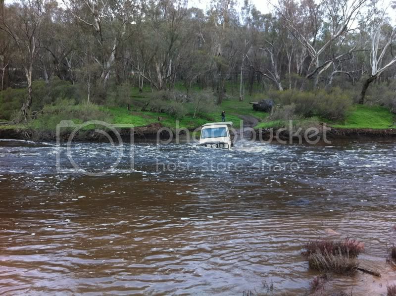

this got a little deeper and no water troubles luckily ,ill be building a stainless 3.5" snorkle soon though,
The current gave the underneith a good wash of all the clay and mud
