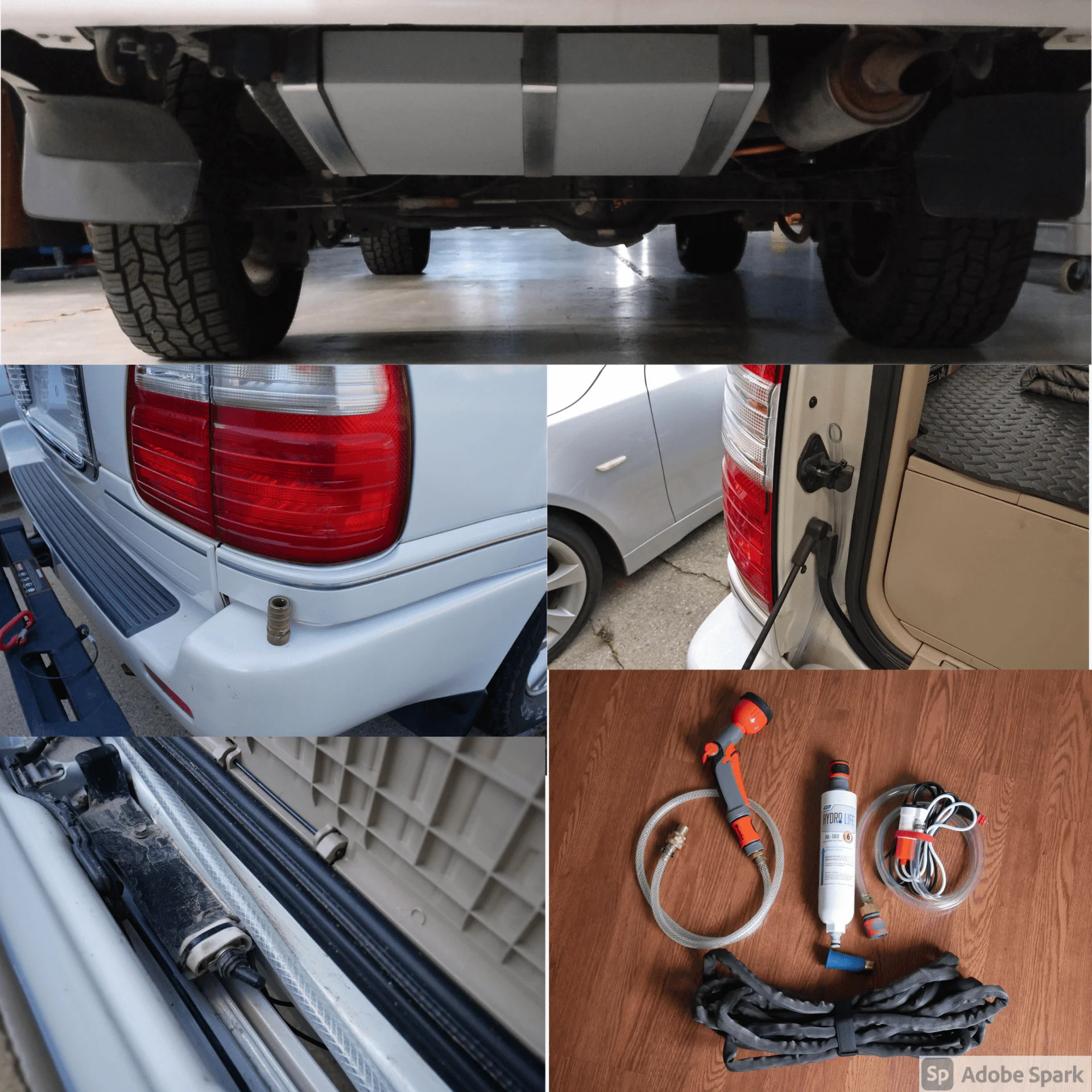

I think you're on the right track with hard-mounted tank and a filtration. Carrying those 20L containers around gets old fast. Here is mine. It is a single 60L tank with hard-mounted discharge pump, a separate fill pump which can be dropped into a bucket or stream/river, and a separate filter which can be used on both fill and discharge sides. My filter is a Hydro Life 52133 - 20 micron sediment+Activated Carbon+KDF - good enough for North America.
The simplest setup for third-world countries would be as follows :
1) Fill the tank with the best water source possible (city tap water). Use a particulate filter or screen while filling.
2) Treat every tank with chlorine bleach, which is available all over the world cheaply.
3) Use the tank water as-is for cleaning/bathing, but use a taste filter while filling a separate, smaller drinking/cooking water container located inside the vehicle.
It maybe better to carry your filters inside the vehicle rather than hard-mounting.
