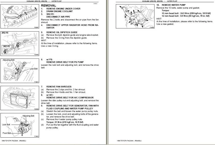

Searched but didn't find anything. Friend of mine has a 97 Tacoma with a four cylinder engine. He needs to replace the water pump. Anything tricky about this?
Thanks very much.

If that doesn't help, try this....
Ha! Probably just as well that they don't let me vote.
