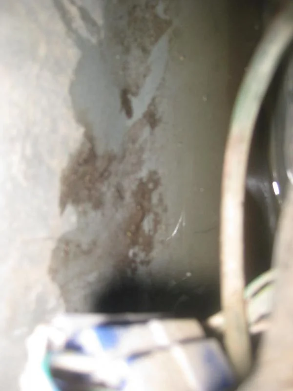

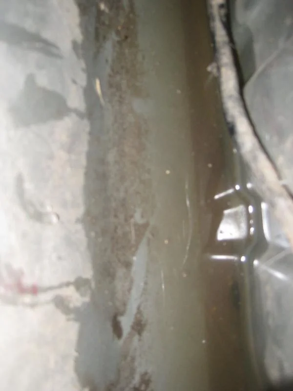

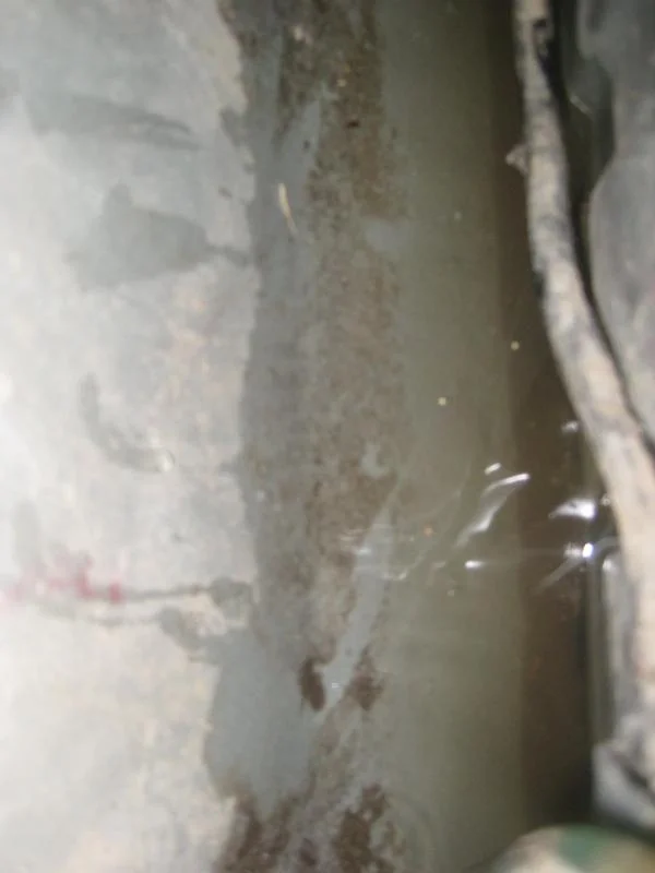

I was in the process of installing Kevin's side panel doors and found this?!? About 2.5" of water. :doh:
How does it get there and should I worry about it?
Thanks for any advice.

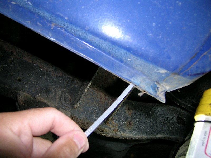

I can't answer your first question, but there are drain slots in the bottom of the quarter panels, so if water does get in there, it should drain out. You should clean out the crud and unclog the drains.
Thanks 2mbb. I'll check that out. Do you know roughly where the drain holes are? I assume that I'll be able to see them from the underside? Despite being pin-headed I can't fit my head in from the inside and couldn't feel anything.

There are two rubber plugs on each side...remove them and watch the waterfall. This happens because the drain slot openings are plugged up. Clean them out every so often and this wont happen anymore.

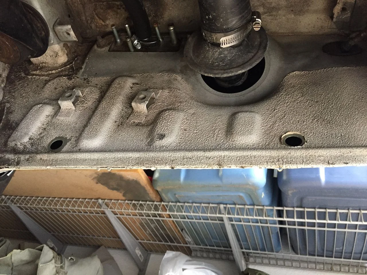

I also located the drain hole but it has a plug in it. Is that standard or should I remove it?
That rubber plug should be there. The drains are more like small slots that are at the bottom where the two sheets of metal that make up your quarter panel come together. They are more than likely plugged up or even worse, smashed shut.

No problem, glad to help. I'm learning (and documenting) a lot of information about FJ60s and FJ62s due to my '86 FJ60 project. Most all of my '89 FJ62 is being swapped over into my rust-free '86 FJ60, so I'm learning a lot about the subtle differences between the two models. I've been careful to document via photos and notes as I remove/reinstall parts between the two vehicles. One thing that's been bothering me recently as I work on swapping over the rear wiring harnesses and the fuel tank/lines is "What, if anything, was attached to the two brackets below the fuel hose nipples?" (shown in your photo). I don't recall removing anything from my FJ62 in that location. Is there supposed to be anything attached there?
