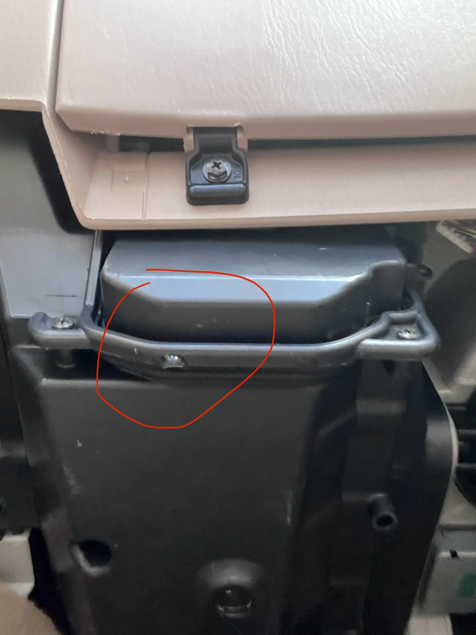

Seems like my AC is condensation line is dripping inside the car. It’s coming from under the glove box on the passenger side floorboard. Not very much. Maybe 5 or so drops and hour. Anyone have any experience with this?
Yup, common issue. There's a foam gasket in there that has deteriorated. Open it up (7 or so screws), pull out gasket, clean the area (will be full of leaves, dirt, etc) and replace with new gasket.

I have this problem. Your seal at the bottom of the evap cover needs to be replaced.
I just did mine.
I also replaced the COVER with a proper Lexus one that has a slot for air filters, the Land Cruiser for some reason (at least my 06) does'nt have air filters.... But the LX ones do have so I got that cover.
