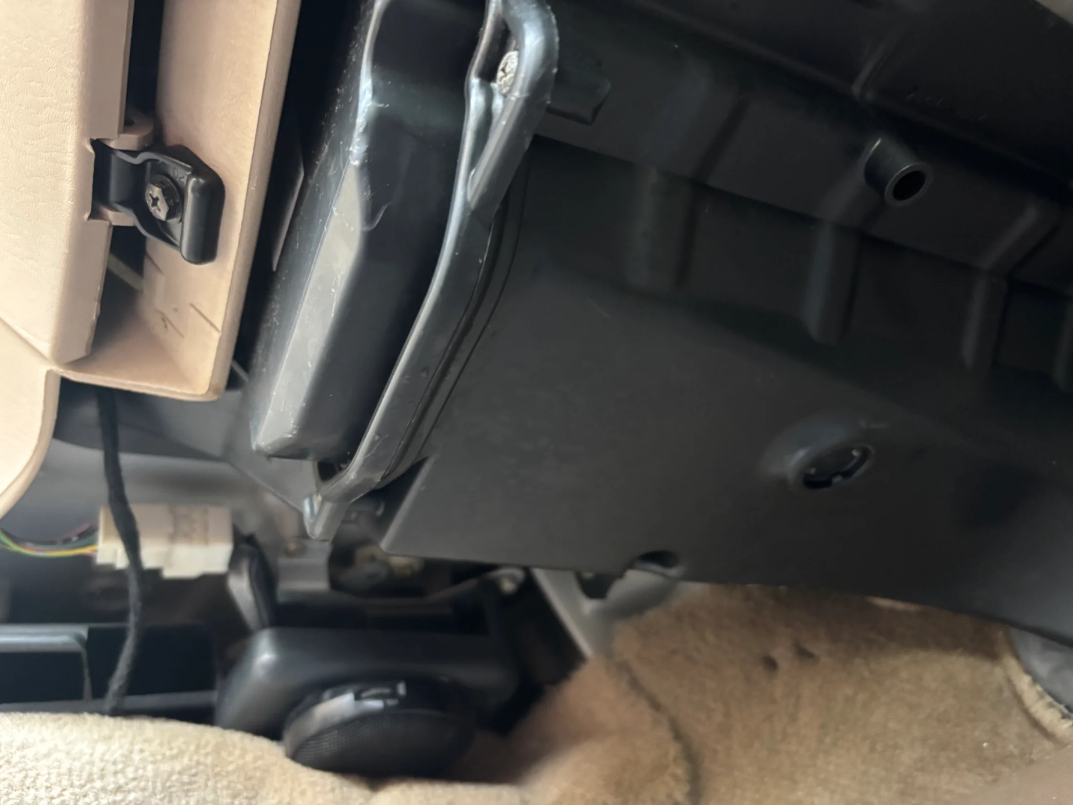

Hello, so it just recently rained and I noticed a puddle on my passenger side car mat. I was running the a/c as it’s hot out. It also made a weird gurgling noise when I ran it. I’m not sure if gurgling is the right word but it sounded weird. It kept dripping so I decided to shut it off and deal with the heat. I didn’t want to break the a/c as this is the first time I’ve experienced a/c in a car I own. Hence not knowing what’s happening or how to fix. I’ve read a few posts on where the a/c drain is and such but nothing on this specific problem. I attached photos of what I’m seeing it’s coming from the black box (evaporator box?). Let me know if you guys have any solutions

Almost certain its the seal that just deteriorated over time. My friends LC did the same before we resealed it.

The drain is on the firewall, in the engine compartment; it's blocked. This is a maintenance item.
Use a long, flexible tool (a wire or pipe cleaner) and clean it from the engine compartment side. Alternately, but only if you enjoy disassembling things for no reason, you can clean it from the interior end by running something through it, or using compressed air; it's just a tube. Resist the temptation to blow into it from the engine compartment side.

Evap core seal. 88578-47040

But yes, the drain may be clogged too. I was dumb and assumed you checked/cleaned that already.
^^^^ Same here. I have just caulked the seem to stop the drip. You can always easily pull the caulk off when you need to open things up to clean or repair.
I've used the factory foam gasket, and it only lasted a few years before it leaked again. The last time I used rubber window screen spline, and its held up great.

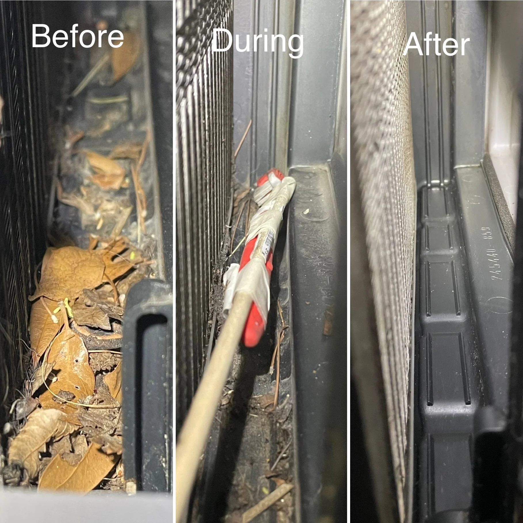

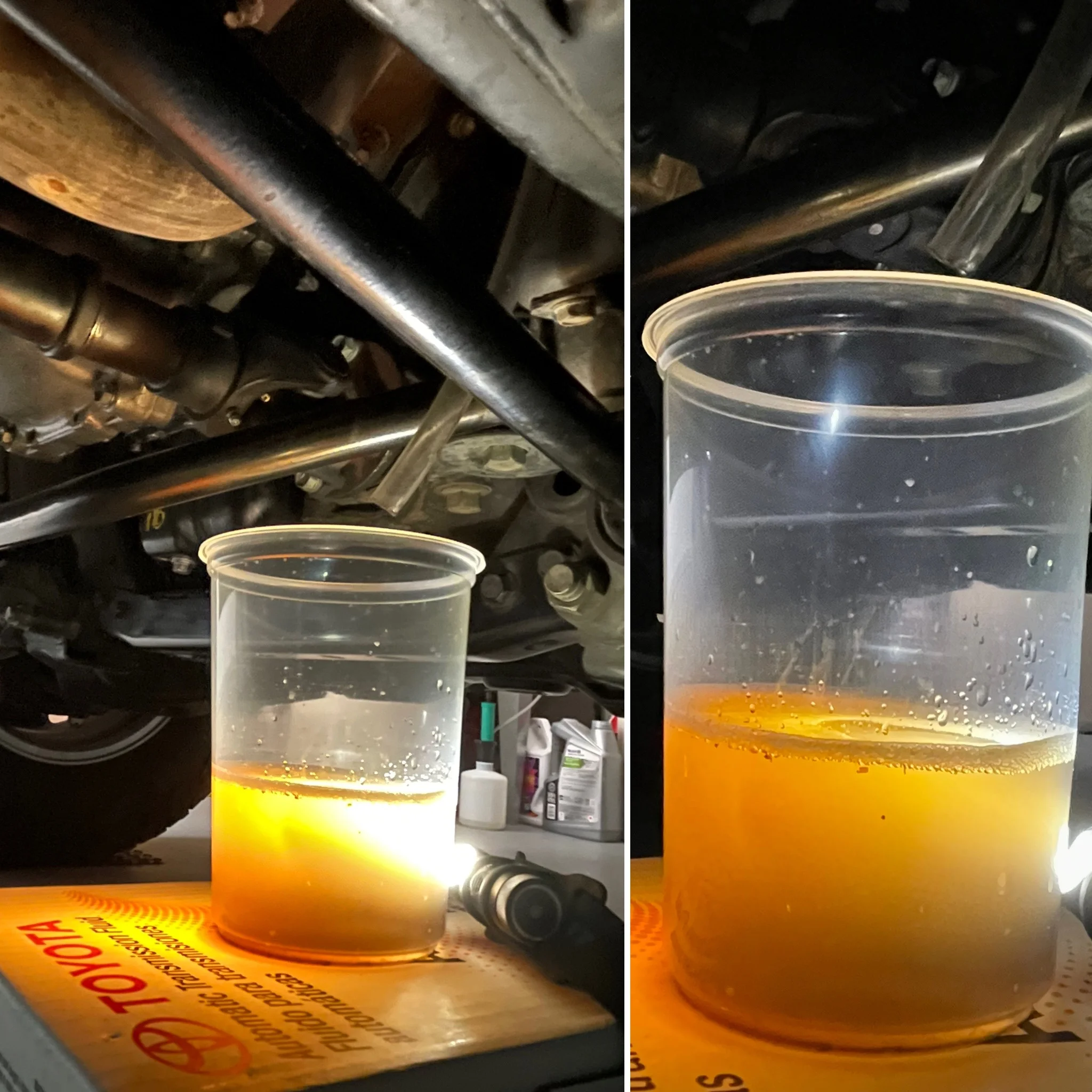

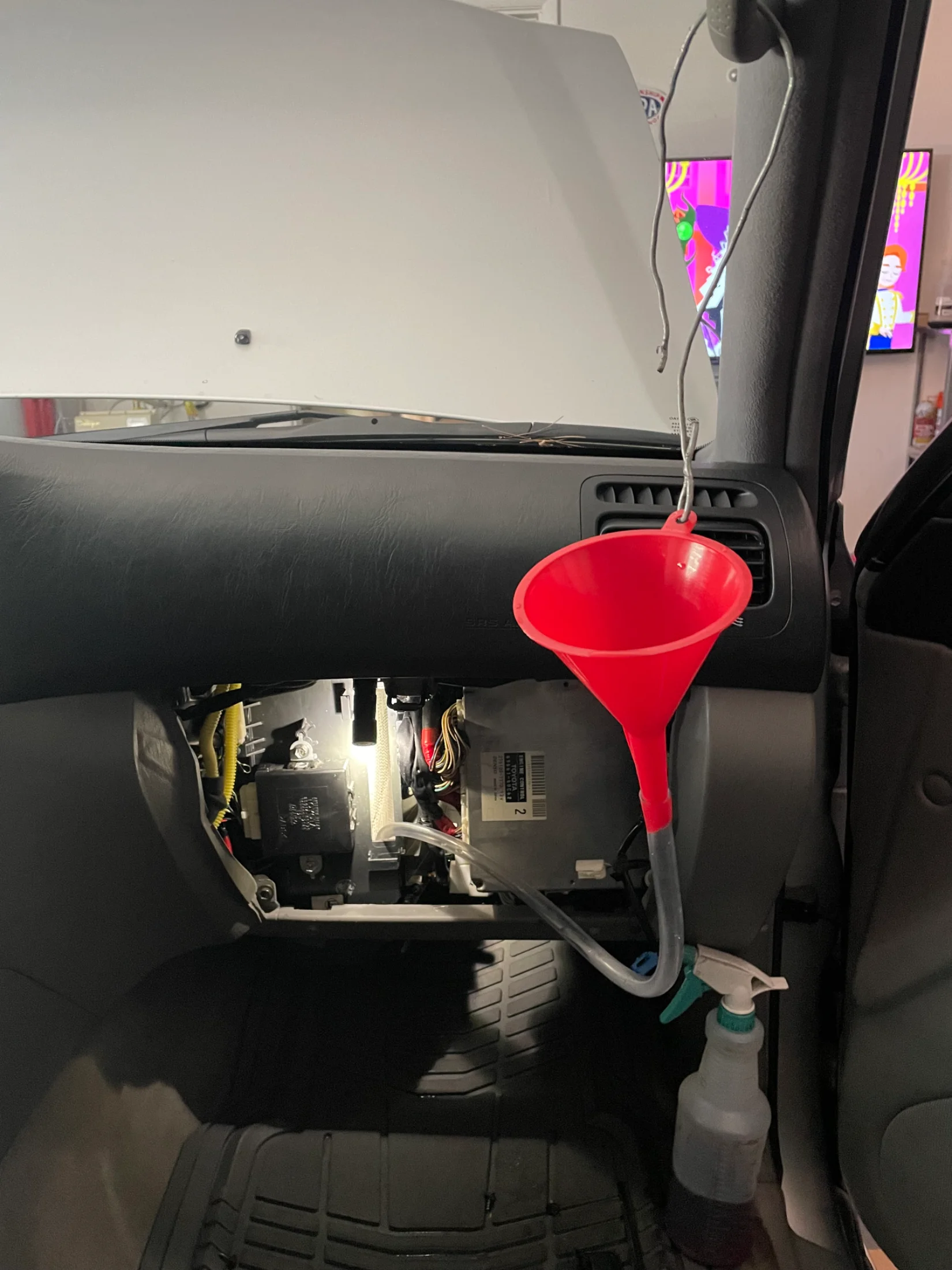

The drain plug is at the end of this plastic housing right behind the evaporator. The housing is pitched downward so by principle of gravity, water should flow towards the front and f the car or downward onto the drain plug. It’s leaking because the condensation (water) isn’t going anywhere as that drain plug is clogged.
There are so many ways to unclog the drain, one is you can use a wet-dry shopvac. Once clog is removed, you can now start servicing the evaporator core.
I use warm water and direct it through the flexible clear tube to the evaporator fins to breakdown/soften any hardened dirt , and wash it down.
Collect the drained dirty water and repeat the process until water coming out us clear.

I just did this. The stock foam gasket seemed fine, but it must have been worn. Replaced with another OEM one. Be careful you don't pinch the wires on the left side between the cover. There is a slot for the wire to go about midway up. No more leak for me.
