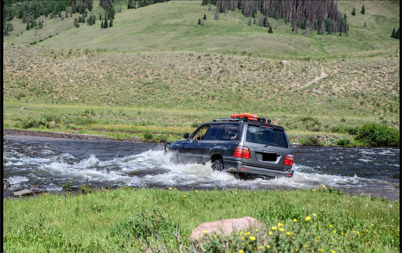

Yippeeee! My rig was pretty much stock at this point, only water related mod was elevated diff breathers. This was at 100s in the Hills when it was still running. Great event . . .
Nice, which trail is this?
