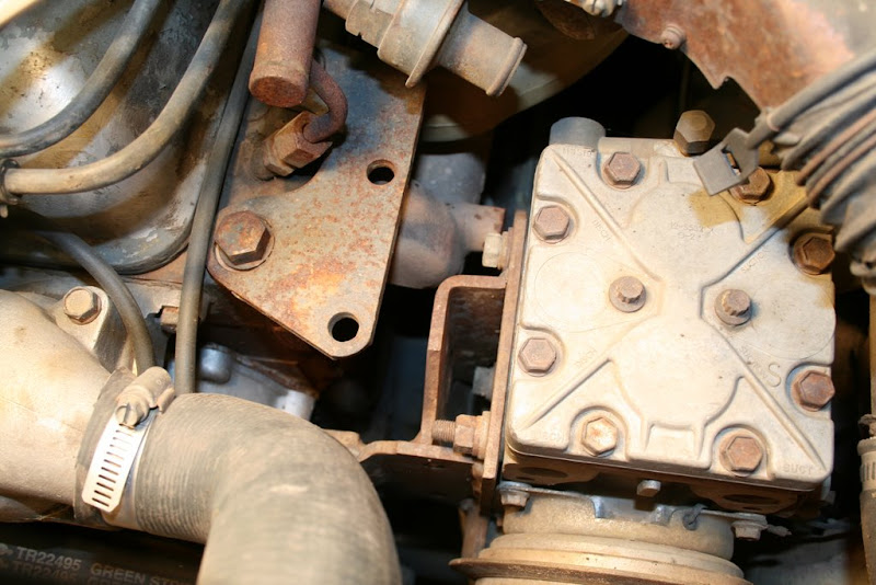

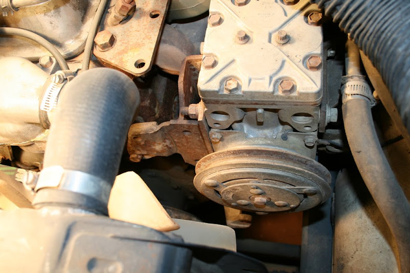

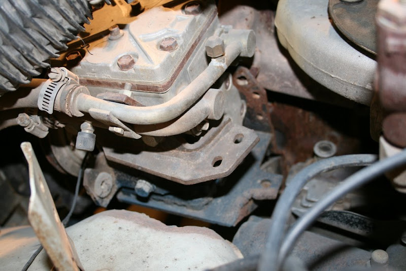

i'll grab some pics tomorrow...
this photo shows the little bracket underneath the wheel on the compressor...
that is dealer add on aftermarket A/C, with a tecumseh(sp?) compressor... It appears to me that the small tab under the compressor is actually for the now deleted smog pump mount bracket.
Dunno if there is supposed to be an idler, but a trip to the auto parts store should net a cheap one you could use...
I'm no mechanic, but am I right in thinking that there should be some simple pulley-with-a-bolt that'll go onto the tab below the compressor? Is that what you mean by "idler?'
Howdy! It doesn't loook like the compressor is set up to pivot on it's base to allow for tensioning the belt, like the alternator is. Usually, A/C compressors do not share the belt with another unit, like the alternator, which could be moved to adjust tension. I am guessing that you are missing some harware. To me it looks like there should be an adjustable pulley mounted between the valve cover and the pump. It may have been mounted to that nice aftermarket bracket that is bolted on top of the head by the #1 AIR injector nozzle. Look at what else lines up with the A/C pulley. It may run on the crank pulley by itself, or it could run over the water pump also. There should be some empty pulley grooves somewhere. If you added a vertical brace between the compressor and valve cover, you might be able to add a spring loaded tensioner pulley like many Chevies use. John
