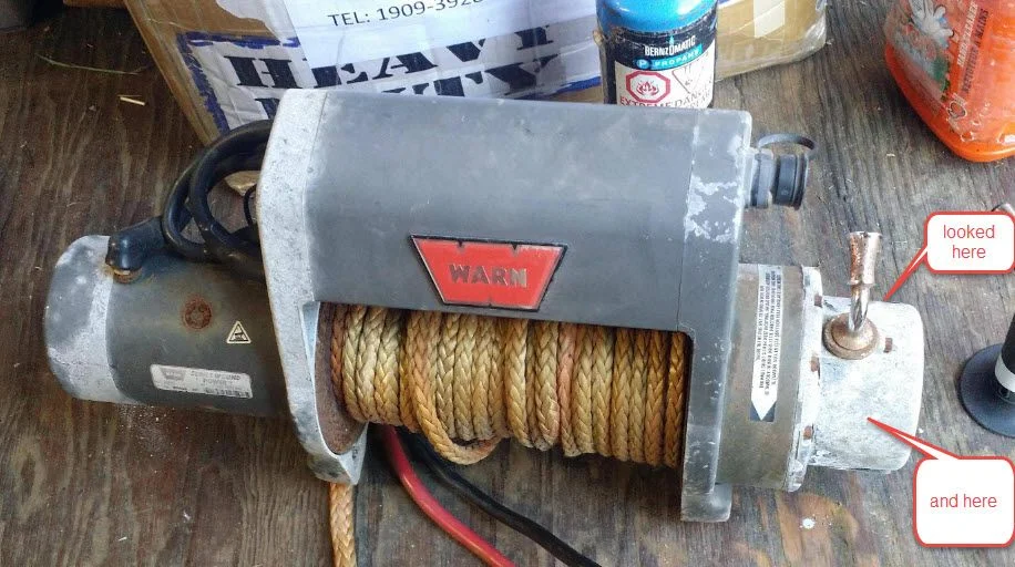

Hi Andy,
I wire brushed the transmission end last night looking for any numbers but could not find any, in those years was it stamped into the aluminum housing or just etched into the powder coating? I attached a picture where I was looking, should I be looking elsewhere?
I really will only need the 2 paper gaskets for the transmission side, those should be standard across the xd9000i right? And for the motor end cap would part number 61543 be the correct end cap for the motor model 26626? The rest of the parts look good enough to clean and reuse, I was able to pop out the brake assembly in one piece last night.
Thanks Andy, after further teardown, I will end up needing the motor side plate since the corrosion ate through around the bearing area, and trying to remove the motor tore that area straight out. So one side plate and a new motor should fix this winch back up, Montana Jack's seem to have all the necessary parts.
