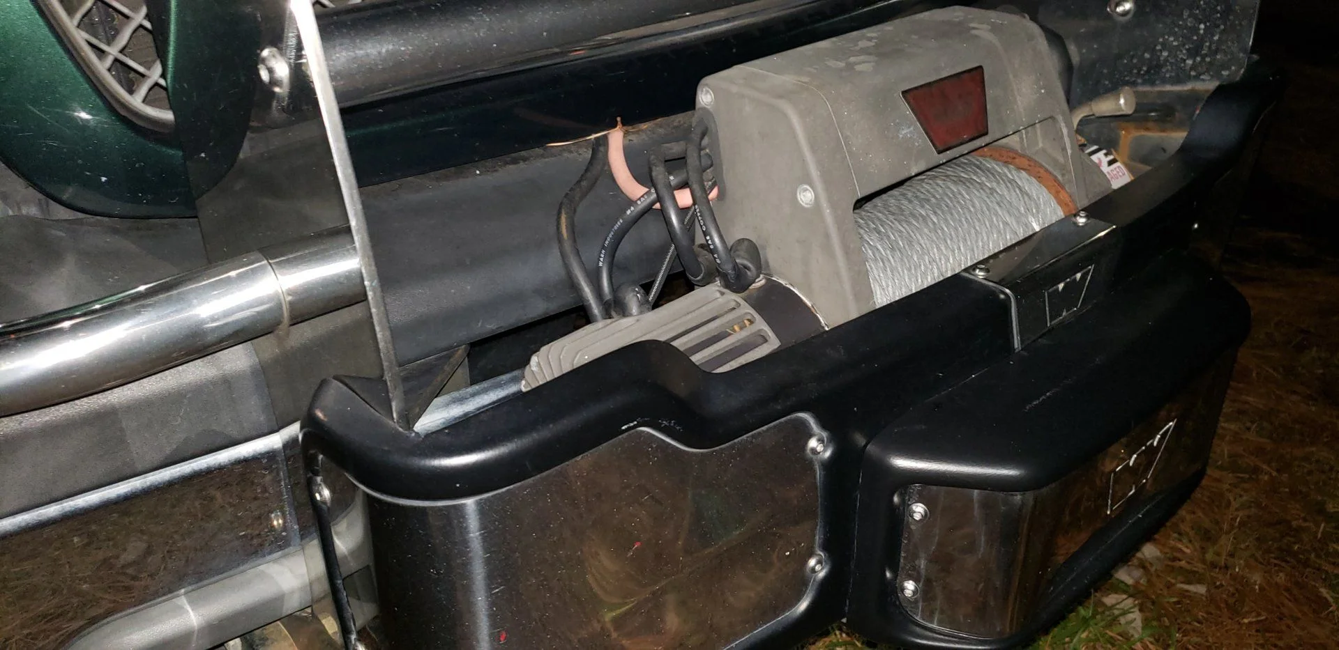

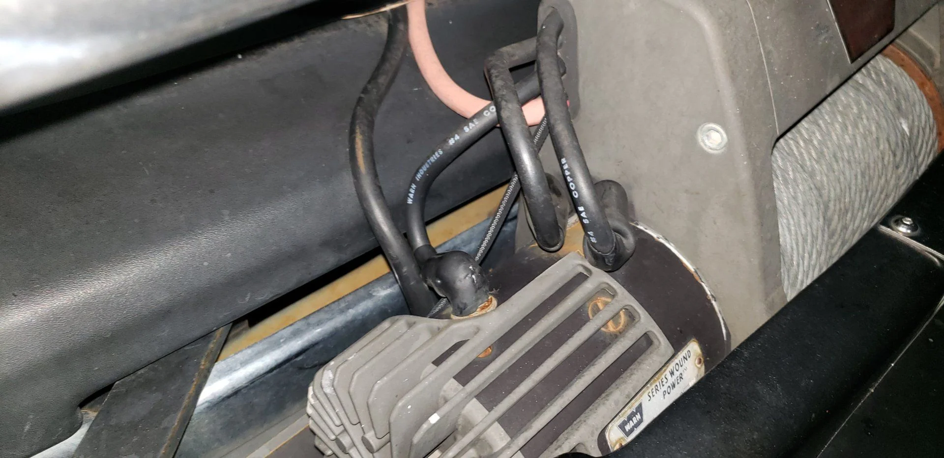

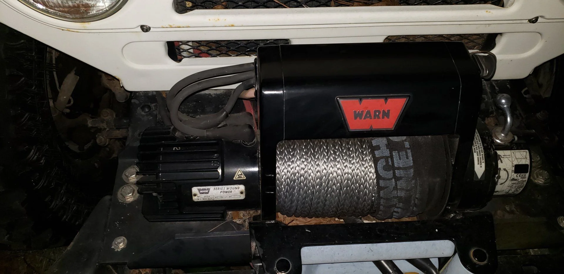

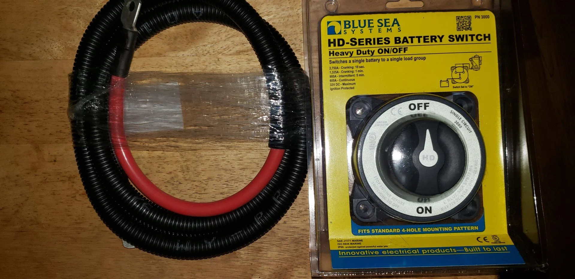

I hope this helps you out. I have the XD9000I on both my Z71 and my FJ40. I bought the one on my Z71 new in 1993. I originally had it on a 1993 Toyota 4x4 V6 pickup and it ended up on my Z71 after I sold the Toyota pickup. The XD9000I on my 40 I bought from a friend. He bought it new in 1992 and I completely re built it. I have a cut off switch already installed on my 40. I have all the parts to rebuild my 1993 XD9000I and a cutoff switch and cable ready to on my Z71. I haven't had any issues with it so I am holding off re building it and installing the cut off switch until I get some more time. Here are some pics that I hope might help you get a visual of how mine are wired. You have the three black connections on top of the motor and the main ground cable on the bottom of the motor running back to the battery. I also included a pic of the additional Warn power cable I have ready to run from the switch back to the battery. The Blue Sea switch has high amp ratings and will handle everything the winch can throw at it.

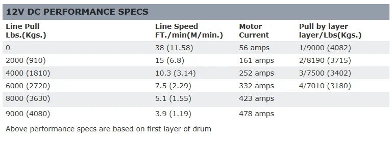

Just for your info. This is the amp Ratings on the XD9000I off the warn website.

Thanks so much for taking the time with me. My motor looks a little different than either of those, but that's the one. Mine's buried sideways in my ARB on an 80, so everything's twisted and cramped. It took a bit to find that ground lug at first because it's at the front of the vehicle facing the bumper plate. I've even watched a couple of rebuild videos prior to working, but they've been off the vehicle so I didn't see the mounted wiring. I really respect what these things do, but I have seen enough YouTube videos to know that they can kill you dead if you get it wrong, so I've been in no hurry to go get stuck.
A winch is just like a loaded gun. It the right hands it is completely safe but in the wrong or inexperienced hands it will kill you. Just follow your basic safety protocols and don't let anyone stand anywhere near the cable or vehicle when you are winching. When winching drape a floor mat or something similar over the cable to absorb some of the energy if the cable breaks. If winching from inside the cab and you can properly see open your hood to protect you if the cable comes loose or snaps.
