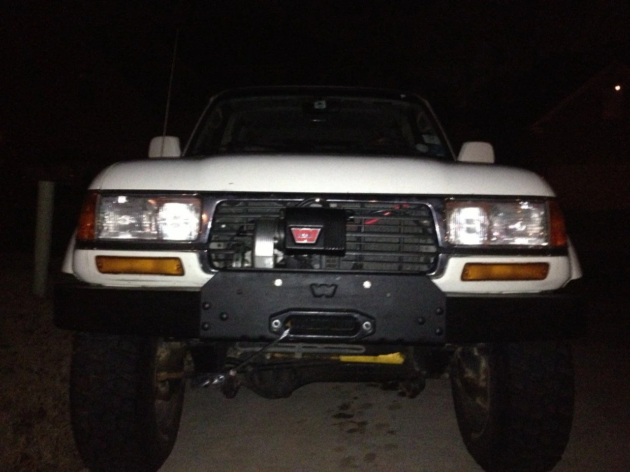

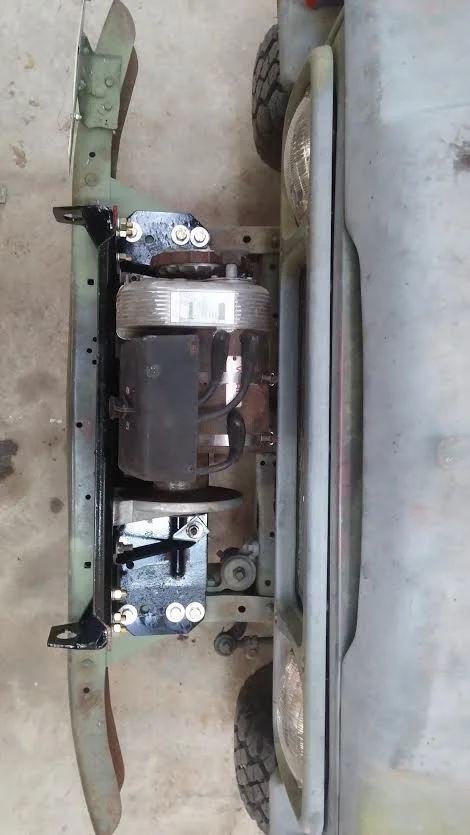

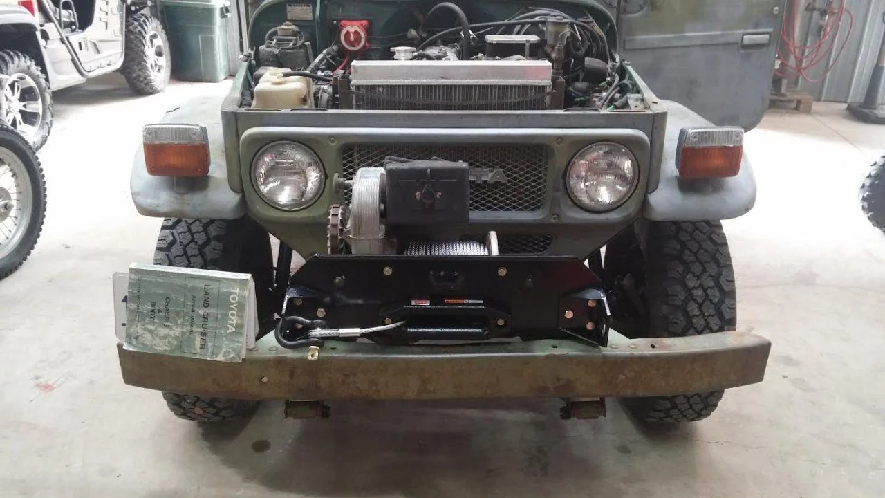

Well got it done. No overheating but the high has only been 70 deg. There are 6 half inch grade 8 bolts holding it on. You can also see my battery switch on the firewall.
