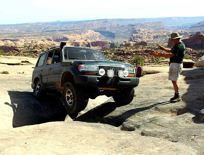

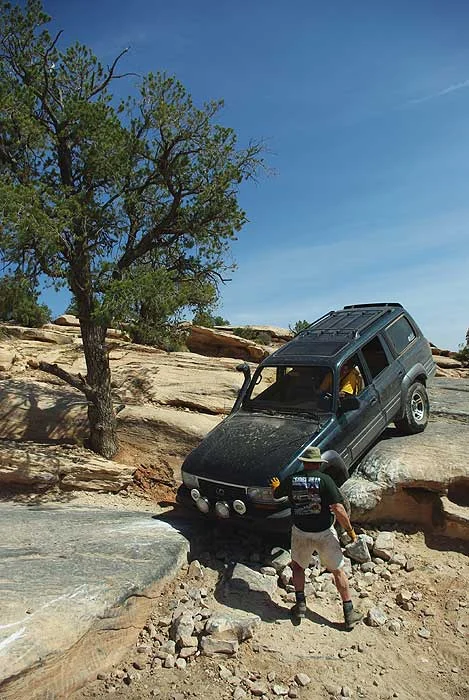

I like to refer to the '80 as the Swiss Army Knife of wheelers. It's a good rig to jump in, drive to Utah, run say Lockhart (~70mi dirt) the next day run Golden Spike (~17mi of ~4.0 rock), it handles it all without missing a beat and in relative comfort.
They are amazingly capable box stock. If your the type who looks forward to tons of necessary mods to trail prep a rig, maybe disappointed.:hillbilly: IMHO bolt on your lift and tires of choice and wheel it, then see what other mods you want. With just lift and tires they handle most 4ish trails, pretty good for a station wagon.:hillbilly:
For AZ trails and a highway/trails combo rig, Nitto Terra Grapplers work very well. A good lift is OME hybrid, J springs in the front, heavy rear springs and L shocks all around. This makes for a level lift that is relatively easy to setup and wheels/flexes well.
A couple of pix of azrider's rig on Spike running this setup. More pix of the trip; https://forum.ih8mud.com/az-copper-state-cruisers/282439-cruise-moab-2009-pix.html
