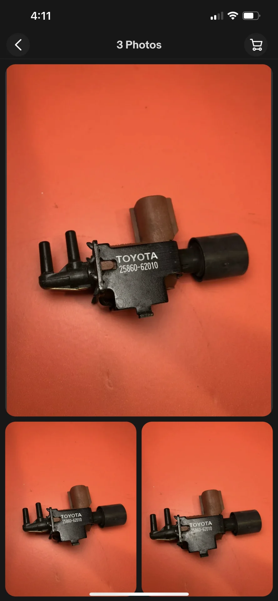

Sup guys, I’ll be installing an a/c idle up on my 84 fj60. I’m currently running a city racer carb and I’m missing a couple of parts. Is there a recommended replacement for the idle up VSV since the OEM is no longer in production?
Thanks a bunch! I’ll order one of those as well. Picked up this one on eBay for $12
That one will work, too. You'll just need a connector or wire direct with spade terminals. The ebay one with the pigtail is not the proper connector, either, but easier to make work. Just swap the little black cylinder 'filter' on to it.

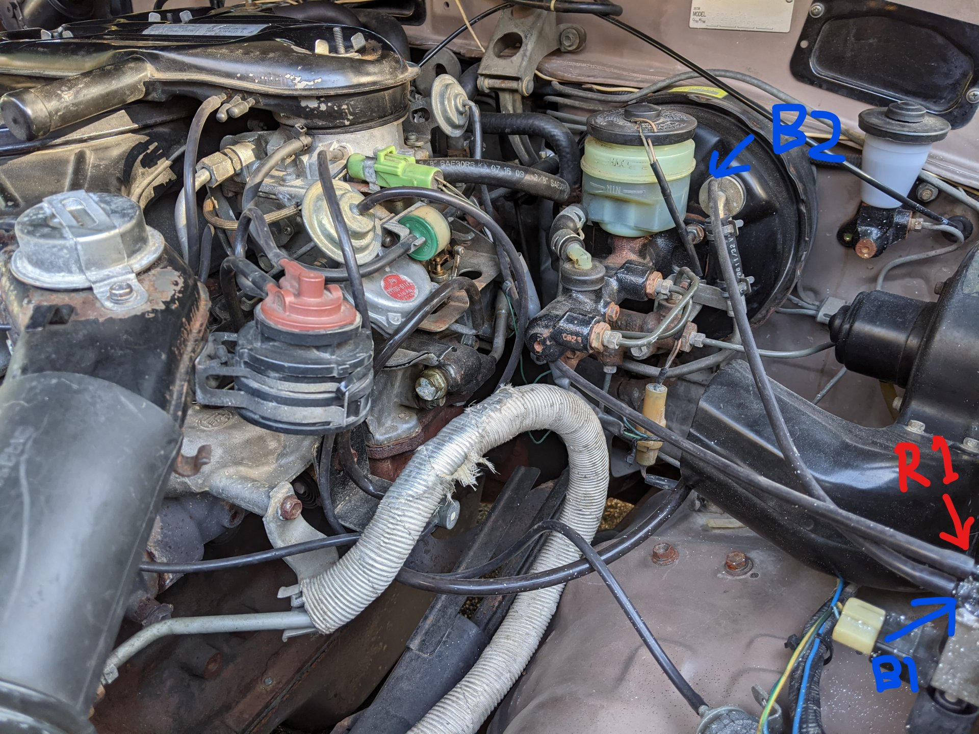

near as I can tell the A/C idle up tubing shown in this picture is not connected properly. The lower port on the VSV should be connected to the ac idle up diapragm, but it is connected to a vacuum source on the brake booster. It looks like both ports on the VSV are connected to a vacuum source. Connect the tubing according to the schematic above.
I had my hoses swapped when I reconnected everything and got this terrible hiss that was coming from the carb and manifold area.....I thought it was an exhaust leak. Swapped hoses and it fixed it.
Photo isn't mine and was only intended to show location of components, although any source of manifold vacuum will work with the open port of VSV then connected to idle up .
Yup. Got that. No worries. Just adding context. :)
