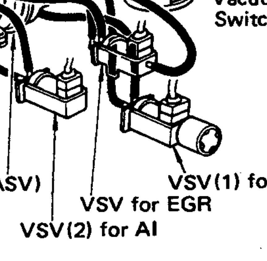

well, it's not just on/off, but also whether one or both of the lines is vented to atmosphere. If one side of the VSV is connected to a vacuum source and the other side to a vacuum actuated device, it is usually the device side that would be vented...or not vented. Sometimes the vent is routed back to the air cleaner, sometimes it is vented directly from the switch. Here is a diagram from the AI system with two different VSV's. One is not vented and the other vent's through the top of the switch chamber. I saw another one for EGR where the vent goes back to the air cleaner...
On the 2F there's basically three different types of VSVs that all do the same thing, although slightly differently.
One of them is a simple on/off valve.
One of them releases built up vacuum to the atmosphere when the valve is actuated (as a pressure release). The third type (used for EGR) does the same but one of the pipes is used for a bleed so it's routed to the air cleaner with a vacuum hose.
They aren't interchangeable on the 2F, but there are VSVs used in other Toyotas that can be used as replacements if they look the same (same piping). The plug will be different, but that's easy to change.
Also within different models of Toyotas, a VSV might have its bracket oriented differently, or have an updated plug end — so it gets a new part number.
2F VSVs below.
