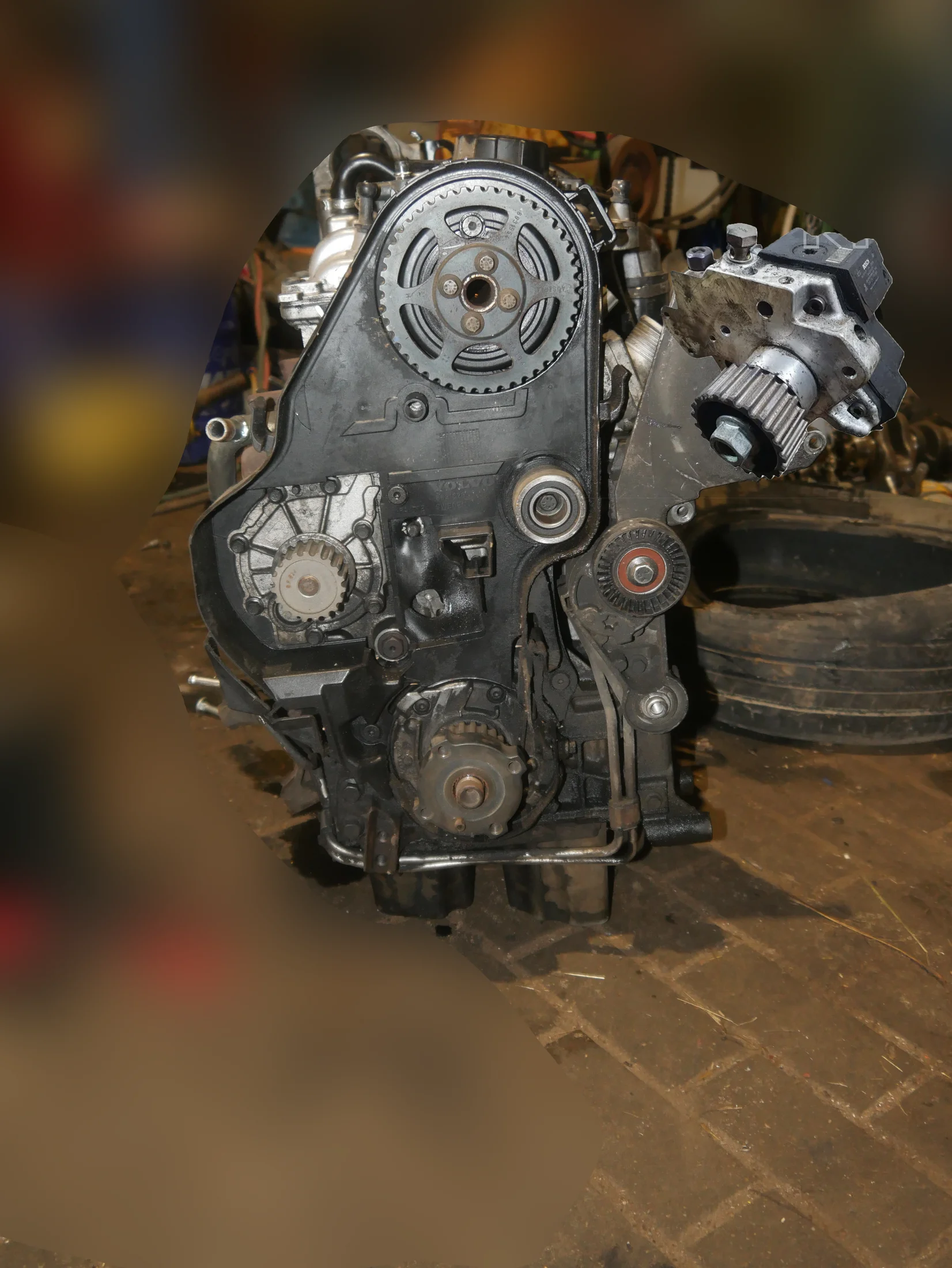

Ive spent some time trying to figure out what to do with the commonrail pump on the D5, as it sticks out about 15cm past the crank face. Ive had an idea of remote mounting it and maybe driving it from the timing belt or making a custom thing to drive it with gears from the cam shaft. Has anyone seen this be done? Its a commonrail pump it shouldnt matter at how its timed as i understand, because it just has to keep the pressure in the rail.

sounds tricky, those pumps take a bit of power to turn so what ever you come up with will need to be strong. I know that the VM 3.0l engines actually do need to have the high pressure pump in time, if they're not timed up right they still run fine but make a noise. Better 2x check that it's not an issue on your Volvo. i would see if you can make it fit without moving it.
I don't think driving the common rail pump with a belt would be feasible.
Do any OEMs run the pump with a belt?
Commonrail injection system produce huge pressures to the injectors, and would require a lot of torque to drive the pump.
Not sure about the D5, but some common rail injection runs at 40,000+ psi. That's wild!! That's slice through steel wild!
The pump is basically a hydraulic fluid pump.
You'd need a big wide, toothed belt, and a LOT of belt tension, and pulleys precisely aligned.
I don't think driving the pump from the cam would be a good idea either. Camshaft is driven at a 1:2 ratio to crank rotation.
I think, regardless of timing, you'd have to use gearing to bring the pump rotation back up to 1:1 to produce the correct output for flow and pressure.
You'd be putting a lot of load through the cam gears/ belt etc ( no idea how the Volvo cam is driven), that aren't designed for high torque loads.
The diesels I've had apart use sturdy/ heavy metal gears driven off the crank. And that's for engines running 2500psi injection pressure.

After speaking to some diesel guys ive found out some run belt driven dual CP3 pumps in high power applications, now 200hp isnt exactly high power but il just run one pump. Heres some people selling kits for a second pump https://www.msttuning.com.au/product-page/m57-dual-cp3-kit
PPE Dual Fueler CP3 Kit Cummins (04.5-07) With CP3 Pump - https://ecddiesel.com/dodge-5-9l-ppe-dual-fueler-cp3-pump-kit.html I know some diesel toyotas run the cr pump from the timing belt. Volvo actually drives the pump from the cam from factory. I know some engines are gear driven, but isnt that more for reliability?

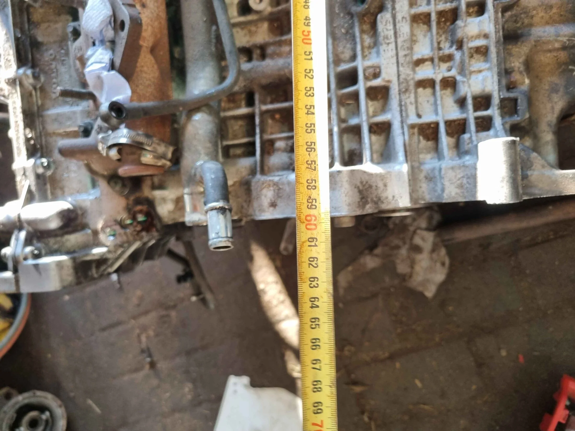

Took off the CP3 pump and the vacuum pump on my blown engine and the block is about 60cm with the head being 3cm past the bellhousing face.
Im hoping i can use a CP3 pump from a different car as the Volvo version has a very short shaft which would be difficult to adapt to a pulley. Im finding the information online about the CP3 pumps to be basically what @TheBussman said, the engine will run but itll be a bit rough. Im hoping to adapt the 2LT PAS pump as then i can use the original vacuum pump. Its looking like ill have to make a custom accesory drive, which would also solve this engines achilees heel, where the serpentine belt can snap from old age and get in to the timing belt, which causes bad things happen which is how this engine died
This is the current plan, usually the PAS pump is there but ill run the stock 2LT one on the otherside and use that space for the CR pump, the pump ill use is going to be from some kind of Audi as they seem to be much easier to mount and drive than the volvo one, ill replace the toothed belt with a spline one and hope its enough to drive the pump. I know im running the chance of snapping a belt, and itll probably need to be changed more often aswell

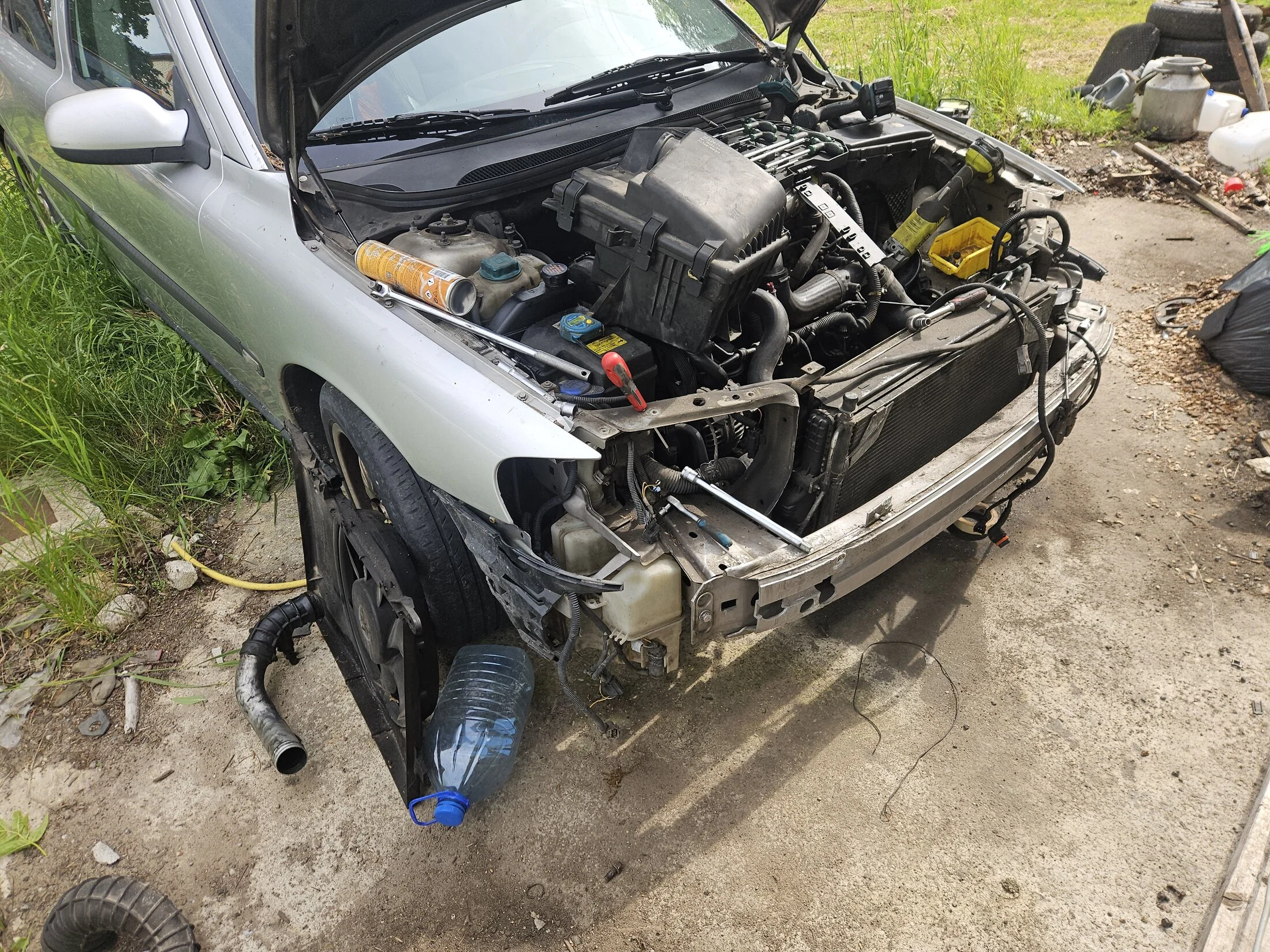

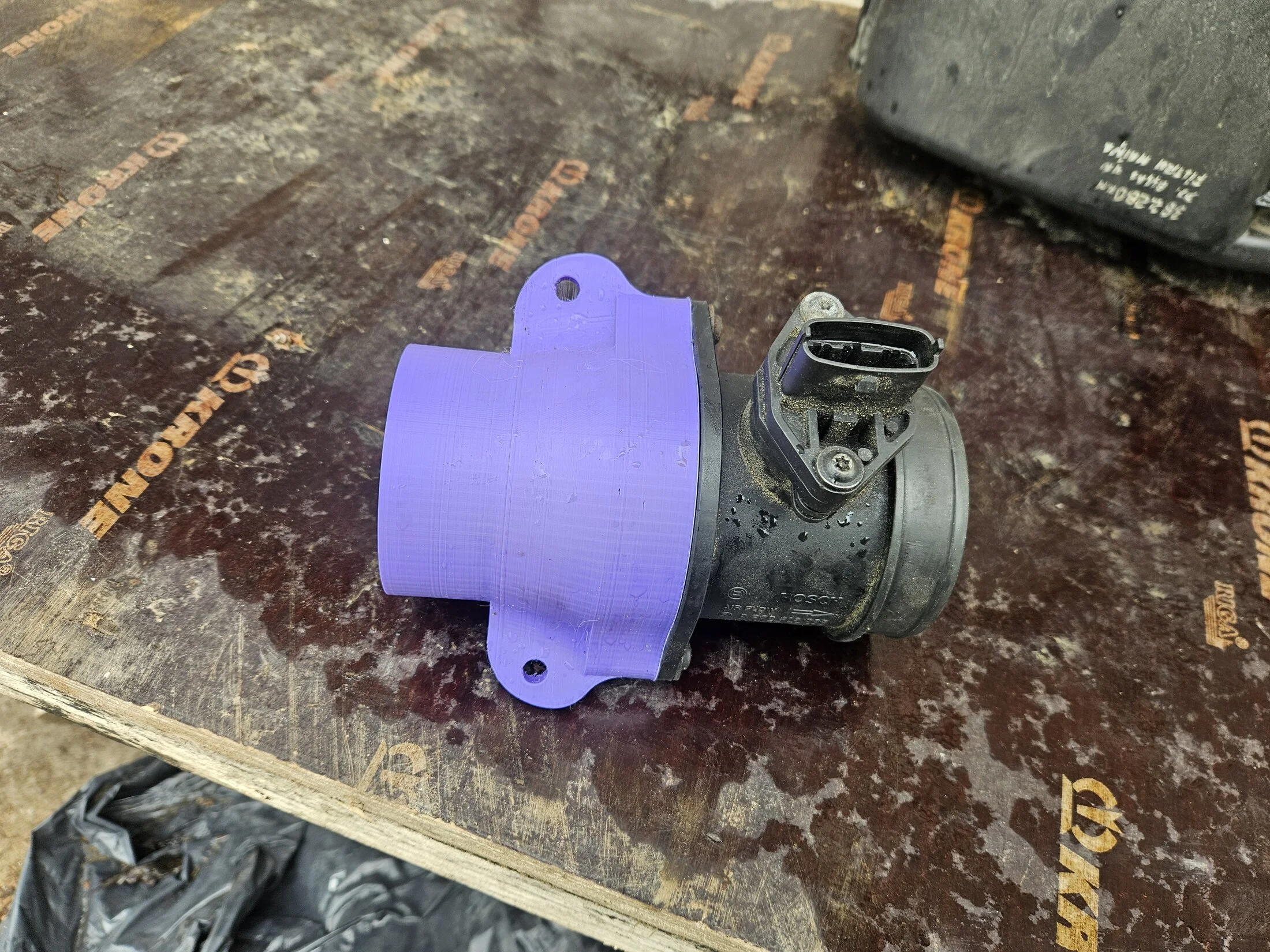

Was busy with life but i have made some progress, i bought a donor manual Volvo S60 to take anything i need for the swap and sell the rest. I considered buying only the things i need but buying a whole car worked out much cheaper than buying individual parts, and atleast this way i know the engine worked correctly before i do anything. I also made an adapter to use the original MAF with a standard cone filter as i wont be using any of the factory Volvo or Toyota intake piping. Its a weird shape and printed out of PLA, as its just for test fitting for now.
